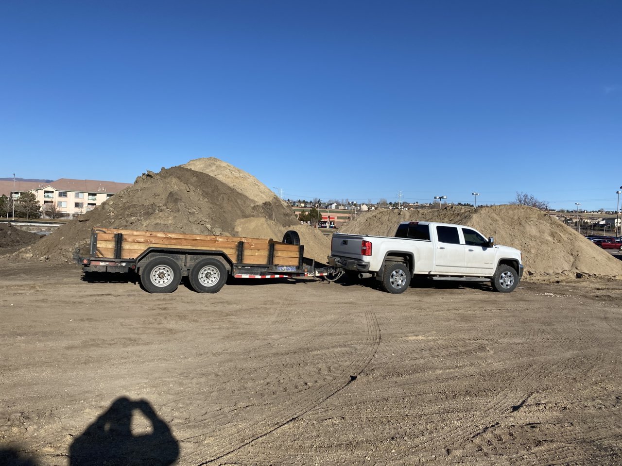

    I’m not one for being overweight when towing. I come close a lot, and with newer diesel trucks having huge GVWR’s now days it makes things even tougher. If I wanted to go out and get a new Duramax, a 3/4 ton now has about the same GVWR as my ‘16 3500 and exceeds my tow ratings (conventional).
    I get flagged into one of my local DOT checkpoints on occasion depending on what trailer I have with me. If I have the Kubota on my 20’ Load Trail, might be a 5% chance. Lots of people out were I live have tractors for property maintenance. Not a red flag. Now if I borrow my buddies dump trailers (bumper pull/GN) and his skid steer...yeah, I’m going in. This past summer I needed fill dirt and a lot of it. I was building a road to the back half of my property. A local builder needed to get rid of good road base material for free. They even loaded it up for me with a front end loader. I ended up towing 200K lbs of dirt running non stop for 4 days. I straight up took 4-5/32nds off my rear tires. I was never flagged in. Now if I would have had my buddies dump trailer...oh hell yeah.
    Here’s the deal and you have to be smart about how much information you volunteer. I do a few side jobs a year (maybe 10-14) with the tractor to help out locals around the area. The words that come out of my mouth if I do come into a mobile DOT checkpoint is “I’m not in commerce” and that usually ends that conversation. Don’t say “I’m not commercial” since that’s for them to determine, not you. If they ask you what the equipment is for....my personal use at my residence. Then you should probably go home for the day. Pulling into someone else commercial building site might get you in a little trouble. I have a buddy in Alabama that got deemed commercial after a traffic stop and was fined up to his eyeballs. He had a dually with a flatbed trailer for his side hustle lawn care business heading to his church to mow the grass and do some other small odd jobs. He would get paid, cover his fuel and donate his earnings to the church. Did he have to divulge all that information? Probably not his wisest moment. He ended up getting popped for no CDL, MC/DOT authority, no log book, and a slew of other fines which included the broken taillight on his trailer that got him pulled over in the first place.

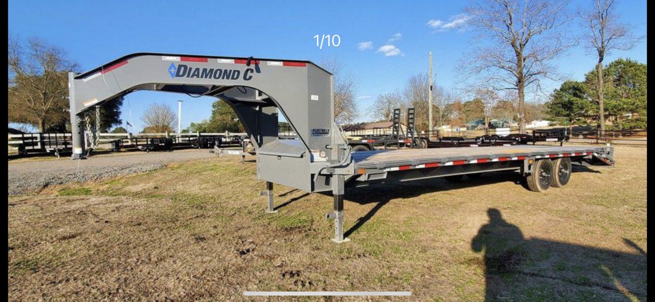

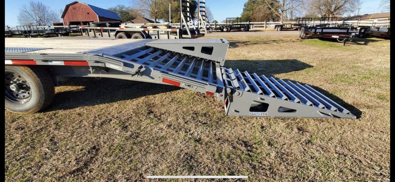

    I’m leaning toward this:
    Diamond C Engineered beam deck over.
    0B015E22-974A-4EA7-9714-C239D5D891B9.jpg DD465010-0CEA-4055-BF8E-1C265AD793A6.jpg

    That’s a good looking trailer!

    I agree.
