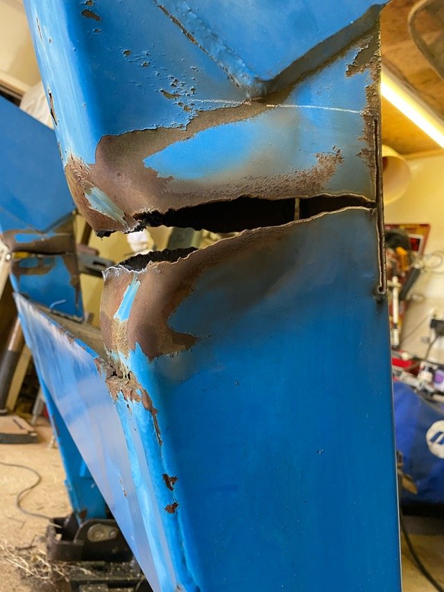

    Reminds me of trailer shop work. Someone always has to say "There's no way you can fix that!" I cut out the bent crap and it always came correct. They are always amazed.

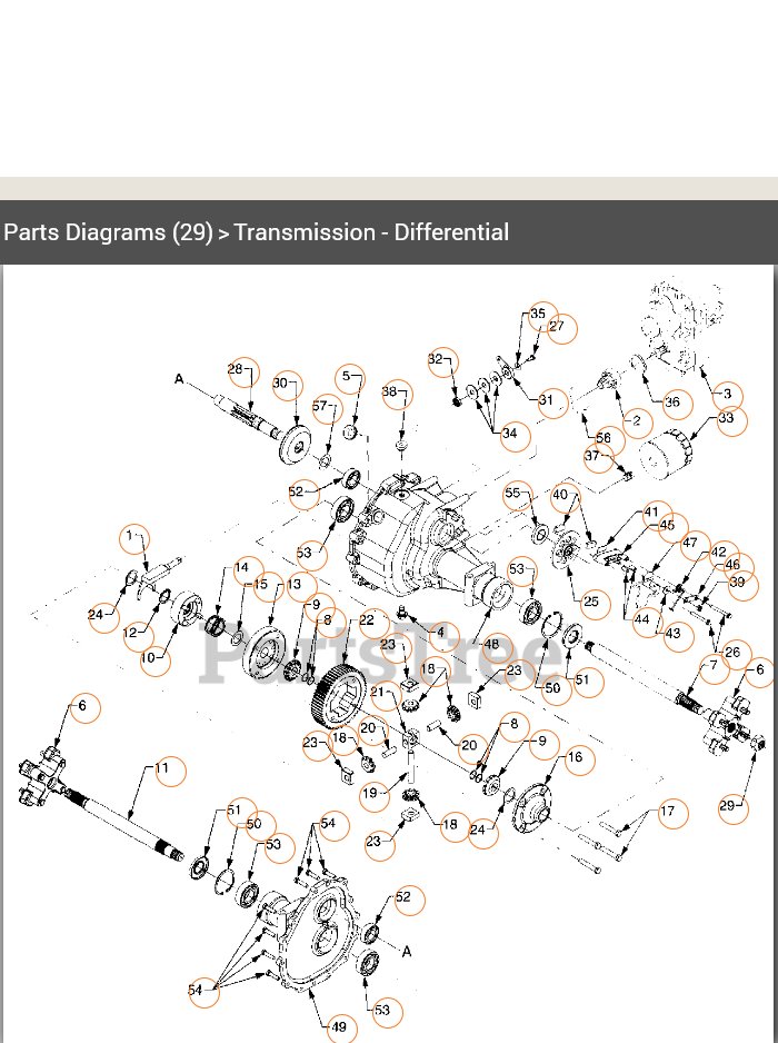

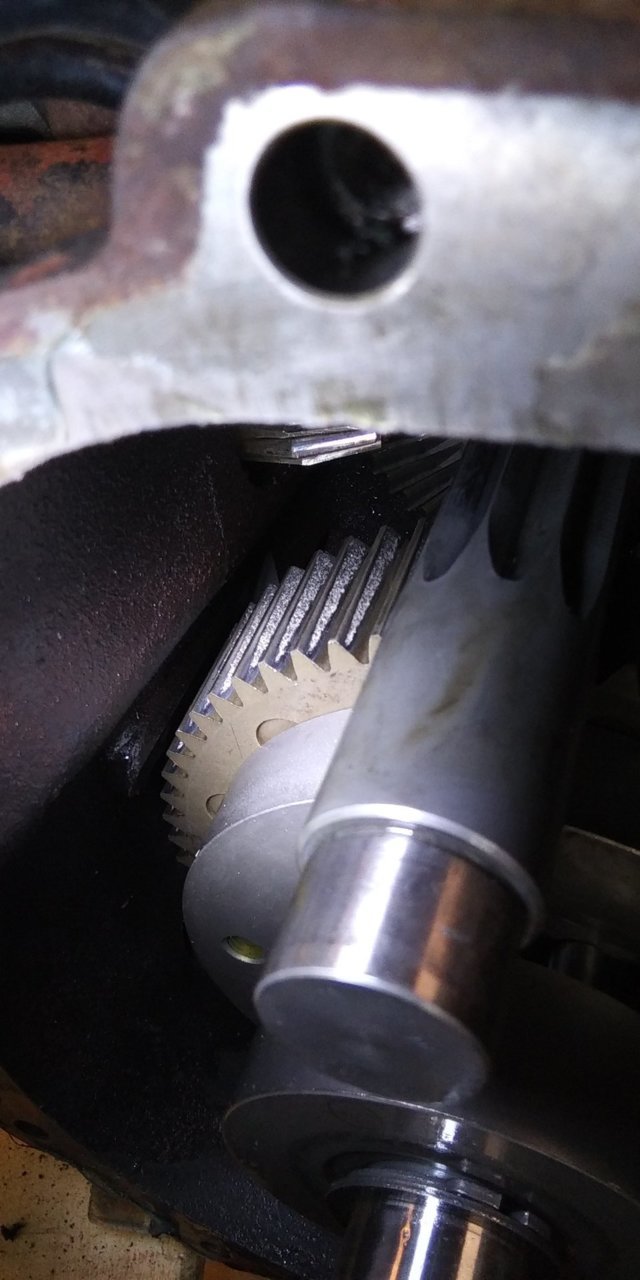

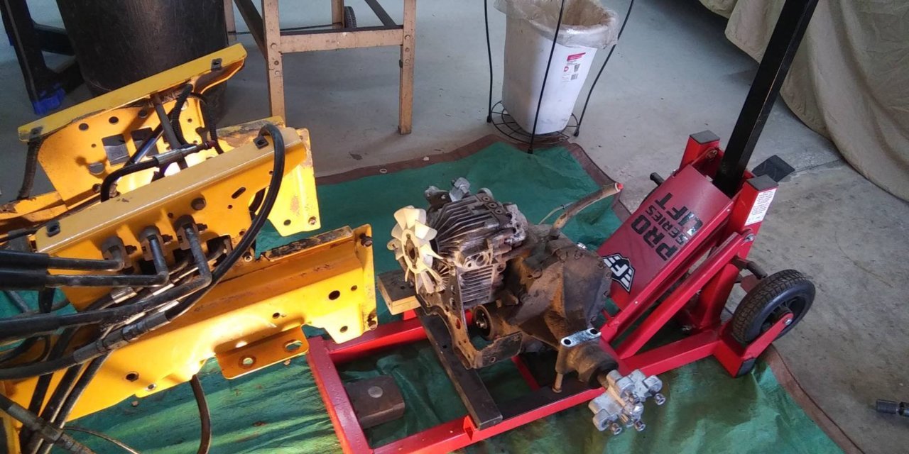

    Got the 3240 rear torn halfway down. The diff lock pins hitting the holes they lock in was the clunking. May be the spring that holds it away is weak. Ring gear is trashed. Gonna finish teardown Saturday and order parts. I've been on a 2 week rotation thru the weekend in the hospital with Covid ICU duty and am beat to hell right now.

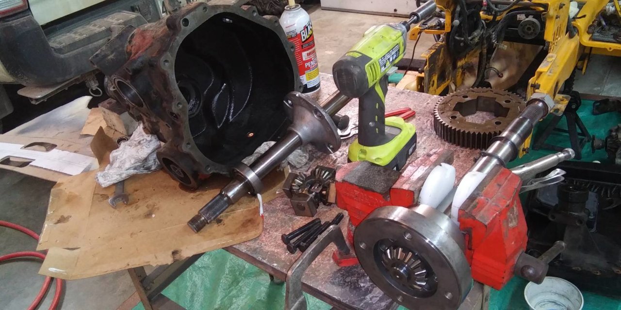

    3240 rear work. Looks like the ring gear is all that's bad in it. Still checking why the diff lock pawls were clunking in the holes they lock in. It doesn't have a wear pattern like it was doing it non-stop so it may have only been noticeable with it jacked up and all the weight of the wheels made the axle sag down. IDK.
    Gonna do a little more checking, order a used ring gear, seals, and the spring that holds the diff lock away from the diff and call it good.
