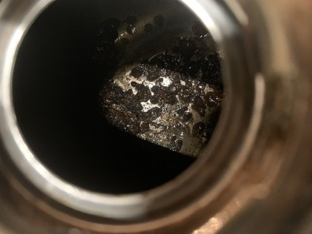

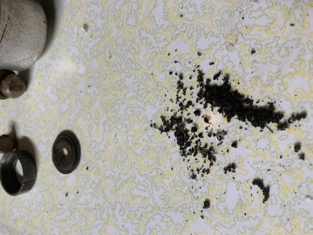

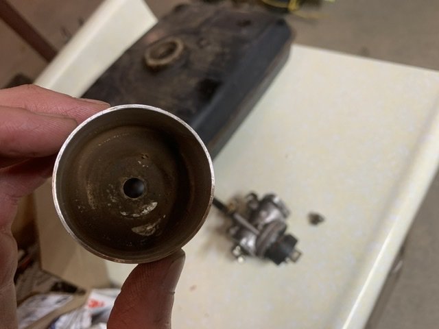

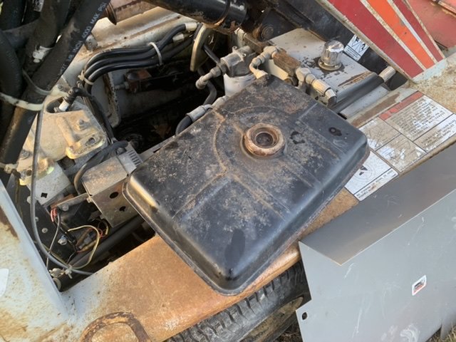

    I finally dug into the mini skid steer I posted a pic of earlier in the thread. Pulled the bowl off the carb because it leaks. Has fine sediment in the bottom, quite a bit. Most ran out with the gas that was left in the bowl.
    So I pulled the small brass screen/sediment bowl off the bottom of the tank. PLUGGED! Only one thing left to do, so I pulled the tank. It sounded like a maraca when I rocked it back and forth after removing it. More sediment than I’ve ever seen. It’s BAD.
    I pulled the carb, too. Just to be safe. Borrowing my buddy’s ultrasonic cleaner. Maybe it’ll work some magic on the jets.
    I’ll fill it with thinner and a bunch of nuts and bolts and shake it up until the thinner comes back out clear. Gonna take a lot, I’m sure. For now, I’ve got a small auxiliary tank I can use for testing once the carb is back together.
    Inside tank:

    Yeesh. You may want to consider having that tank sealed, unless the PO was just filling the tank from a REALLY old rusty can.

    I was thinking the same thing. They make kits to seal metal tanks. I've seen them used with mixed results on old ATVs and ATCs though.

    Red Kote and KBS are both spoken of very highly on my Sweptline forums, and the POR-15 kit seems to generally be the go-to for a more budget-friendly sealant.

    I was thinking it might need to be sealed. I'll judge that once I get all the crap out. If it's heavily pitted inside and scaly, it'll either get coated or I'll adapt another tank onto it.
    I've seen 'em. They get mixed reviews. Probably depends on tank cleanliness and proper application.
    I've heard of the Red Kote and the POR 15, never heard of the KBS though. I'll check it out if the need arises.
    What's crazy, is the guy I got this from was using it just last year with no issues. He's also a good mechanic. It almost makes me wonder if he pissed someone off (lol) and they dumped crap in the tank. He's a good friend of mine, but doesn't take crap from anyone. I know he's had a few run-ins with neighbors. Who knows...
    I'm going to try to grab a new length of fuel hose for it this weekend and replace the two small hoses, really clean out the carb, and start on the fuel tank. Should be fun!
    Edit: the outside of the tank is in decent shape, so I'm hoping it's just sediment from a crappy fill can or something like that.
