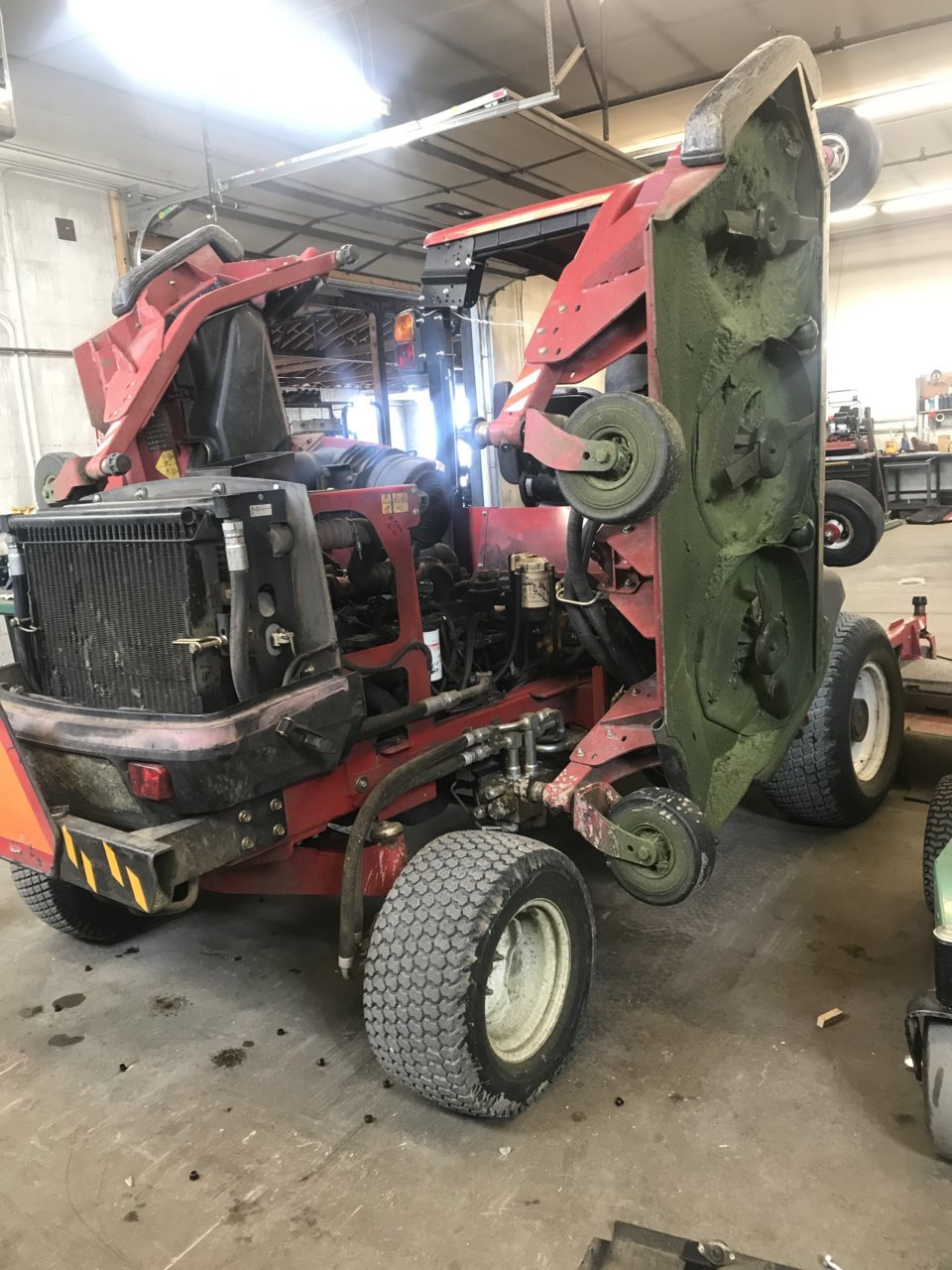

    25C422F4-56AA-4D59-A44C-8F3E636F620E.jpg Parks department managed to blow a hole in their radiator. This is gonna be a fun one.

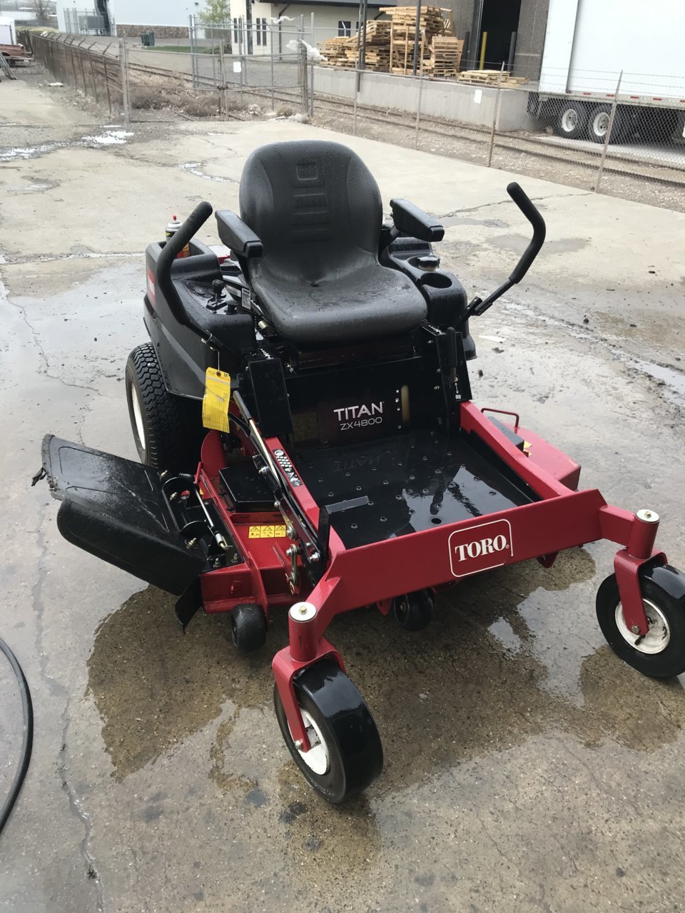

    Also getting a battery for my Titan z today. Hopefully she’ll run long enough to get on and off a trailer. Probably have to do a full fuel system drain. Carb comes in tomorrow hopefully. Should give me something to tinker with this weekend.

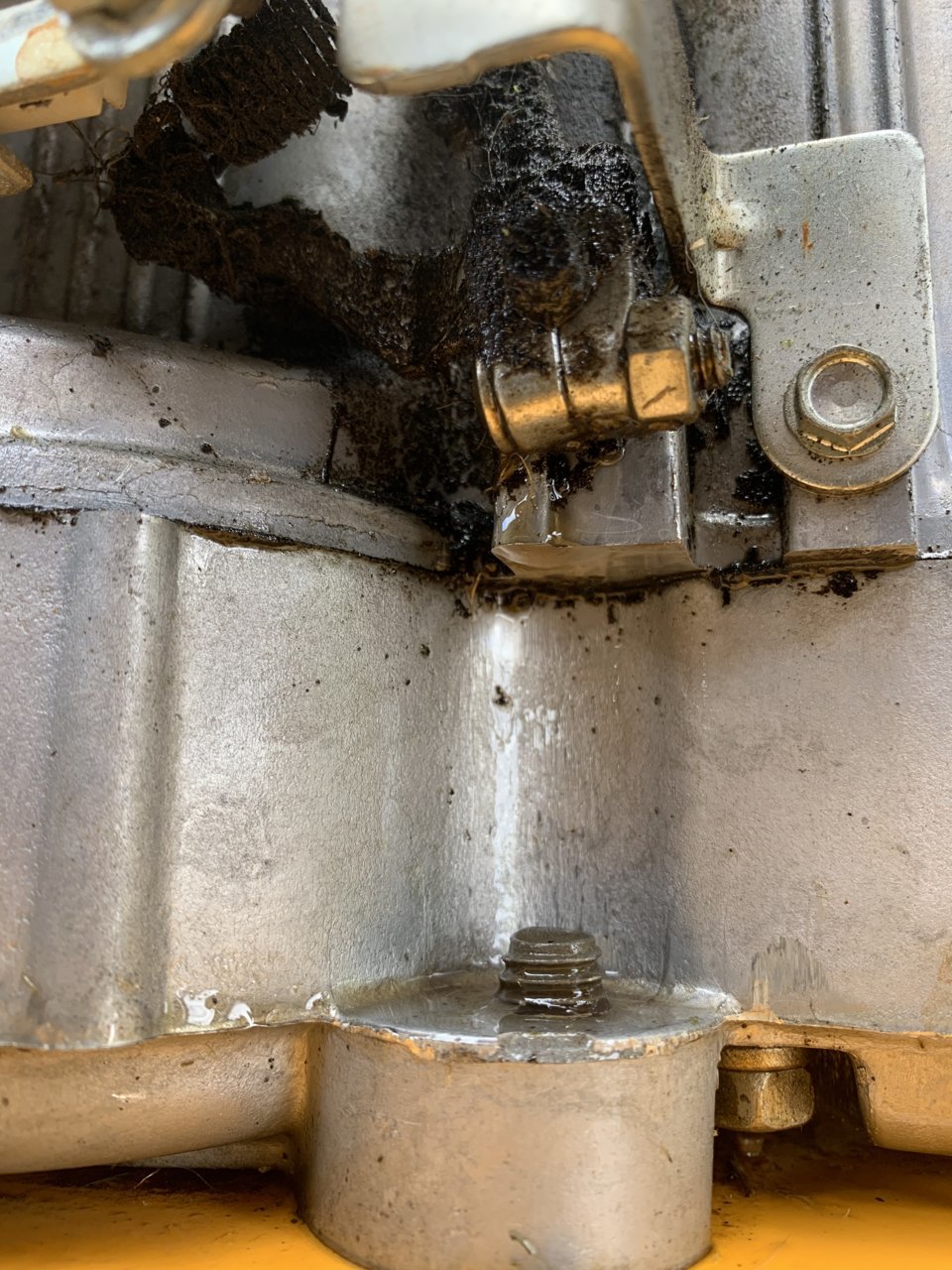

    Has anyone replaced the governor seal on a 10.5HP Briggs that’s on a Cub Cadet 760? 2009 model.
    RustyGreen and six5crèéd[OP] like this.
  10. May 7, 2021 at 10:16 AM
    #3530
    Zeke588
    Zeke588 Well-Known Member
    Jun 1, 2018
    #255189
    764
    Zeke
    Billings, Mt
    Bluerunner
    03 V8 limited
    I’ve done gov seals like that before. Not on a Briggs specifically. Just pull your linkage off and use a pick too pull the old seal?

    With the linkage and arm off, will the shaft move?
  12. May 7, 2021 at 10:36 AM
    #3532
    Zeke588
    Jun 1, 2018
    #255189
    764
    Zeke
    Billings, Mt
    Bluerunner
    03 V8 limited
    I believe it does. Clean it all up before you pull the seal out. There should specific angle or whatever it wants the shaft when you put the linkage back on. The shaft more than likely has a hole in it. You put the linkage on loosely and turn the shaft using the hole with a pick too whichever direction the the manufacturer recommends.

    I had a Bobcat zero turn with a B & S V-Twin and it blew the crankcase seal. I had to pull the engine and replace it, it wasn't that bad of a job. If you do try and replace it without pulling the pan and succeed that's awesome. If something goes wrong it's not that bad to pull the crankcase base off and fix it. The governor is pretty simple on the inside.
    RustyGreen and 308savage[QUOTED] like this.

    I've done it without even pulling the engine. As long as you have good access for tools and can see what you're doing you should be fine.

    0DD7B772-FD9F-4BFD-9C18-5E535F6AB3C3.jpg Just got my mower started! She runs. Sounds like she's missing.
    Can’t Believe the guy told me to scrap it lol.

    I’m just worried that I won’t get things lined back up right. It was free, but I’ve already got about $300 in it between carb, cables, tires, and castor yokes.

    It’s meant to be adjusted. If it’s out of whack it will run like shit and you’ll hear it. Or it won’t run at all until it’s in spec

    Replacing the governor is usually a pain. They even teach us to take everything apart to replace it. You can do minor adjustments outside, but a full replacement...we don't even work on riding mowers here. Too large for our shop and don't have the manpower to do that many repairs and rentals
    edit: just the seal? Not as sure about that one. Would refer to someone more experienced with that. Never had to do one with our smaller mowers
