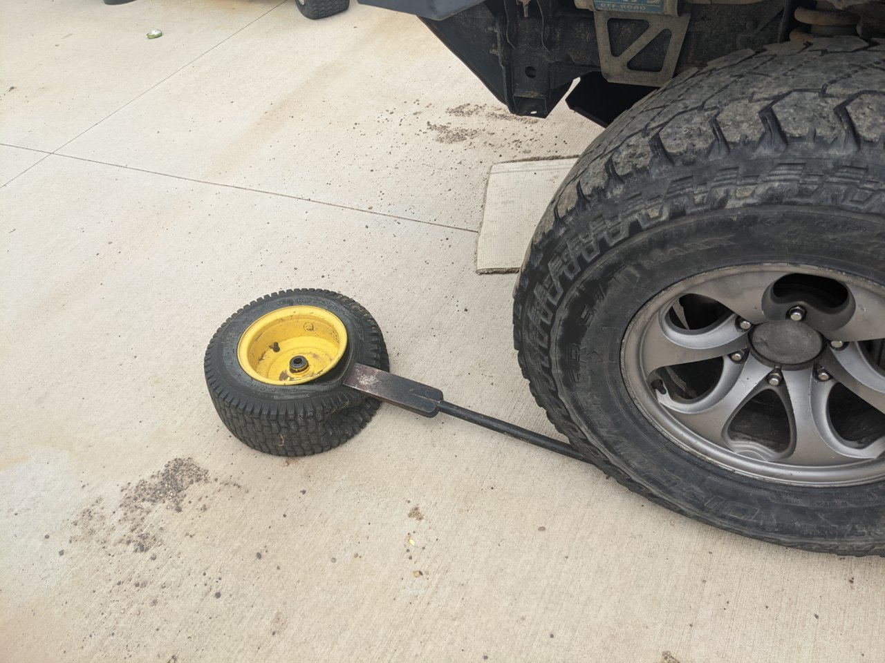

    Meh... Wasn't too god awful bad actually.
    Digging bar and the tacoma broke the bead.
    Couple of screw drivers got er off.
    We'll see how the new one goes on.

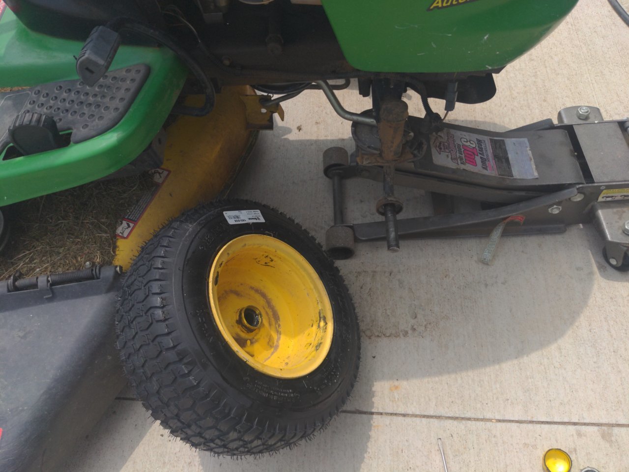

    Well that was definitely harder in my head.....
    Soap on the screwdriver handles was the worst part :rofl:

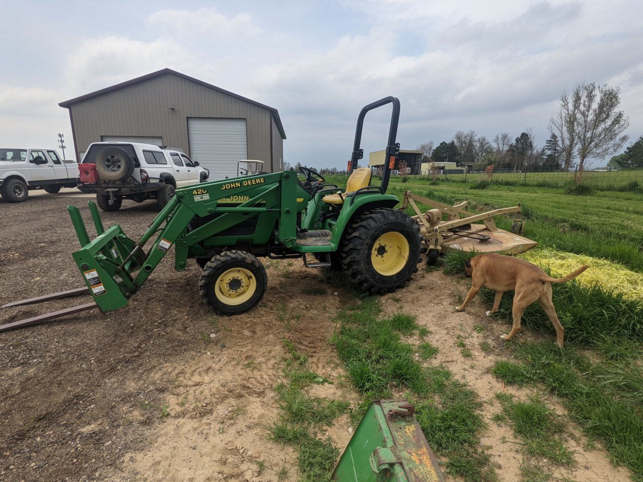

    And in keeping with the theme, I finally attached and used the only implement I hadn't touched so far.

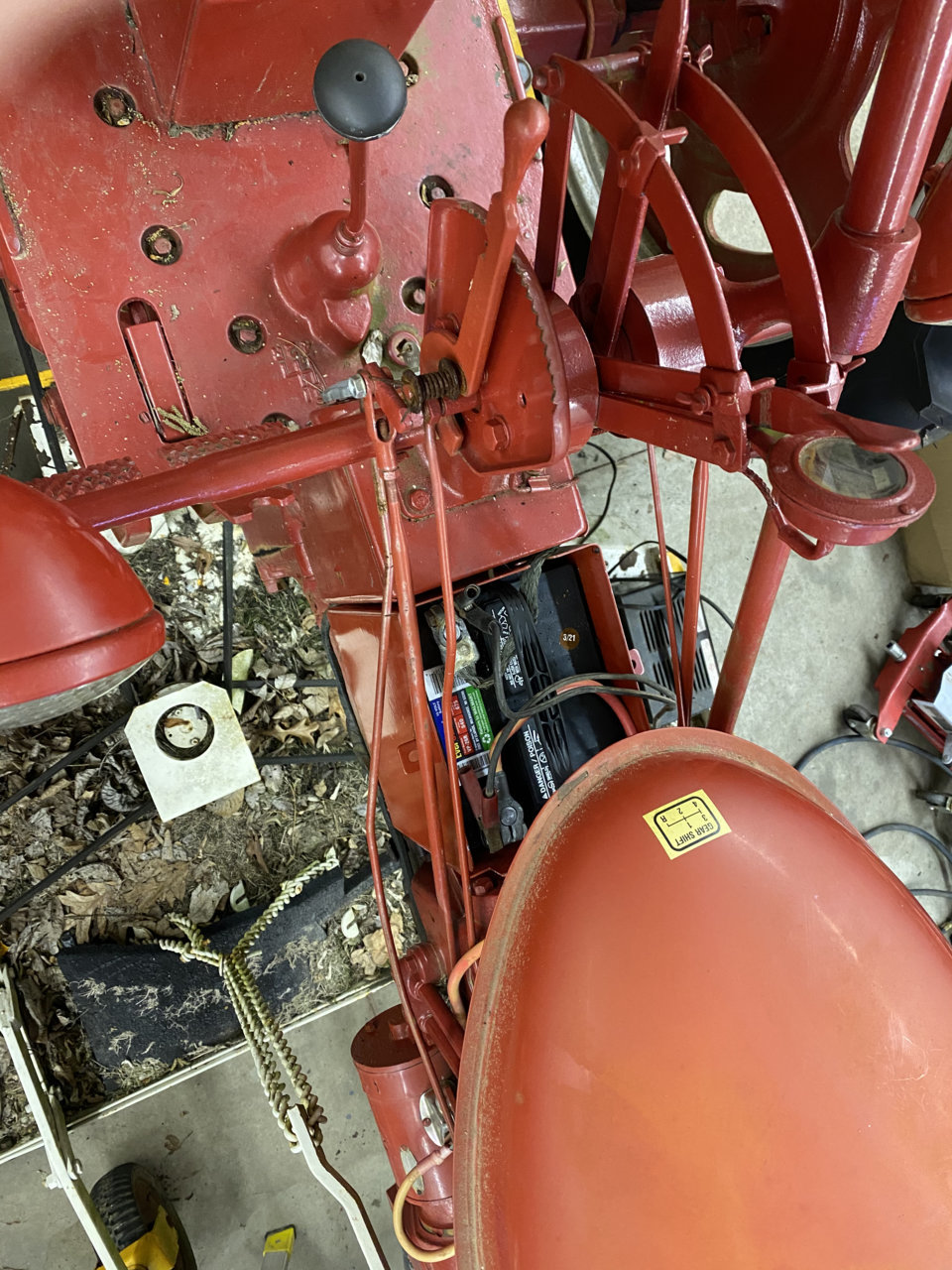

    swapped in a new battery last week, and cleaned out the fuel tank and replaced all the fuel lines today. Went to start it and the battery is already dead. Bad ground cable is my guess. Gonna suck to tear apart the drivers pedestal to get to the other end.

    What model is that? Obviously a farmall, does the factory tach work?

    1953 Farmall Super C. Everything functions thankfully. Woods triple blade belly mower that rocks when the machine runs.
    Have new negative/ground cable in and still won’t start even with known good battery. Pulling plugs and they look terrible so off to buy four D21 plugs tomorrow.E96150A6-A181-41DB-9F01-E2FC4A4E4A5E.jpg

    How’s the points look in the distributor?

    It's running really rich, the needle is probably not sealing and you are dumping way to much fuel into the carb and then into the engine. It also sounds like you have a short or a drain going on or a very bad connection although that would not explain the dead battery. All a bad connection will do is not allow power to pass, it doesn't actually kill the battery and discharge it if sitting.
    Dad had a super M that had all sorts of issues. Finally yanked the carb off it and rebuilt it and put in a good fuel filter. [you can't believe the crap that will come out of those old tanks] He ran that thing for several years after that without issues.
    On the plus side, that will be the easiest carb you will ever rebuild in your entire life. It's just above putting a nail into a block of wood in technical ability to rebuild.
