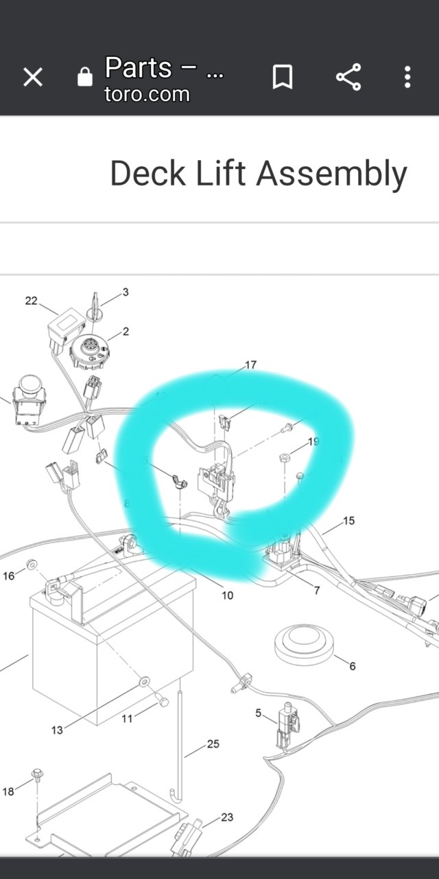

    Not trying to make you feel bad about your purchase on the machine at all with the above comments.
    I cannot stress this enough. Do not get that brake box wet and try not to get that harness wet either. We've had a few of those come in. For some reason those brake boxes fail. Our only guess is that water/moisture corrodes the wiring in there and in turn it fries the harness too. Every one we've had to work on had to replace the brake box and harness together.

    I want to see a diagram of this "break box".
    The commercial Toro ZTs I play around with don't have one...that I know of.

    I’ll pull something up when I’m back at the shop. They are only on consumer machines.
    It’s just an electric brake controller. No more brake lever. So you just start the mower up and move traction levers in. Brake box senses traction levers out of neutral via a switch I believe, and electronically turns off the brake. If you’re ever around one at like Home Depot and you have a key. Throw it in and turn to the on position but don’t start. Move levers in and out and you can hear the brake controller actuating the brake system.
    Also take this info with a grain of salt. While I am a toro tech I’ve never personally had to change the box or harness but I’m in charge of over seeing a few techs who did the jobs.

    Is this the brake box? I can see where that could be prone to water intrusion.
    Amazon lists the part for $90. I would think a little time with some RTV to water proof it would make the system more sturdy.Screenshot_20210611-111817_kindlephoto-81246131.jpg

    Negative. I just looked up a random timecutter. model no 75734 only one serial range on it. Brake box asm PN#138-2514

    Mind you these tend to fail after a few years nothing right off the bat in the low hour range.
