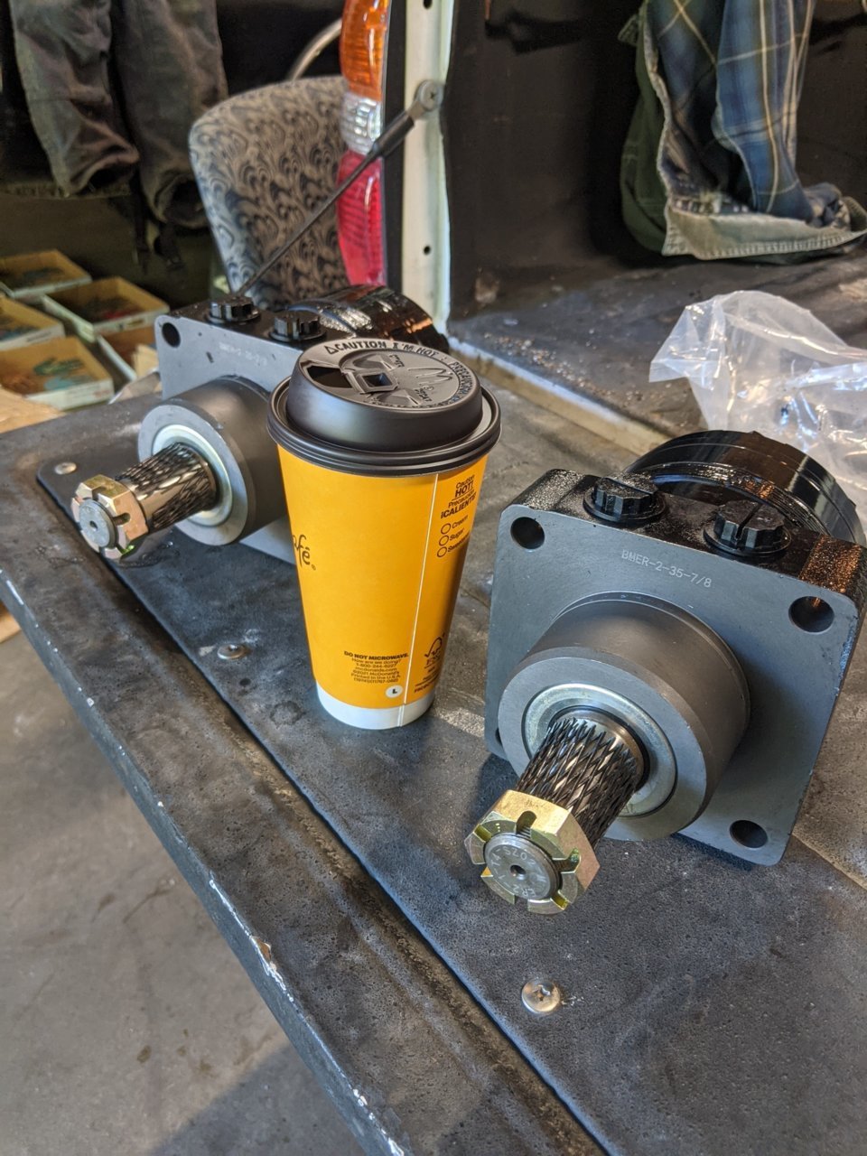

    Wheel motors?

    Ya!
    I just finished swapping them out and took it for a test ride.
    I think it's got weak pump yet. Fuck!
    That's a task for another day.

    got the wheel motors replaced. Found out the right motor was original and the left was a replacement already. After test driving I still have a chatter in the right side when switching directions . Pretty sure there is something wrong with the pump. It doesn't seem to have any power issues, but of course I'm very flat so I don't know if its really weak or not.
    Gonna order a pump and swap the thing out.
    More pics and ramblings to fallow.
