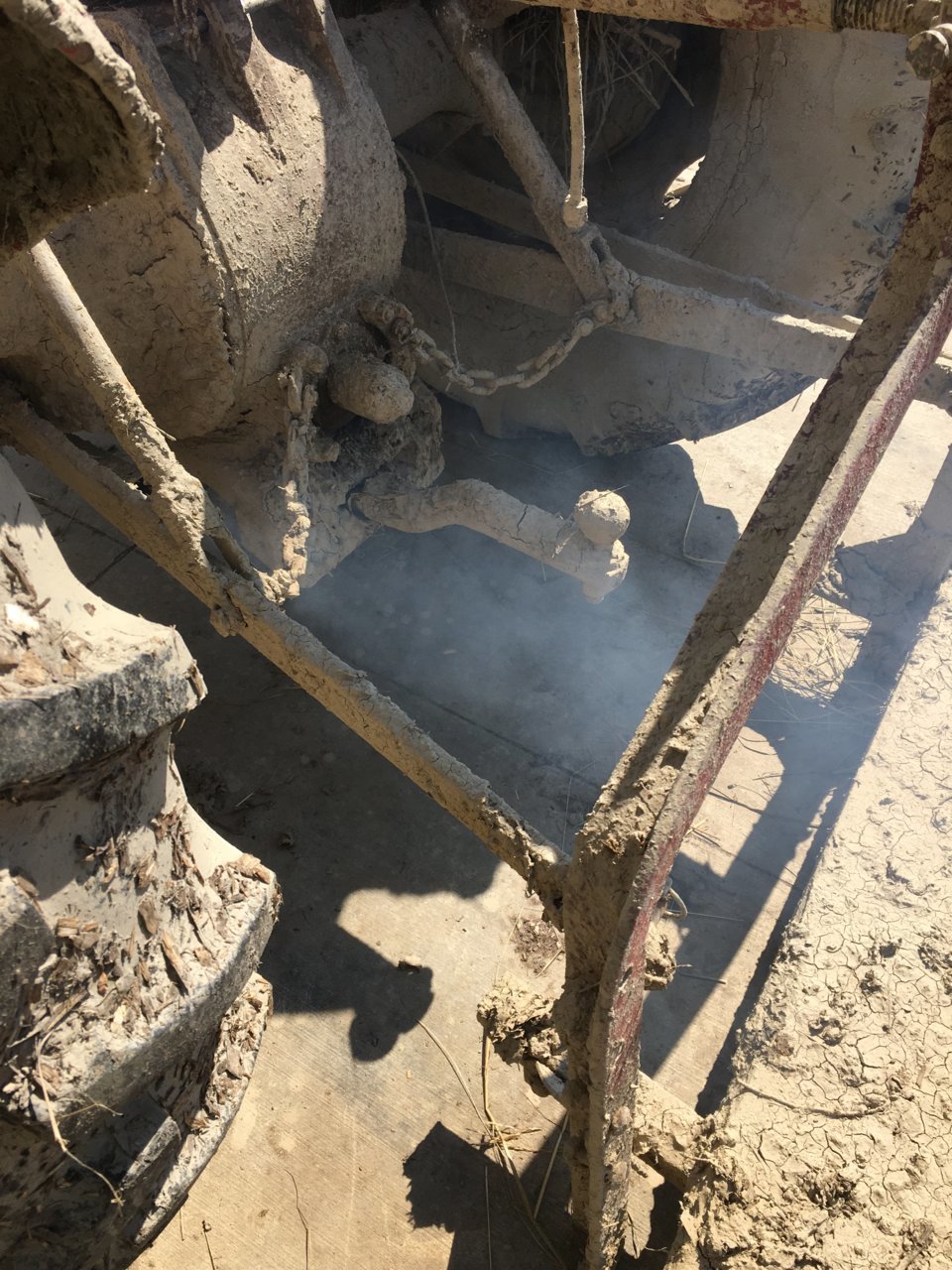

    Here’s a picture. Definitely more on the white side. Maybe I’m just thinking about it too much but it does sound to not be running as smooth as it did before. Maybe I should start with replacing the thermostat, and have the injectors serviced or replaced. I know nothing about servicing injectors or where to have that sort of thing done. I’ve read these injectors need periodic re adjustment, maybe that’s all this is. There’s a whole list of items I’d like to tackle on the tractor this year if funds and time allow. First thing is a good power washing once mud season’s over hah
    Btw my oil is always really black too. Even shortly after an oil change. I’m currently at about 50hrs since last change and the oil is darkest black. Not sure if that points to anything.
    I’m sure there’s a few oil things going on, it steadily but slowly leaks from the weep hole but not fast enough to worry. This is probably all just a bunch of minor things stacked on top of each other. My main concern is that the smoke stopped clearing right after it ran a bit hot and I caused damage that is beyond my current realm of understanding.

    Oil in a diesel turns black pretty quick after a change so I wouldn't be concerned about the color. Smell the oil and see if it smells like diesel, if it does then you could have a bad injector(s) and you need to address it. A bad injector can cause "washout". It puts so much diesel in the cylinder it "washes out" the oil and wears the bore/piston/rings out quick and the diesel dilutes the oil and it isn't good for the engine.

    Replacing the injectors with some good remanufactured ones will most likely be cheaper then having serviced and repaired.

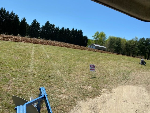

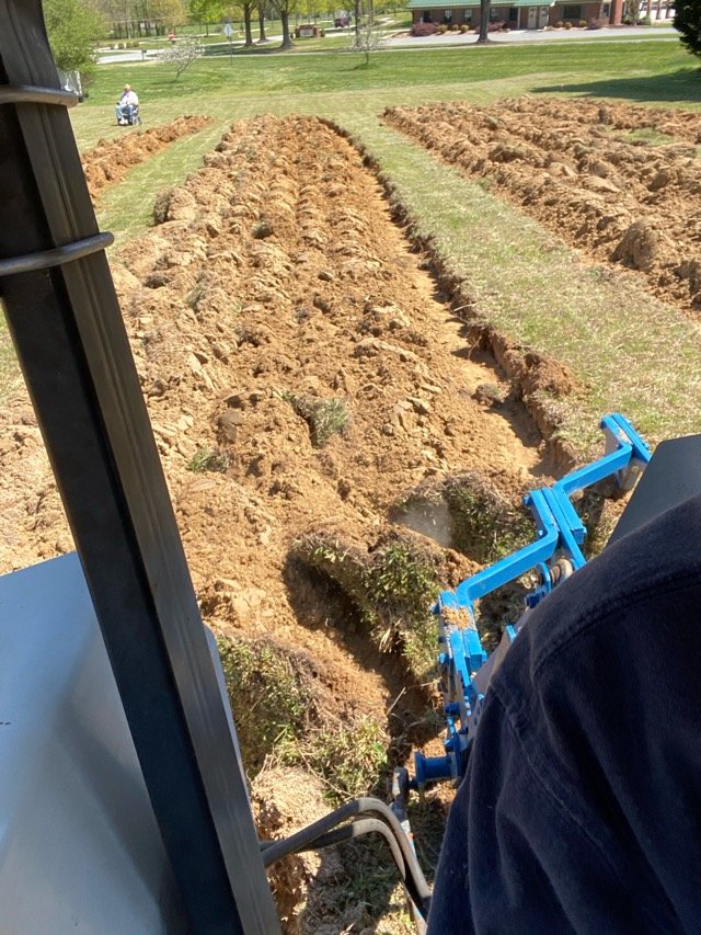

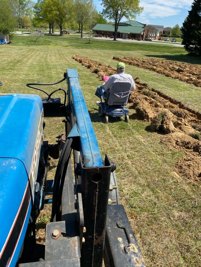

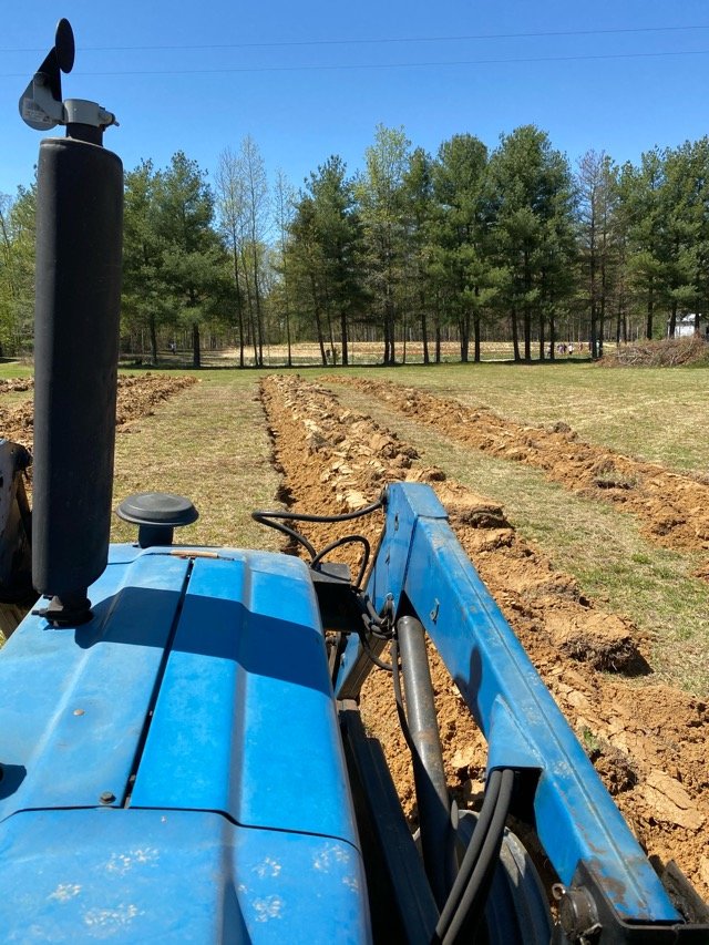

    My cousin has had a rough several years and he only has one leg. He came by today and ask me to plow 10 strips 10’ wide about 400’ long. He wants to plant sunflowers to sell. It’s right beside his tulip patch he’s selling them now. He had it flagged off and had fun riding around moving flags.

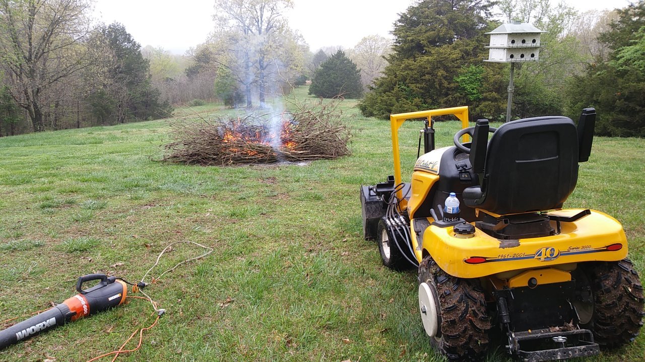

    Cut more sumac and built another pile. The pallet forks and pallet were the way to go. Hauled a bunch of 16ft long stuff with the rear bouncing because I didn't have my rear ballast---100lb box blade on with 70lbs of weights hanging on it. Below is a small load compared to what the wife and I hauled.brush1.jpg br2.jpg

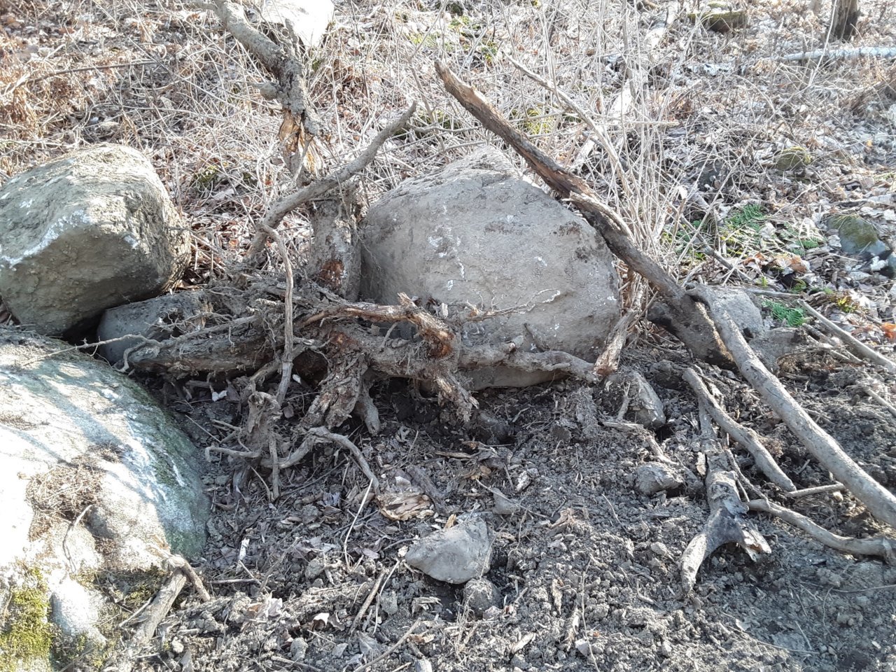

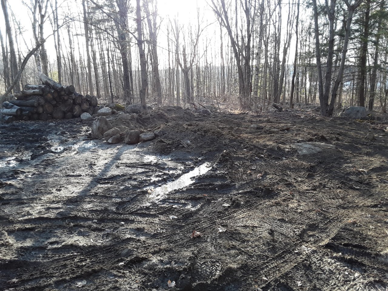

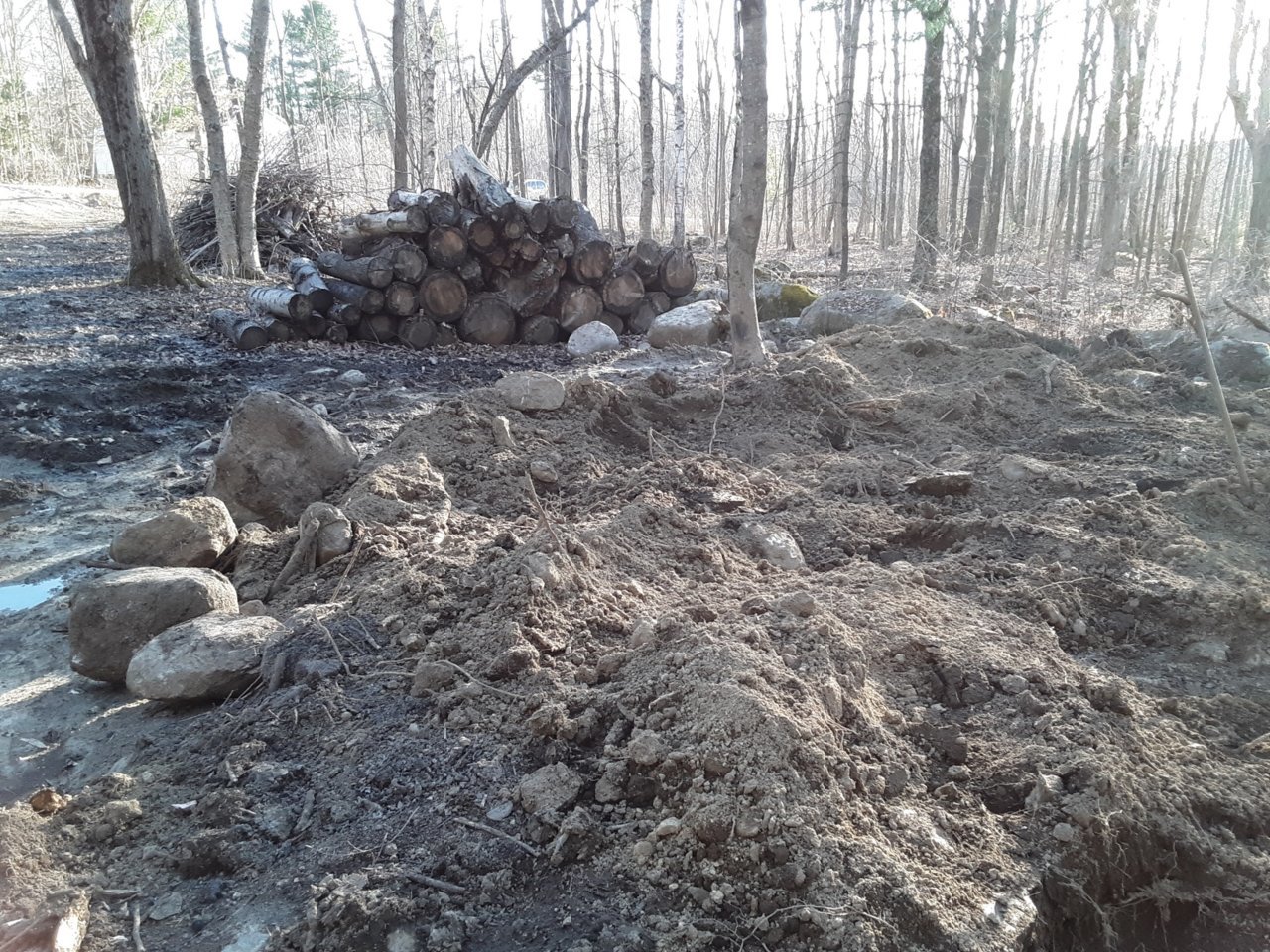

    Did some more on this over the weekend. Mostly just dug out & pulled rocks and stumps. It'll have to dry out more before I can move them all out of the way and start cutting it/leveling it to grade.
    I should have put something in there for scale; those are 3 foot rocks...
