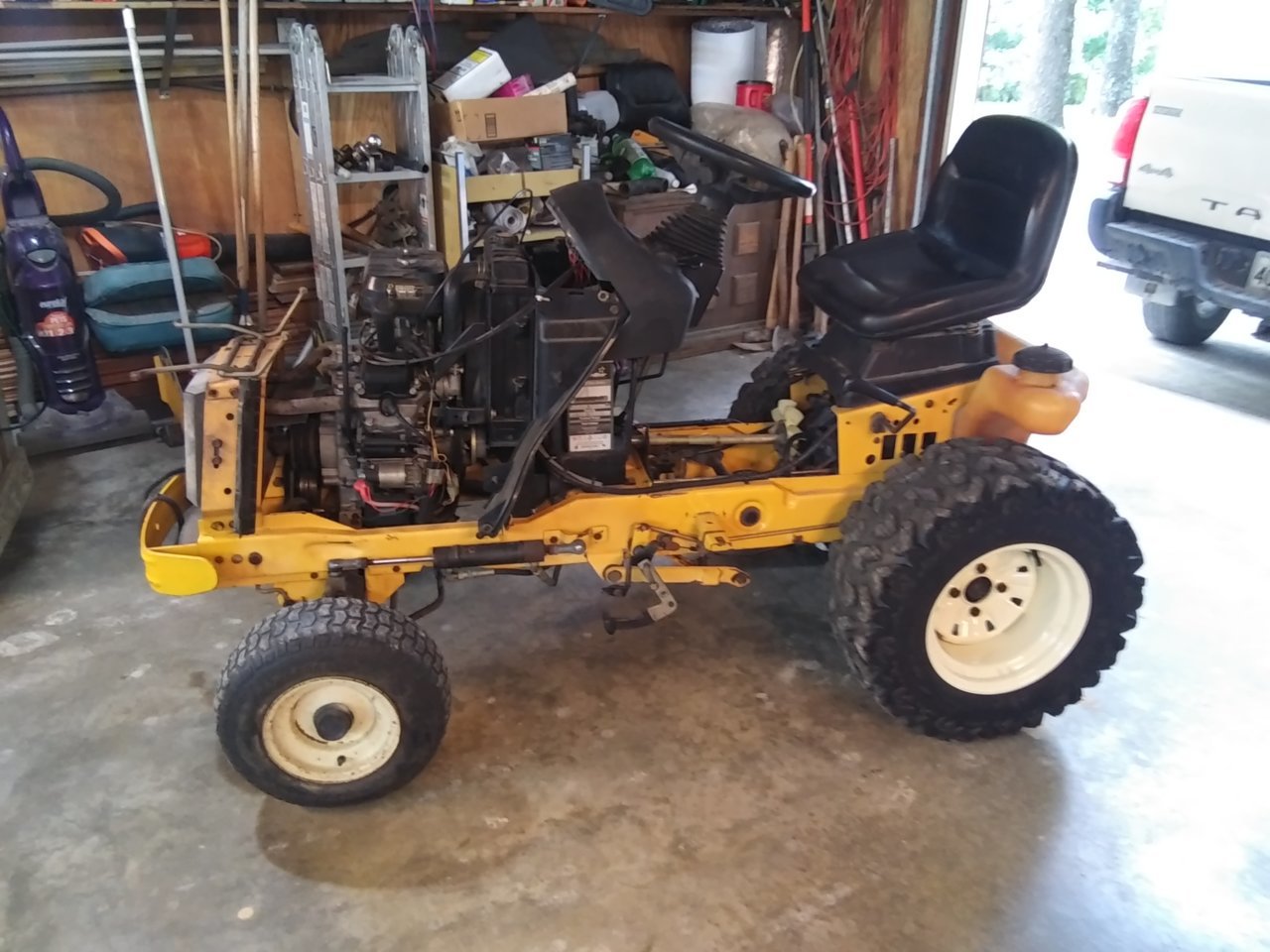

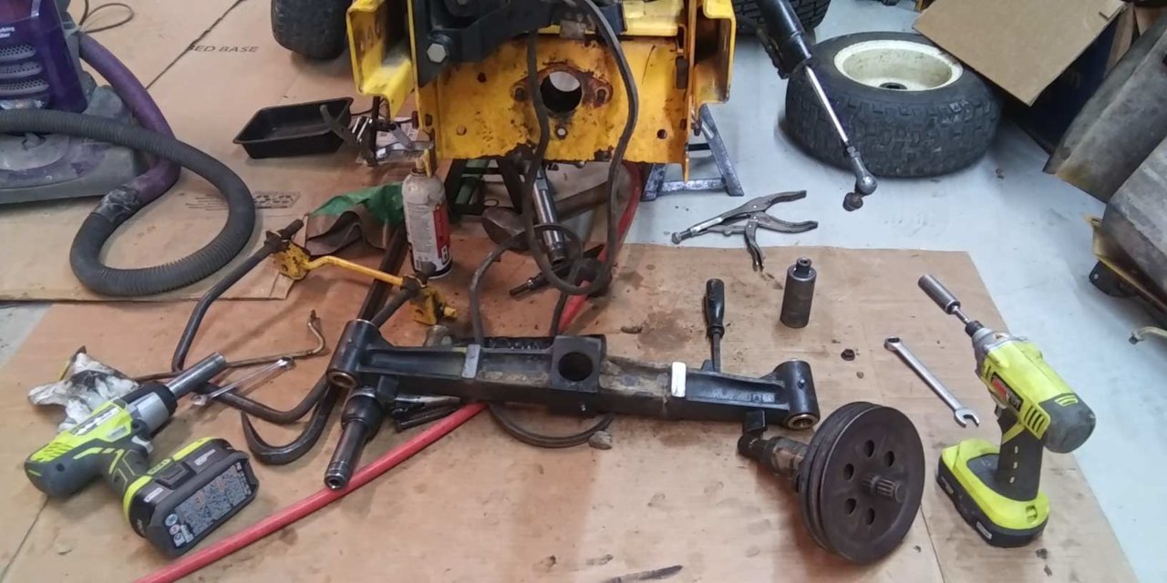

    My 3205 pivot bar has the PTO bearing housing inside it. It wouldn't take grease. People forget about it as it's under the axle. I decided to take it apart and clean out the caked grease after spending an afternoon with a grease hammer and no luck.
    It was a throwdown and I ended up getting out my $1500 USATCO monster .498 shank air rivet hammer and driving the stuck PTO out with a special driver that had a square drive for a socket on it. I put a 1 1/8" impact socket on it and drove it out with the rivet hammer. It did smear the inside of the bearing housing inward so getting that bearing out the rear would be a pain. I have no intention of taking it apart though as I was able to get the PTO to take grease and squirt it out both ends with a grease needle. Spins freely.
    The axle had dry carbon-like remnants of what grease used to be in it and I dug that out and wire brushed the bore. I'm dead beat and I cleaned up. I am getting to hate this type of work. I enjoyed fab more than greasy mechanic work when I worked for truck and trailer shops. I have to get tie rod ends.

    :eek: You the man! I’d probably would of said F-it :anonymous: then It would of bugged the shit out of me until I ended up getting grease into the fitting…

    IDK. 51 year old body with 20yrs of heavy eqpt repair mileage on it don't like crawling around on the floor much anymore.
    Man I gave this sucker a full day of messing with it before this. I built a grease hammer to run off an air hammer. A piston in a bore. Heated the axle with a torch, hooked the hammer to it which was full of 5W oil and tried to hammer it thru that zerk. Probably 1500psi of pressure with zero effect.
    The grease remnants were like carbon you hammered into the holes. Completely dry. Nothing was getting thru.

    Sometimes just biting the bullet pays off :fingerscrossed: one less thing to worry about and hopefully it did some good :thumbsup:

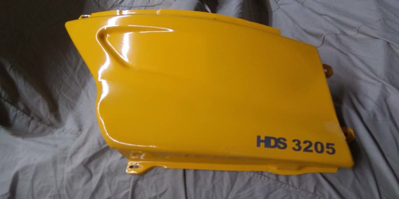

    I've been putting this off knowing it needed to be done. I was getting ready to swap out the spindles for ones I modded to take 4 lug boat hubs and wasn't gonna tear it apart without fixing this. I'm getting close on paint and decals and want this to come together.

    you know that things gonna be too pretty to use once you're done right?

    I know, I know. This GT pulls my brush hog thru tall field grass, sumac, and under tree limbs all the time. Gonna cry when I scratch it up. Maybe I just leave it nekkid and dress it up for pics. :D
