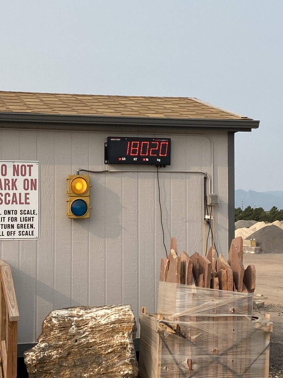

    Hauled some materials for my neighbor. Glad the yard has a scale. Their estimates on weight were a bit off. I had them take material off until around 18k.

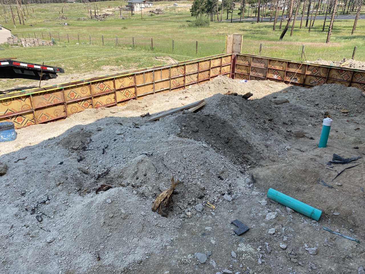

    Been working on the rear covered patio project. This has been the bane of my existence. Can’t wait until this is finished.
    Footer in and now stem walls. Then electrical/gas plumbing and pour the pillars and slab.

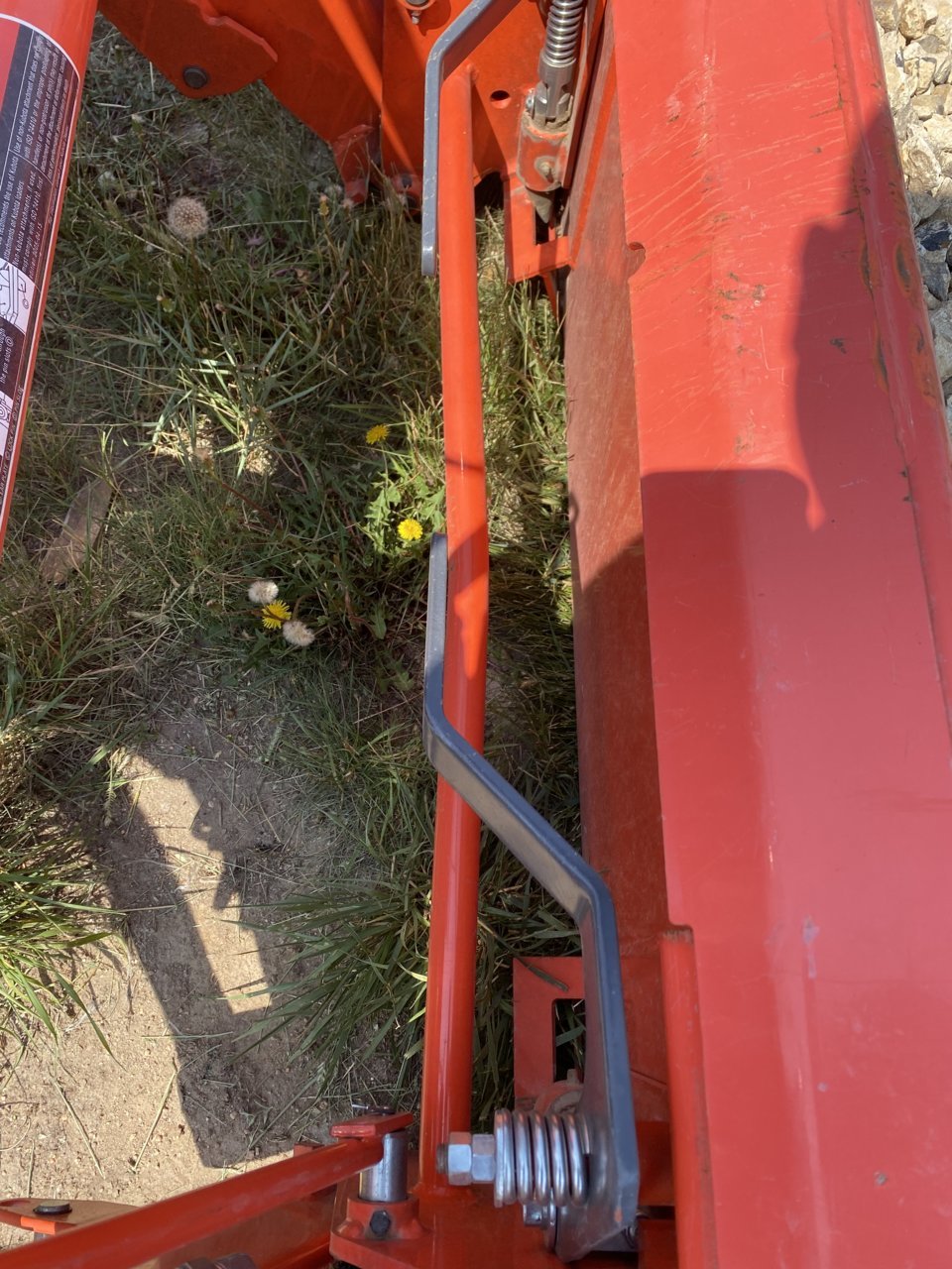

    Then I noticed this…..
    I am no longer allowing anyone to use my equipment. People just don’t give a crap. Now I have to repair this. I’m sure this cross sectional bar isn’t real strong, but once I get into it I can see what is needed to be done.
    I can cut this section out all but 1-1.5” on each end and sleeve with a bigger and thicker DOM tube, weld in place. Only concern is this piece goes through the loader arms. I may have to torch it out and replace. That is a lot more involved. I’m almost ready to do an insurance claim.

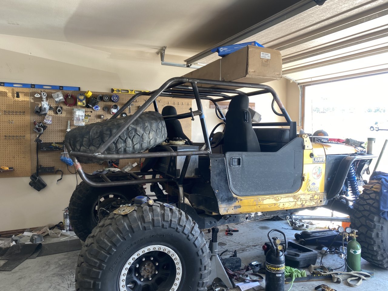

    On my free time been rebuilding my crawler (back half, cage, re-valving shocks, etc).

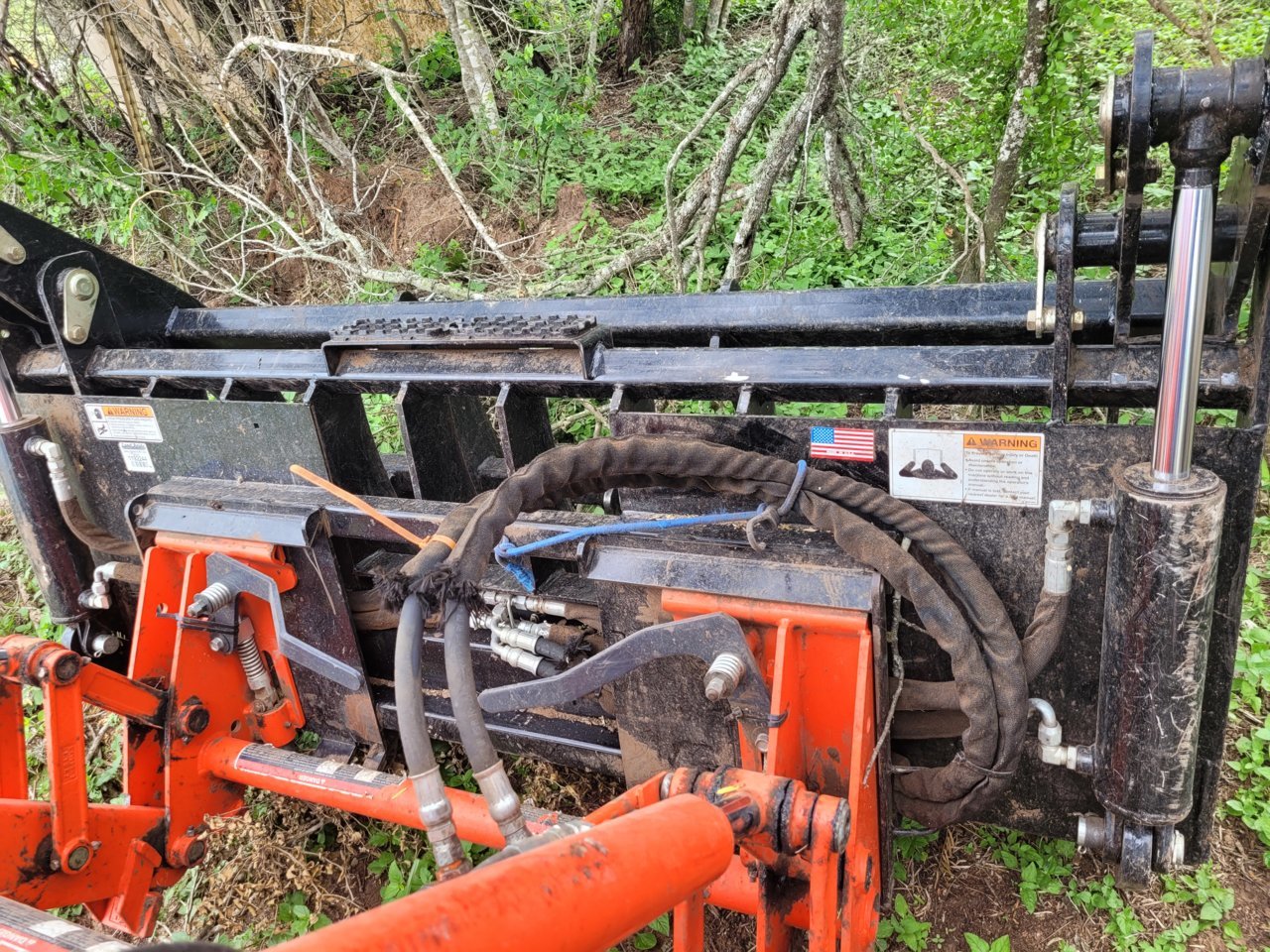

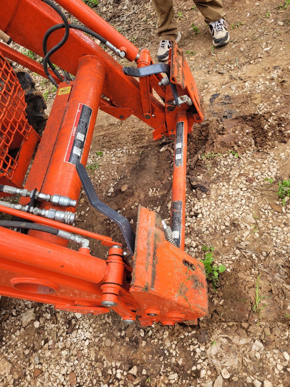

    That tube is engineered to bend, (think of it as a fuse) meant to bend before bending or damaging the lift arms/cylinders, do not replace with heavy guage material.....
    Kubota service will just bend it back, but this is the second time for this MX5200, so I paid $250 insurance claim to have a new QA put on, I will be able to keep the old QA for back up.
    Wood stabs push those QA arms, next thing you know your losing a 2K pound load and it bends it.
    My brother has done this twice, I now put 160lb tie wraps on the arms.
    Bent.

    It's possible they put a strap or chain and used it incorrectly as well.

    some damn good tech right there. Thank you for that!
    my framer used a chain around the bucket and bent the shit out of this.
