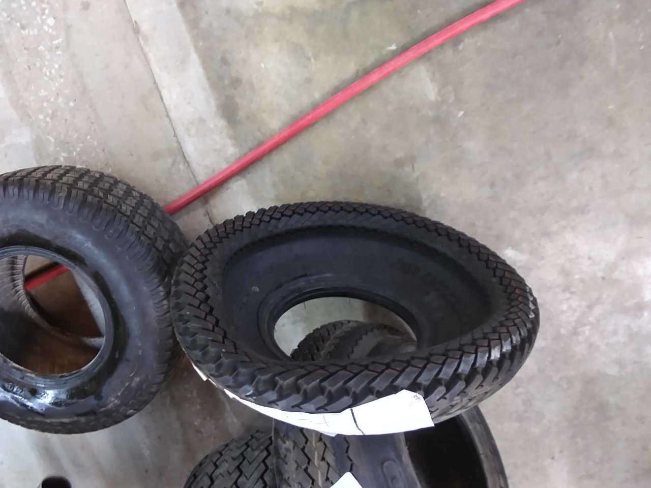

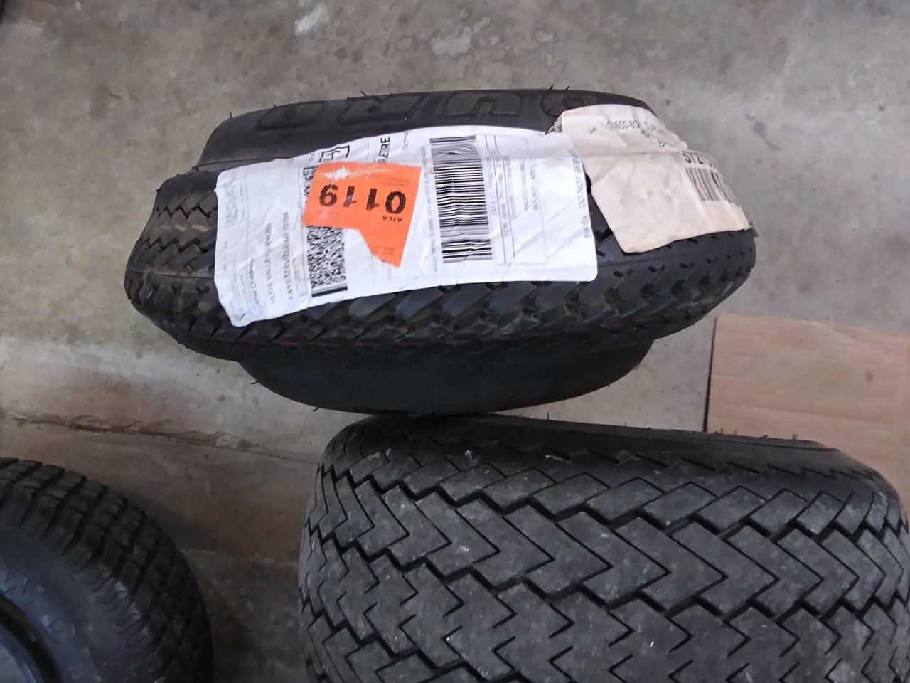

    Got some 18x6.5-8 6-ply golf cart tires to replace some junk WDT tires that I cant keep inflated. The vendor had these flattened and banded to the point of me not being able to get them to even pop out away from the cup once mounted. I put a tube in one an aired it to 50psi just to seat the beads. I put a ratchet strap on the other and can't even get the crown down. Any suggestions?

    No. I could not get the beads to even pop out. The tires were cupped on the rim like the pic. I put a tube in in an attempt to get the beads to seat. I don't want tubes in these

    One is seated with a tube in it--only because that was the only way to seat the beads. I want to remove the tube but am scared to break the bead. The other is unmounted with a ratchet strap around the tread. The strap can't even mash that crown down. They bent the steel wire in the tread banding them like this.

    Never seen tires look like this ! I’d return them… o_O
