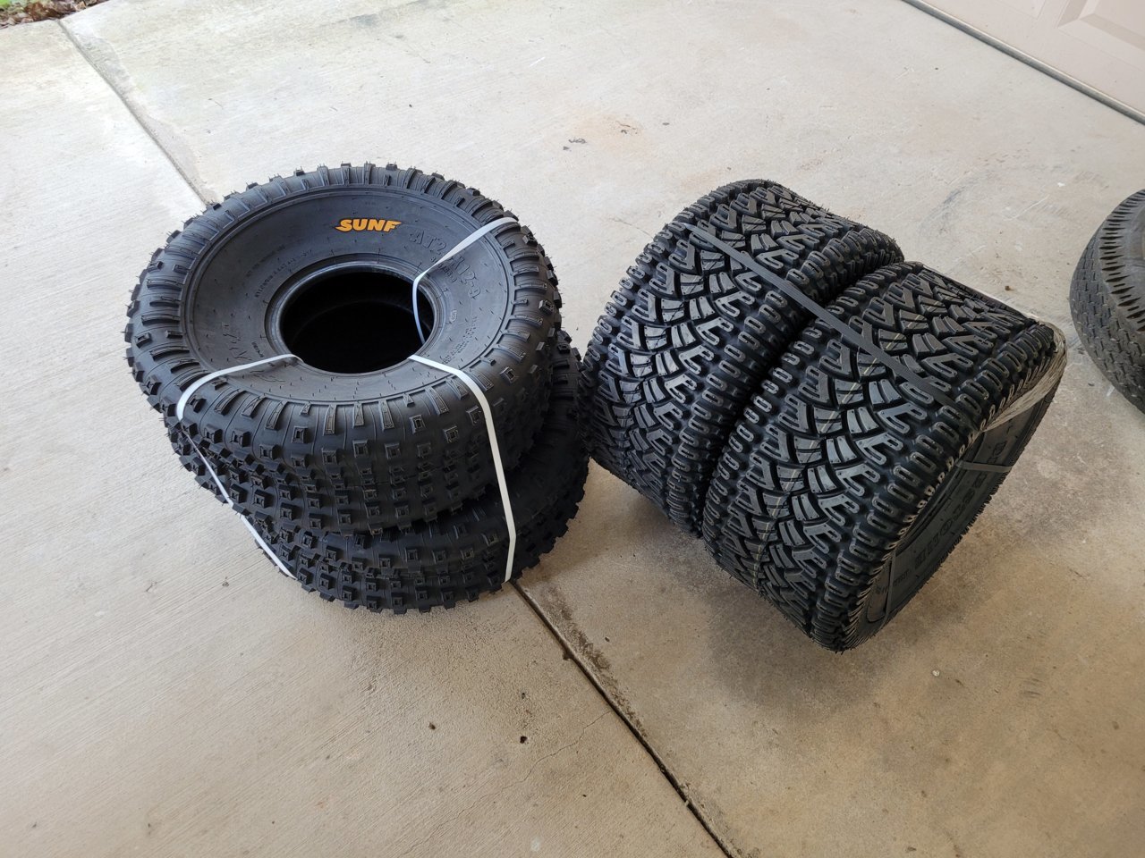

    And with all this tire talk my FIL drops this shit off at my shop for one of his projects I'm working on. He didn't even buy matching lugs :crazy:.

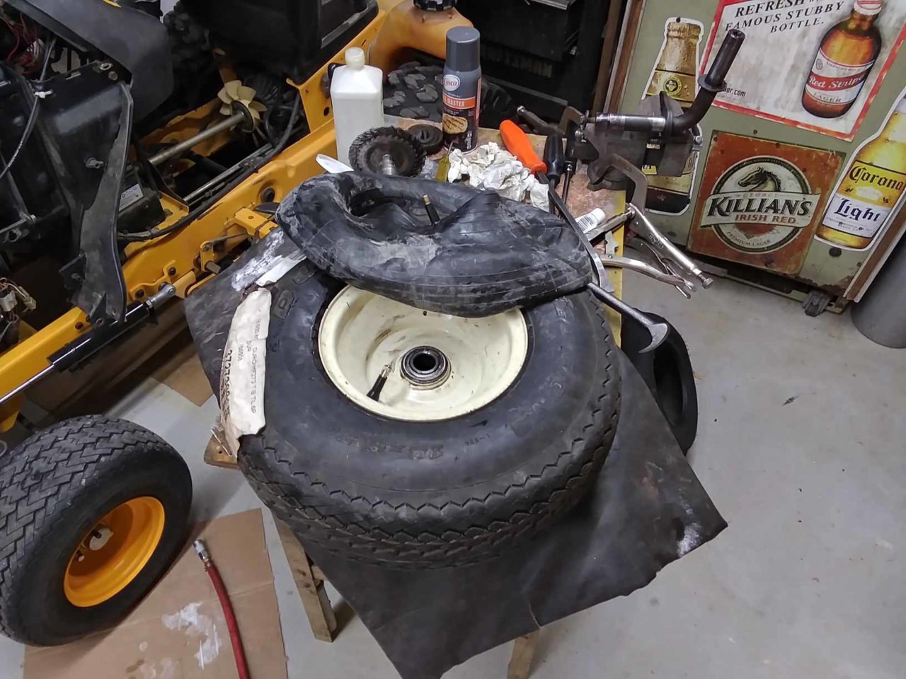

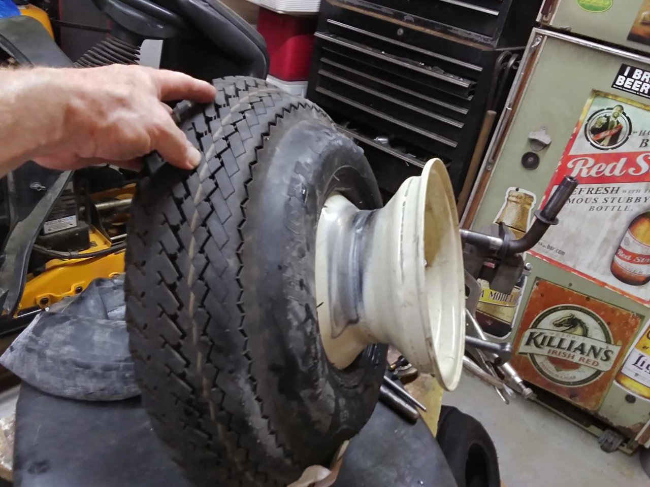

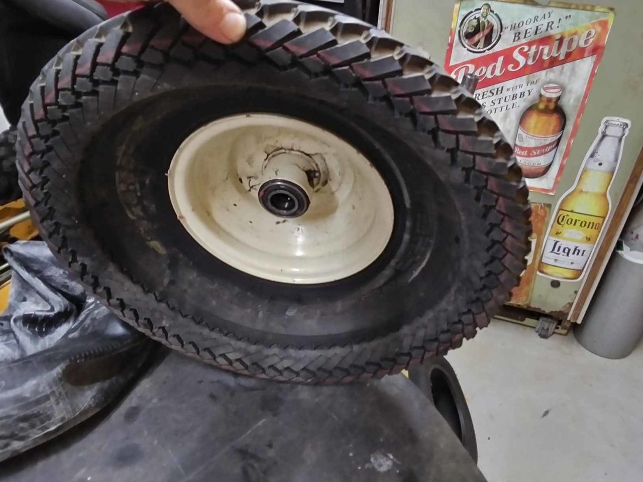

    There was no way of getting any starting fluid inside the tire due to the extreme cup it had. The problem was that the tire was flat as a dish when on the rim with no way of popping it out. I deflated the tube and broke one bead gently tonight and pulled the tube out, pulled in a stem. I always air without a core. I did tire work in truck shops for years.
    It popped back into a dish but the bead was on the back of the rim so tight I was able to push the rim down and the dish came out and the bead seated. I'll follow the same procedure on the other. Could have sent them back but I'm stubborn.
    20210827_190943_HDR_compress80.jpg 20210827_190948_HDR_compress21.jpg 20210827_191503_HDR_compress28.jpg

    good deal, even those were a PITA to deal with.

    This was a "you will NOT break me."
    moment. Must say I was almost ready to throw in the towel when I had 60psi in the tube and the beads had not yet seated though. I was inflating with a rubber tipped blow gun.
    Deflated and bumped it around then tried again. Beads were well lubed with cooking spray. I don't figure anyone but me would ever get these inflated at home. IDK if tire shops deal with this regularly or not.

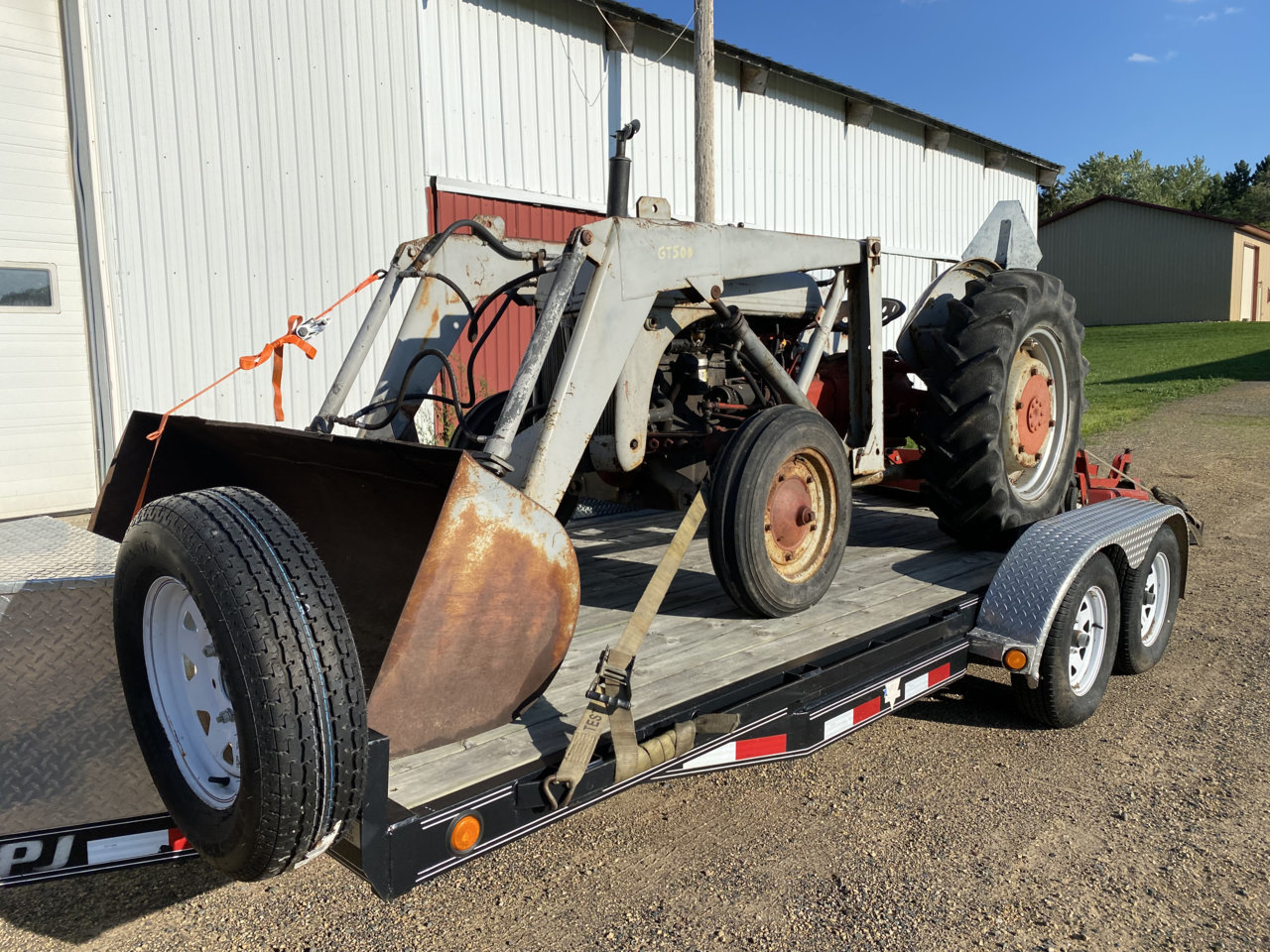

    Went and bought a thing today from a guy up between Eau Claire and Minneapolis. Ford 9N that has a Sherman hi-lo range with the loader, finish mower, snow blade, clamp on forks

    Holy shit, is that Derek's (Vice Grip Garage) tractor!?

    It sure is! It’s the ole GT500. He’s moving next weekend and shipping it was going to cost as much as the tractor. Super cool guy to meet and talk to. He was actually out using it to cut the grass for the last time when I pulled up

    Does it have power steering? If not, that's the only drawback to a loader on the old Fords.

    No power steering but not planning on super heavy loader work so hopefully it’ll work well for me. Driveway maintenance/moving skids around/tree work/shuffling trailers type of stuff

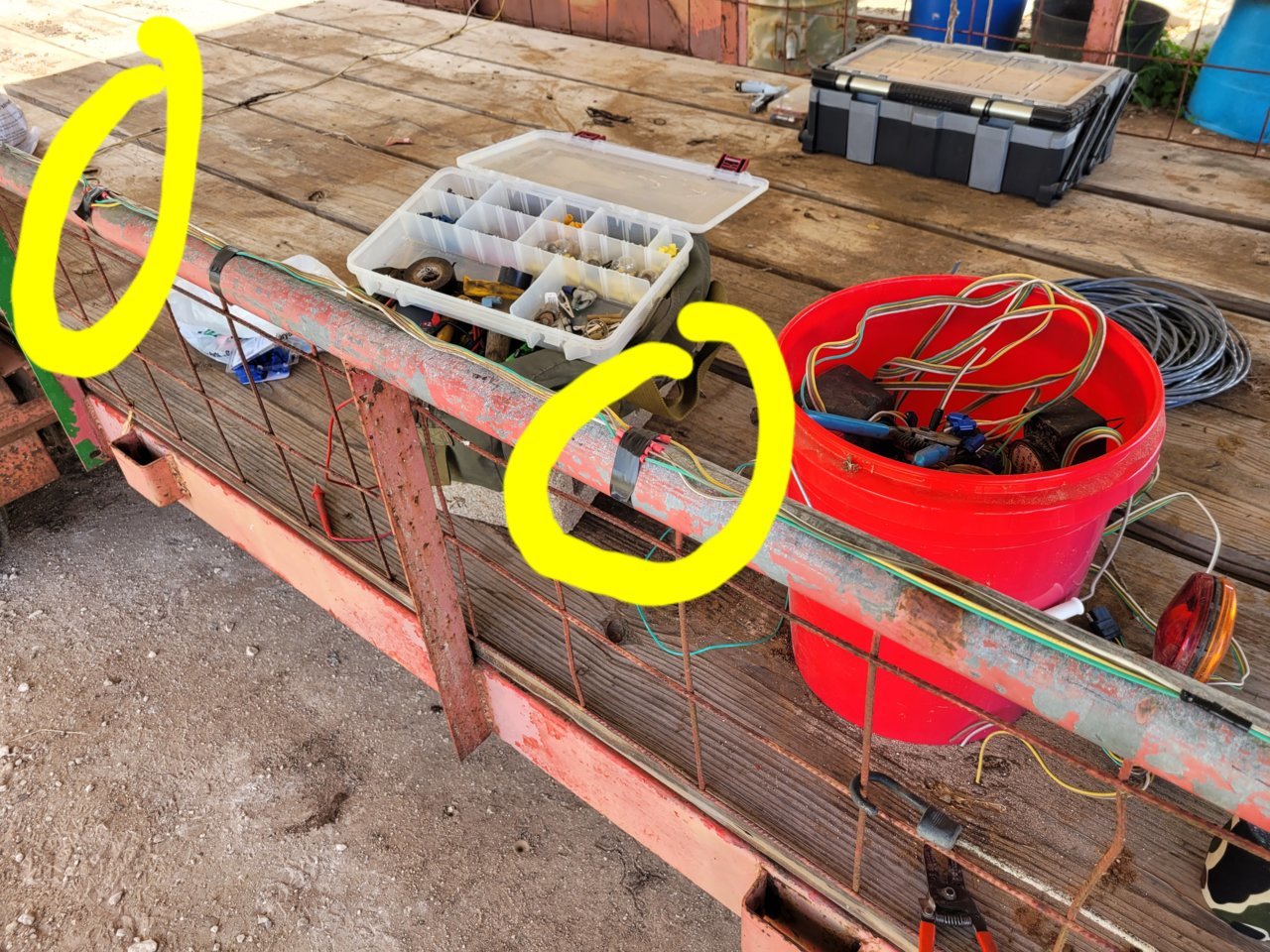

    Did a temporary fix on a set of magnetic lights, so I could bring this farm trailer home to work on it. 5 new shoes on order and new jack stand, and it needs all new wiring.
