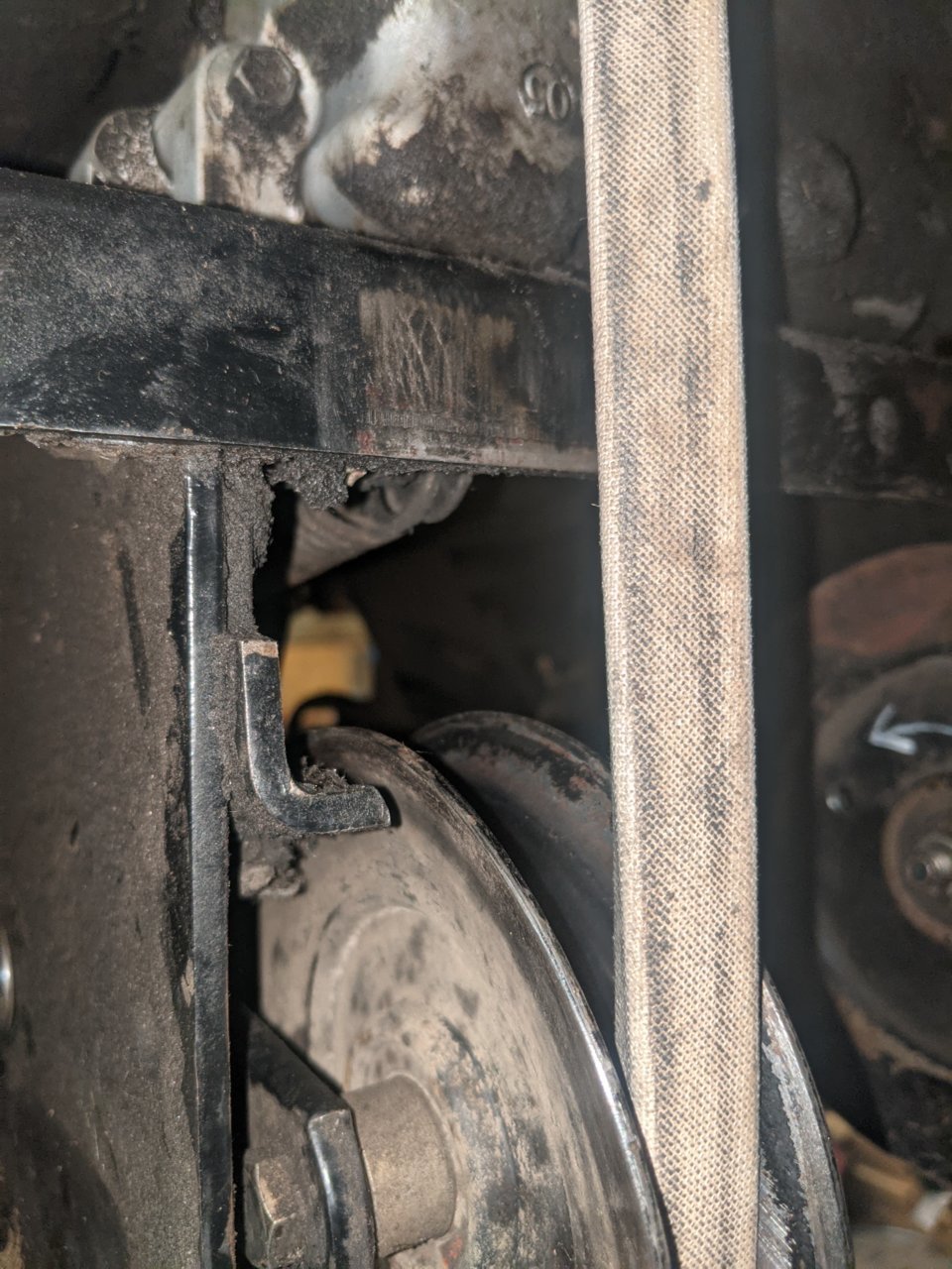

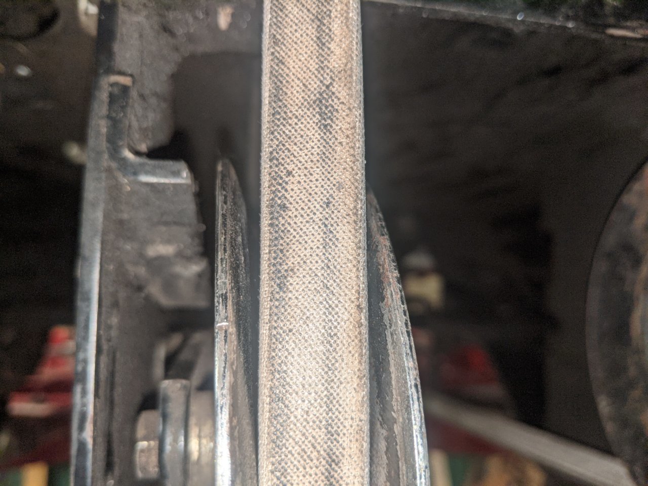

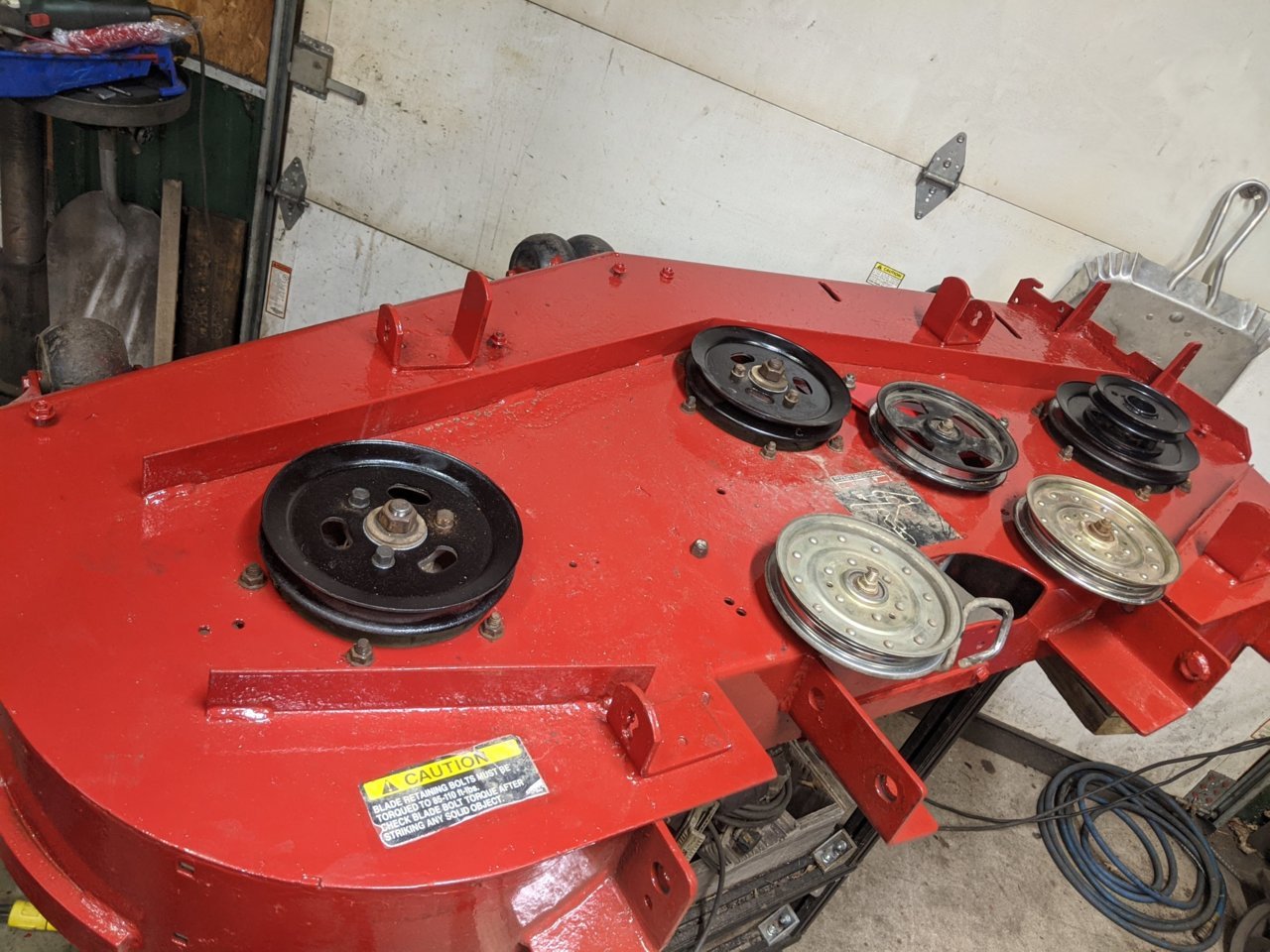

    Got the Toro deck installed. Still need to order a couple anti-scalp rollers.
    Took it for a test ride and am still hearing a weird, clutch noise sound. Kinda metal on metal, but every 1/2 second intervals.
    Was outside running it and saw Sparks coming from the idler tension pulley.
    Someone bolted the idler arm to the frame without the required spacer washer.
    New spacer washer and this thing purrs!
    After washer installed pics show the corrected position.PXL_20211212_203941559.jpg PXL_20211212_203916981.jpg

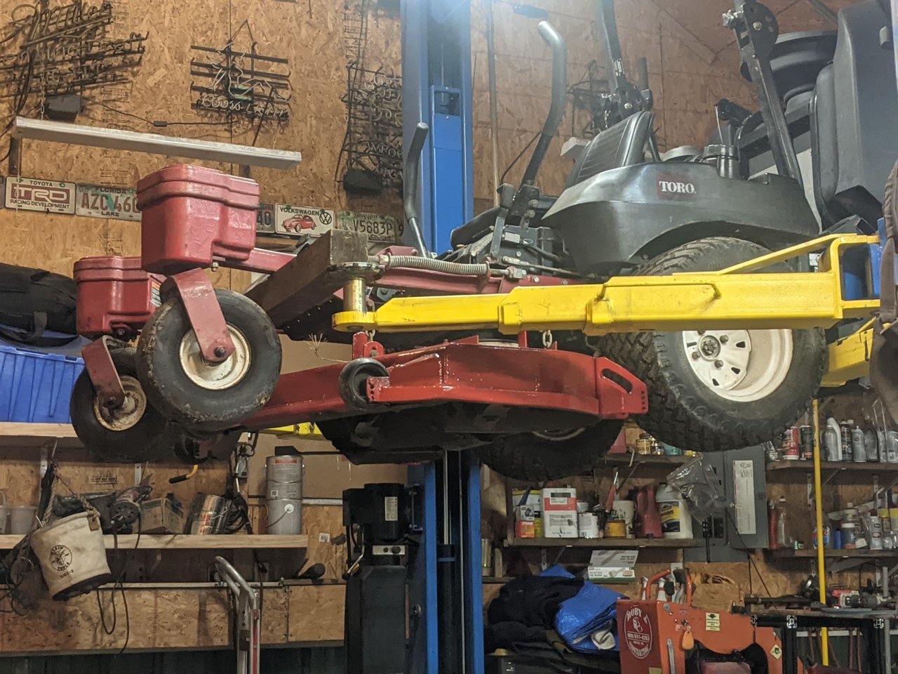

    Installed deck after I rebuilt it. You can see the missing rollers.PXL_20211212_203744056.jpg

    I wonder if the previous owner peddled this cheap because they couldn't find the source of the noise and just assumed it was the engine?

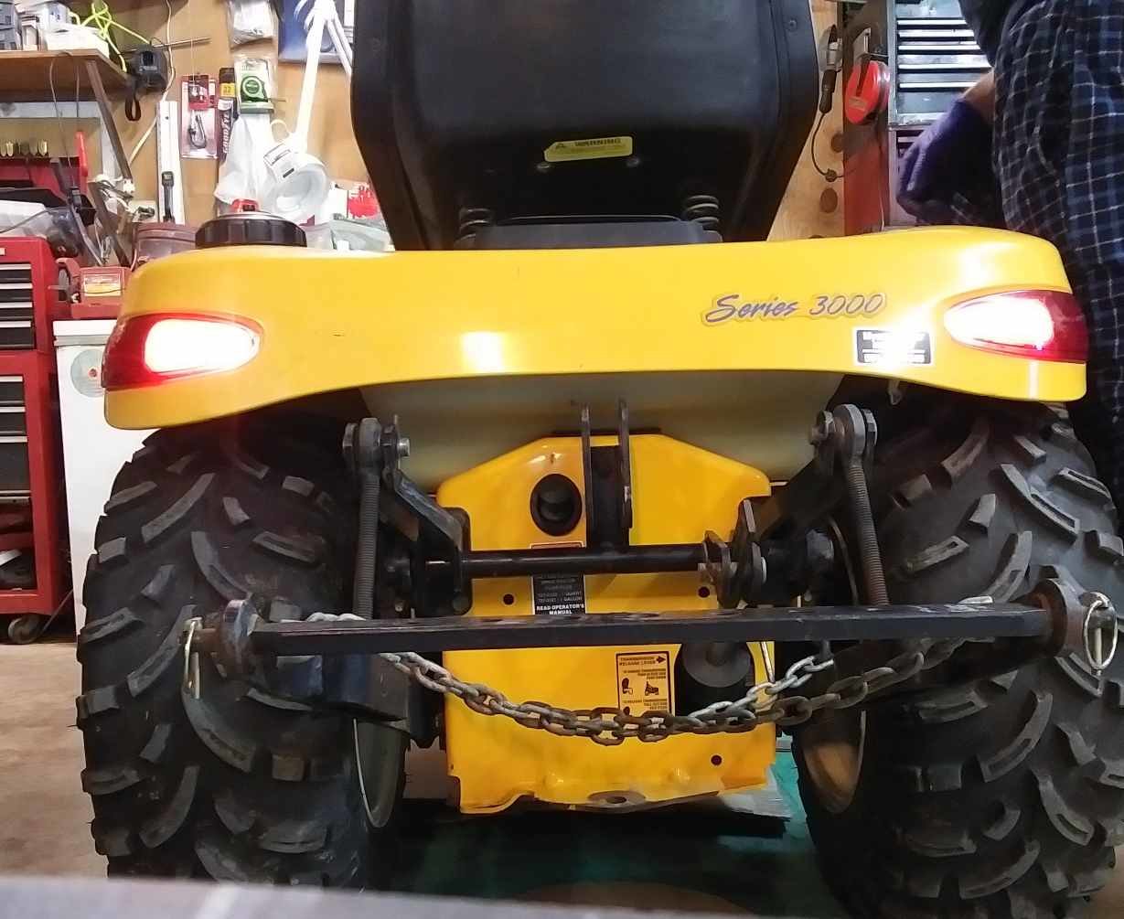

    I piddled around a little after the inlaws left. Got my back up lights working on the 3225. Lol on a GT with tail and back up lights. :D

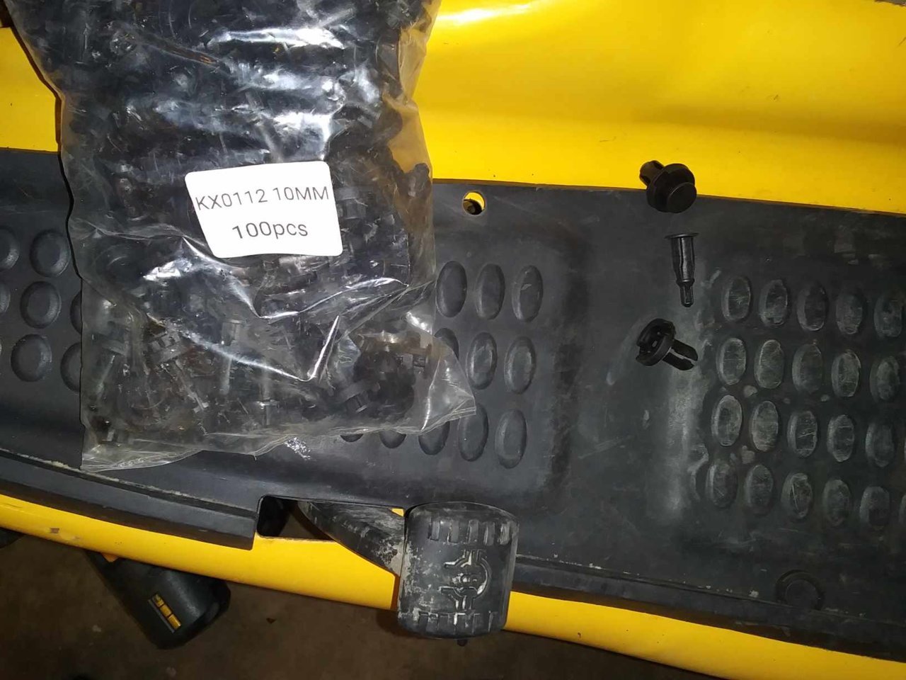

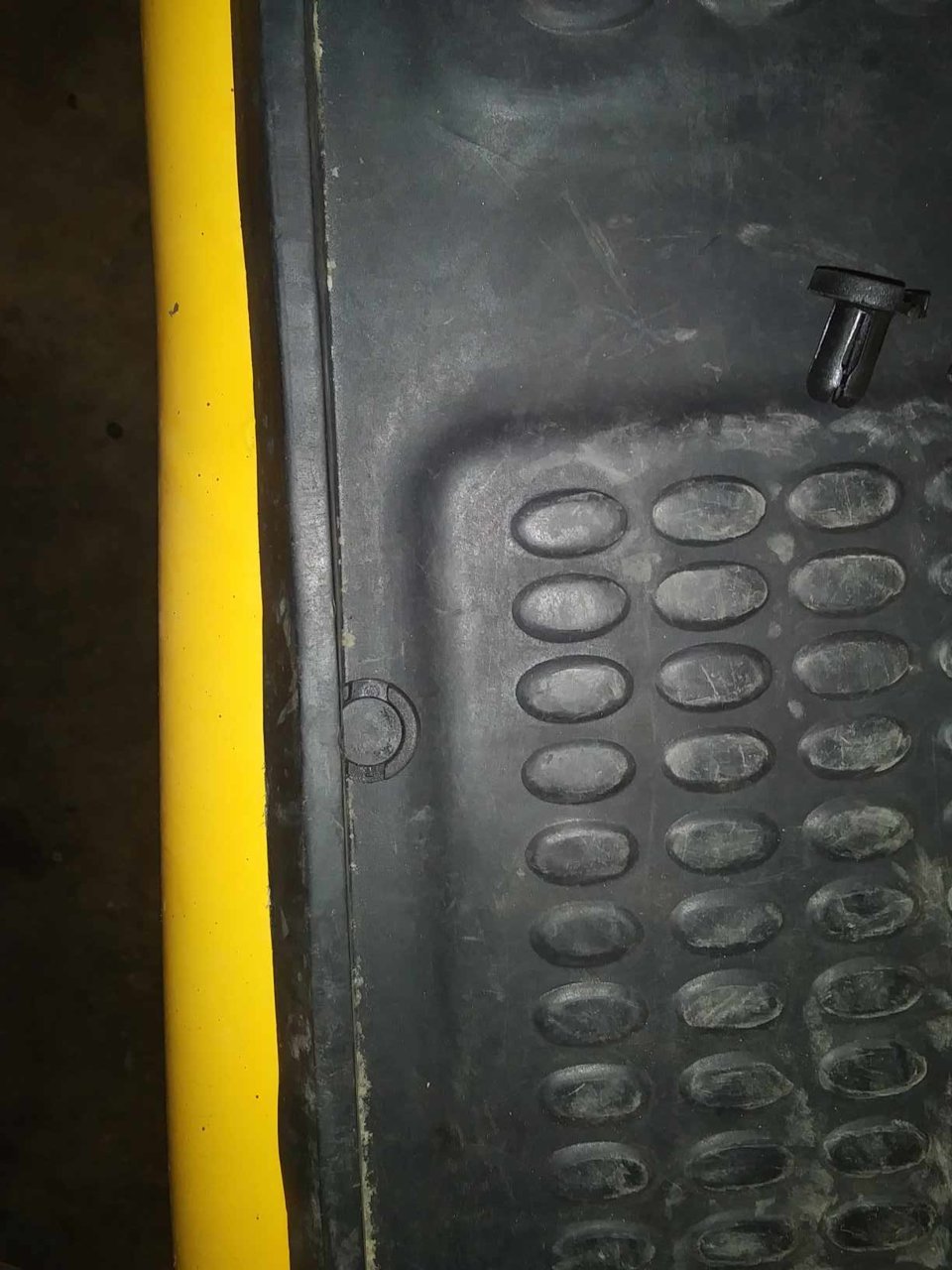

    Also put a few drive rivets in the footpads. The factory has sprues molded in on the bottom that dry up and break off after 20 years or so.
