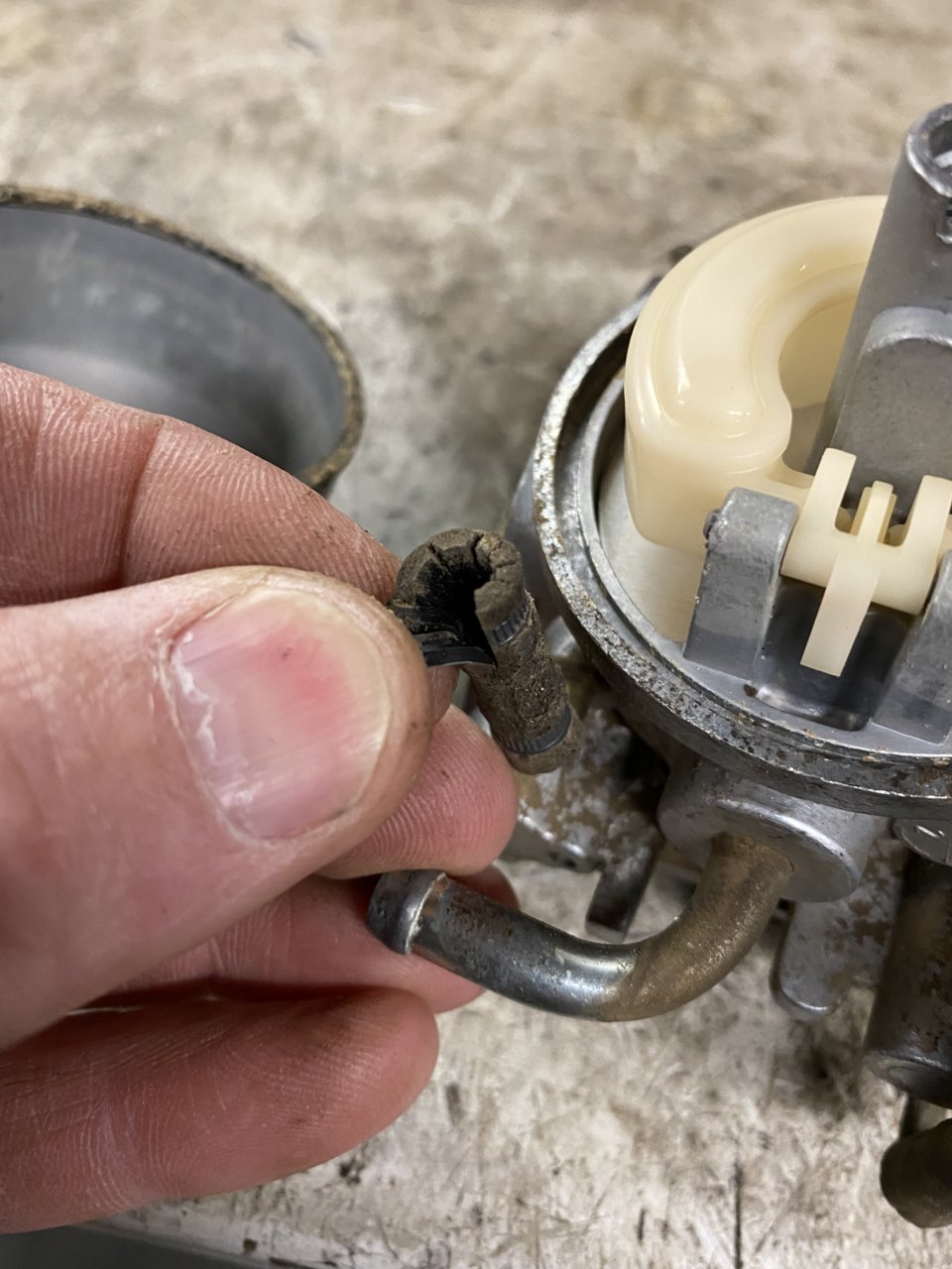

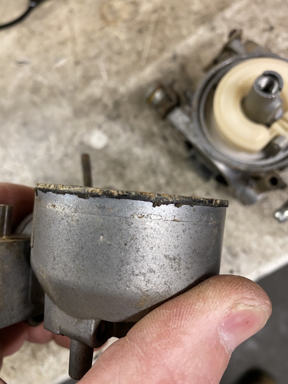

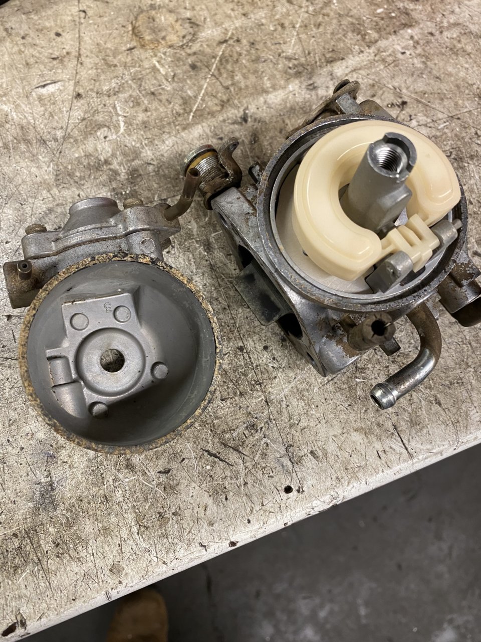

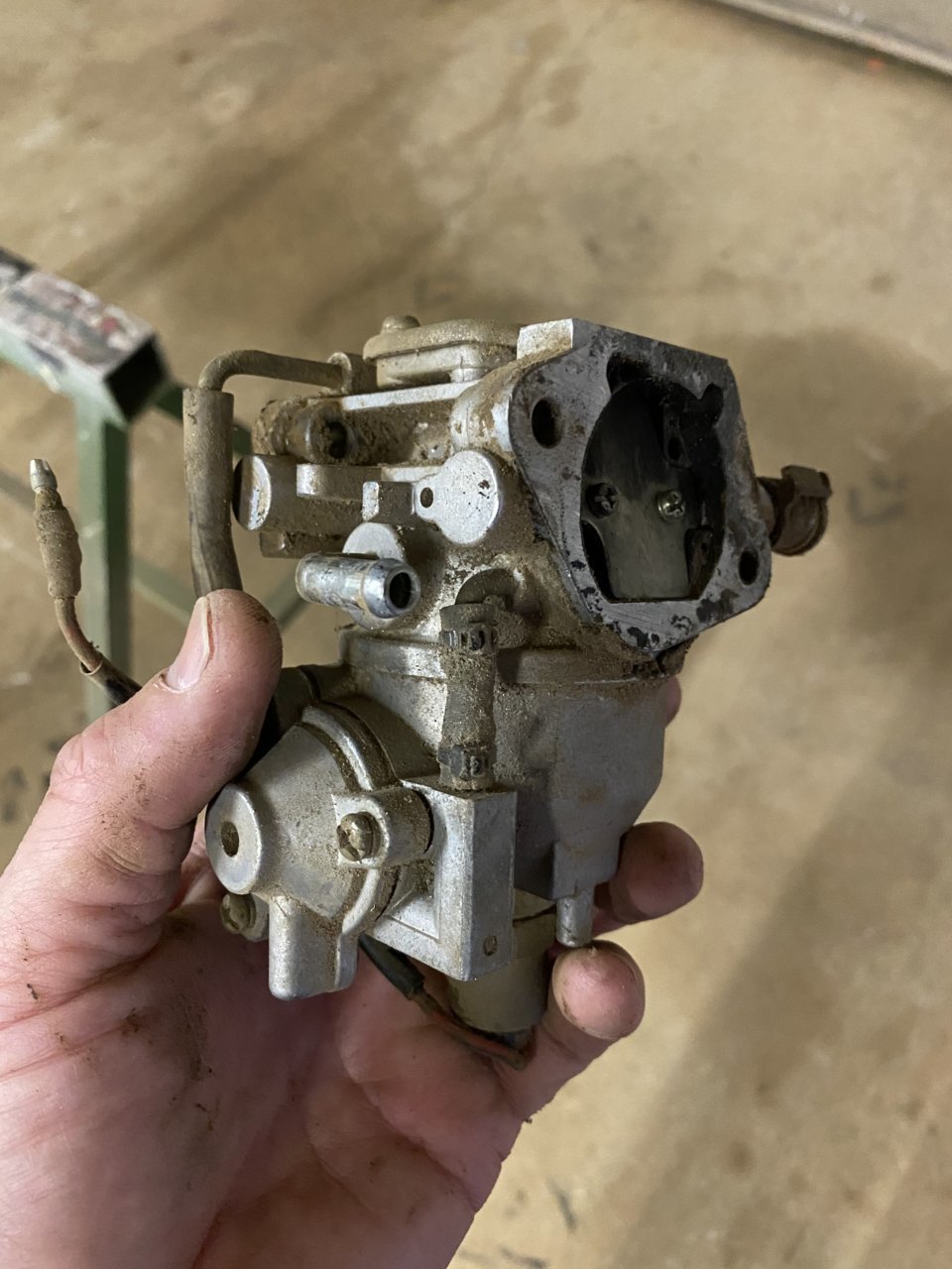

    I opened this carb up and it’s surprisingly clean. I did order a bowl gasket for it though, it’s toast. Also need some hose for the accelerator pump.

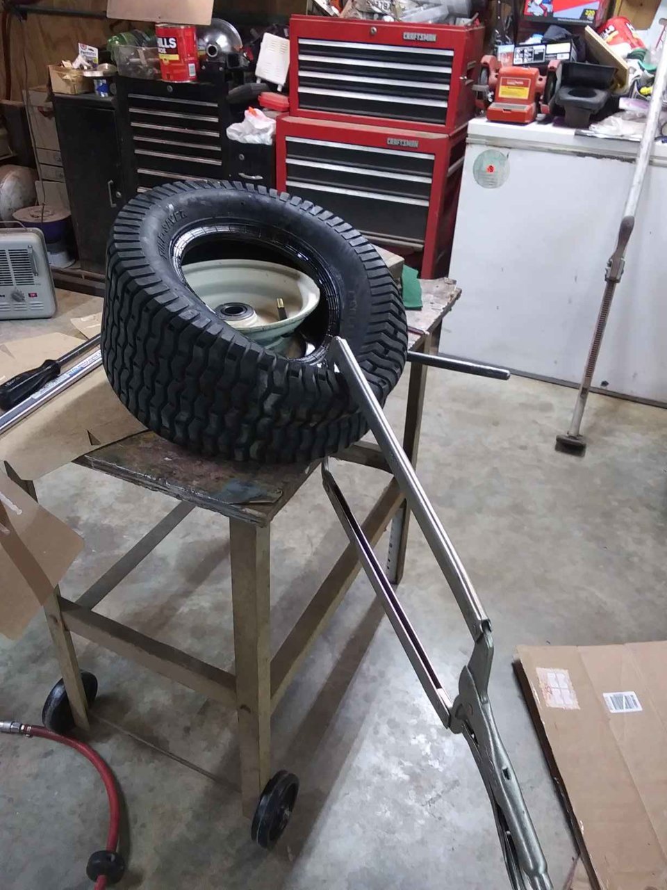

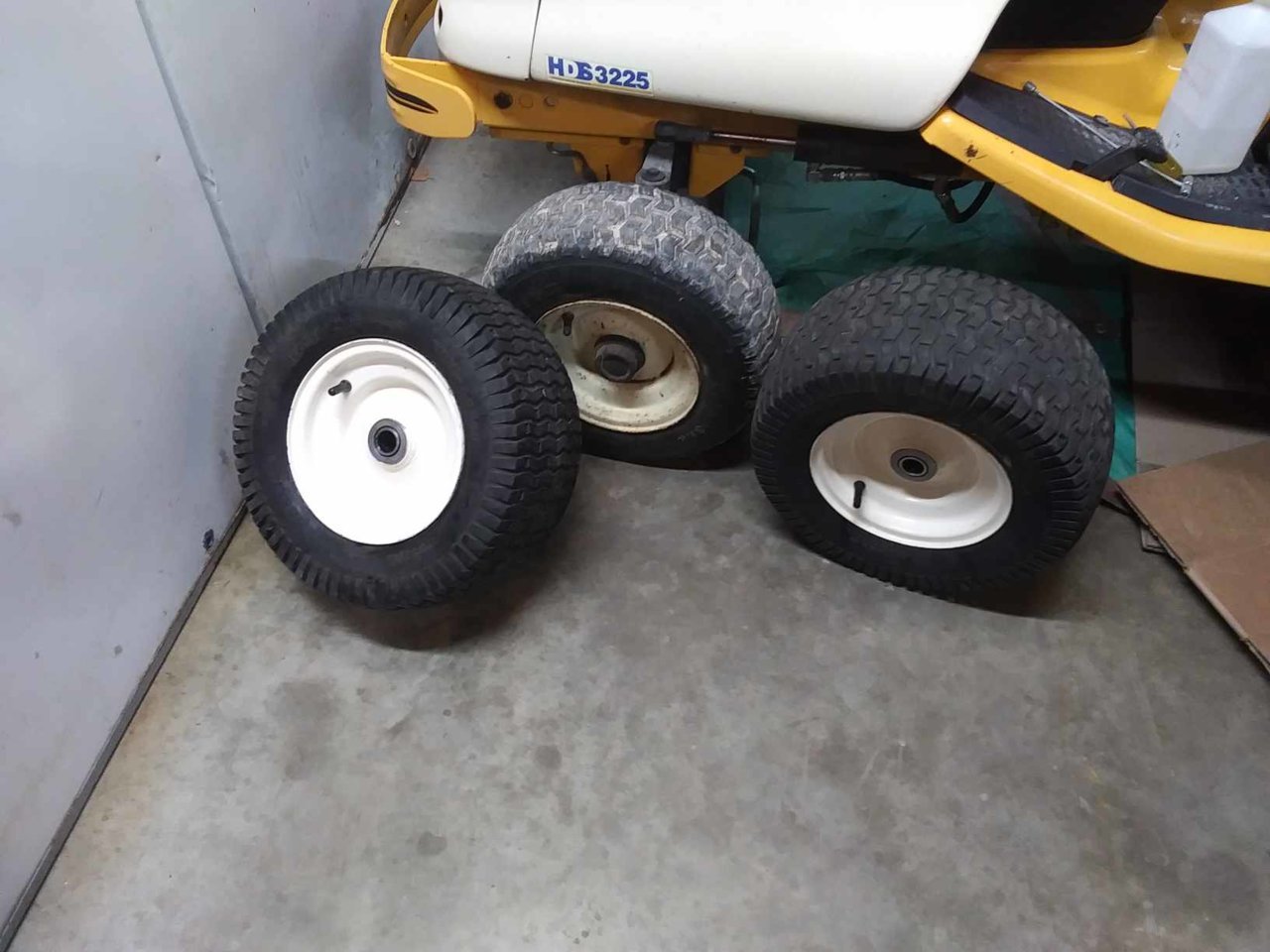

    That looks like something I need :D, mower tires are a p-i-a.
    The second line of the Amazon listing actually says "handy as hell!", you have to admire good ad copy people. :laugh:

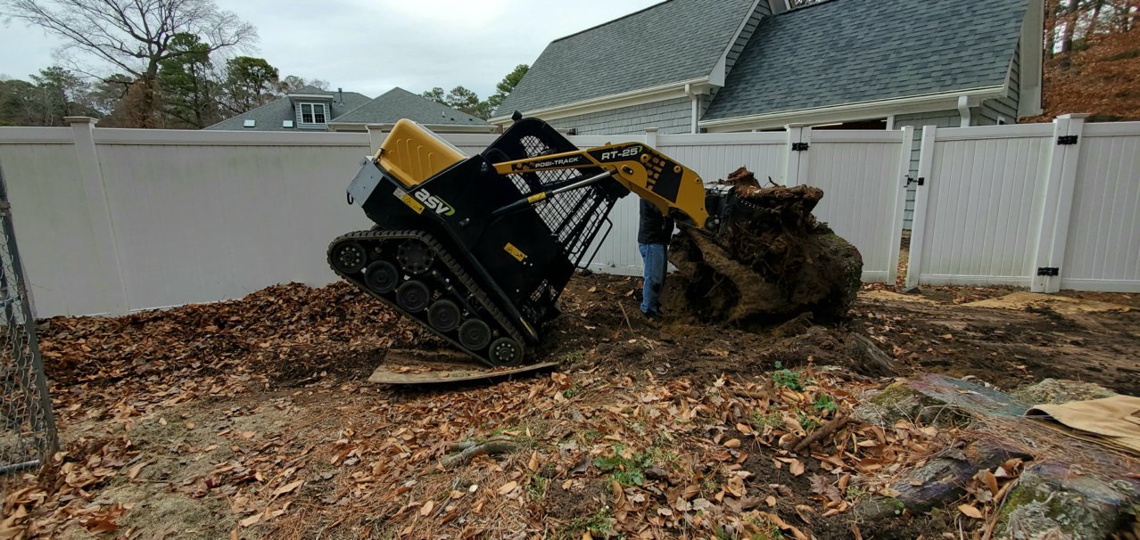

    Should've gotten the 40hp version...great balance though (and yeah I had the anti-collapse bar installed) 20211227_133106.jpg
    Gave my dad half of his "Christmas stump removal wishlist...lots of hand digging, cutting, sawing and we did get it out and moved back into the woods.

    Before I found this tool I used a mini c clamp with a small scrap of leather, but it tends to mar up the rim paint if it's fresh. This tool is much gentler on fresh paint, but you still have to be careful

    I use my International 140 as a bead breaker on the mower tires.
