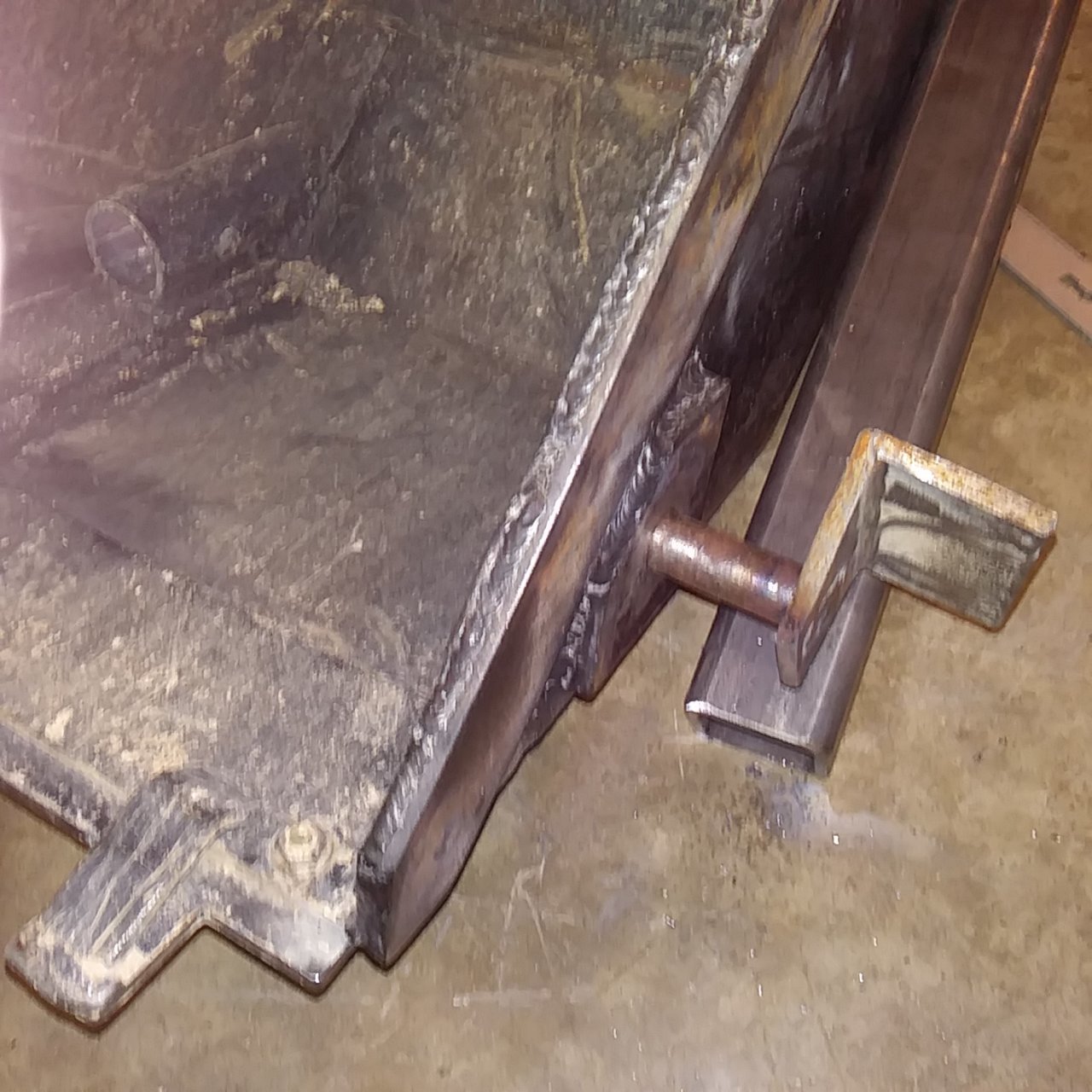

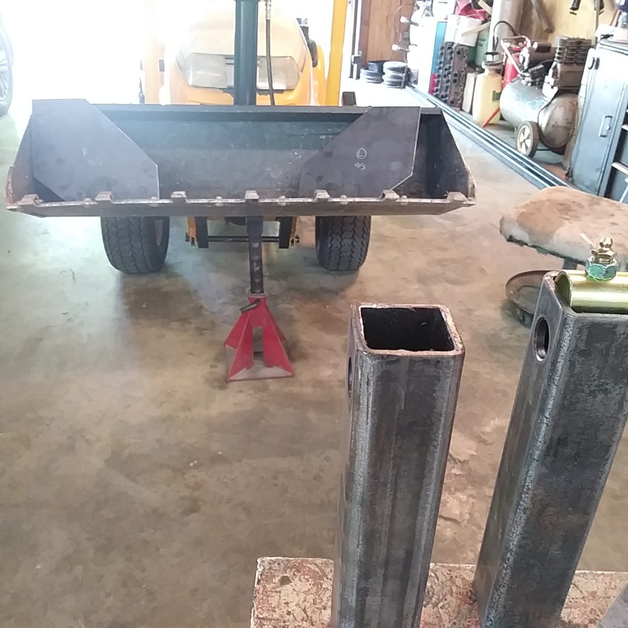

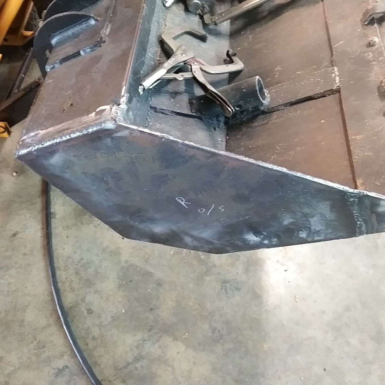

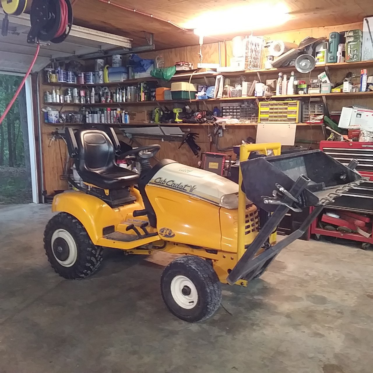

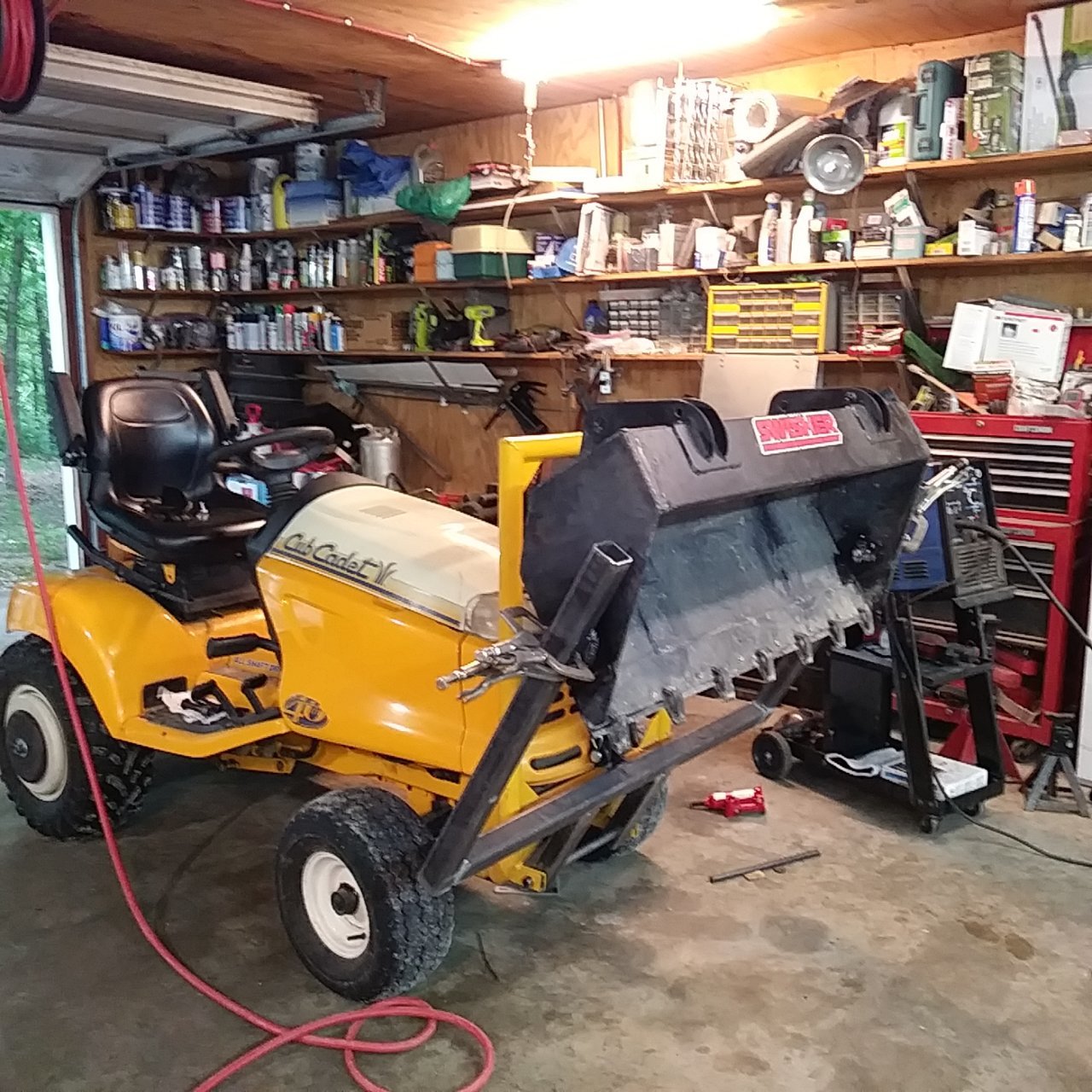

    My little GT loader has one flaw. It won't dump from any amount of height due to the original swisher design of being a trip dump. I'm moving the dump pivot forward and down to get my dump height high enough to clear my trailer side rails-->32".
    Cut out and welded 3/16" plate on to the sides, 1/2" pivot blocks, and a 1/4x2" plate to the left top where my curl cylinder will mount. May get 40" of dump out of her. Fabbing the arms now.
    That weld on the 1/2" block is about as good as I could ever expect my Miller 130xp 110v flux core would ever do. 20200430_165312.jpg 20200503_122951.jpg 20200503_123107.jpg 20200503_151106.jpg

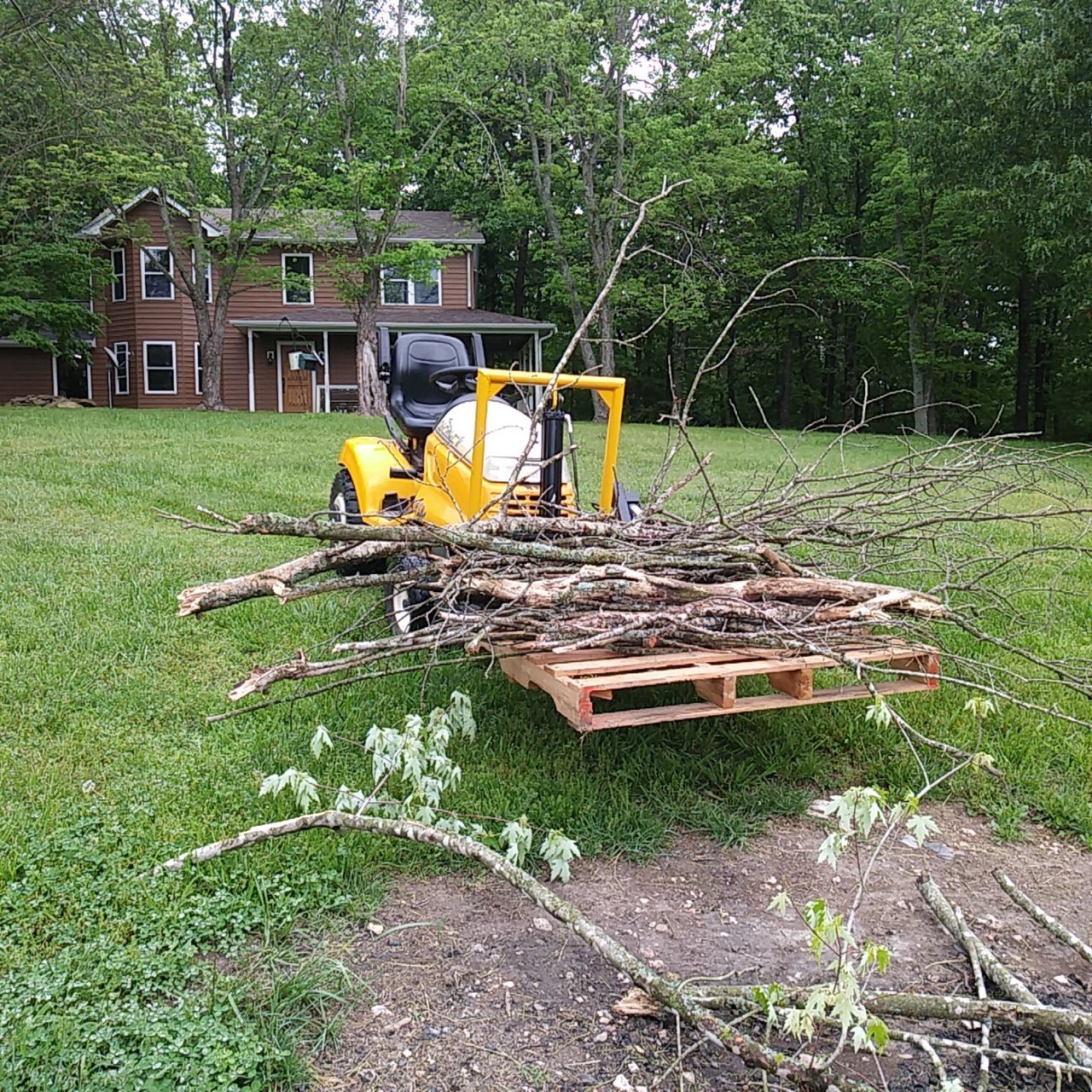

    Hauled limbs that I pulled and sawed down after a storm the other night while the bucket is still together. I could feel the added weight of the steel I welded on the bucket today.
    I really like the forks and pallet for limbs. Long stuff lays nice and small stuff goes in the bucket. Much easier than the dump trailer.20200503_174834.jpg

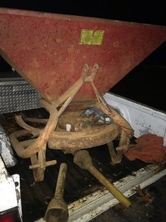

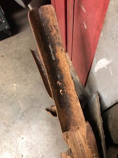

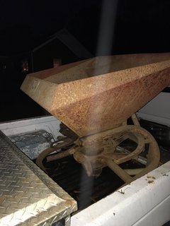

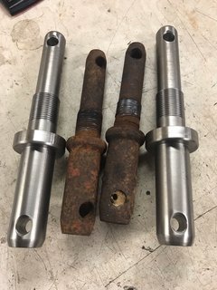

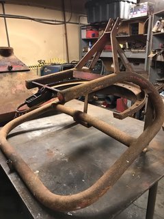

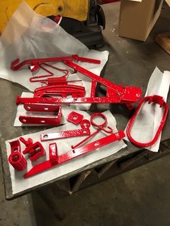

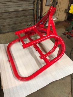

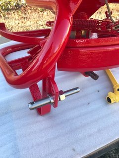

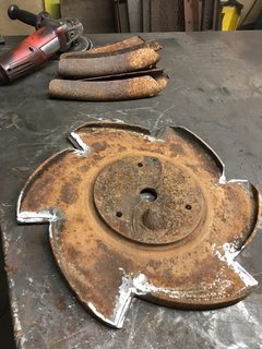

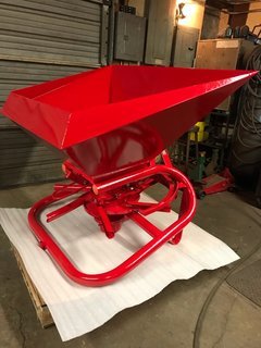

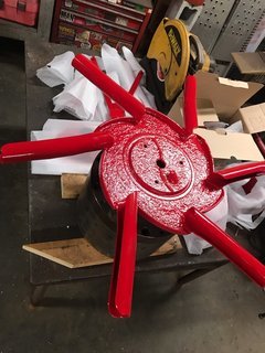

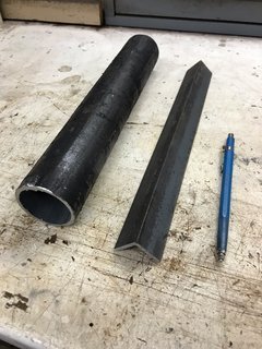

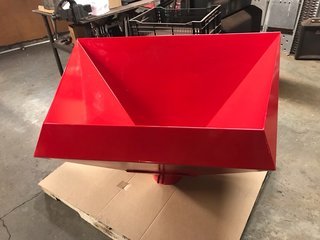

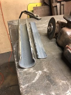

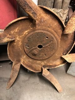

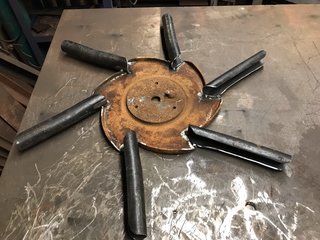

    A friend of mine about 45 minutes away saves me his feed sacks through the winter and I use them for deer corn. I went to get some a couple years ago and he had some at a farm he rents from an older lady. Long story short I bought this Lely from her and had my buddy powdercoat it. I had to make new veins for it because I couldn't find any. Made some stainless pins at work.

    Wow, your really gave that a new lease on life. Great looking work

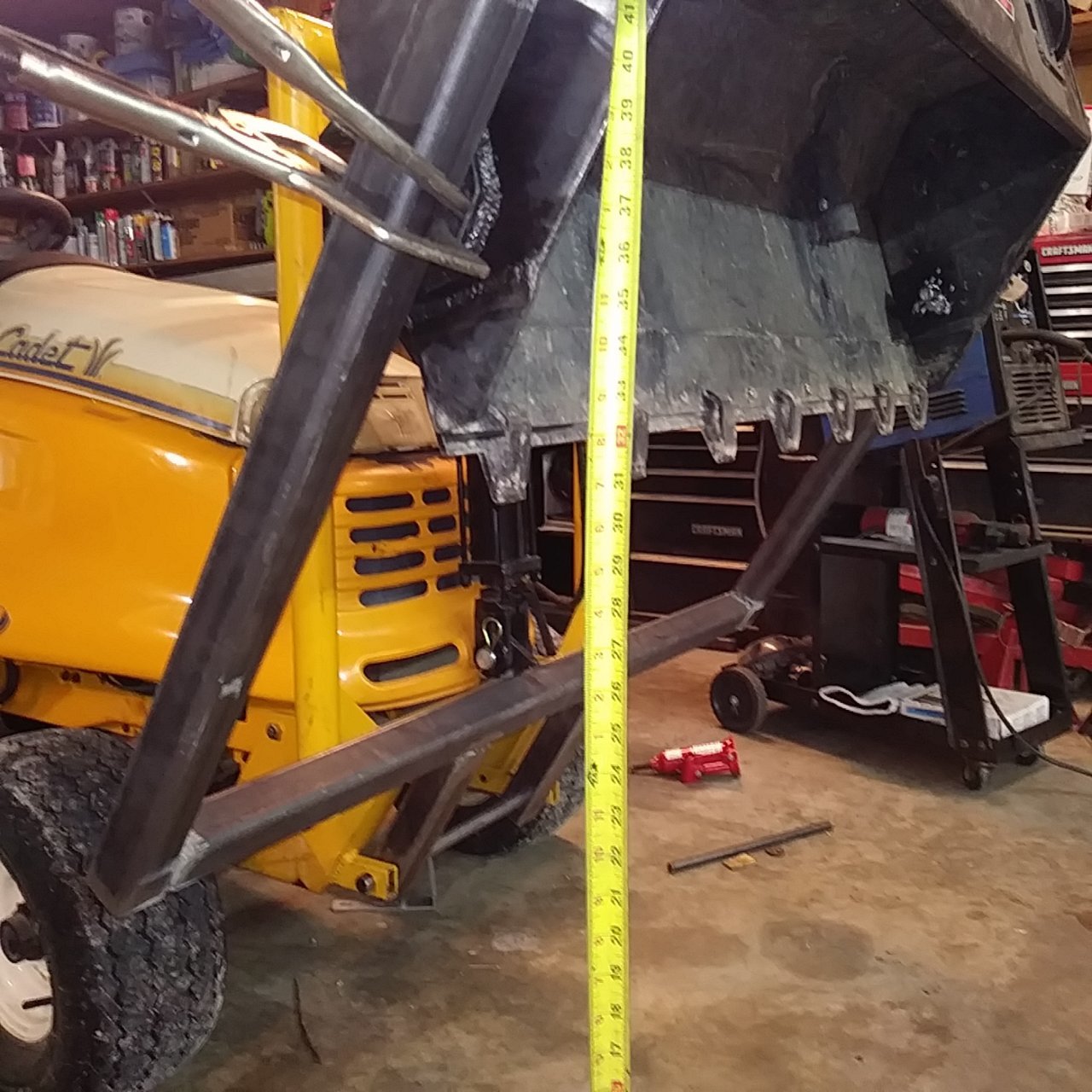

    Worked out the deets on the bucket. I made temp pivots that can slide along the lift arms to work out the best curl and dump place. Its pretty good at 31" of dump with the bucket at the same distance from the tractor as it was before. I will need a longer curl cylinder.20200504_180043.jpg 20200504_182032.jpg 20200504_183941.jpg 20200504_181120.jpg

    That’s pretty slick, thanks for sharing :thumbsup:

    Thank you sir. Still working out the size of curl cylinder. Gonna really think it thru before ordering one. I'm limited by a slow and low pressure 500psi 1.5gpm pump.

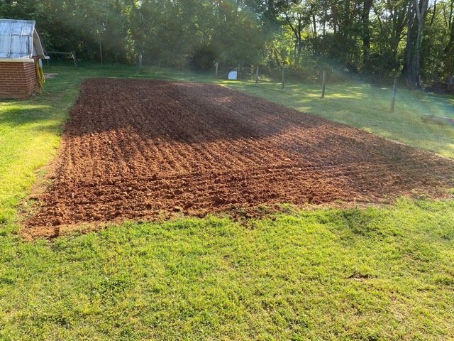

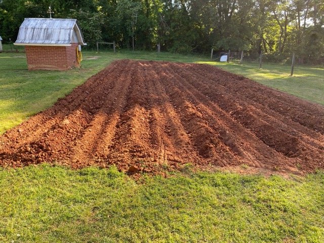

    Got the garden listed today. Plant it next week.

    What are you gonna grow?

    Squash, zucchini, tomatoes, etc. not enough room for corn.

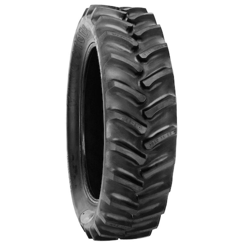

    My friend who owns the powdercoat place and I worked out a deal on the tiller. He bought it and he’s going to paint the rear rims on one of our 140’s. Ordered some Firestone’s for it yesterday, 8 ply. They should be in Monday or Tuesday. Now I get to wrestle these next week with getting them off the rims.

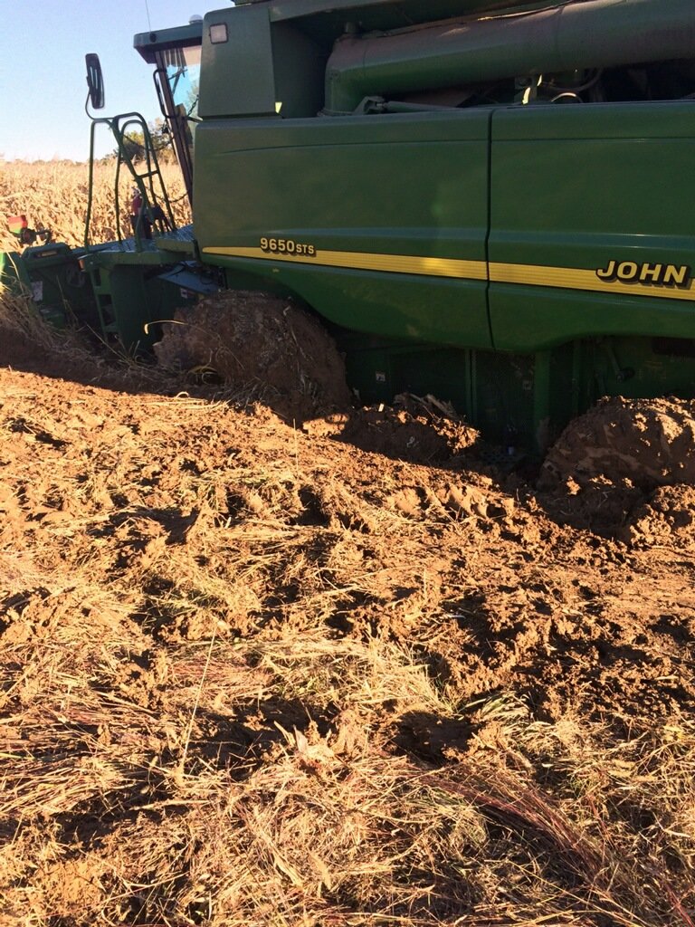

    Friend forwarded me this, not sure who’s it is.
  19. May 10, 2020 at 5:55 AM
    #599
    G.T.
    Jul 14, 2010
    #40169
    19,797
    G.T.
    CONUS
    That can kill allot of people’s seasons.
  20. May 10, 2020 at 5:57 AM
    #600
    Tractorman
    Tractorman Just A Dumb Farmer
    Aug 17, 2014
    #136355
    17,082
    Stupid
    Misery
    2015 DCSB / MGM
    Haven’t we all been there a time or two?
