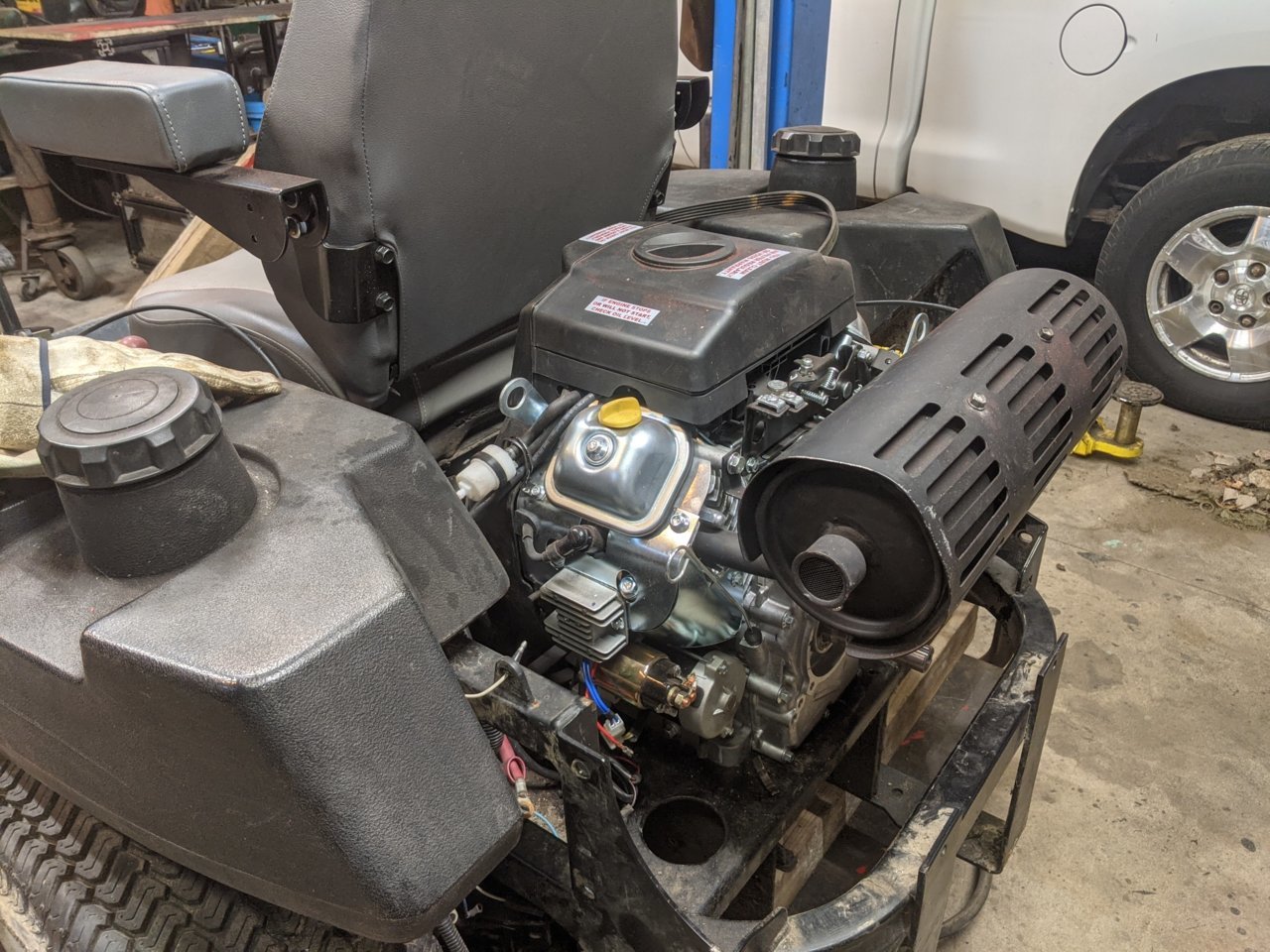

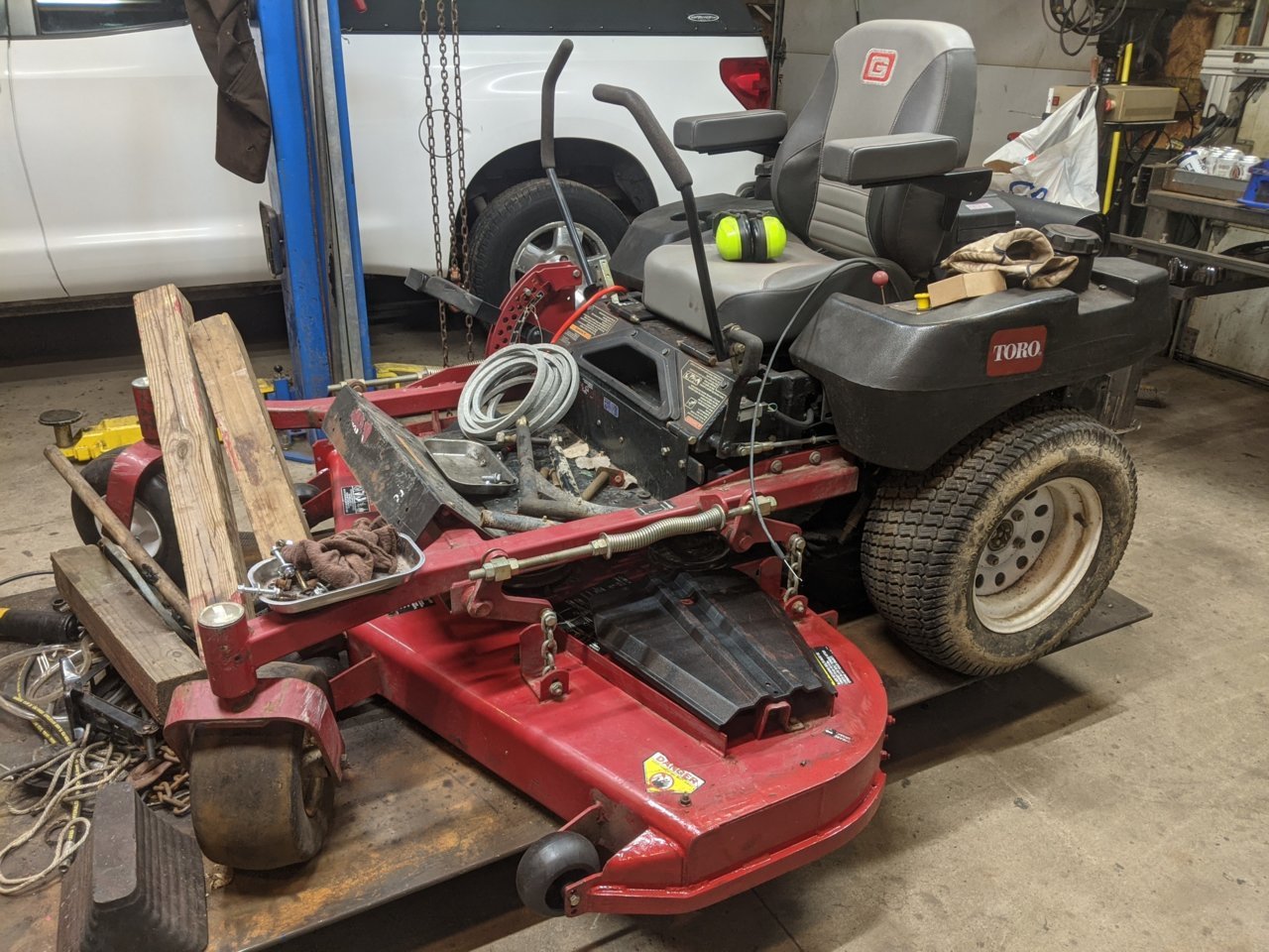

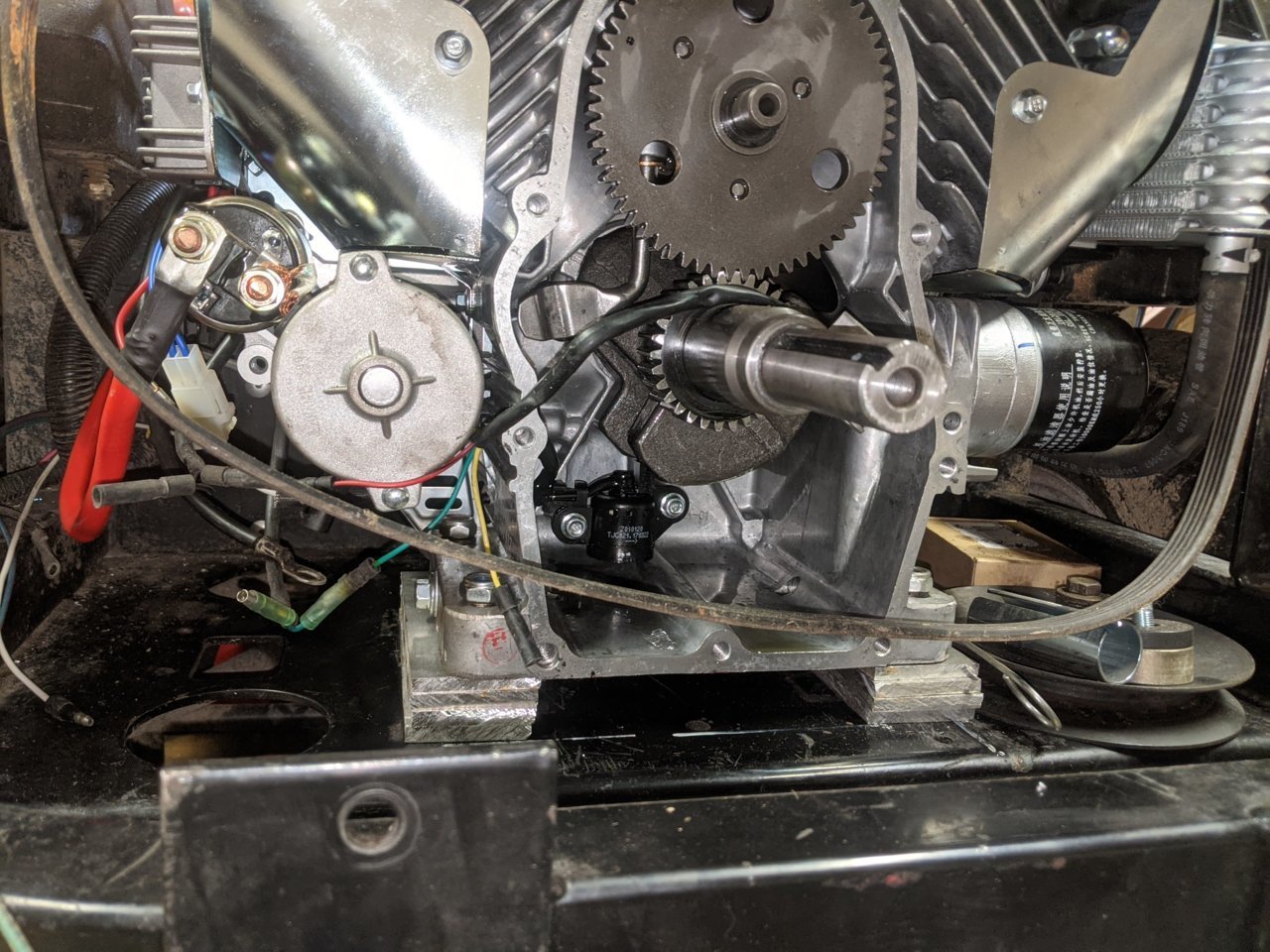

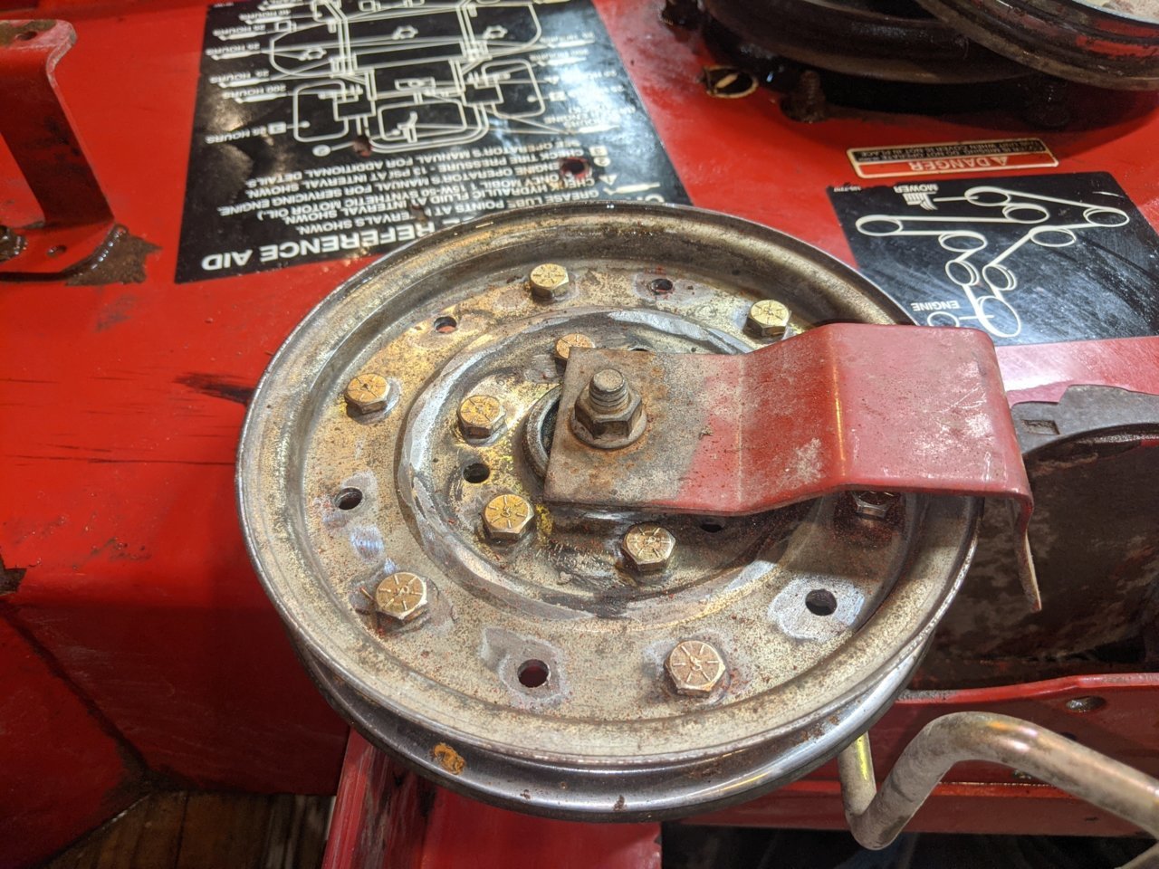

  4. Jan 14, 2022 at 12:18 PM
    #6024
    koditten
    koditten Well-Known Member
    Sep 8, 2013
    #112077
    19,762
    Kirk
    Central Michigan
    04 trd x-cab 4 x 4 3.4l
    Reserected from the dead.

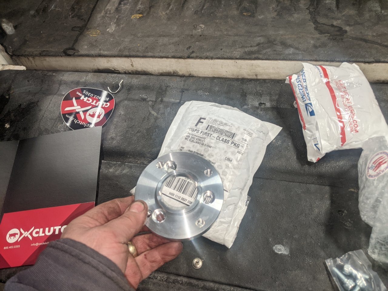

    Deck is rebuilt.
    Waiting on my drive hub adapter.

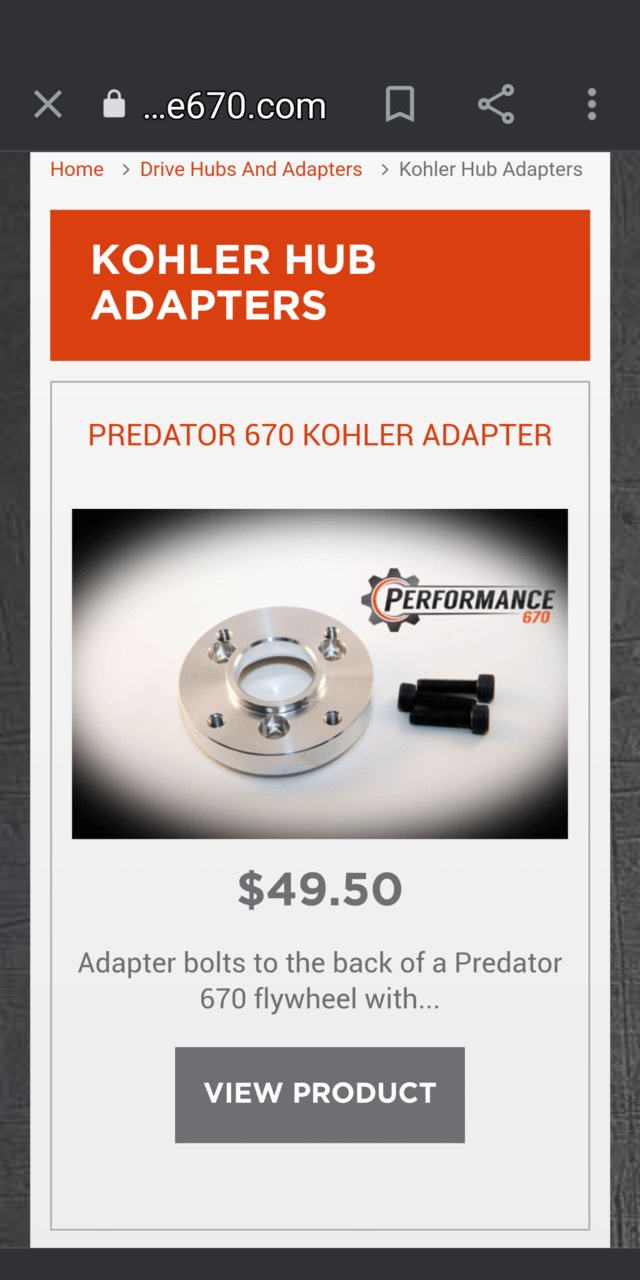

    Decided to rebuild an idler. $3 for a bearing and $2 in locking nuts with bolts. $25-$30 to buy a replacement idler. I figure I earned a case of beer with the savings.
    The Predator has a 3 bolt flywheel PTO mount, the Kohler's use a 4 bolt.

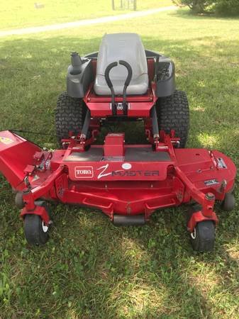

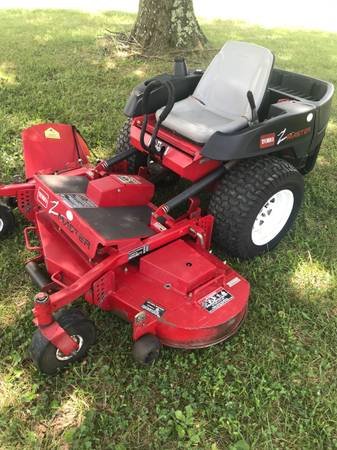

    If you were closer…..a friend of mine is selling this Toro for $1,250 it has a bad pto gearbox. Runs good.

    If thats got the Kohler, its worth that price alone.

    25hp Kohler :thumbsup: 60” deck.

    There sits the hub adapter I've been waiting on.
    That's gonna be a tomorrow project

    I have the identical mower (1993 I think), not as nice naturally... I got it for scrap for $100 and got it running just ok. The thing is a blast to use and incredibly fast, having your feet move with the deck feels odd at first. It is a giant thing to store and the deck is too wide to fit on my trailer.
    Once I get caught up (yeah, right) I would like to bring it home where there is a lot of open space to mow. The little New Holland takes about 3 hours, the big Toro could probably cut that down to 90 minutes.

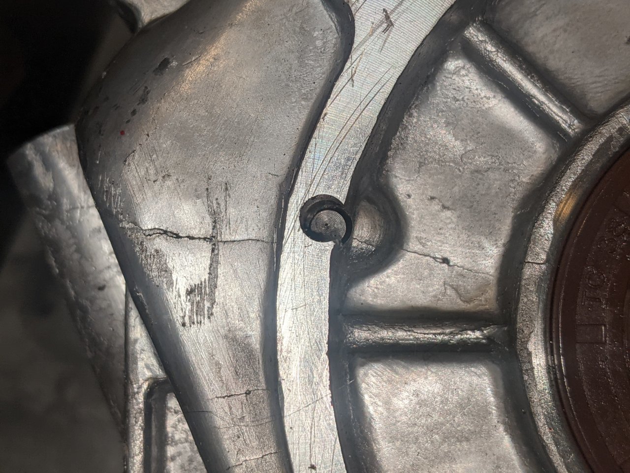

  13. Jan 15, 2022 at 11:59 AM
    #6033
    koditten
    Sep 8, 2013
    #112077
    19,762
    Kirk
    Central Michigan

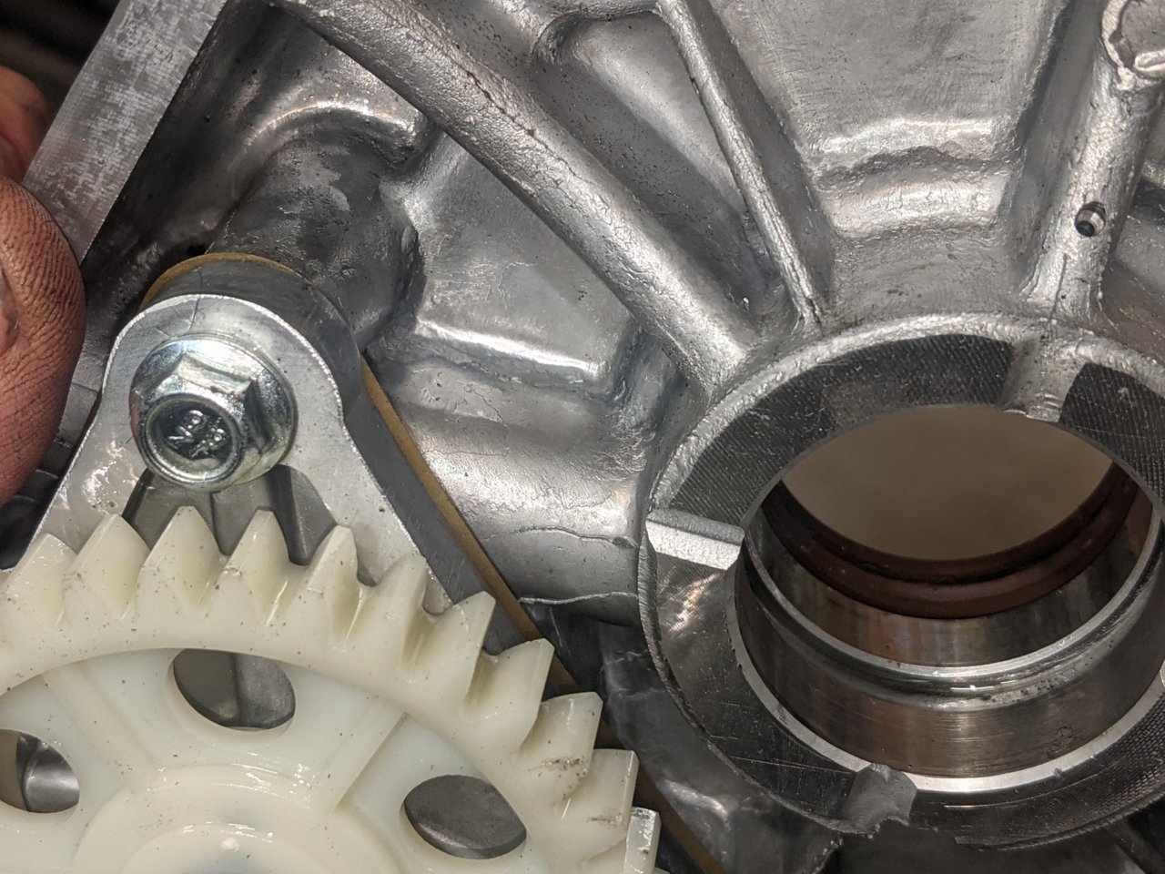

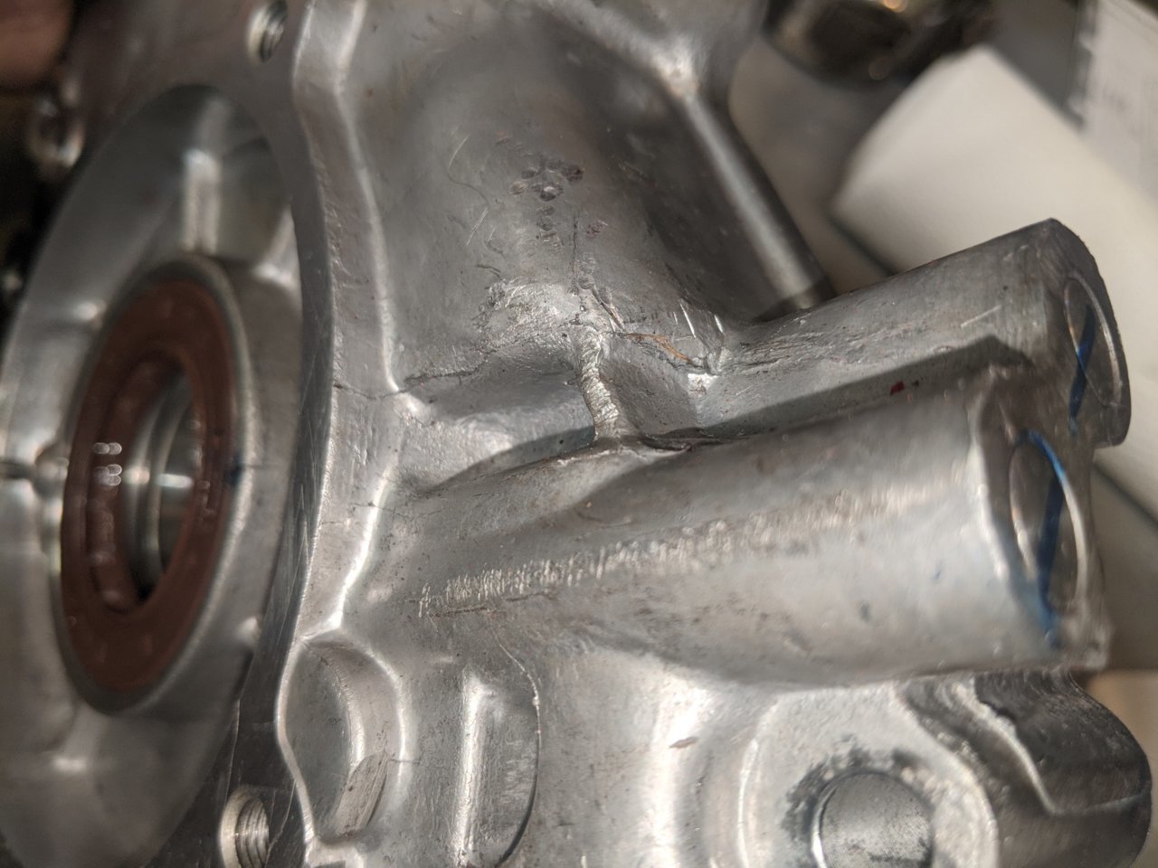

    Well, fuck!
    Case cover has some nasty cracks!
    Was hoping they were just casting marks. Took it apart to get a look at the inside. Yep, cracks there too.
    I soapy water/compressed air tested and no bubbles were evident. These cracks are along the oil journal to the crank bearing.
    Best to just replace it.
    $130 for a new cover. Fuck it! It's still costing me less than a new one...if you can find one.

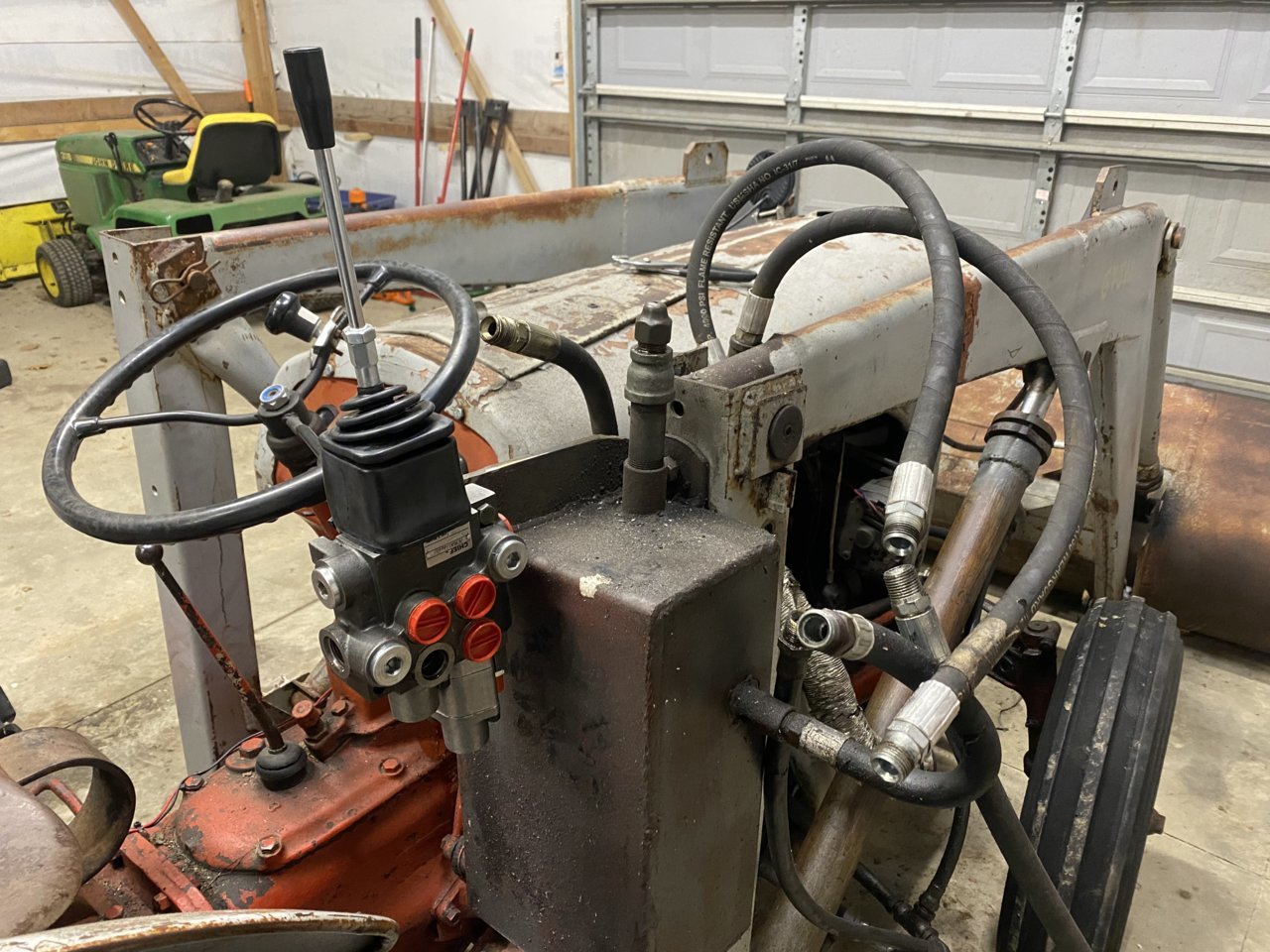

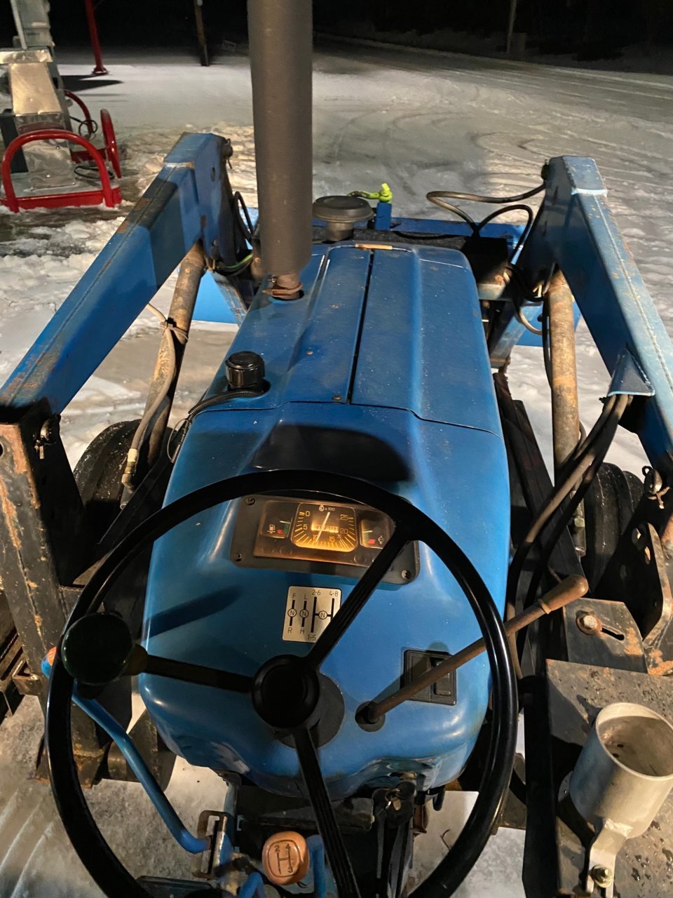

    The GT500 is getting a new loader valve today. It came with two separate valves that…loosely controlled the loader. I think they were tired internally because when you commanded boom lift, you’d have to run through a small spot where it would loose hydro pressure and the loader would drop before it eventually applied lift pressure. Not a huge deal for dirt work but sucked trying to unload the truck with pallet forks.
    While I’ve got it down to do the loader valve, I’m getting around to fixing the exhaust manifold leak that was annoying to listen to under load.
