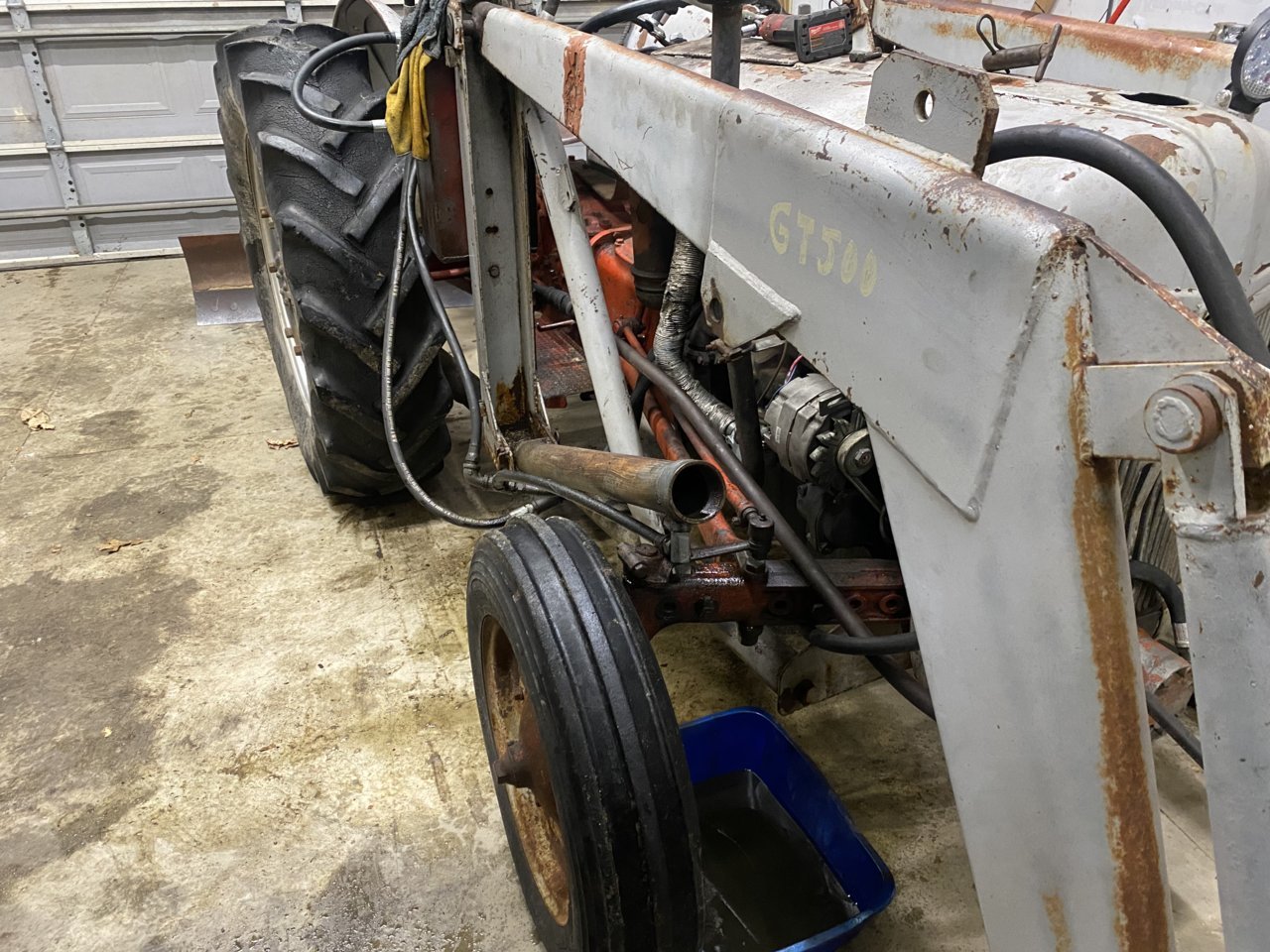

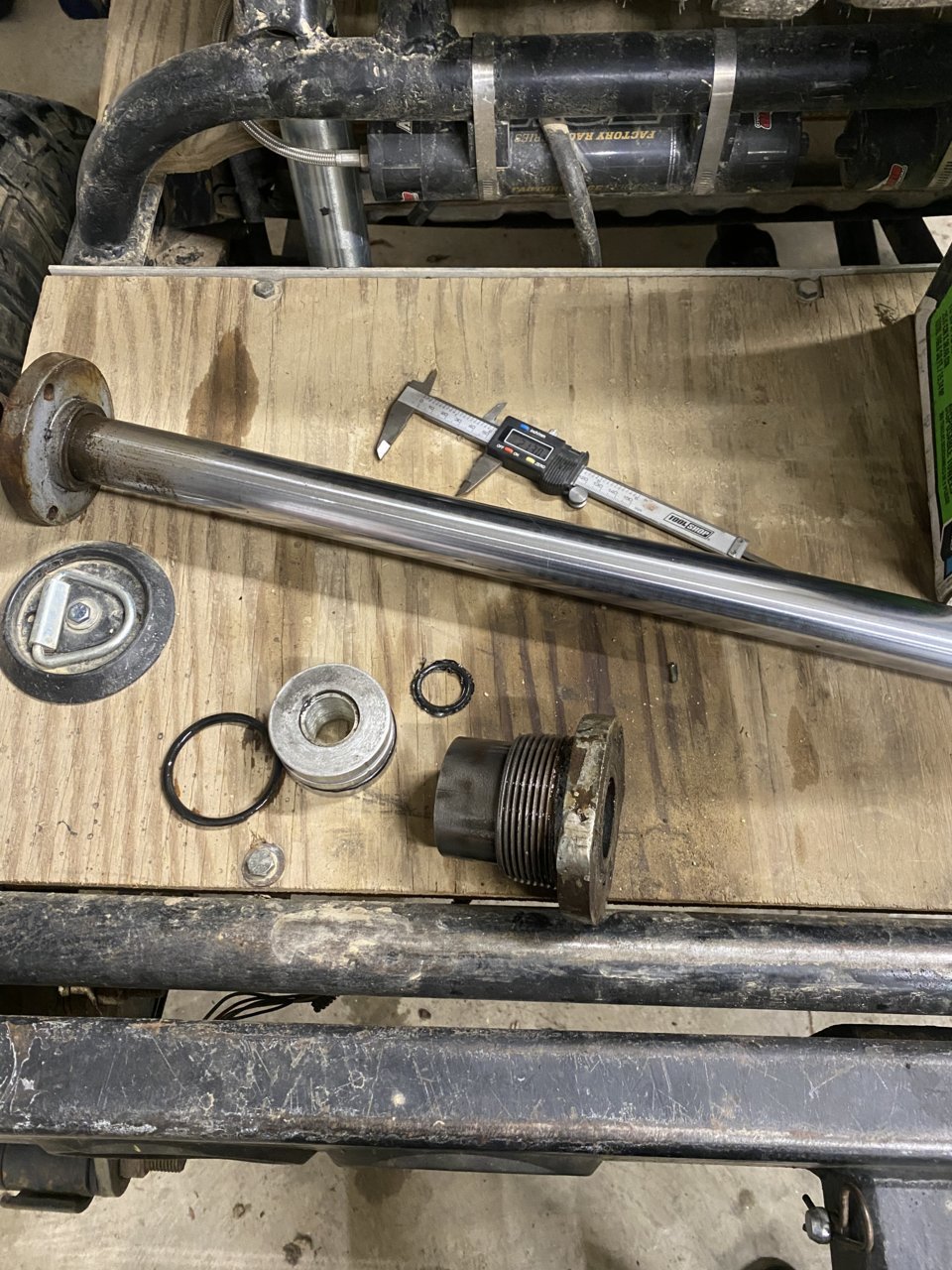

    After I got the new loader valve plumbed in and some small stuff fixed with a new accessory belt and exhaust gaskets, the GT500 rewarded me with blowing the loader packing (that admittedly had been leaking for months) and leaking profusely under pressure. Good news is that the ram came apart super easy and I should be able to get new seals from the hydro store locally. Also love the new loader valve, no more weirdness from the controls that makes me look like a drunk at the wheel.

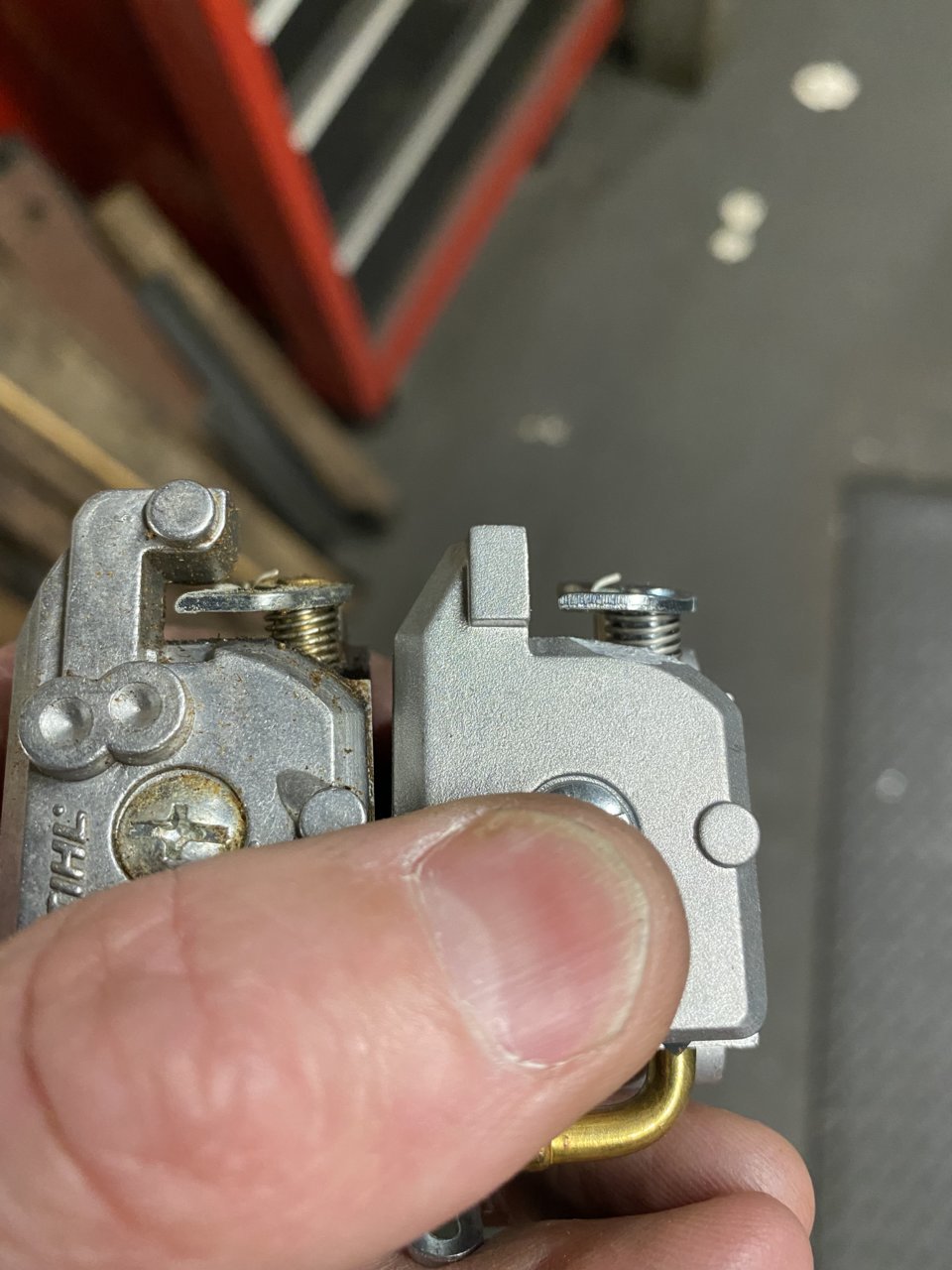

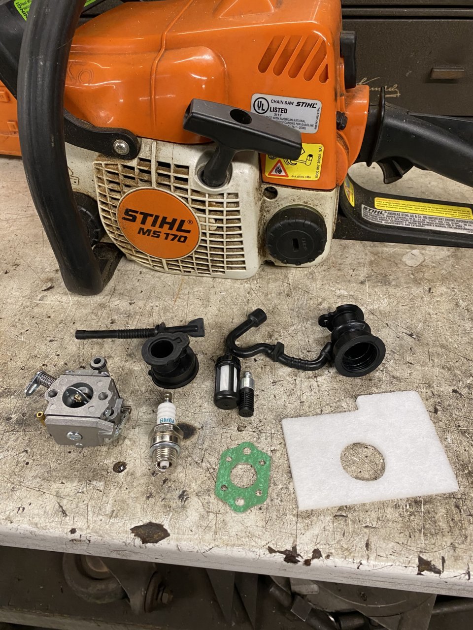

    Bought this saw new about 12 years ago. Had carb trouble with it once, cleaned it and it’s been running fine. Until Saturday. It will start but die. Won’t take any throttle. $20 Chinese carb it’s a getting.

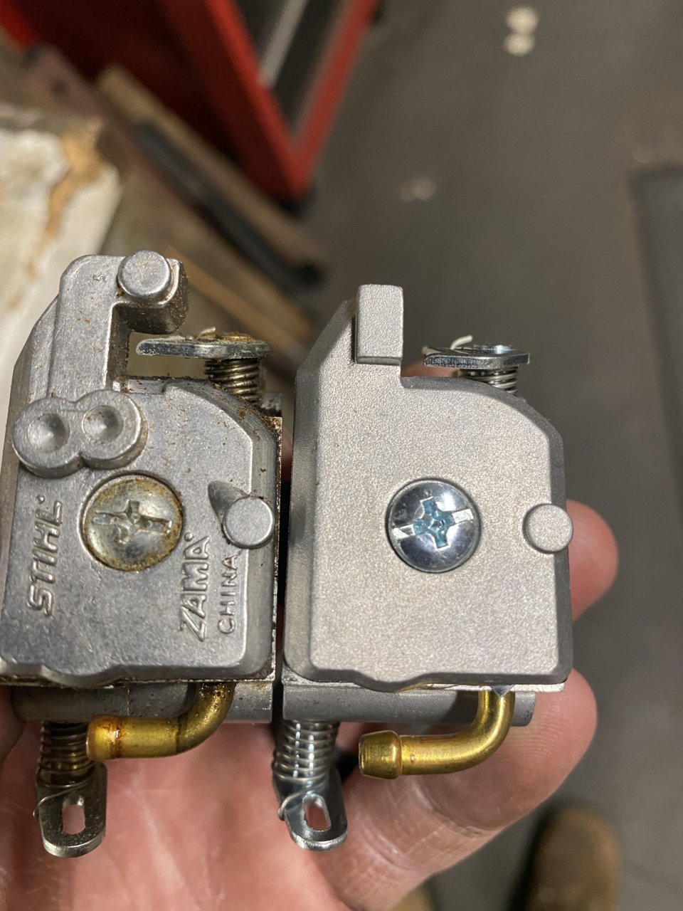

    Got this Chinese carb on, the idle was more like a half throttle. The throttle rod was hitting the carb, took a dremel to it then bent it a tad and it runs perfect now.

    Good to hear it worked. I've heard those carbs are about 70/30 in favor of not working.
