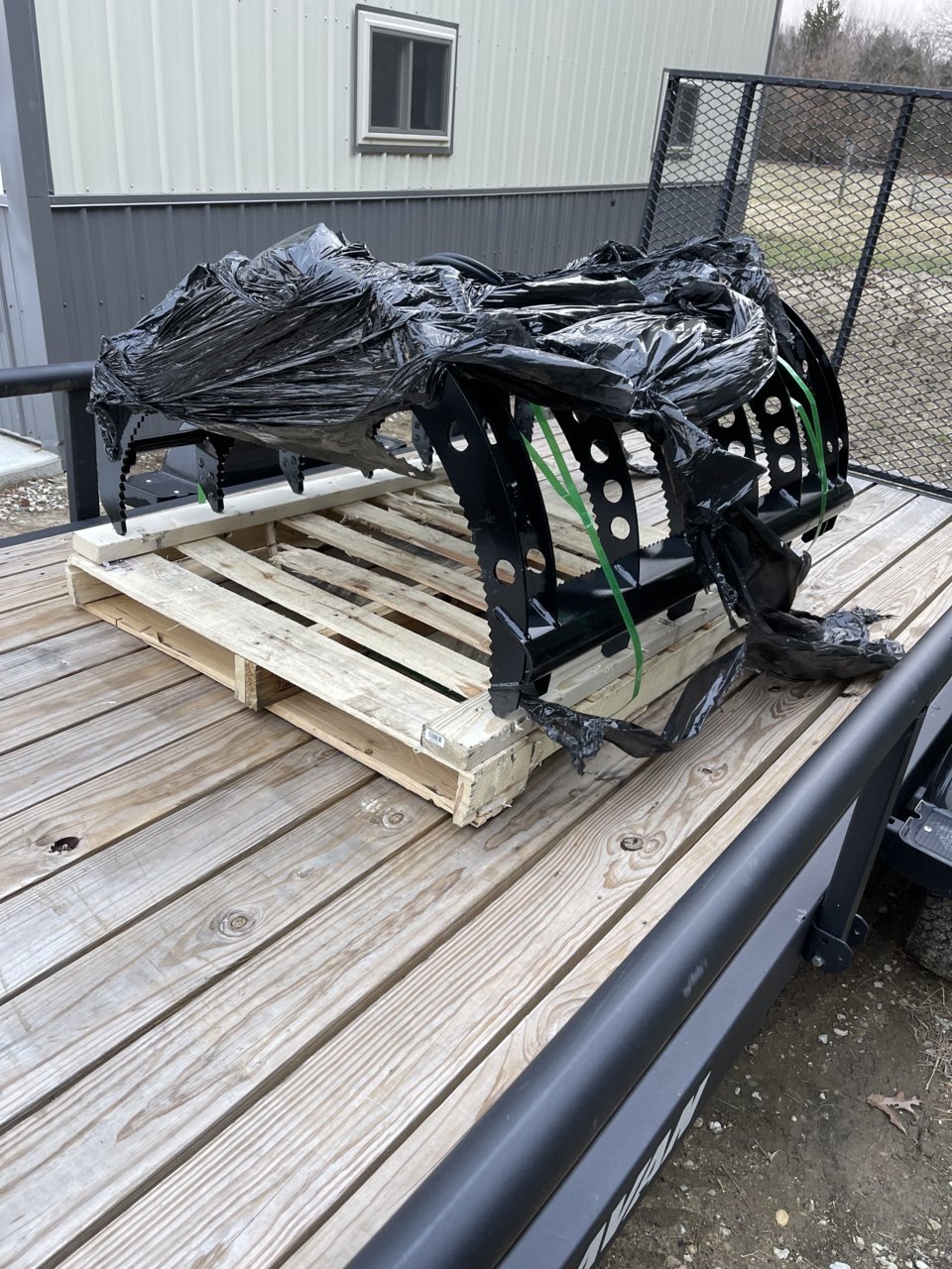

    1BA910CE-6596-457C-B74D-BF44B3A85AE4.jpg Look what finally decided to show up
