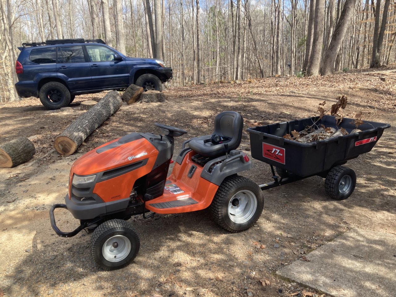

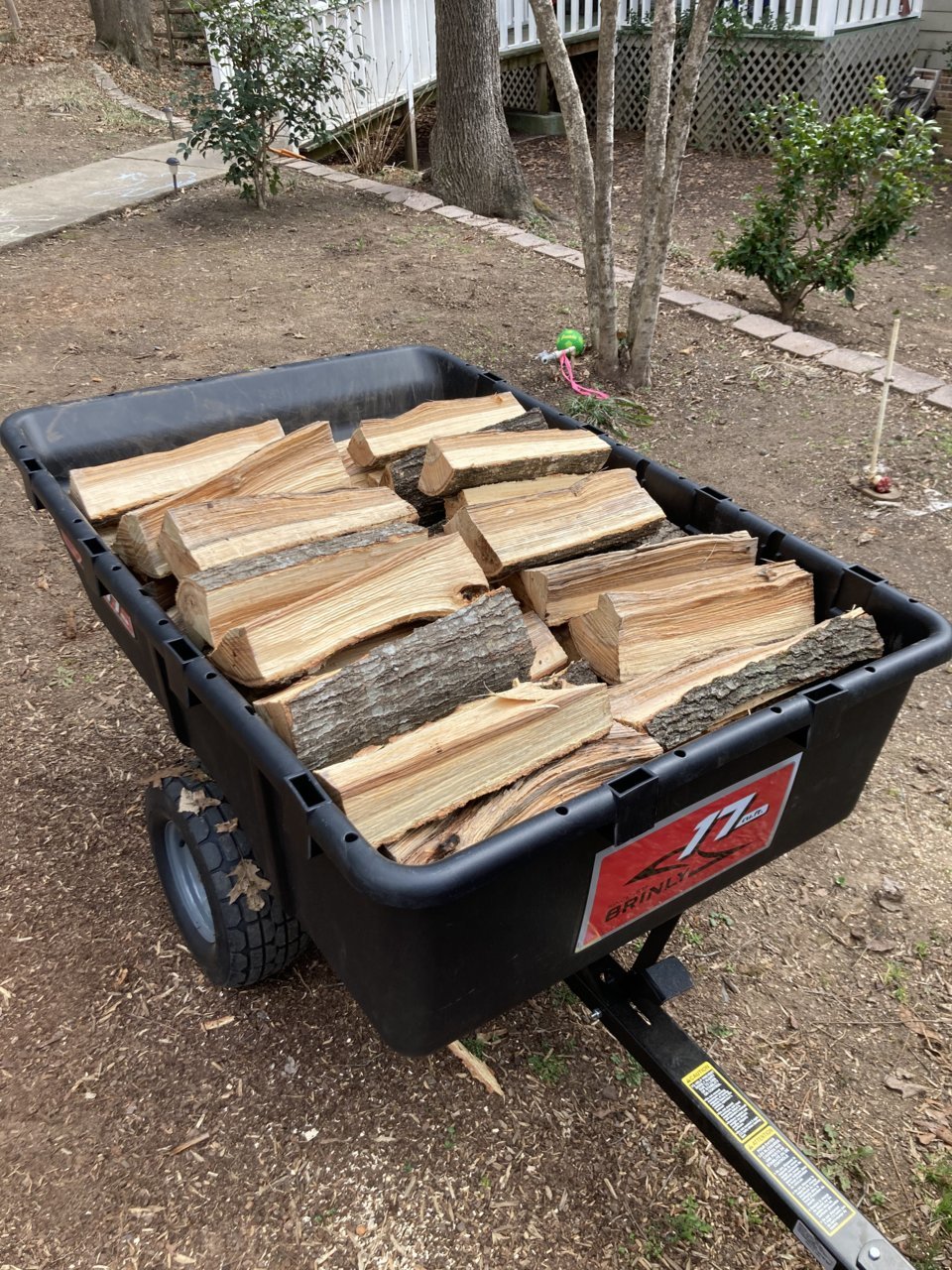

    Picked up a dump cart for my Husqvarna. It’s so much better than a wheel barrel! Broke it in by moving fired wood and leaves over the weekend.
