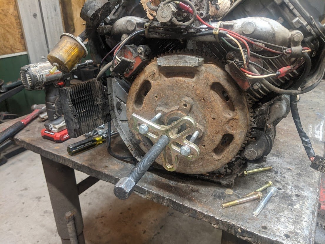

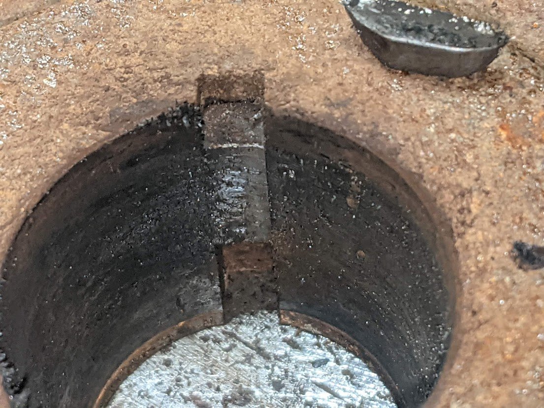

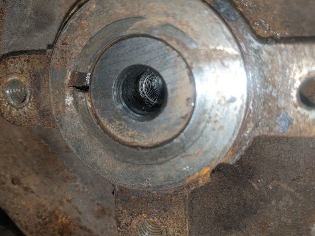

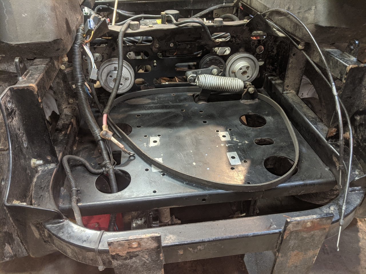

    Popped the engine out this morning. Just as suspected. Keyway was sheared.

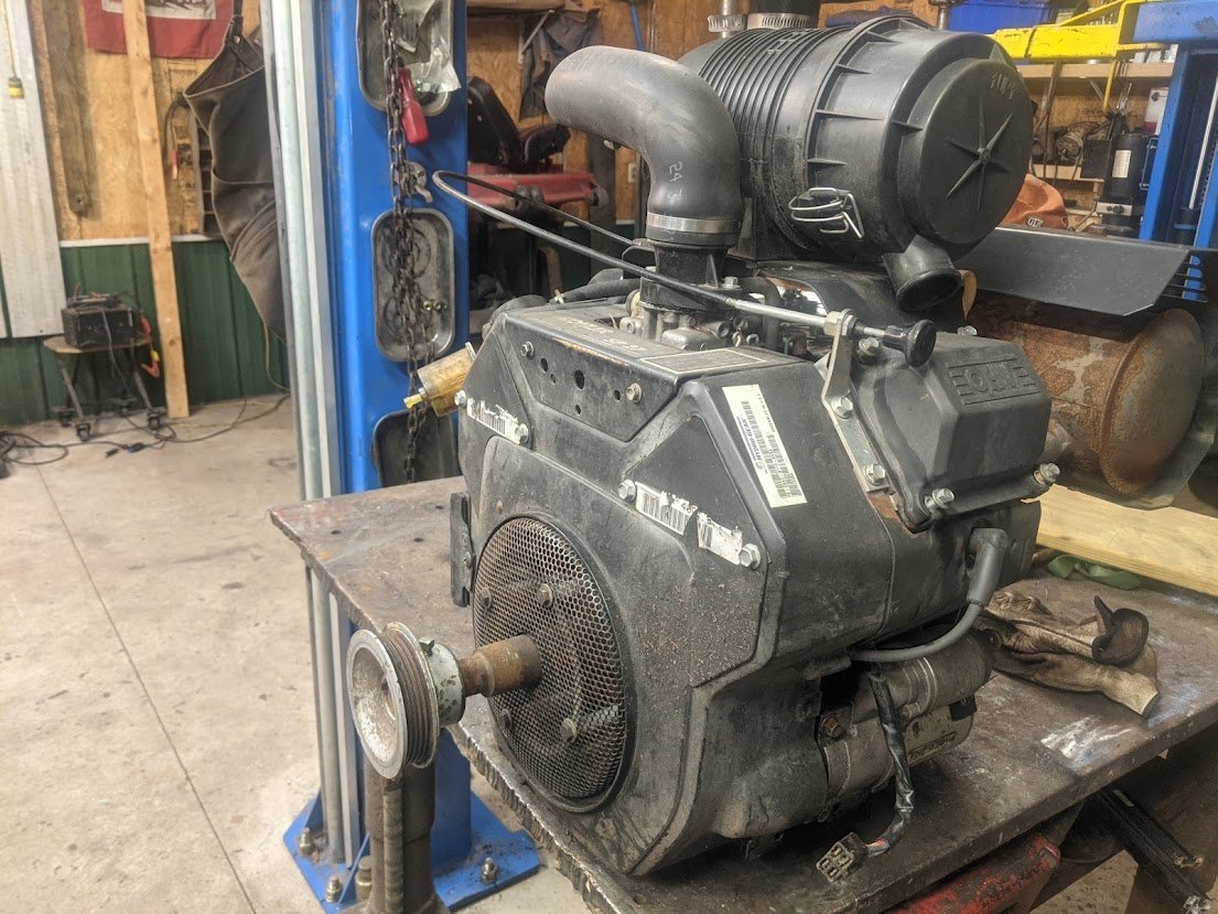

    That big, orange can made a great handle when grunting that motor around the table.

    EZ fix :yes:

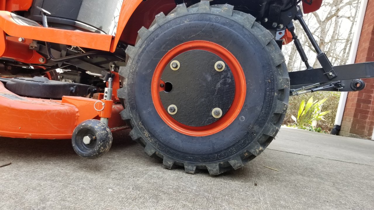

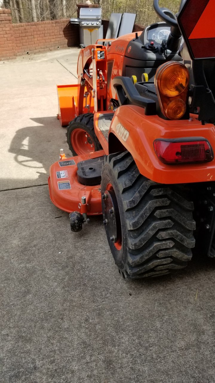

    Put wheel weights on bx2380.
    Still feels like a high center of gravity but better.
    It's 2 thick steel discs, 1 smaller diameter than other, welded together.
    My grandpa made these weights in the 70s for better traction using a snowblower attachment. I just had to get longer bolts and shims and grind down a back corner so they would nest nicely in the rim. And paint of course, couldn't have that faded old jd yellow on an orange machine. :D

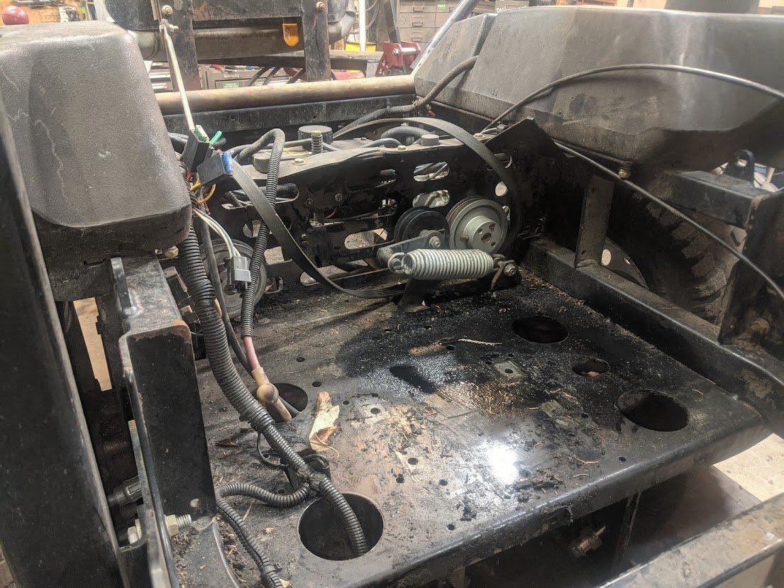

    Cleaned the engine up before putting the flywheel back on.
    For buying 12 years old, it didn't seem that grimy.

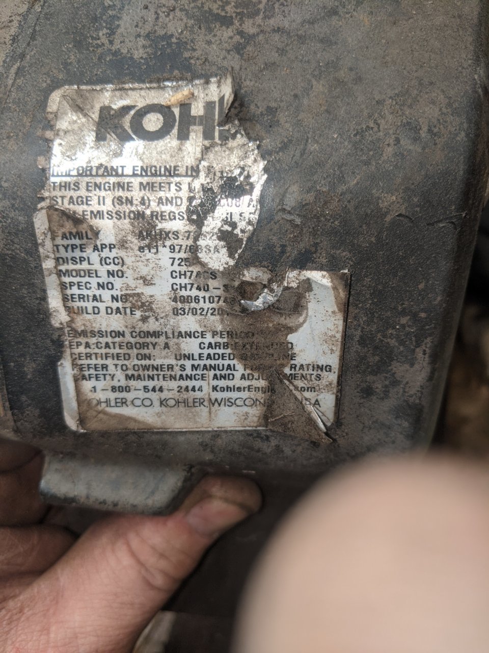

    The build date for the mower is 2010-11.
    The decal on the engine says build date of 201(3)?. There was damage to the decal.PXL_20220321_133746316.jpg PXL_20220321_224409708.jpg PXL_20220321_224551696.jpg

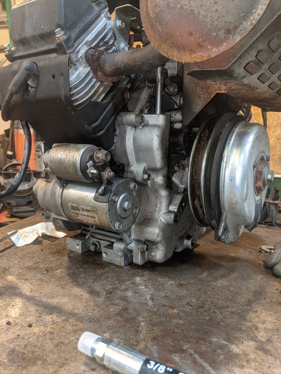

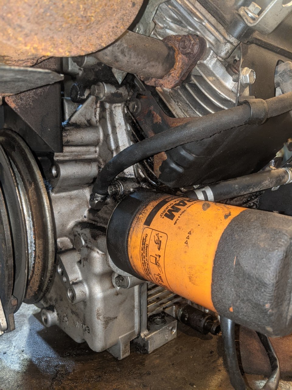

    I can't decide if I want replace the queer " quick drain" valve on this motor. These fuckers always leak, thus coating the chassis with engine oil. Oddly enough, this one was actually leak free.
    I have a 3/8" hydraulic hose ready to install if I want to do this.PXL_20220321_224424930.jpg

    I had no idea the Frame 3600 filter was the same as our 3614. That thing had got to be a 1/3 longer than the 3614. I bet close to another 1/3 quart of oil can be held in this engine.
    Now I'm curious if this filter will fit my Tacoma.

    I remember your past experiences with them.
    I have the same quick drain on the Courage engine in my ZT, not convenient to get to.
    It doesn't leak because I have never used it, I have always used the oil extractor.
    I raise the away side and after the initial vac out I let it sit for 5-10 minutes and vac any remaining oil out.

    I've heard people complain about those valves but I've had 4 machines with them, always used them, and never had a problem with them.

    Yeah, I'm thinking I might leave this for the next owner.
    I do like my vac extractor, too

    I've got 1 ZT that I thought that valve was ok. While it sat for the last 2 months I found it leaking.
    I was getting ready to list it for sale and I found the leak.
    I guess I have to replace that valve with a hydro hose and cap before I put it to the road.
    Oh, well. Better than getting a call from the buyer complaining about oil leaking in their drive.
    I know Kohler put those valves on engines that went on many different machines. The layout on these Toro's just doesn't make them very convenient. You have to attach a hose to the nipple, turn the valve 1/4 turn, then the oil has to travel laterally 8" before it can go to a pan or bucket.
    Like Russ said " the extractor is the way to go".

    Motor is back in. Test ran for 30-40 seconds as I only was gonna sacrifice 1 qt of oil on an an engine that I have not heard run.
    The engine started right up with no choke needed. Zero smoke like I expected on a 4000 hour machine that had been sitting for 15 months. I figured the valve guides had to be leaking a little. I guess not.
    I still need top install a few covers and anchor the electric clutch. When those free ride with the motor, they Hella shake the chassis! Oops!
    I wanted to snap a shot of it running, but was worried about that clutch grabbing the wire harness.
    Pretty happy it runs so well. I'm still doubtful that it is the original engine.
    Regardless, $1.50 to replace the key was a "gimme".
