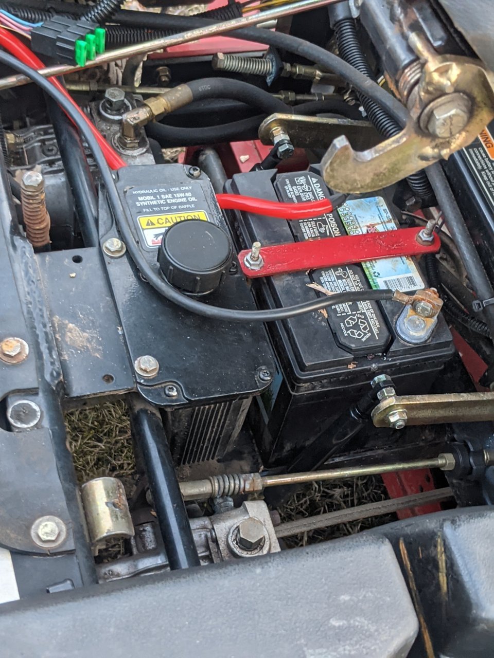

    Reserected from the dead.
    It wasn't the key switch.

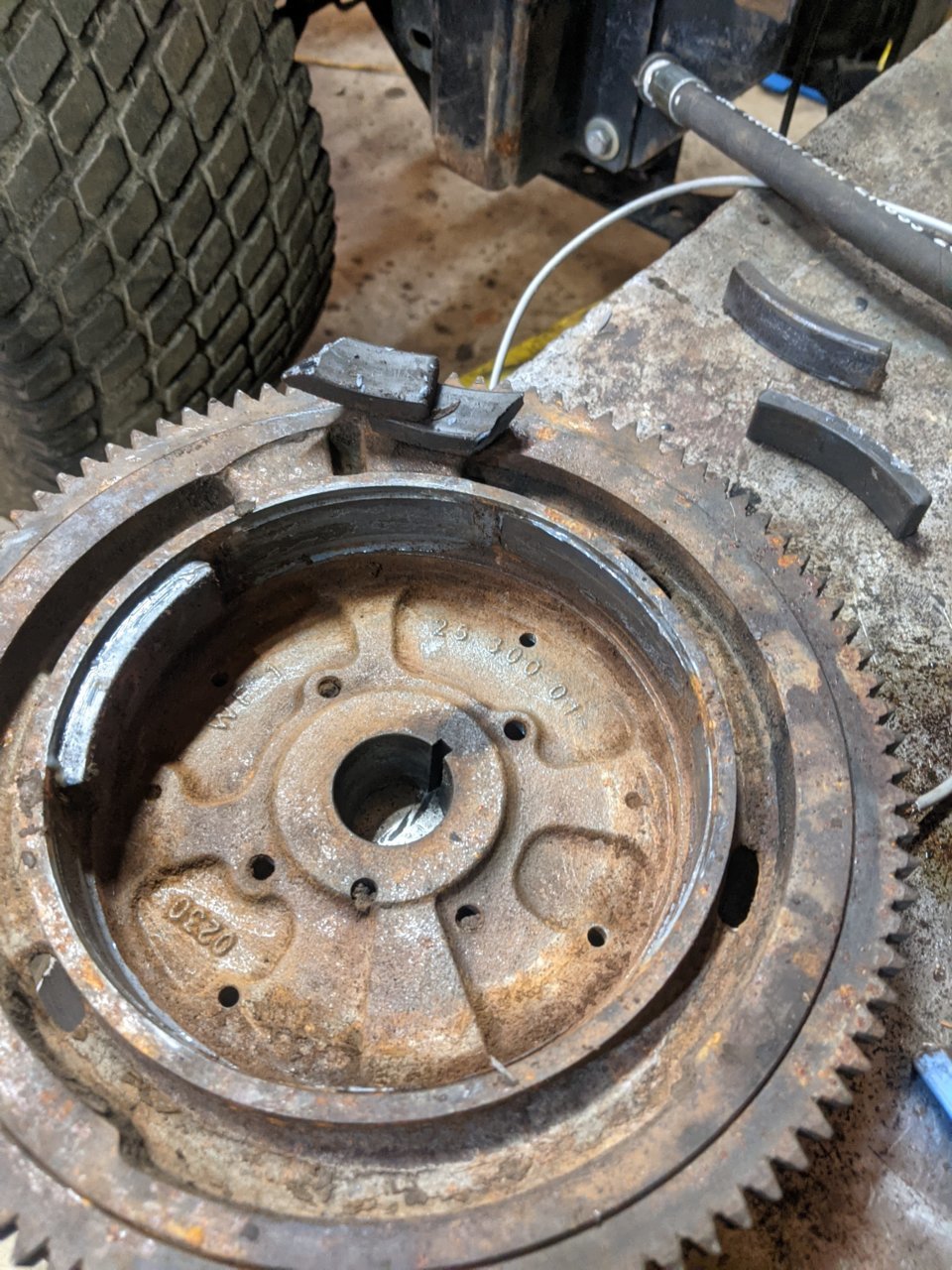

    Motor is out and apart...again.:rant:
    Broke magnets. Dammit!

    Well that is ... unusual...
    How?
    Maybe rust formed behind them?

    The magnets are a weak link on these Kohler command engines. They come from the factory stuck with double sided tape. After running hot, the adhesive let's go.
    Someone has been in this engine before and glued the magnets in the wrong position. They are polarity sensitive.
    I have a new(used) set on the way.
    You can't buy these magnets new...that I know of. You have to buy the entire flywheel. Kinda sucks

    Agree, does suck.
    Do you tape them or epoxy?

    I will be using hi temp resistant epoxy.
    The mags won't be here until next week.

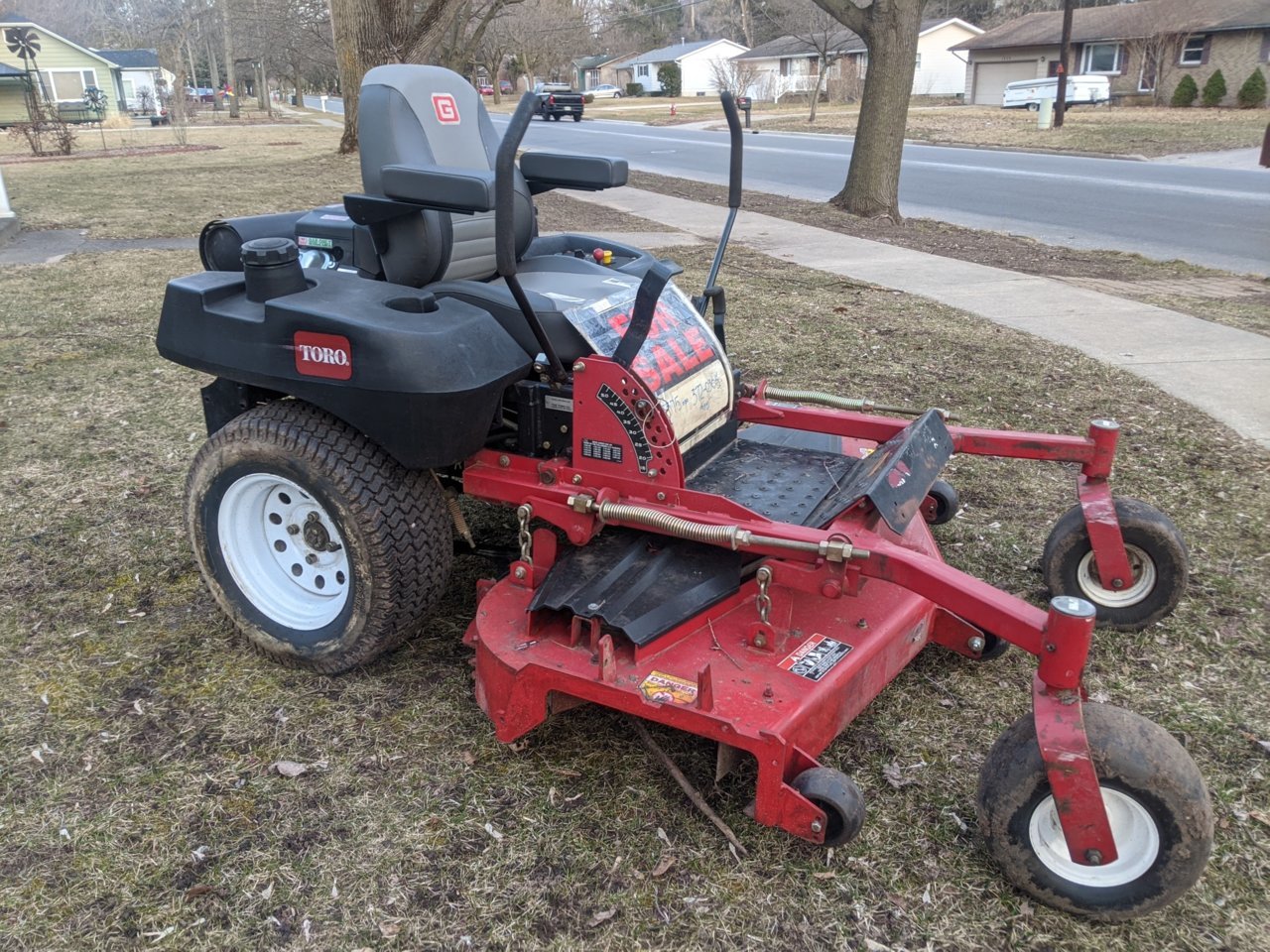

    I stuck this one to the road an hour ago.
    Already had 2 "tire kickers".
    Any guesses how long it's gonna sit?

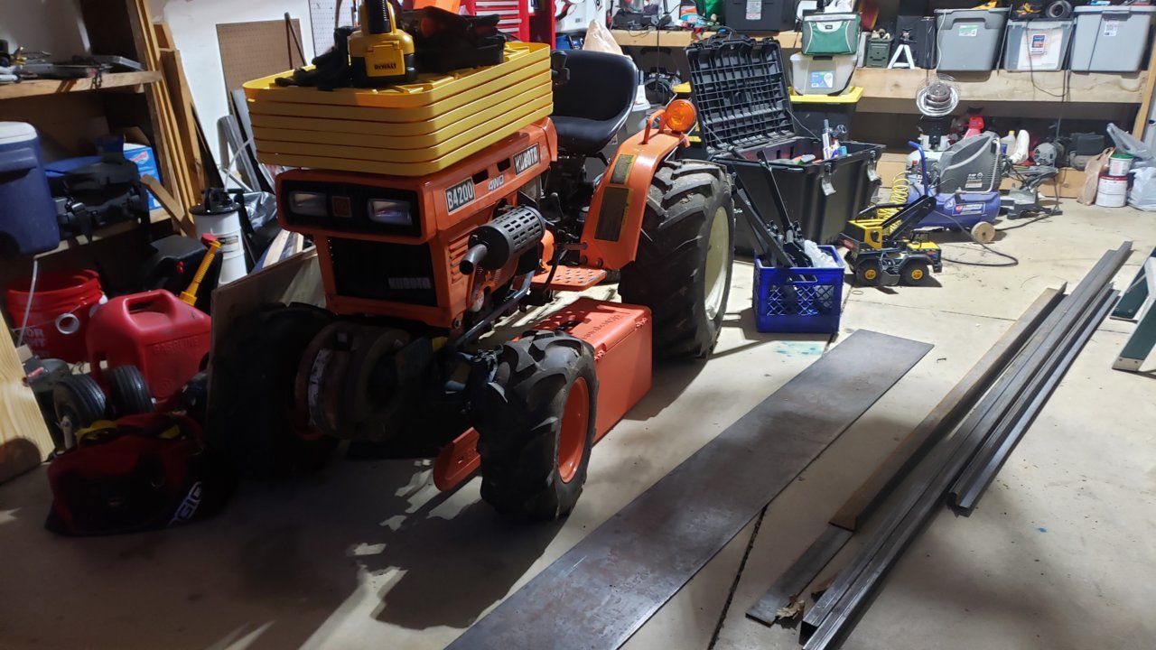

    I need to run my tractor before my garage reclaims it. I have some ground work to do once it quits raining.

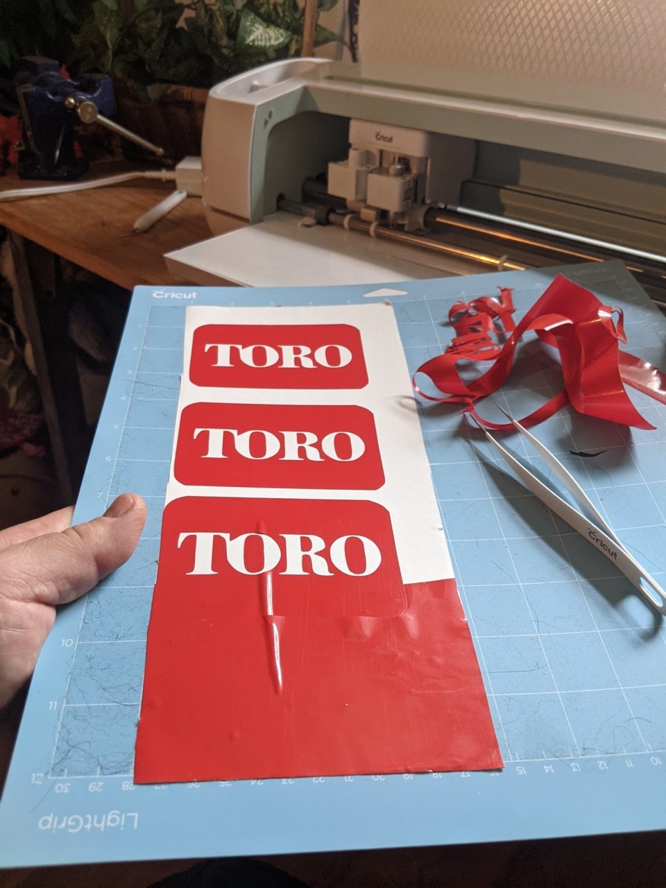

    Needed some decals to make the mower stand out from all the rest up for sale. Figured " factory" decals could make it "pop".
    Found a similar sticker on the ' bay.
    Copied it to my computer.
    Imported it to Design space and told the Cricut unit to cut it out.
    As long as I'm not doing this to make money, no one seems to mind.

    Uploaded the image to DS. Had to tell Design space what to keep and what to discard.
    You can just barely see the cut out pattern on the sticker.
    BTW. I made 3.

    I removed what is considered the scrap. What is left is the actual decal.
