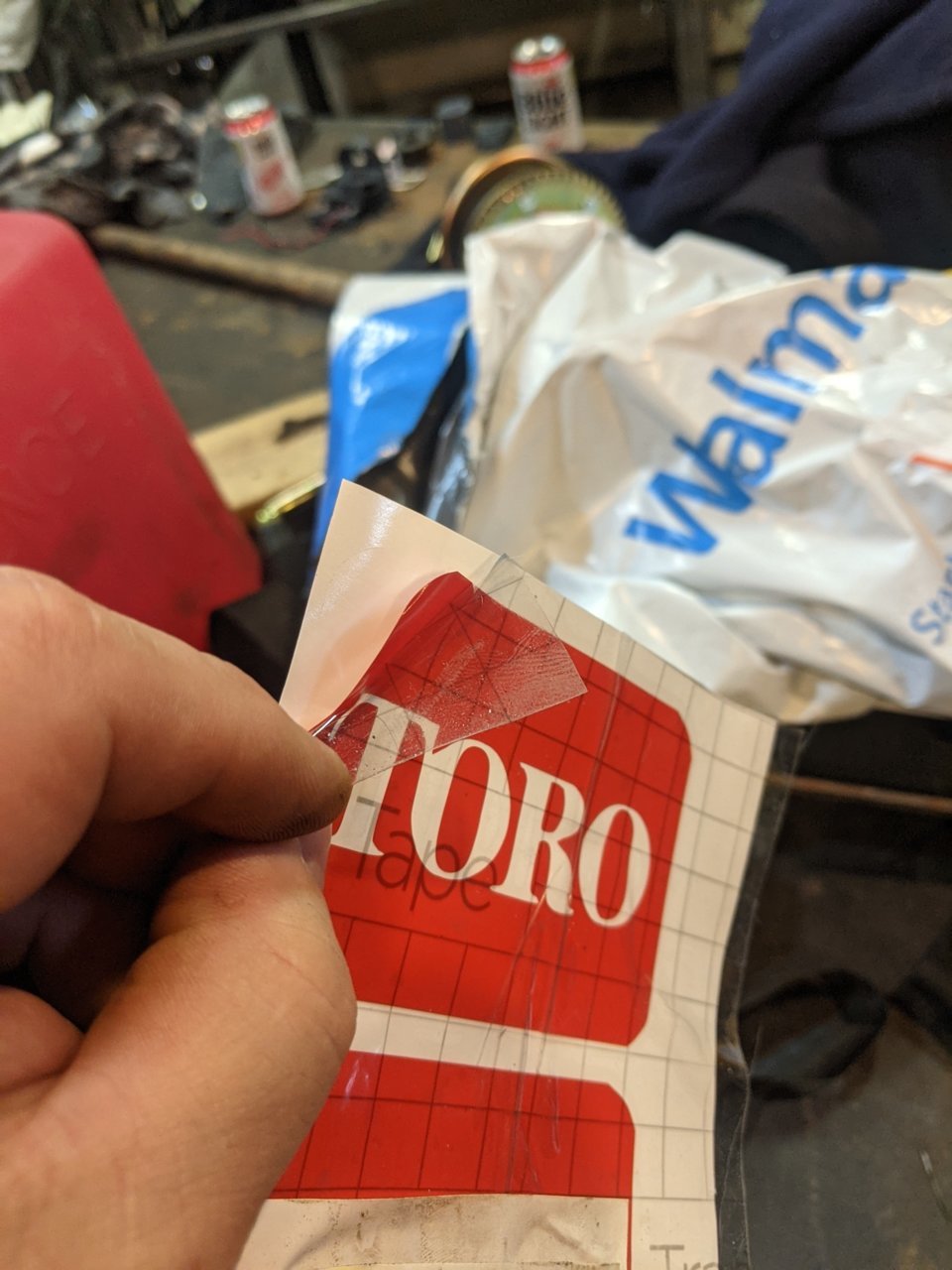

    In the last pic, the transfer tape has been attached to the top of the decal. You use this to help remove the decal from the decal backing paper.
    You position the decal with the backing paper removed, rub the decal with Bondo spreader, then remove the transfer tape.
    Rub out any bubbles in the decal. Done deal.

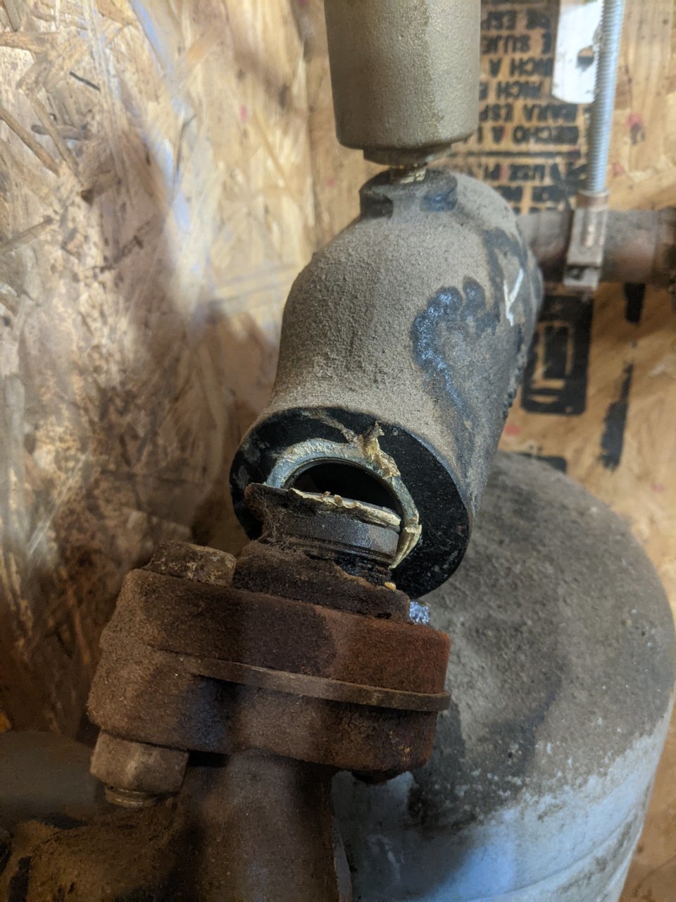

    Shop boiler for the floor heat developed a leak.
    Took it apart to reseal the leak.
    The expansion tank fitting nipple was broke.
    Now I have to figure out how to get those male threads out of the expansion tank fitting.PXL_20220402_150839585.jpg

    Internal pipe wrench.
    https://www.lowes.com/pd/Kobalt-NA-...VCZfICh3tXgzLEAQYASABEgKB3_D_BwE&gclsrc=aw.ds
    If needed a new air scoop isn't all that expensive either fortunately.

    They only had up to 3/4".:(
    Gonna have to McGyver something.

    McMaster - Carr has a 1" internal wrench for about $23 as well.
    5371A16

    Usually you can use a hack saw blade to weaken the broken nipple and then curl it in with a small sharp chisel.
    Blkvoodoo and six5crèéd[OP] like this.

    That has been my recipe in the past as well.

    I’ve seen a hack on YouTube or IG where you grab 4 largish bolts so there is a tight fit in thebore then twist those bolts as a bunch with a pipe wrench, causes the bolts to twist and wedge and bite into the softer pipe
    I’ve use the hacksaw trick before as well

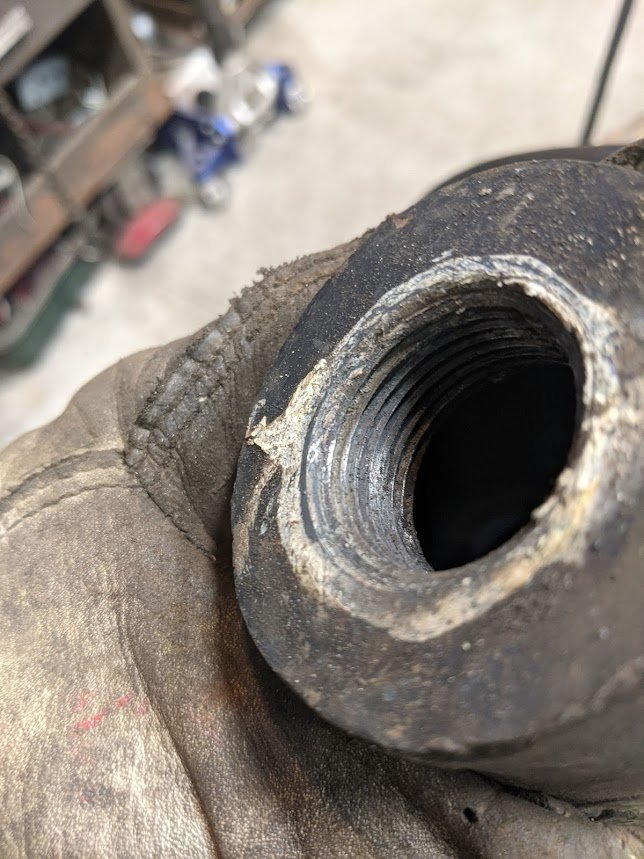

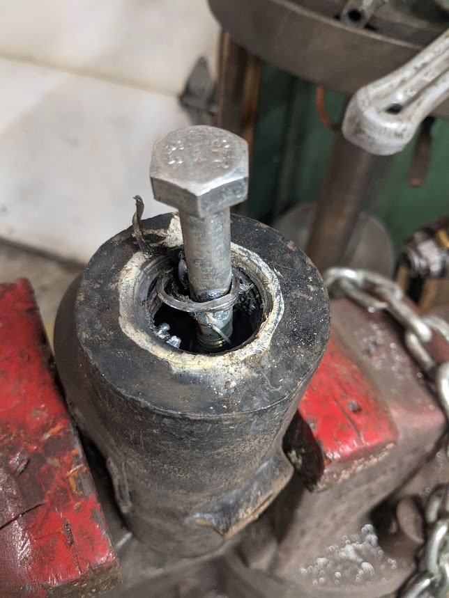

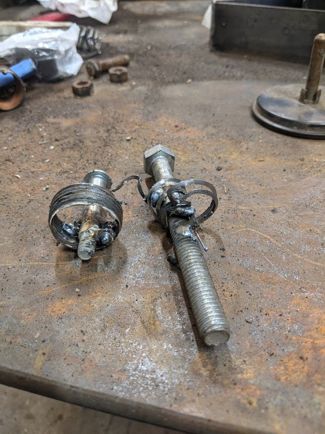

    I just got it back together. Floor is starting to get warm again.
    I was able to weld a bolt inside the broke off pipe. The threads screwed right out. I'm sure the heat from the weld softened up the pipe sealant.
    -uOPlUhnDfAC7tiiaoDj_YnAvK_pZc7wtsalOAlw_11a966bfc94876488655940a43145a6c9c515cec.jpg
    CDMUgs93TiQ1ocSi5Z_8LKIolIN7ND4AFiK12VhC_25cad3b6cc1a9a298ea717137579d20f3b38cc07.jpg
    Zero damage to the threads!
