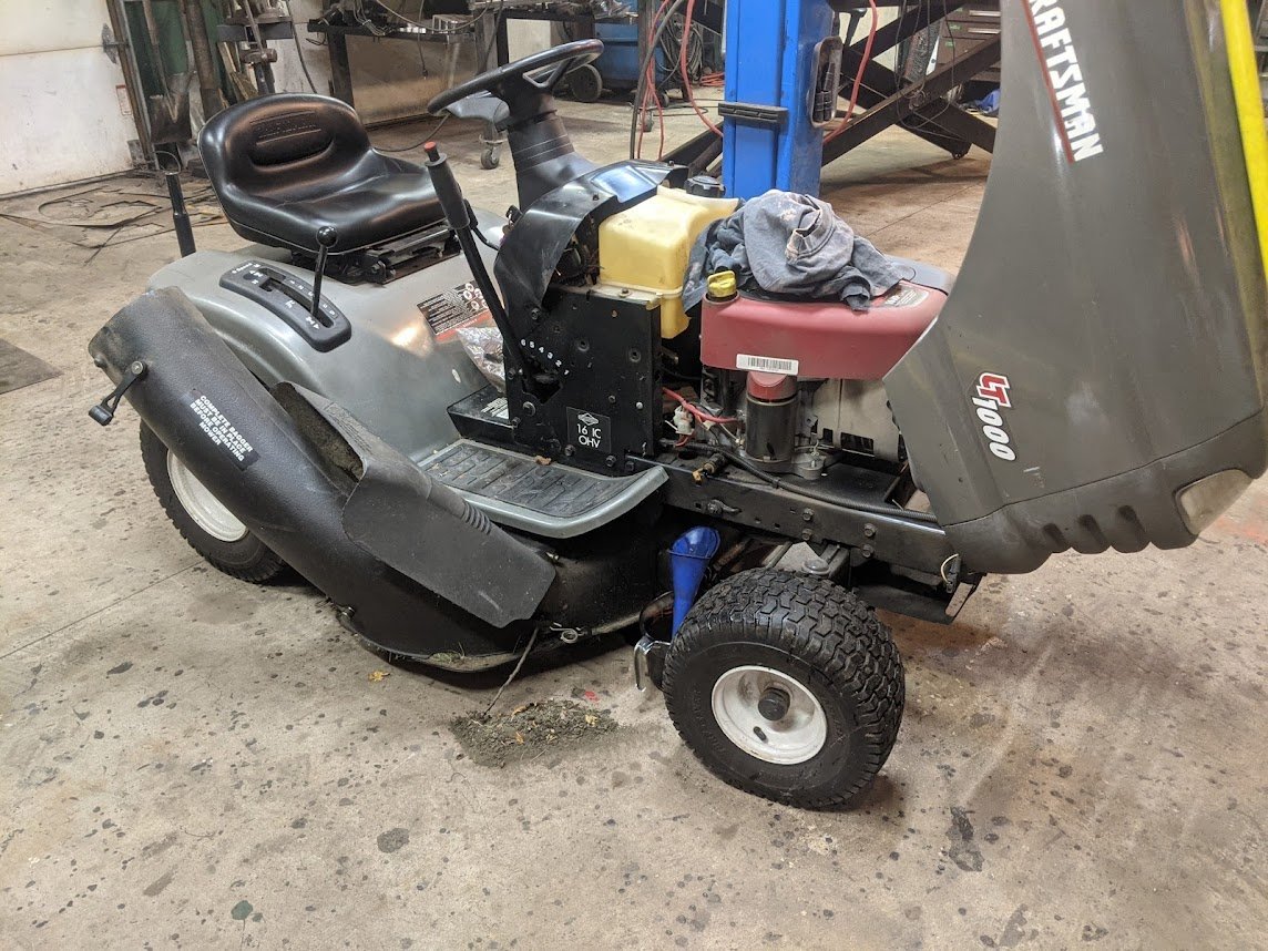

    My 78 year old widow across the street wanted to know if I could pull the deck off her LT 1000 So she could clean it. I said " Why don't you let me take it home and do the job and give it some maintenance?" She was all for that.
    she does all her own yard maint. She is more active than many 30 year old's.
    Oil change (no filter).
    Cleaned the deck and tested the battery (good).
    I do think the starter is getting weak. When the engine hits the compression stroke, the starter wants to hang up.
    The deck was remarkably clean. She said she tried to clean it every year, but missed last year because her grandson was too busy to pull the deck for her.

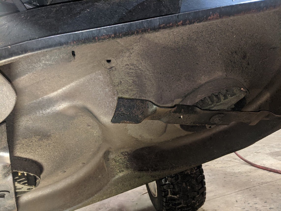

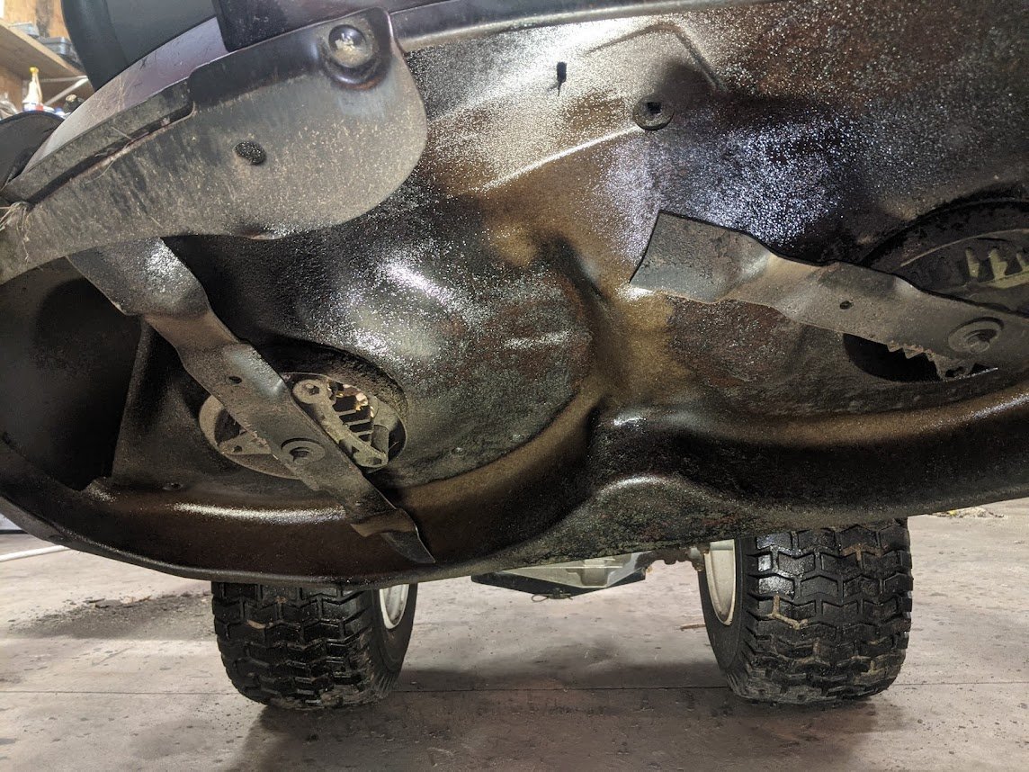

    Since the deck was in such good shape, I gave it a Fluid Film treatment after I used the needle scaler on the grass build up. The needle scaler is the best tool for finding weak spots in the deck sheet metal.
    8w-emTfZfRgyZj2dW1aHV9RRW4JvQ5EjjTH-IjNP_084af7e5232b9f0f8ae42ea51a92d01a1942c1d6.jpg
    JfI6BB3fMr5dD9fshlyWQU2WGauOk4KrUoq8HLwu_789caa94dd2a237848746dda8895c1a795ca701a.jpg
    Before needle scaler cleaning.
    JO9hUIsQNQo4GSUjlhHVb0koqJWiLbltOtEKNz6Q_5f6fb88c421764d627a1541a0ce6a36b96a251f4.jpg
    After needle scaling.

    Fluid Filmed.

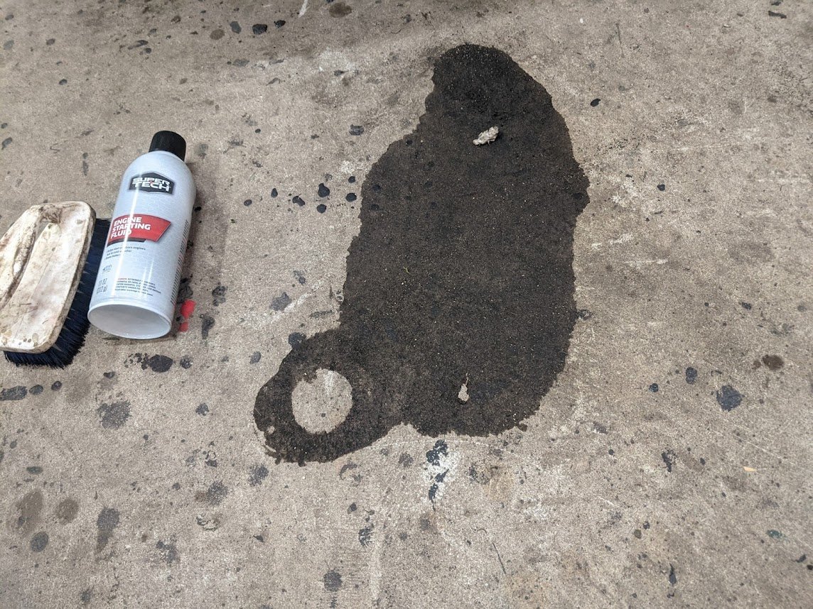

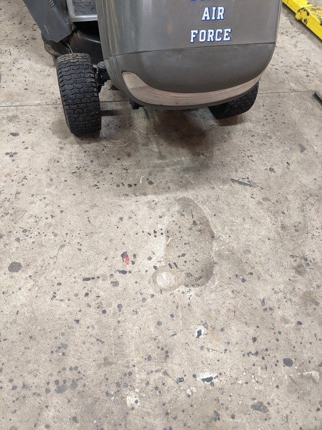

    Wasn't paying attention and missed the drain can. I'm cursed with always leaking some used oil on my floor. It mostly cleaned up.
    And yes this mower has that queer "quick twist" oil drain plug That I hate.

    Oil spots like that can be a pain
    I’ve found that saturating with brake clean and then grinding in oil dry or cat litter while still soaked will pull up most if not all the oil, more so than oil dry by itself. I dispise using oil dry as it’s messy dry on its own, but nessesary evils sometimes. I have the fortune of having good pig mats available to me most of the time, so that gets the default. Brake clean and a pig mat work exceptionally well as well. (I also have brake clean available, partials from work sometimes several cans)

    I found starting fluid works the same as brake clean and it's a dollar a can cheaper. It's almost the same ingredients.
    Starting fluid, scrub with a bridle brush and soak up the residual with an old cotton towel works good enough for me.

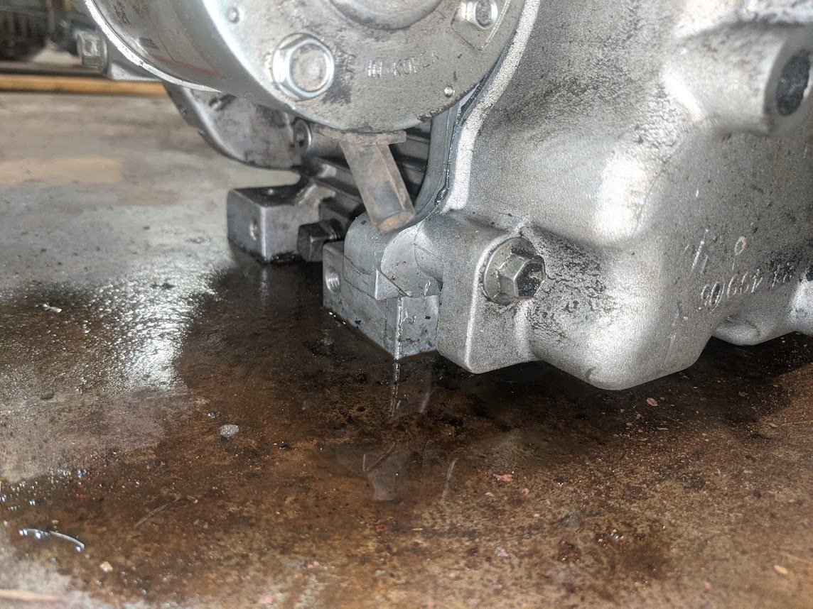

    Bad case sealing. Gasket on the way. BTW, the big, orange filter is now gone.
