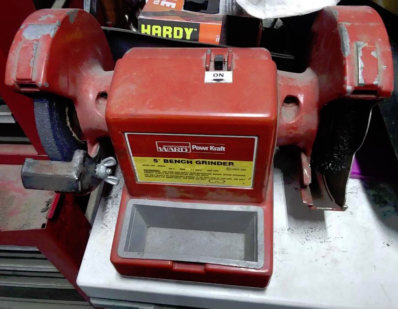

    I have a small bench grinder that would not start (just chugged along slowly) and had no start capacitor in it. For awhile I could help it and it would but it got to where it just chugged. Cleaned/blew it out looking for dry bearings or something and nothing was apparently wrong that I could see. It did the same thing after assembly. I turned it on and spun the shit out of it with my air blower and it started up and has worked fine ever since. I mean--perfectly, no chug, nothing. Starts up and runs better than ever.

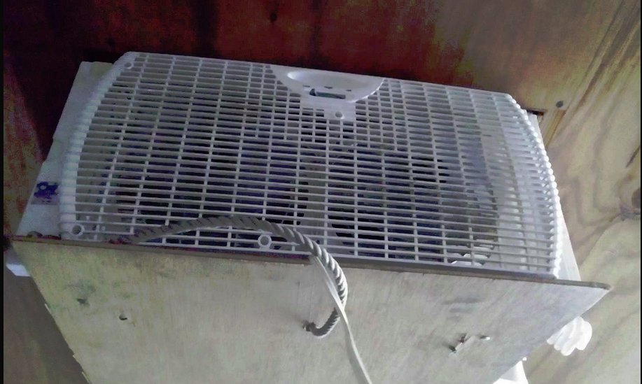

    Just did it again to a fan with one of 2 motors nearly frozen. I couldn't even turn the blade with compressed air. Turned the fan on and ZINGED the hell out of it with the air blower (probably 20,000 rpms lol) and it is now free, starts and works fine. The 2 motors nearly stop coasting at the same time when turned off now--maybe 1-2 seconds quicker stop on the one I zinged. Any ideas here? Worked like a freaking charm on both of these destined for the trash items.

    Dirty brushes maybe? That’s cool they are going good though.

    I guess it could have knocked something off them with the speed. The fan acted like a bearing freezing up, blade was stiff to manually turn over. The grinder would easily spin but not start. I know that this will be my go to from now on before taking anything apart.

    I'm gonna guess the bearings were gunked up. I like the Montgomery Ward grinder though. I have a pump 22 that my grandpa gave me that is a Montgomery Ward. It is so old it doesn't have a serial number.

    The bushings are oil impregnated and if they sit too long, it dries out to a stiff grease. The motor just can't get it moving. Once the grease thins out due to enough movement, it'll work fine most of the time. VERY common with trailer/modular home inducer motors at the beginning of the season. Once you get them moving, they are perfectly fine, they just don't have enough starting amps to overcome the bushing sticking. Probably do 20-25 every fall, I might replace one out of all those and that's because the customer left it on for hours and hours and the board wasn't smart enough to shut off power after start up failure.
    [and yes, I do HVAC as part of my job]

    The grinder spun freely, the fan was sticky.
    I had started the fan many times over the past year to get it going but that one motor always took a boost to get going. I didn't let it cool after super speeding it so the easy start may have been due to liquified grease. I may let it cool off and see if it reverts to slow start. This happened to my new Trane condenser fan but it continued to do it and at one point it had sat all night trying to start after I had gone to bed. It could be started easily but was unreliable. Thank God the tech replaced it under warranty or it would have continued.
    The grinder was easily spun over and would free spin but the motor never had the power to start it. I'm thinking something about knocking scale off the brushes or polishing the rotor or something. I did blow the ever loving heck out of it before I reassembled it so I'm ruling out any debris just sitting in there causing problems.

    I don't believe they are brush type motors. :notsure:
    Many of the older style motors have a centrifugal start switch like this:
    You can usually hear them click on acceleration and again when coasting down. The contacts can get dirty so the start winding isn't in circuit when you turn it on. Spinning them up gets them up in the zone of the run winding.
    The "permanently lubed" bearings can get gummy too, 20 grade non - detergent oil can usually get them smoothed out.
