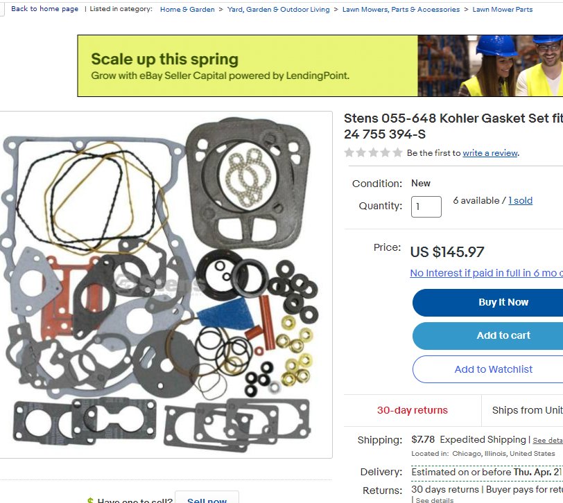

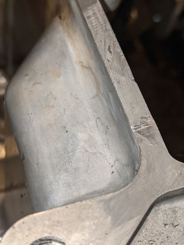

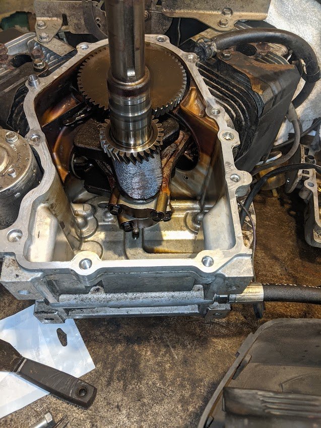

    Question for the wrench heads:
    I took the case cover off this Kohler to find a seal leak.
    I found this gouge on the block side of the engine.
    My question is: will FAG sealant be able to seal off this gouge?
    I'm pretty sure this engine case is a form a gasket case. There was no paper gasket when I took it apart. I can not find a case gasket, maybe someone else wants to take a shot at finding it?
    I did find this kit that shows the correct gasket, but I don't need the rest of them.gask.jpg
    The gouge seems to be about .030 deep (estimate). Of course it is below the water line.
    yLEFMgF35SP49QaXhrzCQa-bcM5H0FErvppgoECM_d7ed1ca1c4a76bd7f113e0c4c343cd16fed93488.jpg
    ML2wTvVmdmTKYwmq8tNn4BgBzErNtg-1yCjVKOVP_c07bcdfd7b5d9aacf8eb645d9c33d211030e43ce.jpg

    You could put some epoxy in the gouge and file it down, go to the auto parts store and get a roll of gasket paper and cut your own gasket. Use the mating part to trace it, etc.

    Reserected from the dead.
    Most likely what I'm gonna end up doing.
    I'm just surprised that seal cant be purchased separate.

    I'd clean it very well and get ALL the oil off I could. Then I'd use a metal epoxy to fill it in, sand it carefully to flush level and seal it with a good gasket sealant if there wasn't a gasket available.
