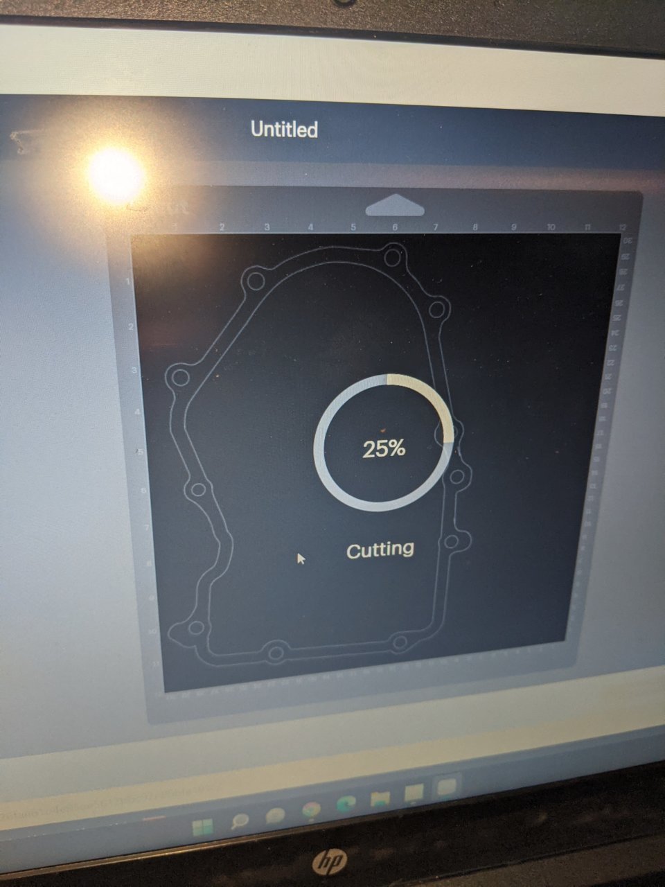

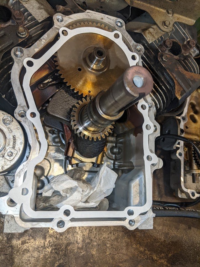

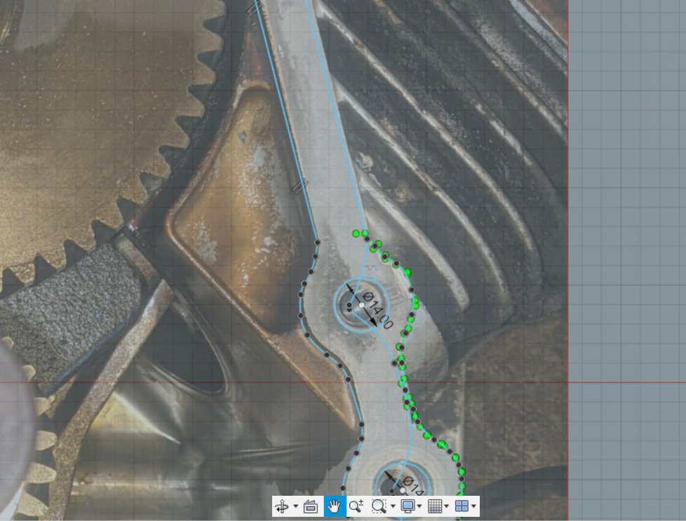

    Once I was done with all the tracing. I was able to extrude the gasket making it 1 mm thick now the computer knows it has some dimension.
    Once I was at that point I was able to save it as a DFX and then I could convert it to a SVG.
    Once it was an SVG I was able to bring it into the cricket design space software.
    At this point it's really easy for the cricket to just cut out the shape that you want.

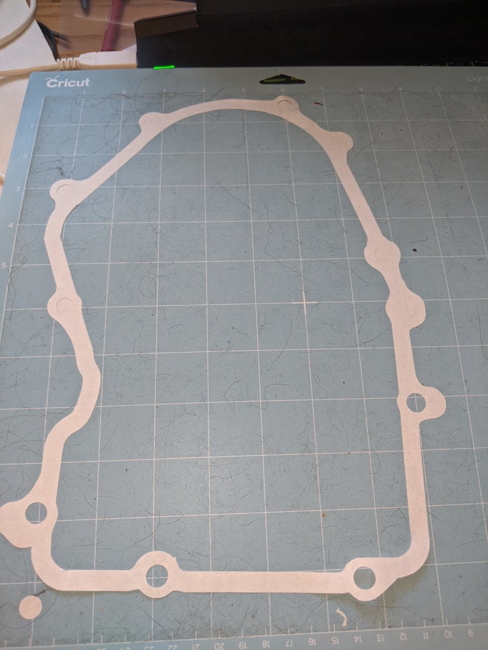

    Unfortunately, the matt for cutting out my gasket was too small. The gasket is 13" tall by 7" wide.
    The standard mat only lets you cut a max size of 11.5" x 11.5". I was okay with this. I have a 12 x 24 mat coming. My gasket material isn't here yet, so not a big deal.
    I was still able to see how well it will work and I'm pretty happy. I'll increase the size and cut a few more out of plain paper until I get the correct size. I'm sure you can get the idea from my picture.
    If I works as well s it should, I'll cut a few more to have on hand or sell. It's bullshit that the only way to get this gasket is to buy the entire $125 set.

    "I'm sure there is a better way to do this, but I haven't found it yet."
    :laugh:
    This is bad @$$, I have messed up making lots of gaskets over the years. :thumbsup:

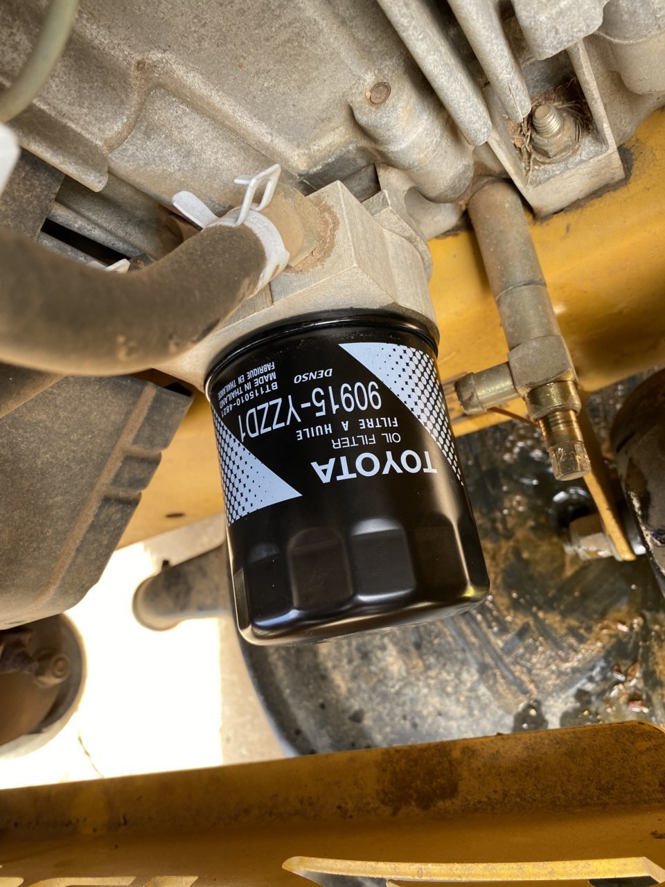

    I just put a Toyota filter on my kohler, got it at Walmart off the shelf.

    The filter off my 2TR is the 90915-YZZG2
    I just came across this post too. I will definitely check to see if it fits next to the steering linkage. That is easy, the toyota filters can be had for like $4 and it fits my truck too.

    I don't know if you have the steering linkage close to your oil filter on yours like mine, but you cannot use a Toyota filter due to clearance. You'll think it'll fit, but it eventually rubs. This is the combo I use on mine:
