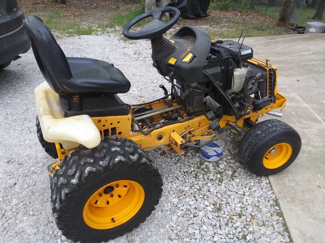

    I ordered a suspension seat for my 3205 brushhog puller after driving it around my field yesterday to heat up the radiator. Reminded me of how the old seat springs bottomed out all last year while hoggin my rough fields. Killed my back.
    Got it for $65 after applying my Amazon CC points. I cut a mounting board for it and will drill it out and then paint it with bedliner spray before mounting it then put the old seat on my 3225 to replace the cracked one.
    The seat will get 1/2" carriage bolts up from the bottom of the board then the board will bolt thru the fender and into the framerails. The suspension seat base is narrower than the framerails on my tractor. This should end up being the same 9" cushion height as my old seat with toolbox base.

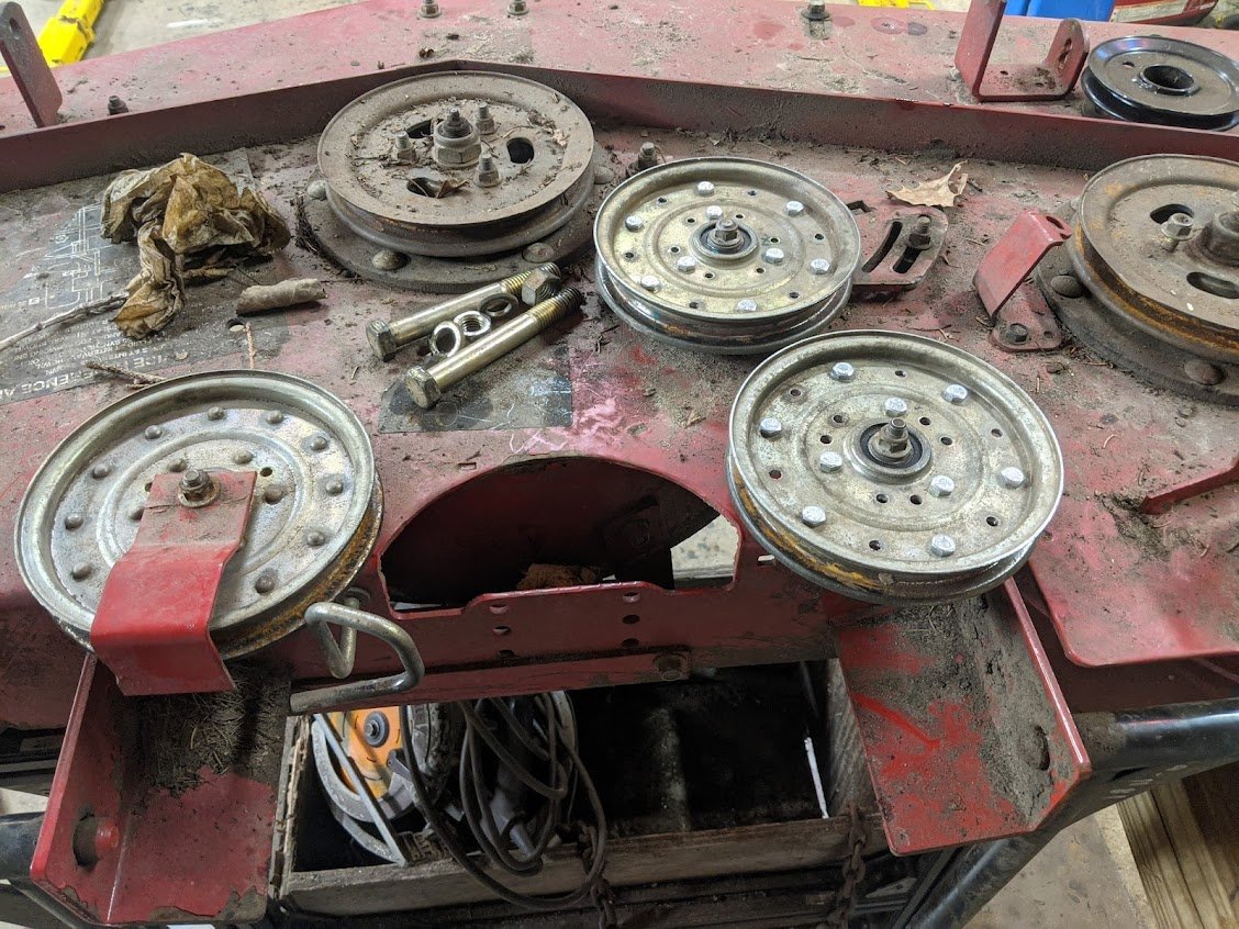

    Started stripping the deck. I already replaced a couple idler pulleys. It was dumb to install them. At the time I was only going to re-bush the deck mount pin holes. You can see them in the bottom of the pic. They are pretty egg shaped.
    There was absolutely nothing wrong with this deck except the 2 bad idlers and the egged out mount holes.
    I started to clean it and get it ready to put it out to the road, but my OCD kicked in. Fuck.

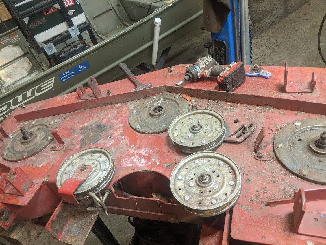

    The grease in these spindle bearings looks brand new! It looks like these spindles and blades were just replaced.
    It's nice getting thrown a bone now and then.

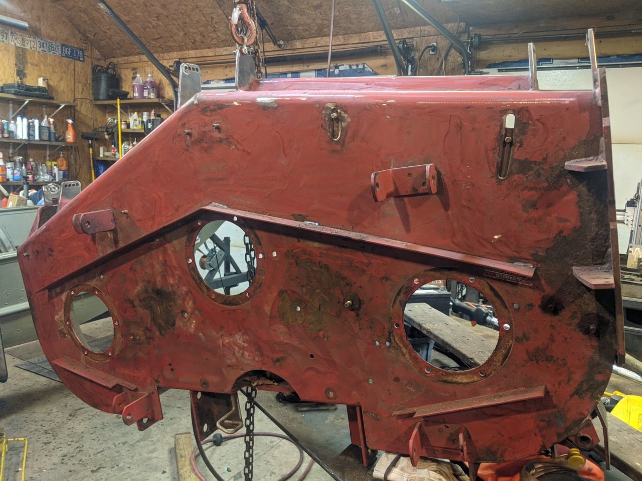

    Bare shell.

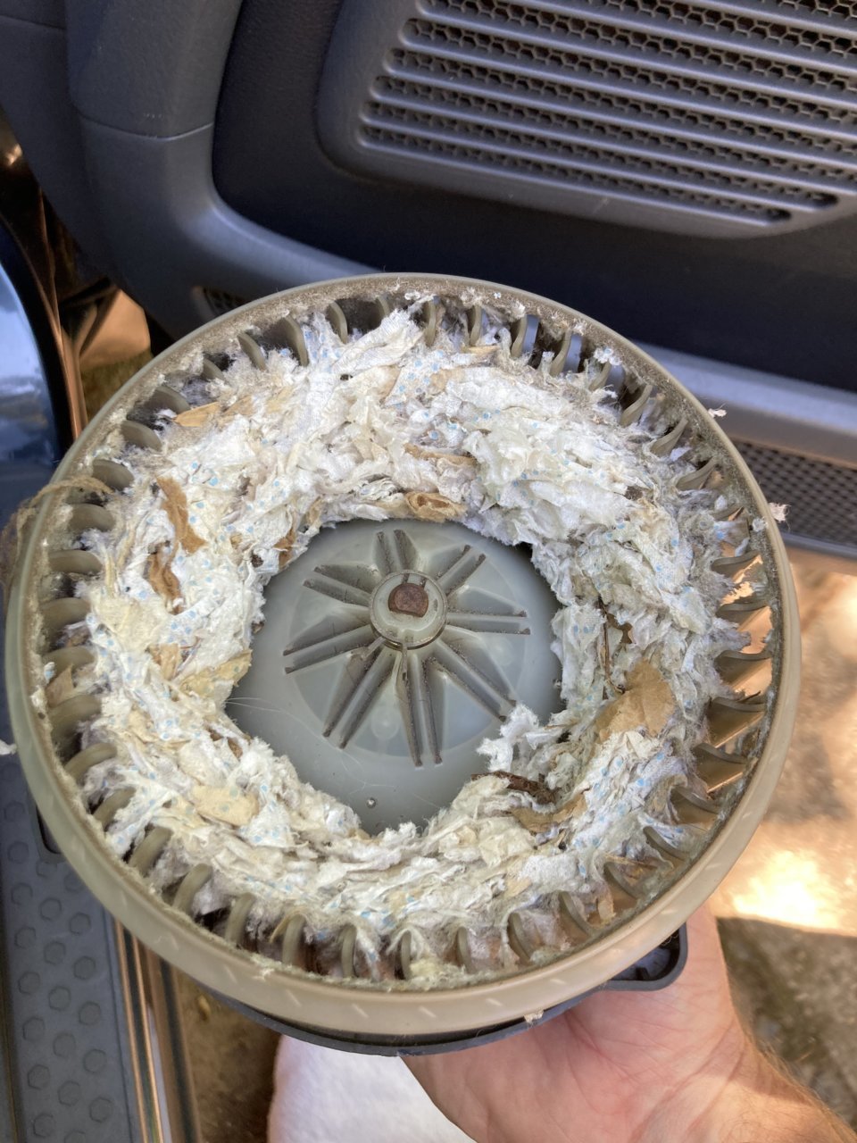

    I hate mice! They have been in 3 of my vehicles. Got into our Honda Pilot after it sitting all winter and it wasn’t blowing any air out of the vents. Started taking it apart and this was the blower motor.

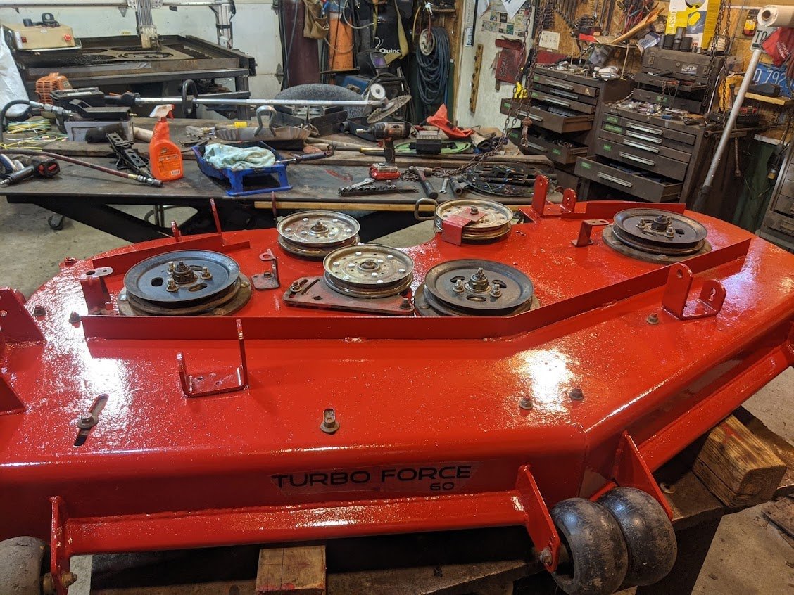

    Deck completely assembled.
    The Cricut cut decal really ties the deck together.
