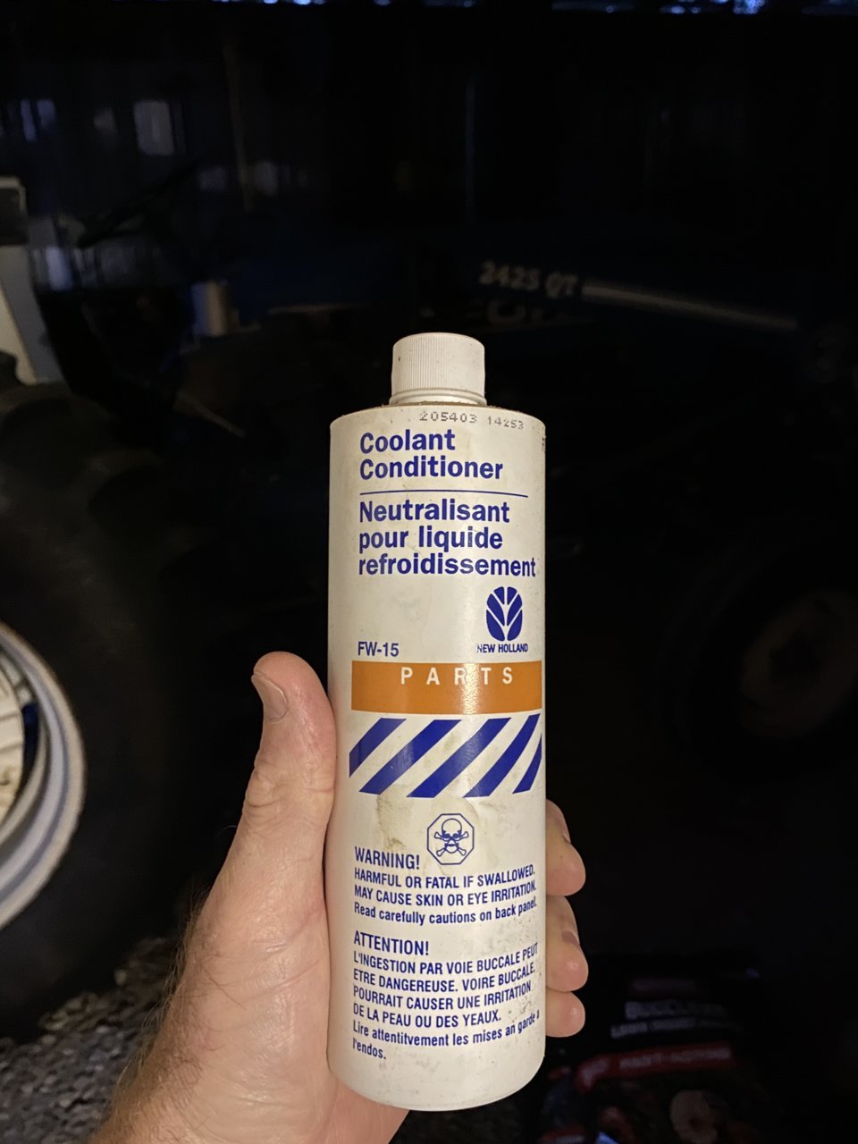

    All this coolant talk got me to thinking. I read in the manual when I bought this 1993 Ford 4630 they made a coolant conditioner and I was changing all the fluids and filters so I grabbed a bottle at the dealer.
    The coolant is the only thing I never got around to changing. Found the receipt in the manual, I bought it in 2016 :anonymous:
    I need to change it and add that conditioner……..soon.

    I don’t know if that bottle says, I’ll look at it in the morning.

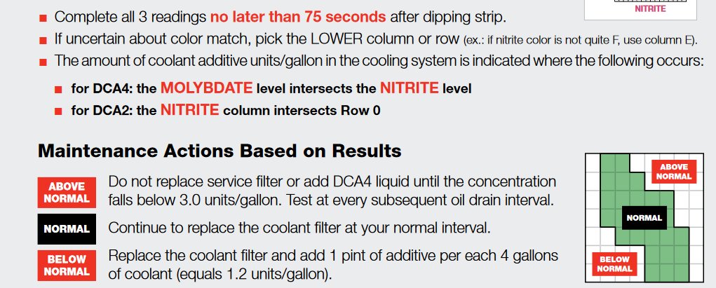

    It's actually valid info. Here's what Fleetguard say about using additive test strips.
    six5crèéd[OP] and RustyGreen like this.
