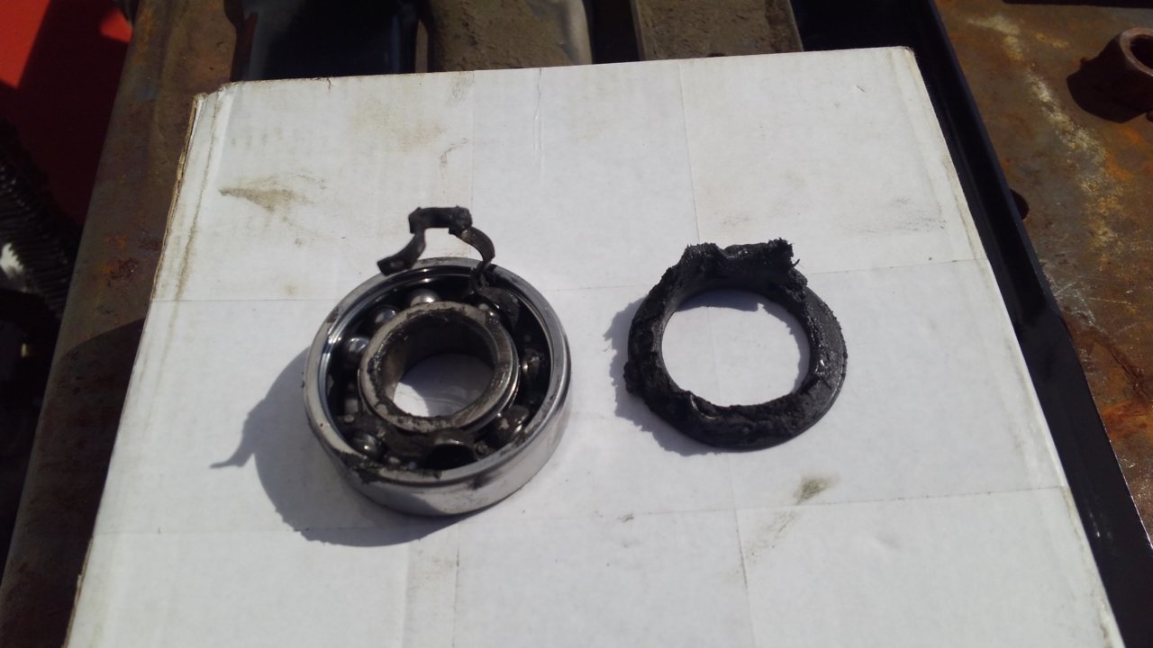

    It threw the deck belt a few times for no apparent reason late in the season so I thought I should look under there.
    This might have been part of "that funny noise"...

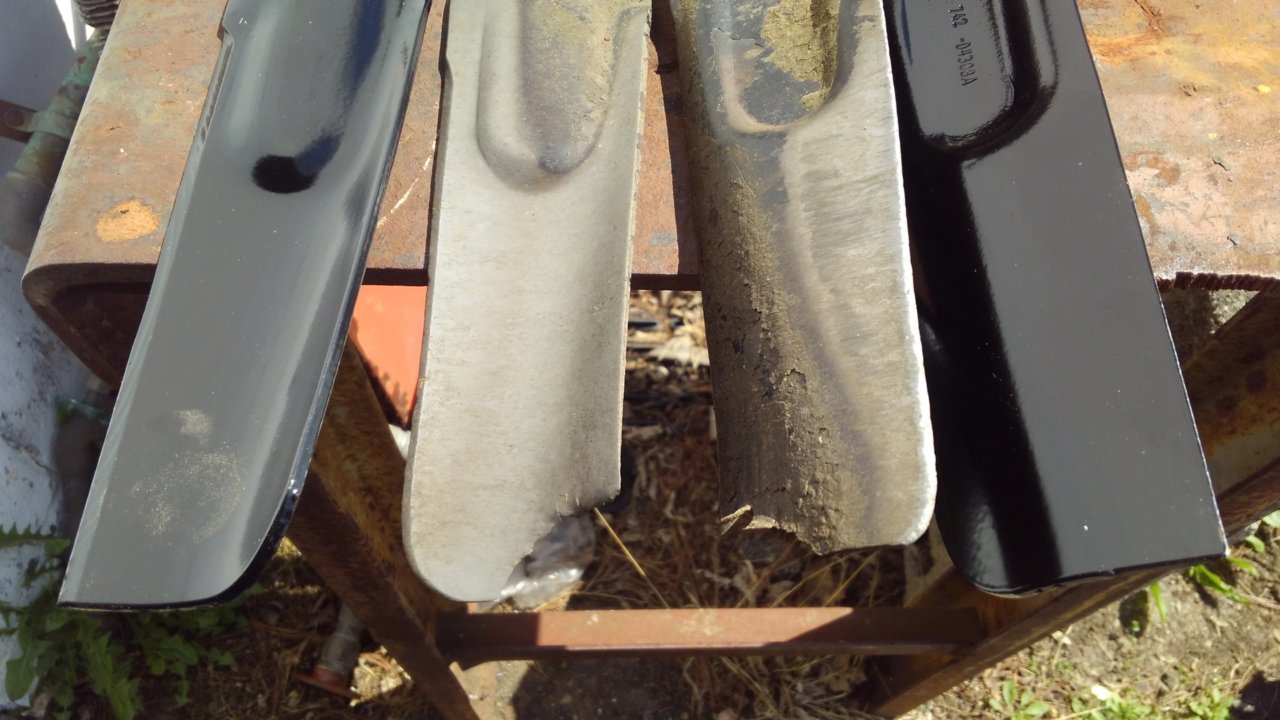

    Times are tough and I try to get my wear out of things, think I did OK with these blades? Probably 2 seasons worth. New ones were $55. :mad:
    They aren't actually the "correct" blades for the ZT, the originals were made of a material similar to tin foil -- but not as strong... They would bend mowing wet grass I swear and if you touched a twig or pebble it was all over. I probably bought 15 sets before I found these.
    New deck bearings, blades, pulleys, belt and I drilled the idlers apart and put bearings in them for the first time and changed the discharge deflector (I have a parts machine).

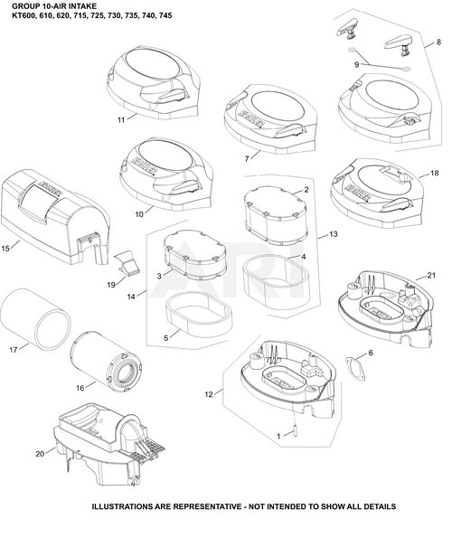

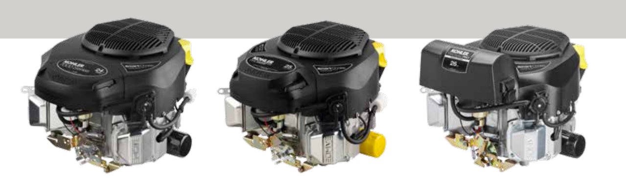

    Is anyone super familiar with the Kohler 7000 Series engines?
    They have three air intake setups. Small, medium, and "Pro".
    My KT740-3085 uses the small. (Ref. 7, 12, 14)
    I wonder if I could purchase individual parts and upgrade it to the Pro. (15, 16, 17, 19, 20)
    I did see one forum post where someone upgraded to the medium. So I know that should work. (10, 13, 21)
    That would help a lot with my dusty conditions concern.
    I think that might void warranty unless maybe I get the dealer to sign off on it.

    Theoretically it should work, I don't see why it would mess with the warranty unless they just wanted to get anal about it.

    I'm pretty up to speed on the Command versions.
    They have different grades of air filters as will.
    The only difference is the filters. The carburators are the same.
    I would see no reason you couldn't upgrade.
    I'd bet the filters fit both engines as well.
  19. May 2, 2022 at 6:49 AM
    #6979
    koditten
    koditten Well-Known Member
    Sep 8, 2013
    #112077
    19,763
    Kirk
    Central Michigan
    04 trd x-cab 4 x 4 3.4l
    Reserected from the dead.
    I do know Kohler Command engines change their service intervals from 20, to 50 to 100 hour as you move to better air filters .

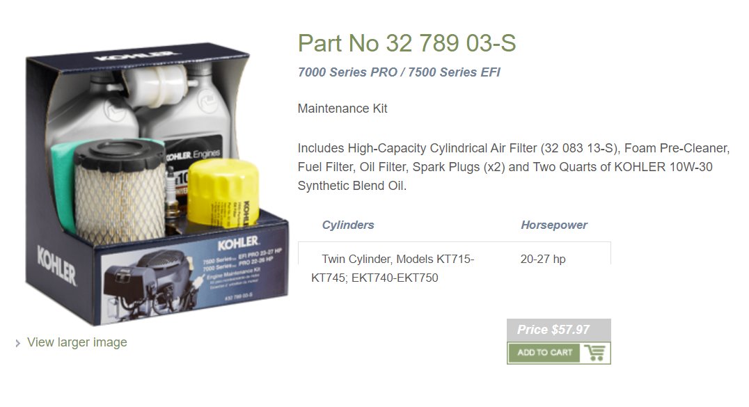

    I'll be going with what Kohler recommends, which to no surprise, is synthetic. Kohler Engines Parts - oil, air filters, spark plugs, maintenance
