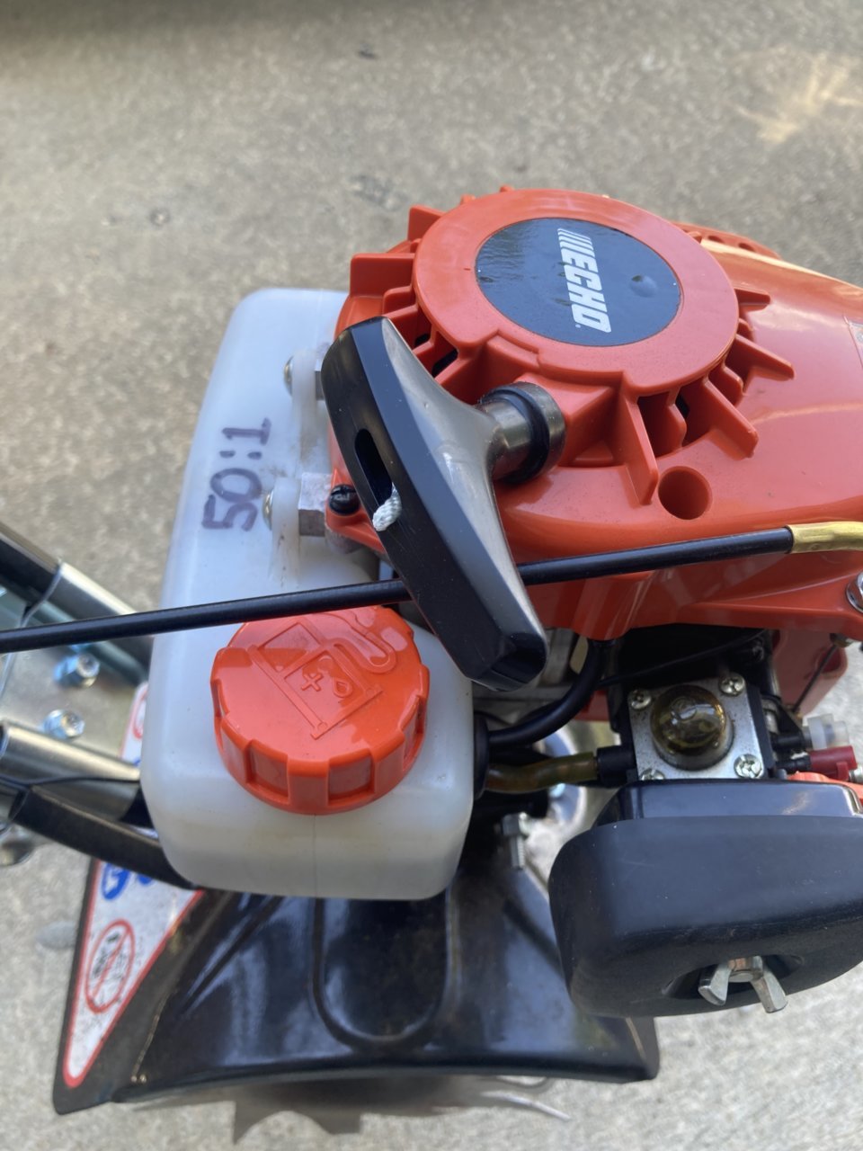

    Does the gas cap have a small hole in the top of it? Like @six5crèéd said, they have to breathe. Post a pic of the gas tank.

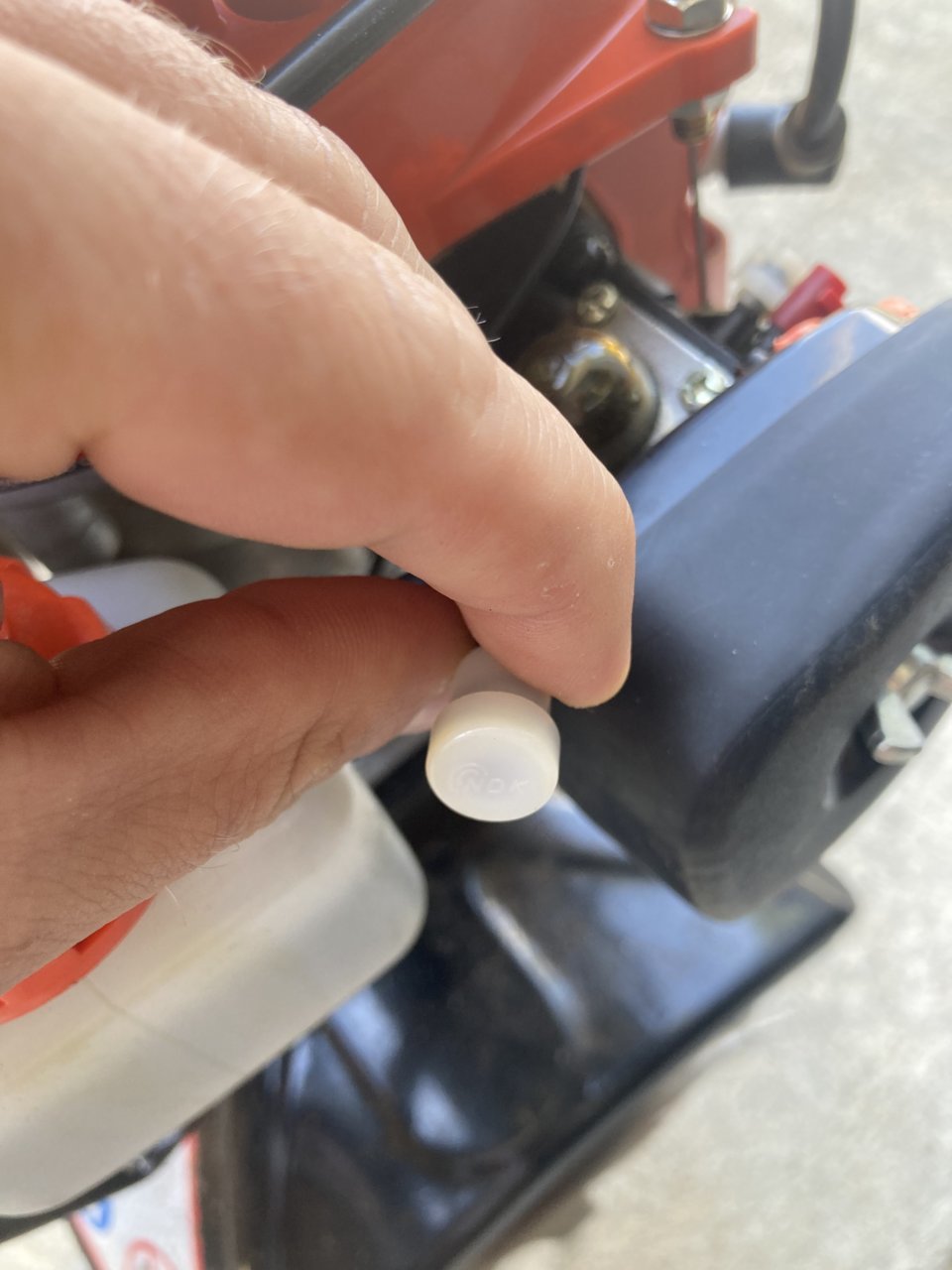

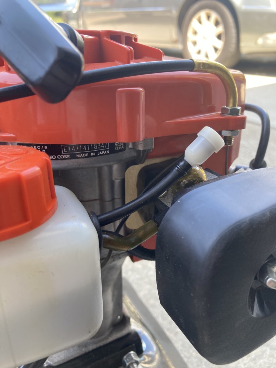

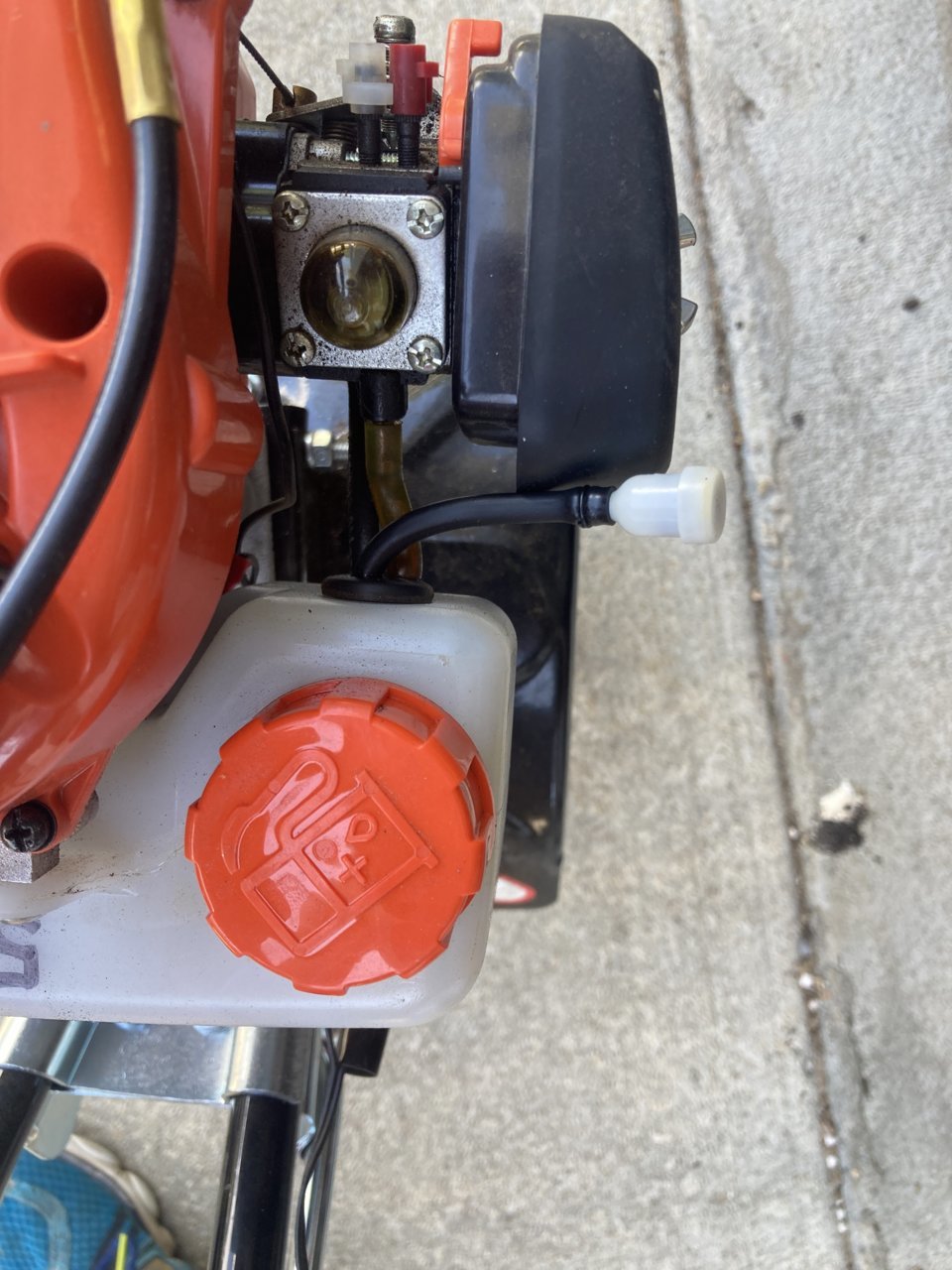

    Here’s the gas tank and what I think is the breather.

    I’ve never seen one of those before. Everything I’ve owned had a hole in the center of the cap.

    I've never seen one but did a search and you can get a 20 pack cheap enough, be worth a try to replace it and see if it is your problem.

    Might be some new safety feature, maybe with a 1 way valve?

    Bet there is a check valve in the white part stuck or gummed up. It's really the only logical explanation.
    Stuck shut causing your issue of course.

    Probably a reason you can get 20 of them for $12. Not a good sign.
    I'd pull the tubing off of it and hit it with some brake cleaner and see what happens if you gotta have it working now.

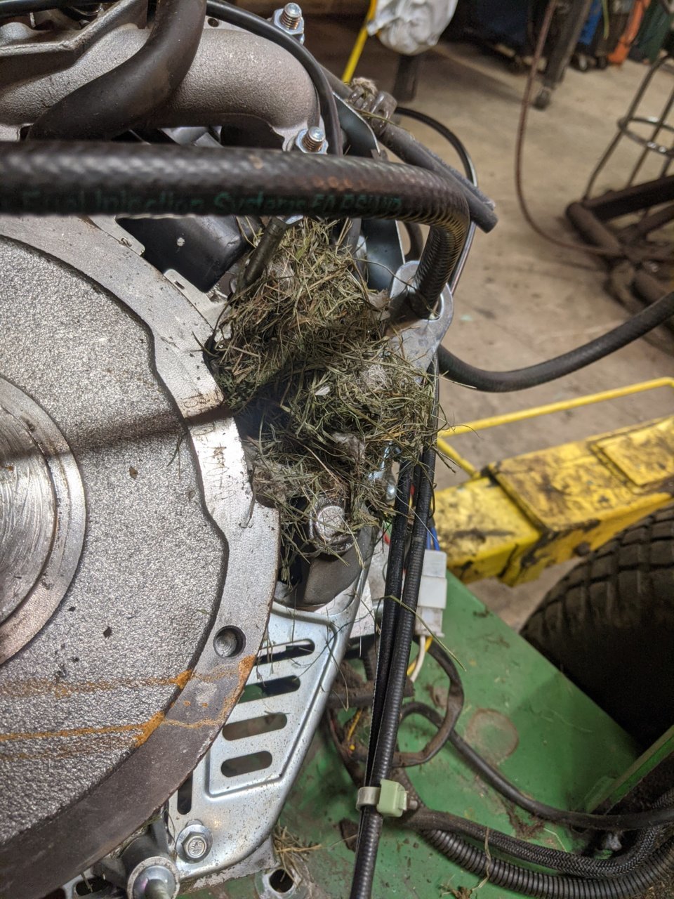

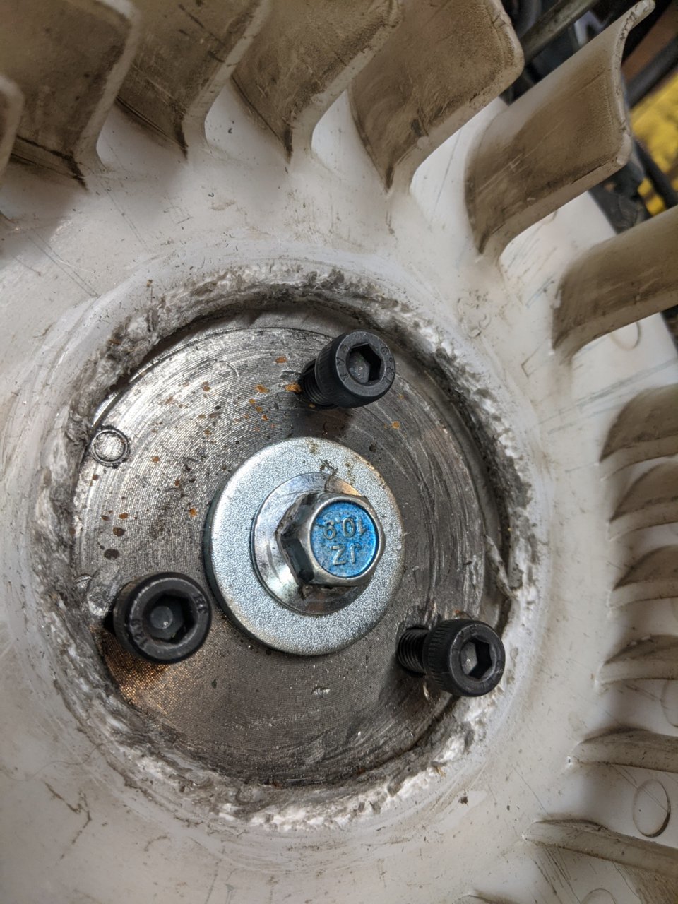

    Had one of my Predator powered project come back today.
    Thought it was warranty work.
    Nope.

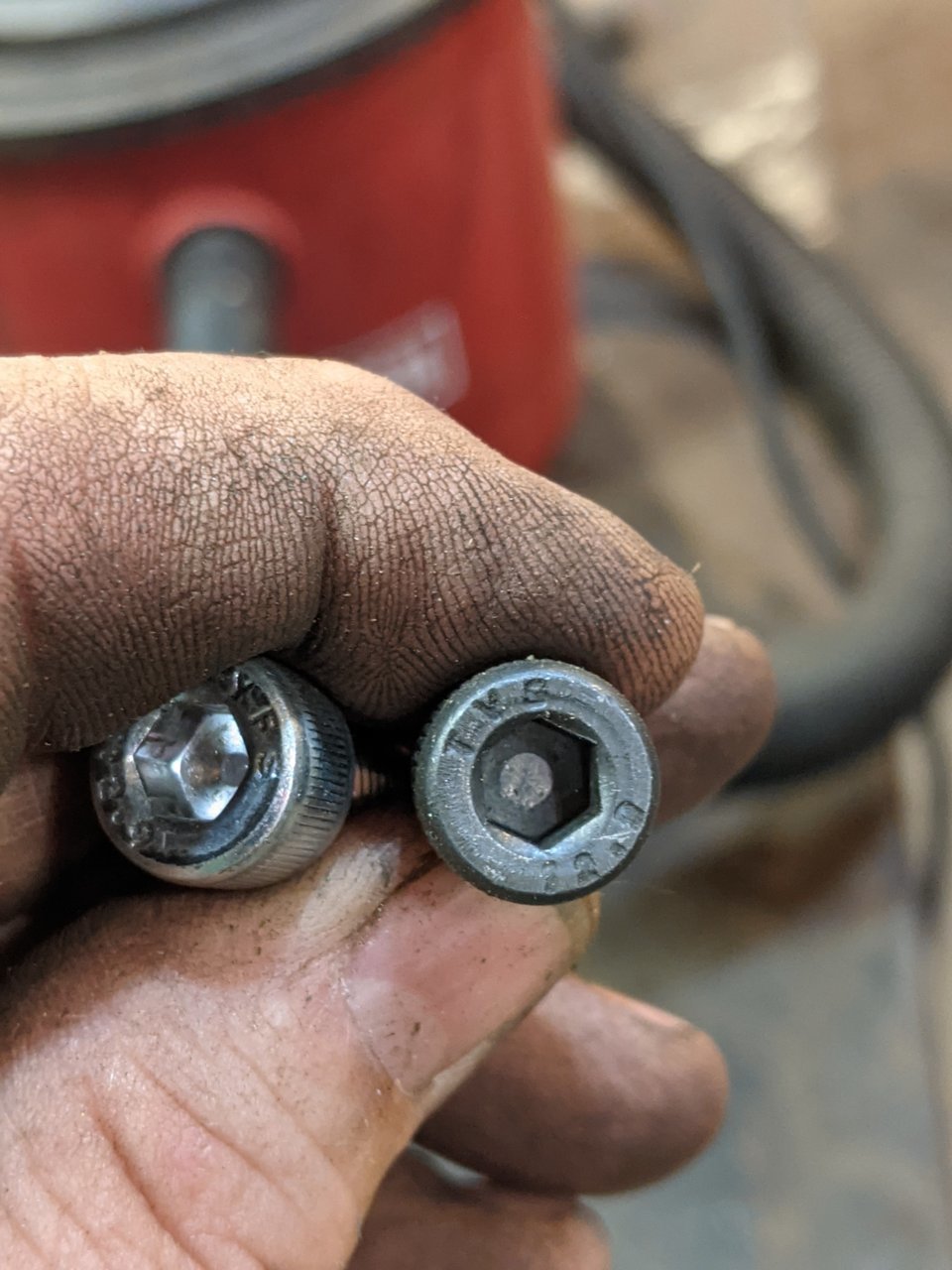

    Mouse nest got in the drive pulley and and wedged the belt causing shearing of the bolts.
    There was a second mouse nest in the fan fins.
    It did take out the fan when this happened, but no structural damage to the engine.
    If course, the use of Easy Outs is never a joyfully time.
    I hope I'm not making a mistake replacing the stainless with black oxide bolts.
    Anyone know which is a more durable bolt?
  13. May 4, 2022 at 2:16 PM
    #7013

    My Name is Rahl
    Jul 5, 2018
    #258370
    22,105
    The bolt with the blue paint is metric grade 10.9 or a grade 8 equivalent. Metric 12.9 is Grade 9 equivalent.
    The difference is in the metallurgy, not in the finish. A Black Oxide finish is the least corrosion resistant followed by Zinc finish. Zinc finish will only give you about 3 months before red surface rust. Even Yellow Zinc isn't any better. You need a Geomet coating, especially for finer threads like on SHCS. It's a dacrotizing, or cold mechanical zinc, finish and it's just as good as galvanized.
    If you give me a size, I can get you the a link to a properly finished SHCS.

    koditten
    koditten Well-Known Member
    Sep 8, 2013
    #112077
    19,959
    Kirk
    Central Michigan
    04 trd x-cab 4 x 4 3.4l
    Reserected from the dead.
    Great! Glad to see the Republic of China sprung for a quality flywheel to crank bolt!
    I figured it was a finish thing.
    I'll measure the bolts and report back .
    Thanks for the response.
    Sep 8, 2013
    #112077
    19,959
    Kirk
    Central Michigan
