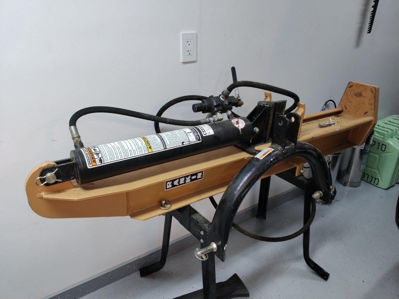

    What do you guys thing about this one?

    Pretty nice! Better grab it. They have very simple carbs. Clean it and fresh mix and you are off and running.

    He offered it to me for $50 so I guess I have to buy it now :rofl:

    Looks like the country line top ends on a 3pt frame.

    Same color and design. But, made in Washington instead of China.

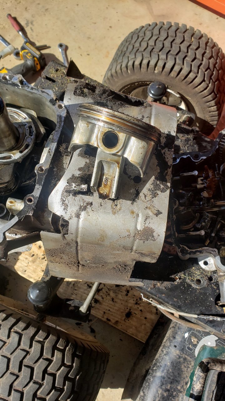

    Well, the valves were good lol. Not a big shock, just was hoping to be wrong. It's ok though, because the Con Rod and Head Gasket seemed to be in a race to fail and the HG may not have won, but it was close to blowing out anyways. Off to FBM to find the Siamese twin for this thing and rob its motor.

    Sorry she "blew a rod" man. <--That saying has been a joke between a friend and I for decades.
