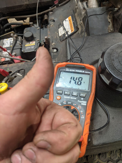

    Finally got the repair job done. New voltage regulator. 1k RPM gets me awesome voltage.

    just got to check it out a little. 11.8V on the battery, and 12.1V while running.

    That's not enough. It's not charging. Like said, check fuse 1st.

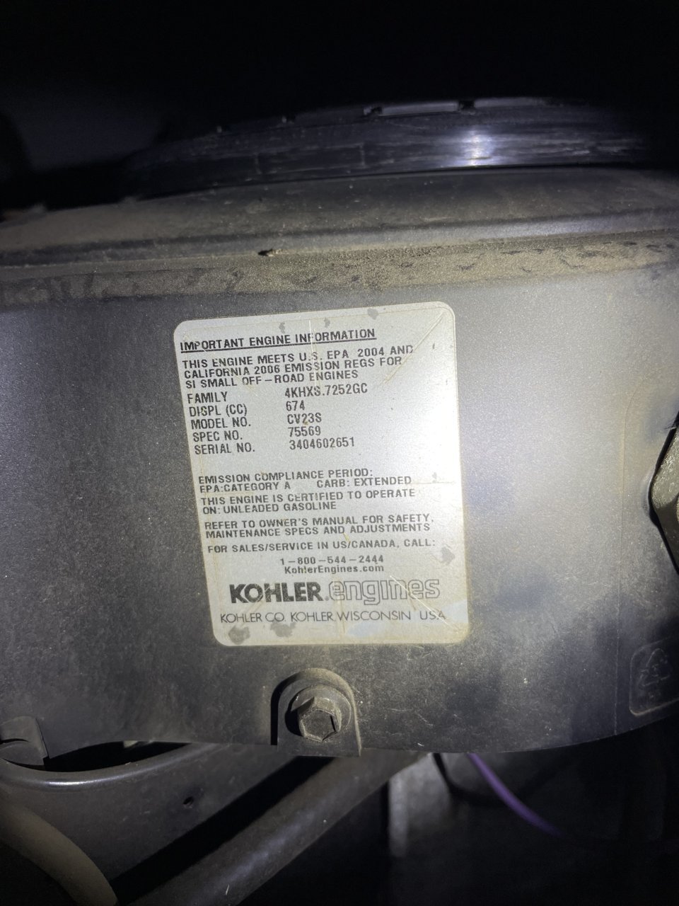

    Can you take a pic of the tag on the side of the engine? It should say Kohler Command and some numbers/letters after that.
    CH 750-0026 is the number of the unit I was working with. Yours will be similar if it's a Kohler Command engine.
    CH means Command, horizontal shaft.
    CV means Command, vertical.
    With that number you can figure which voltage regulator is used on that engine

    Cv23s is my model code.
