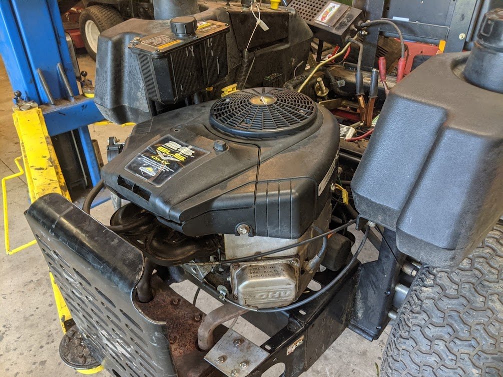

    Engine transplant for this one done. Original power was 19hp Kawasaki. Now has a 26 hp Briggs and Stratton ESL. ESL, sure. A single paper air filter.
    Oddly enough the donor tractor had an hour meter. 580 hours. Hopefully someone just left the key a few times. The chassis meter on the toro has 619 hours. Close enough for me.
    It does sound amazing and just purrs. Gonna use it for a week then peddle it.

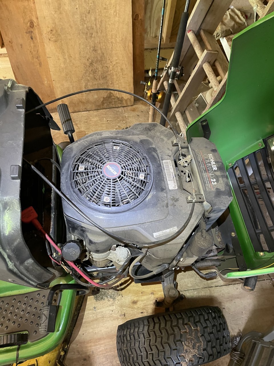

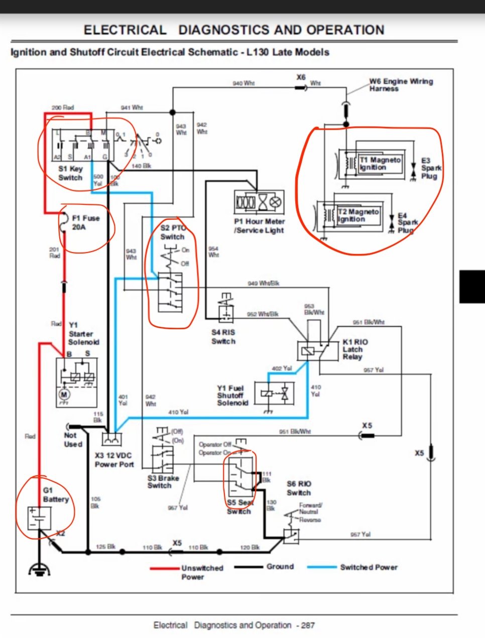

    Well, I got the grass cut today and at least the mower cranks better now with a new battery. same problems as before so I had to stand up, give myself the ol reach around and wiggle the seat safety switch wires to get it to shut off before I could get the PTO to engage. still "troubleshooting". at least it only took once this time. :D
    And since y’all like pictures, here’s my dusty mower and dirty messy shed. E06392B1-CF59-42EC-B389-A59968D2CB15.jpgE904A0E7-DC56-499F-95E2-08F2344E7694.jpg

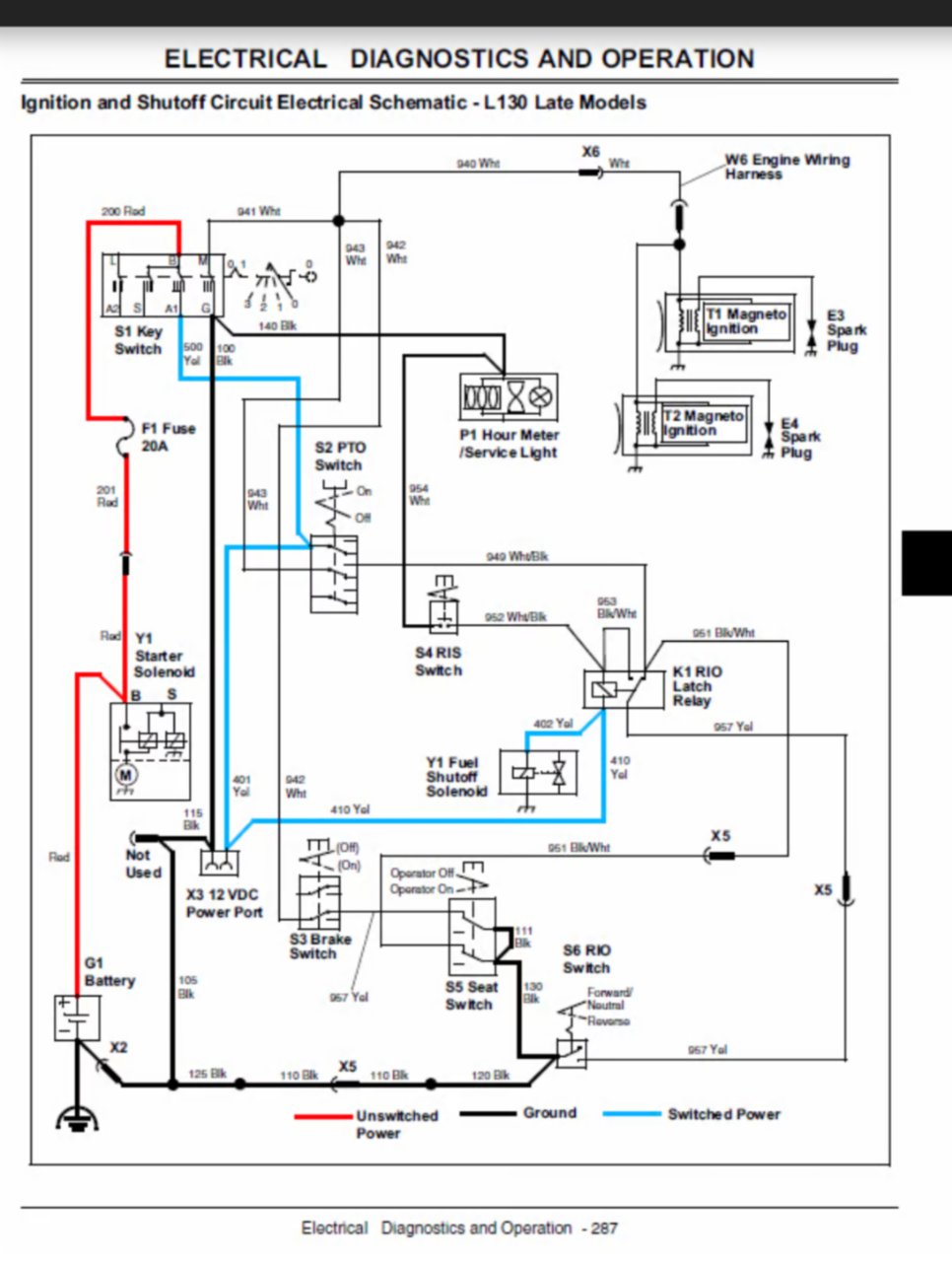

    What is this mower? I want to down load the wire diagram.

    John Deere L130. the problem has to be somewhere in the harness with me being able to affect it by wiggling wires. (although it doesnt always work:))

    I think this is the wire schematic.
    Thanks for the diagram by the way. this will be useful.

    what's the "latch Relay" do in that diagram?

    I was just looking at that. Relays are pretty easy to spot. Can you swap that relay?

    I'm sure I could. that's the next thing in line with the seat switch, although its pretty far away for a little wiggle to reach. also, my hood doesn't always sit flush where it should, so would that relay do anything if it wasnt shut? I don't think there's a sensor for the hood being shut.

    I believe this relay allows you keep the blades running while switching to reverse. If it works, the engine stays running, if it's not working, the engine dies.
    It this similar to your symptoms?
