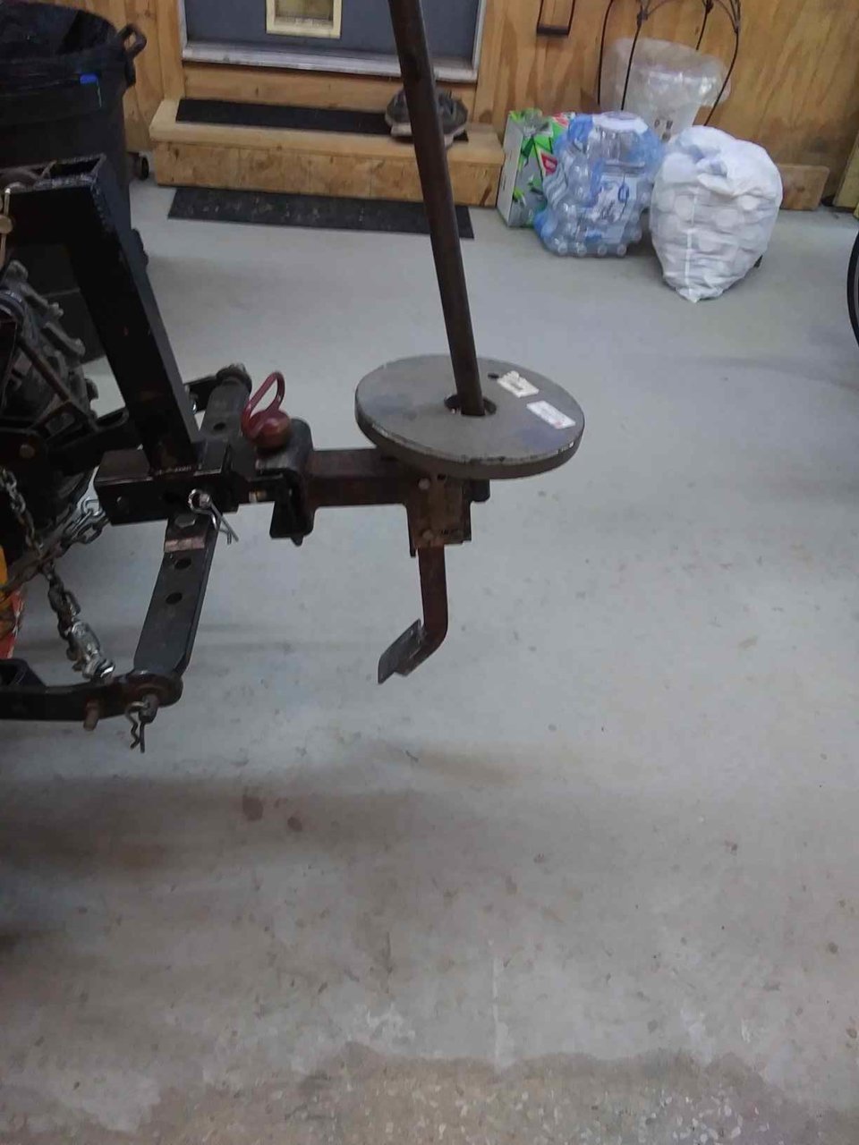

    Git Sum!! At 0 lbs of weight this was just a scratcher, at 200lbs I'm ripping 1.5" roots in half and turning up grapefruit sized rocks without a blip. The only badness I can see happening is the shank body breaking where I drilled it. I may put a block in there behind it to support it.

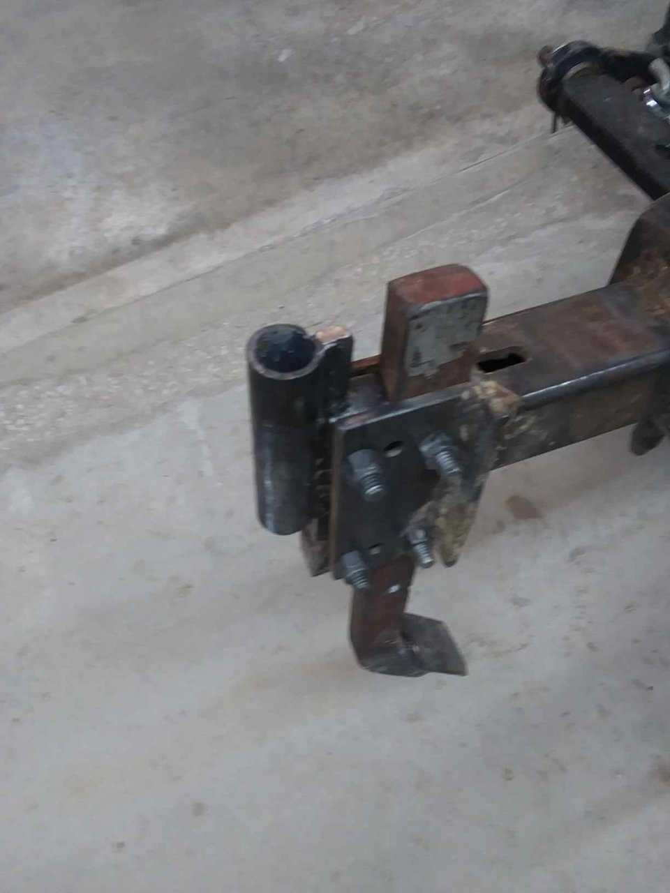

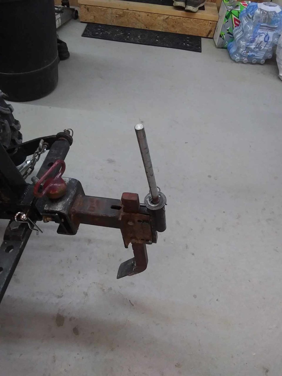

    Went back and added a backer block. While I was at it I welded a pipe on the backer to let me hang weight directly on the shank.

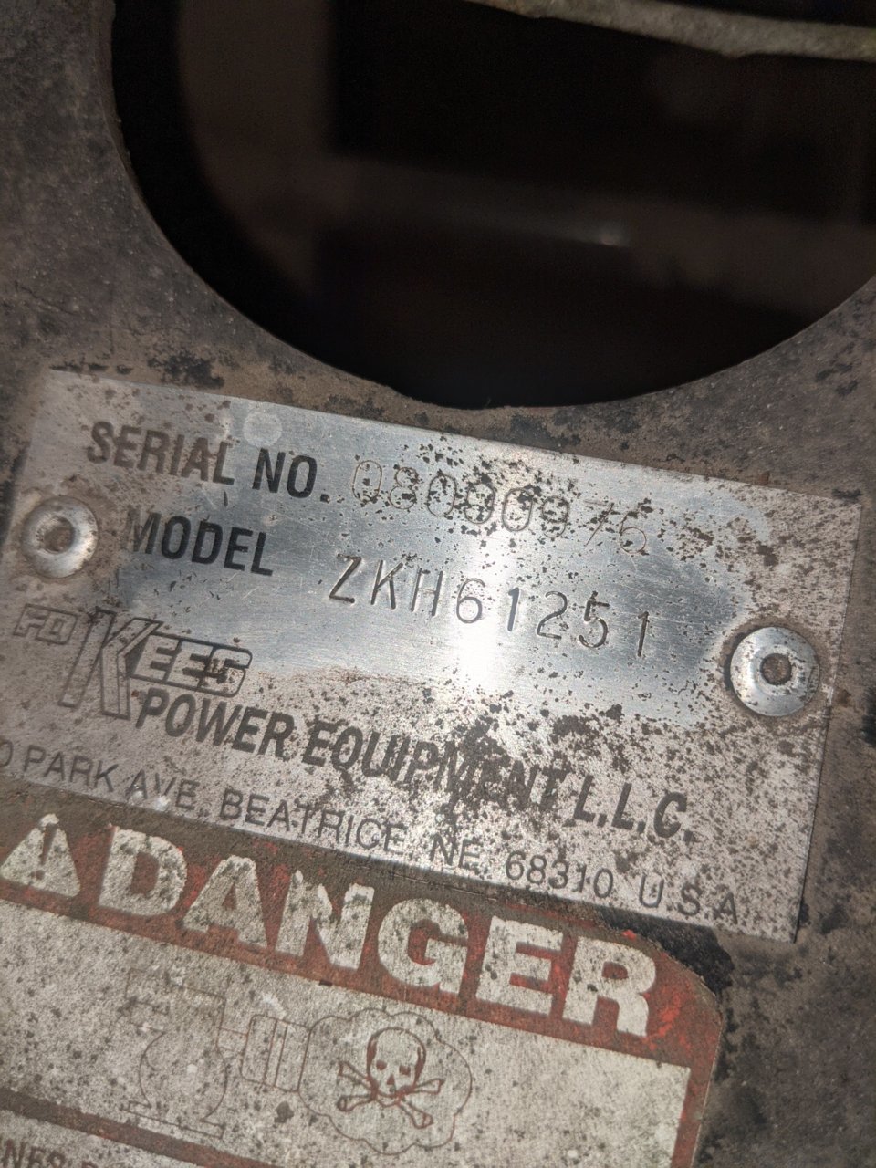

    Trying to find belts for this.
    Yazoo kees ZT mower.
    It has 2 belts for the deck. One belt drives a jack shaft on the deck and the other is for the deck itself.
    I can not find the parts diagram for this thing.
    I measured the belts.
    5/8 x 112ish
    5/8 x 138ish
    I'm done with hunting today. Someone else wants a challenge, go for it!

    Are they toothed? Or just V-belts?

    Found one that says "deck belt" double V 5/8" x 115" https://www.jackssmallengines.com/Products/YAZOO/Belts/Exact-Replacement-Belts

    Thanks for links! That will help.

    Do 3pt subsoilers have shear pins?

    I mean your little plastic drive shafts might appreciate some.
    When I was a plow boy all our implements had breakaways or kicks or shear pins so that you don’t wreck everything at once.
    That is different than a dozer with a ripper blade but I think those still have some planned early point of failure.

    Thinking back on what it took to break those barrels in the 3205 I'm amazed I didn't do it sooner. I was pretty indiscriminately yanking a 500lb brushhog around when it was stuck--thru low spots where I got stuck, backed up and sped up to ram it thru lol.
    I know I won't shear the barrels with the subsoiler as it is a slow process without any high speed idiot maneuvers like I did with the 3205 but it wouldn't be a bad idea to add shear bolts. Do you have a source for 3/8" x1.5" shear bolts?

    I might have a bin from an old snow blower but other than that I’ll need a few more specs. Those usually are specifically for material to material mating. Like 3/16” thick tube wall on a 1/2” shaft. I’ll peak into my parts and reference tables that I can find.
