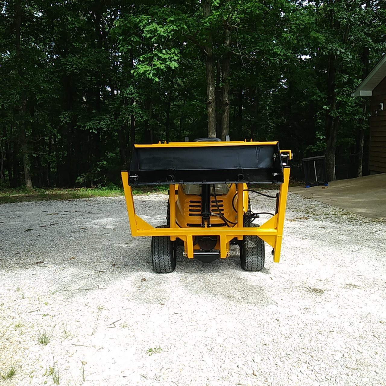

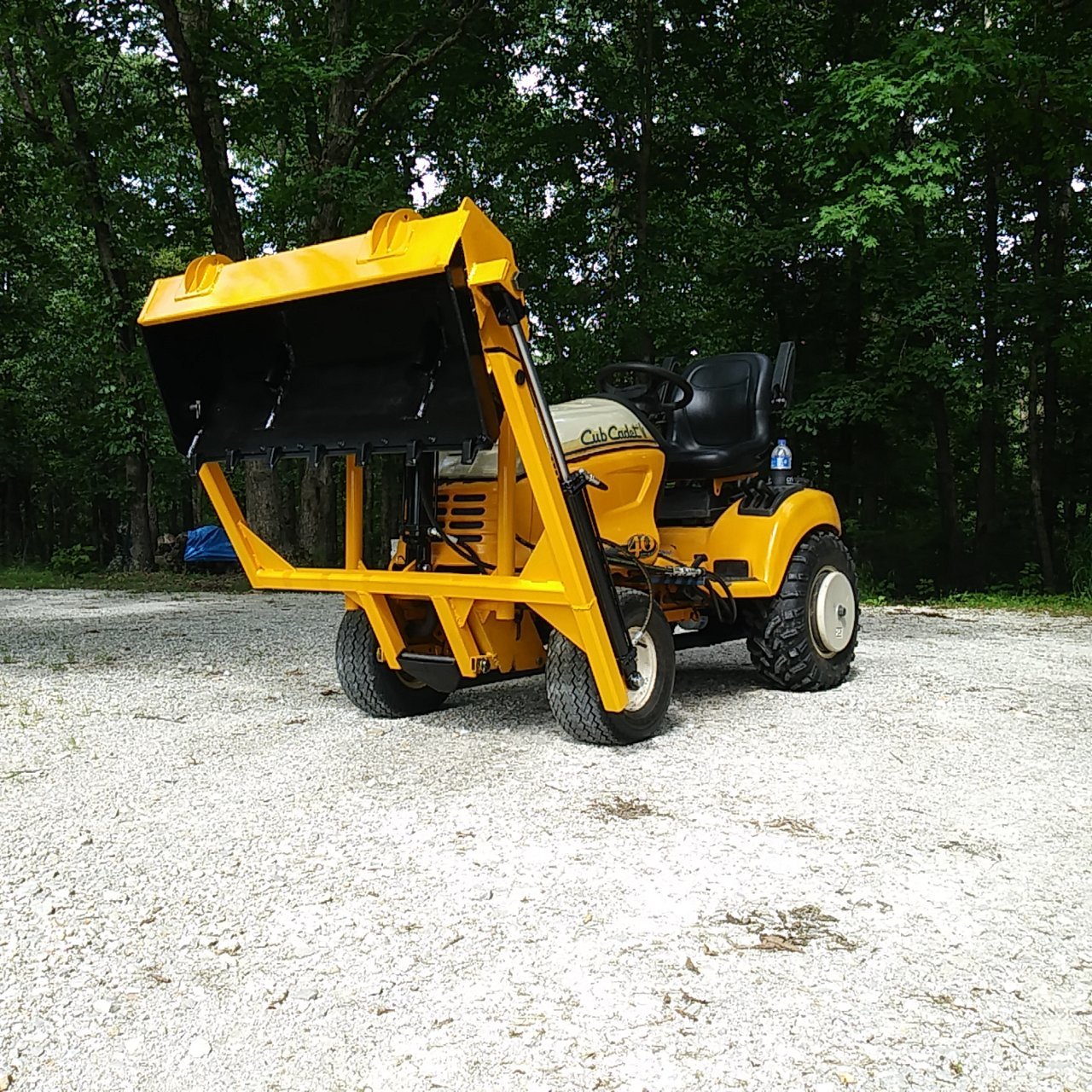

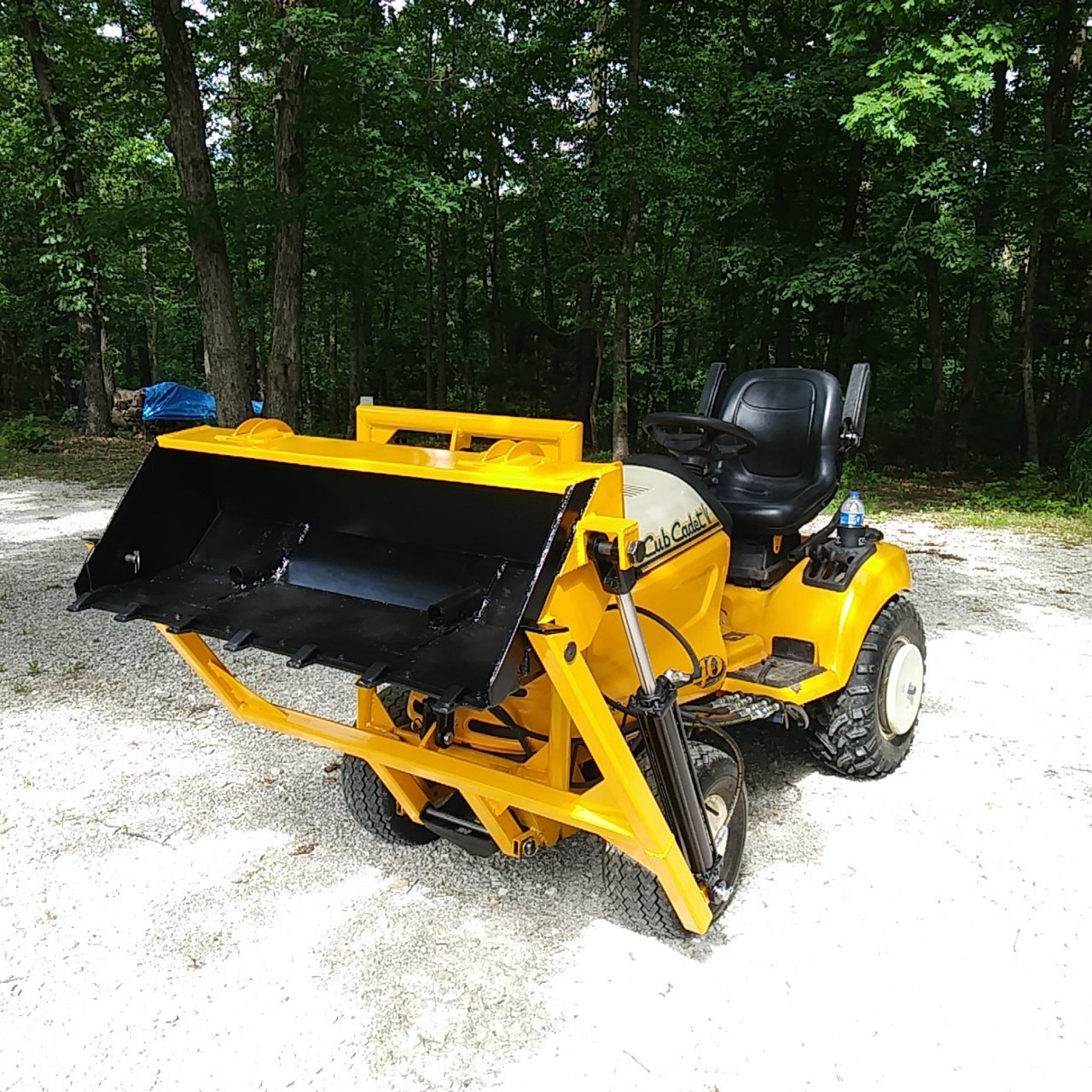

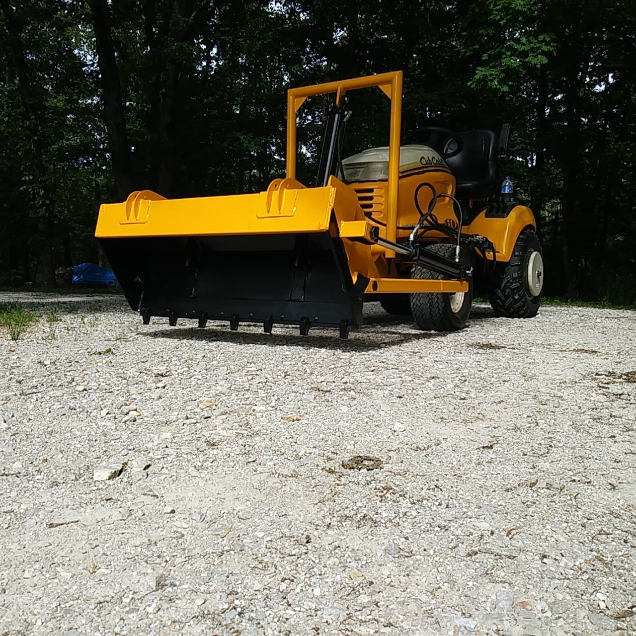

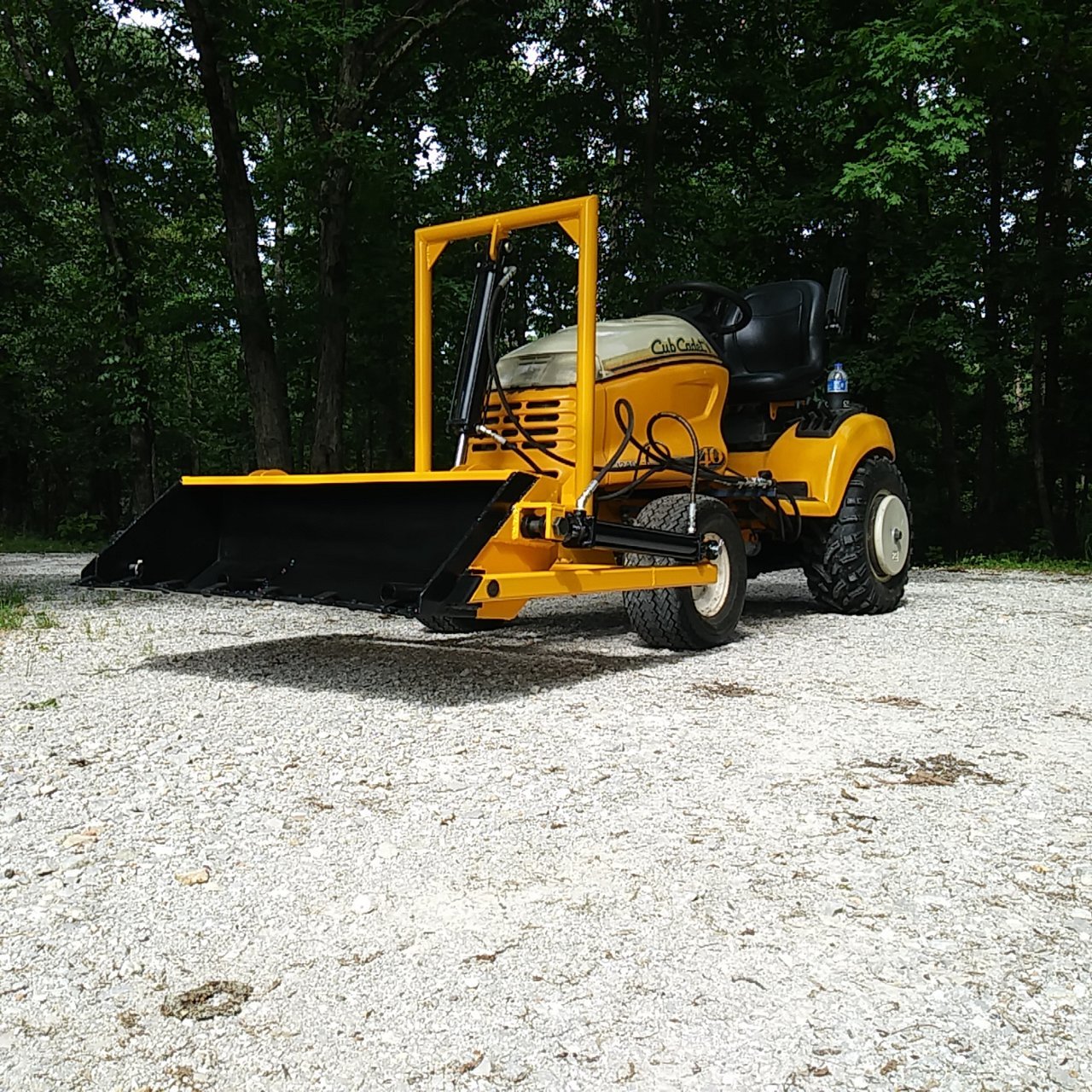

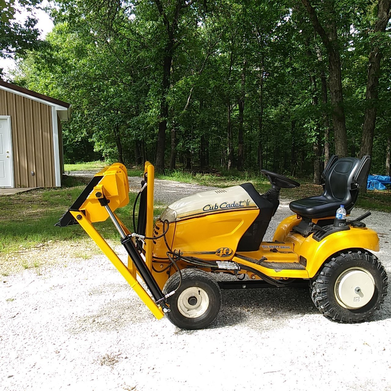

    Just about got Version 2 of my Swisher bucket done. Just have to connect the ATV chassis to the midpoint of my frame. It currently connects the front pivot pin to the rear hitch plate.

    That looks great :thumbsup:

    Thanks duder!
    This fixes several problems I had with V1, mainly no dump height. I had to raise the other setup 24" to dump flat on the ground. I can raise the bottom of the bucket to 40" curled, 35" flat, and dump at 31" and load my dump trailer with it now.
    Also had wicked bucket flop due to poor dump cylinder angle geometry and weak curl(it wouldn't curl a full bucket of dirt). This one is solid as a dozer and the curl cylinder will lift the tractor. No flop in sight :D

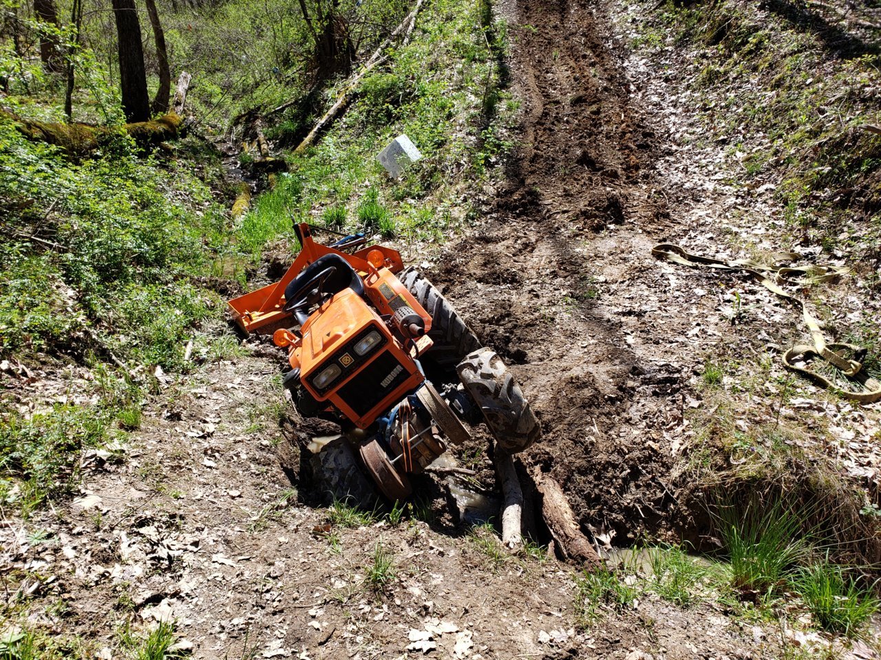

    And here's a pic of my tractor stuck in a ditch lol. I smoothed out the transition after my Taco rescued it.
    And yes, those are Tacoma drum hats on the front for some extra weight lol.
