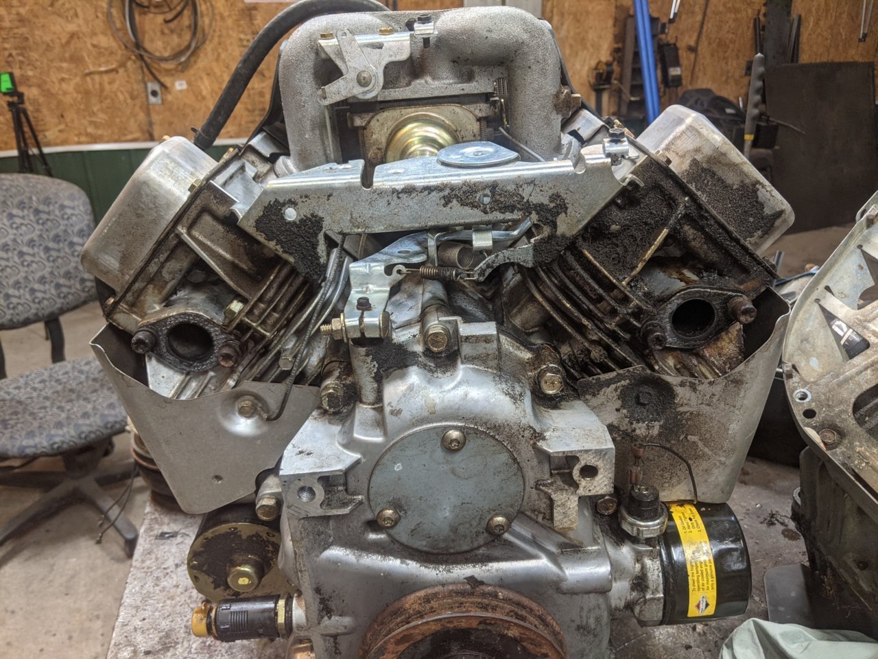

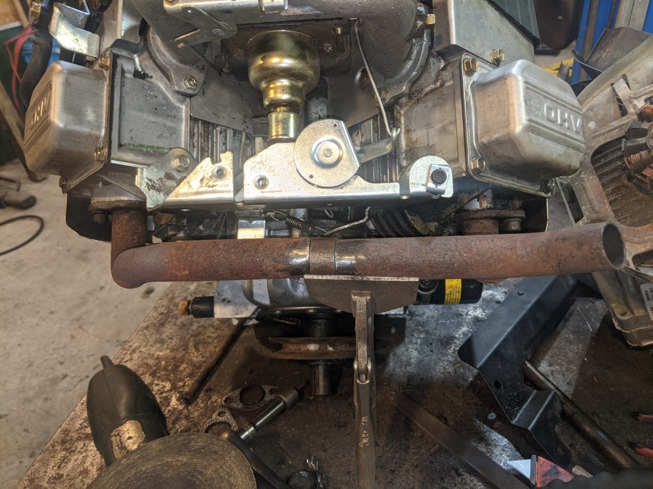

    Head gasket or just leaky valve cover gasket?
    This is a vertcle shaft BS 22hp.

    Head gasket?

    I'm leaning that way.

    If you pop the head off, you should be able to see it if it's failed. Since you have to remove the valve cover anyways to do that, might as well just do both.
    I'm sure you were going to anyways. Gasket kits for these things are dirt cheap anyways. FYI, the head bolts are not dirt cheap though...
    Head gasket would be my guess as well since it didn't smoke. It's a known weak link on these Inteks due to crappy design.

    If I had to guess, I'd say H.G.

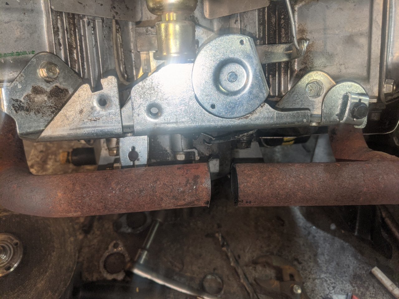

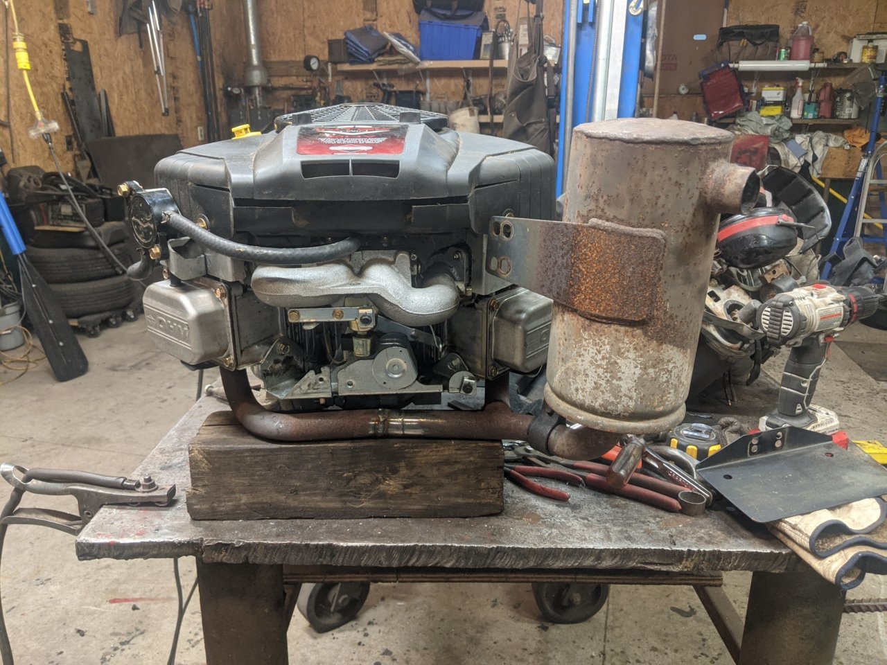

    Lengthened the header.
    The Kawasaki is narrower than the Briggs.
    Head gasket on the way.PXL_20220606_193328111.jpg PXL_20220606_194115096.jpg PXL_20220606_194934064.jpg PXL_20220606_203746484.jpg

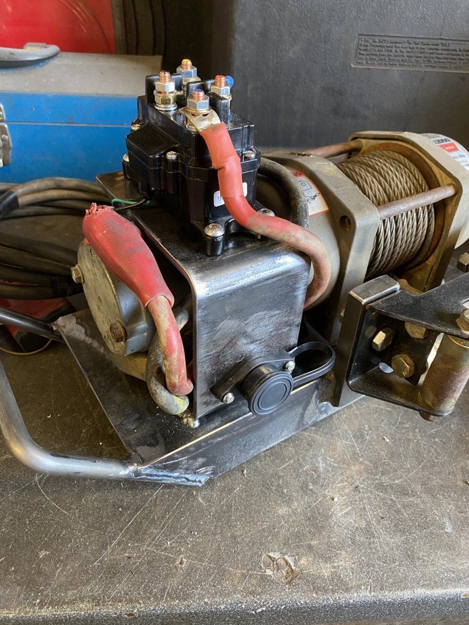

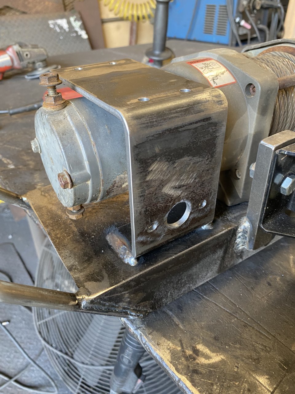

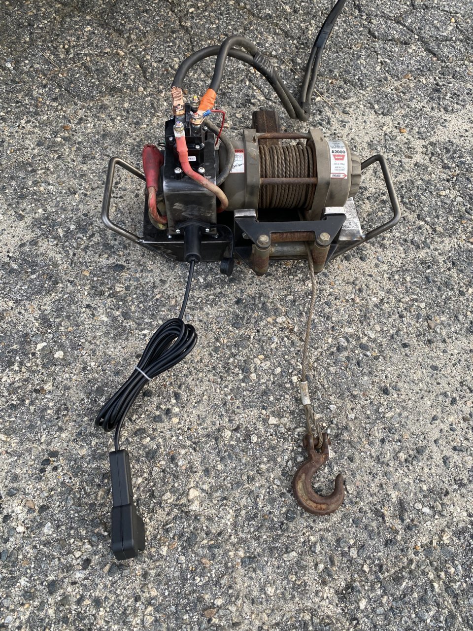

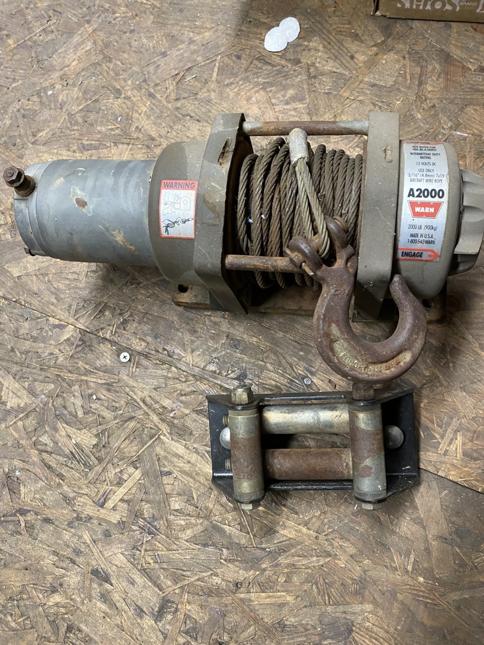

    Got the bracket made and solenoid mounted on the 2,000 lb winch. Now to get it painted and come up with a cover for the solenoid. It'll be perfect for winching stuff up on the small trailer and not having to drag the 8,000 lb one out.
