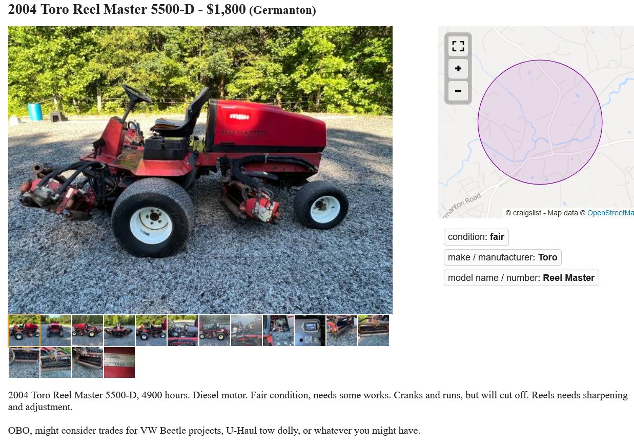

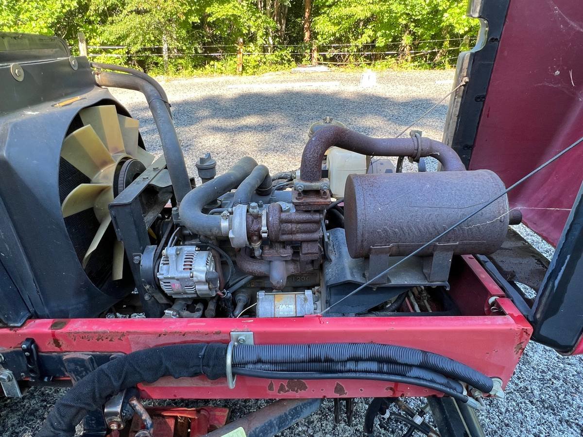

    @koditten I doubt there's much demand for a greens mower but that small turbo diesel would come in handy for something else. Says it cuts off and needs some work though.

    I know very little about the Toro diesels.
    Neat little unit.

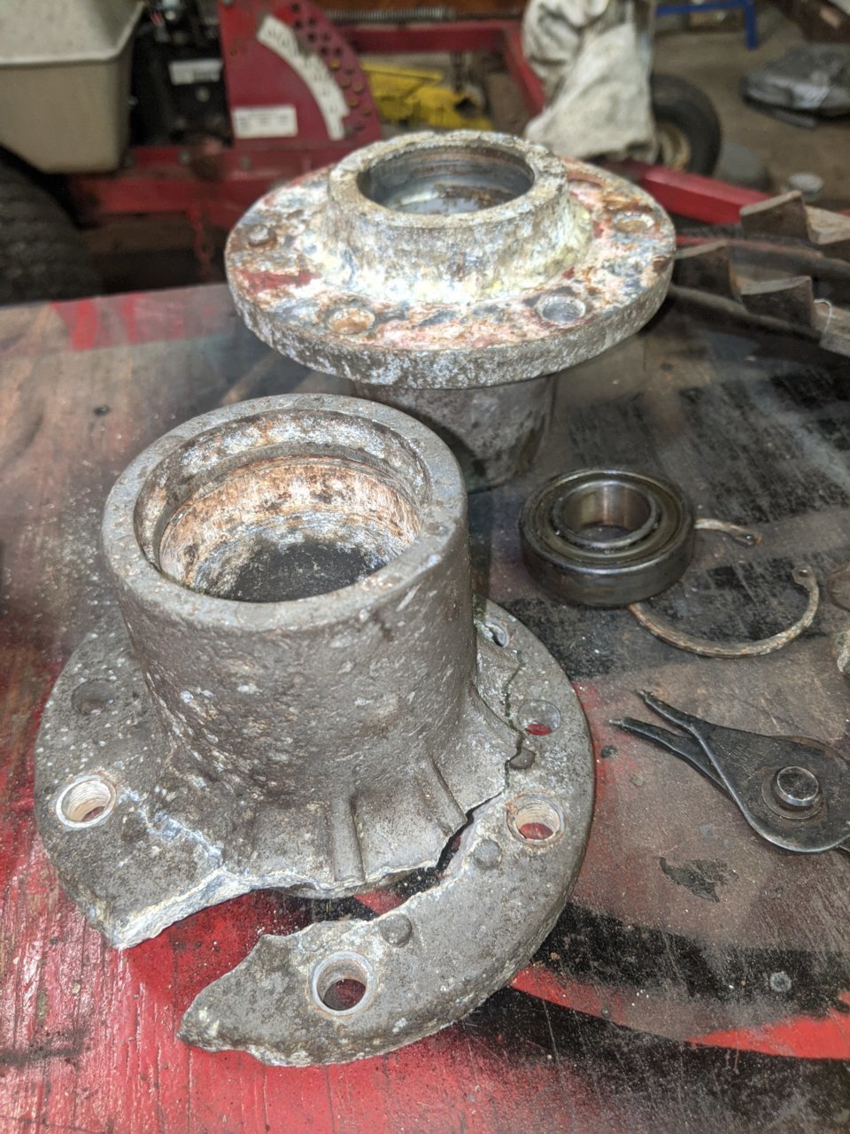

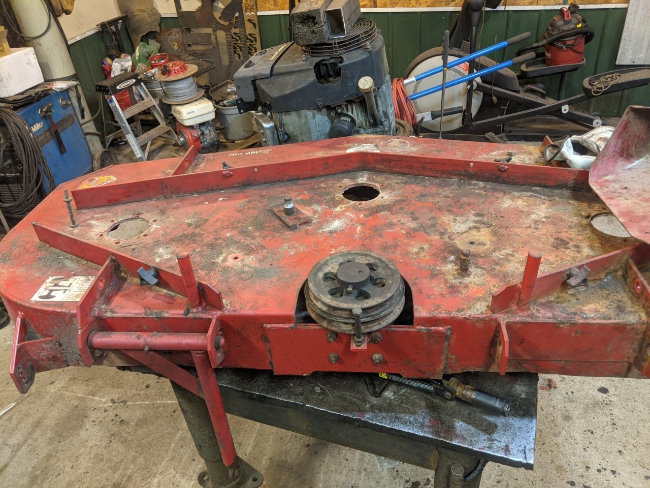

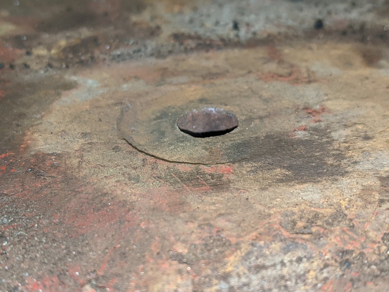

    Decided to strip the deck today.
    Will need 3 idlers and bearings for 2 spindles...of course the only spindle with good bearings was cracked.
    Full set of bearings and 1 housing on the way.
    Will have to weld/build up this tensioner idler bushing pivot. Someone forgot the wear washer. The arm holding the idler is tilted because of the wear.

    It'll be as good as new when you get done with it :thumbsup:

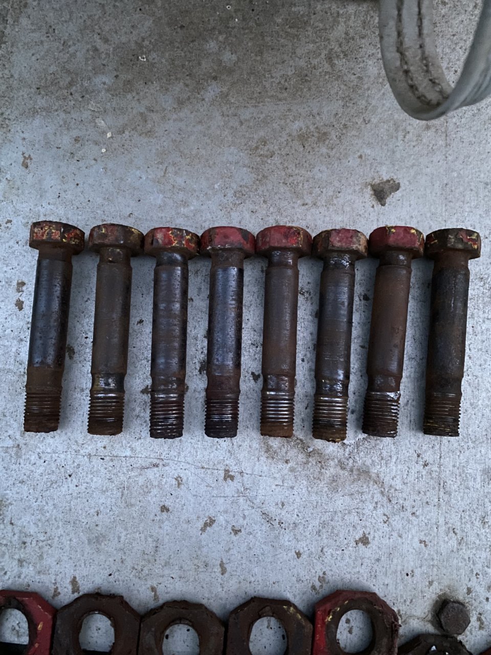

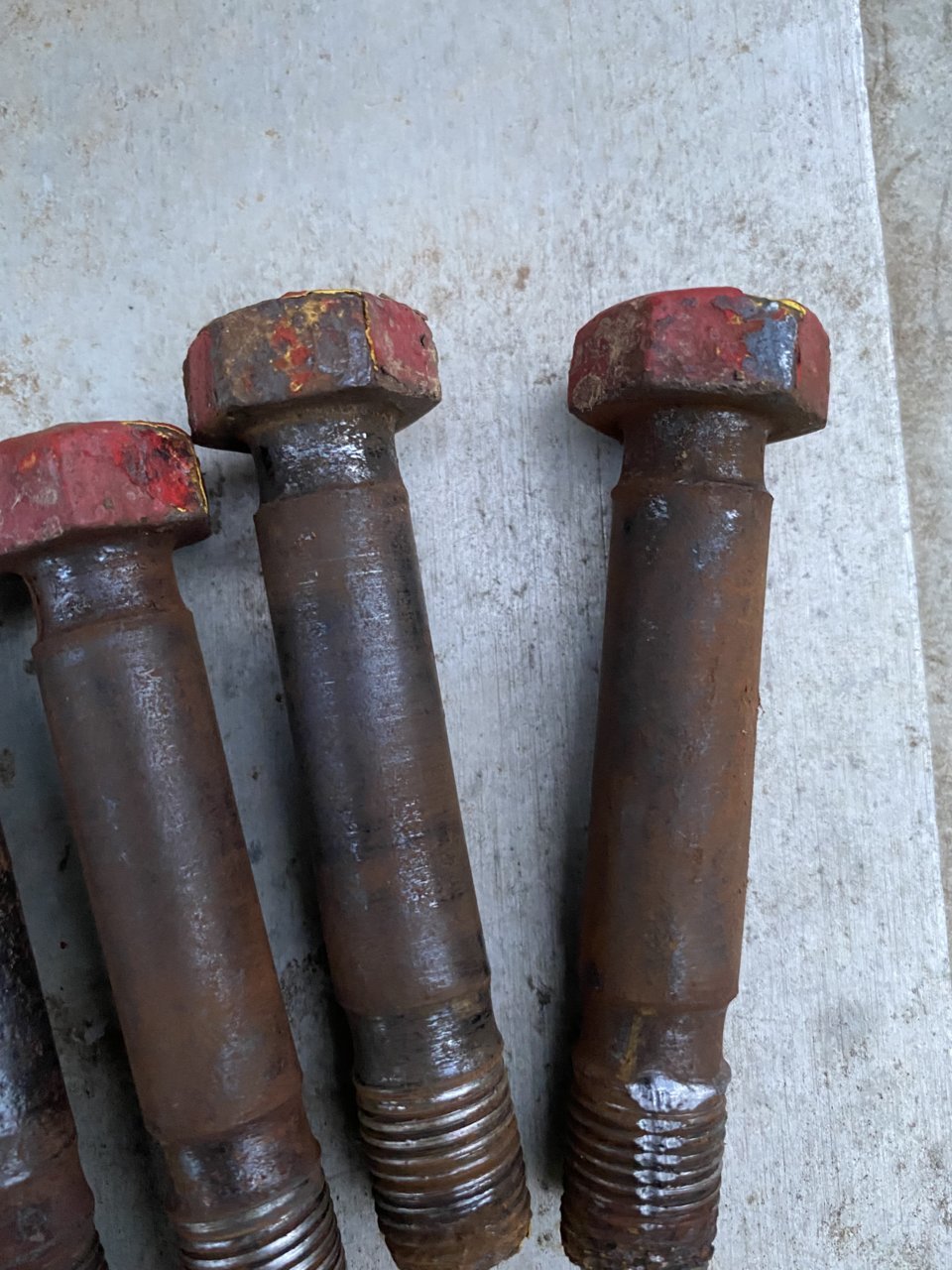

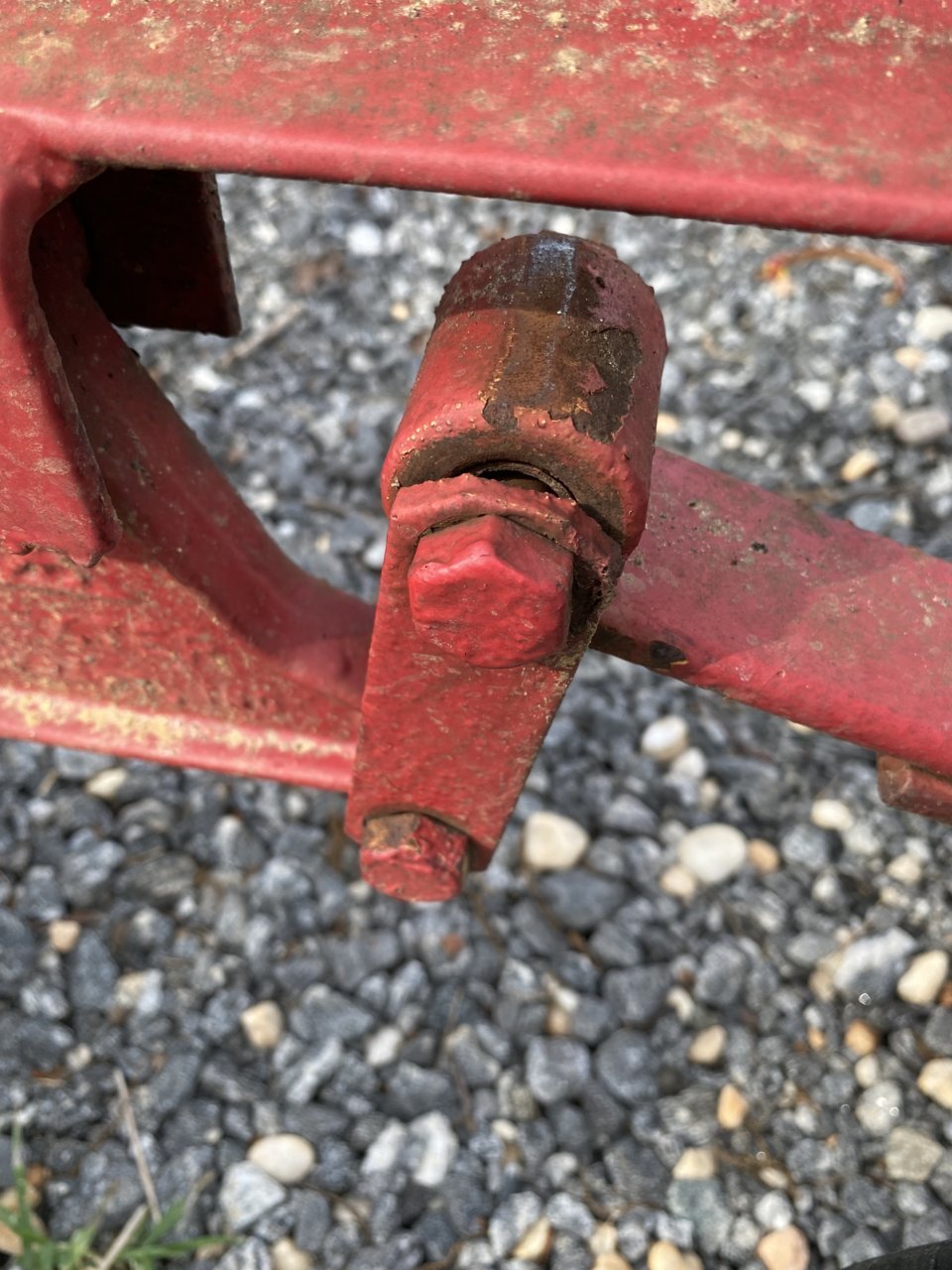

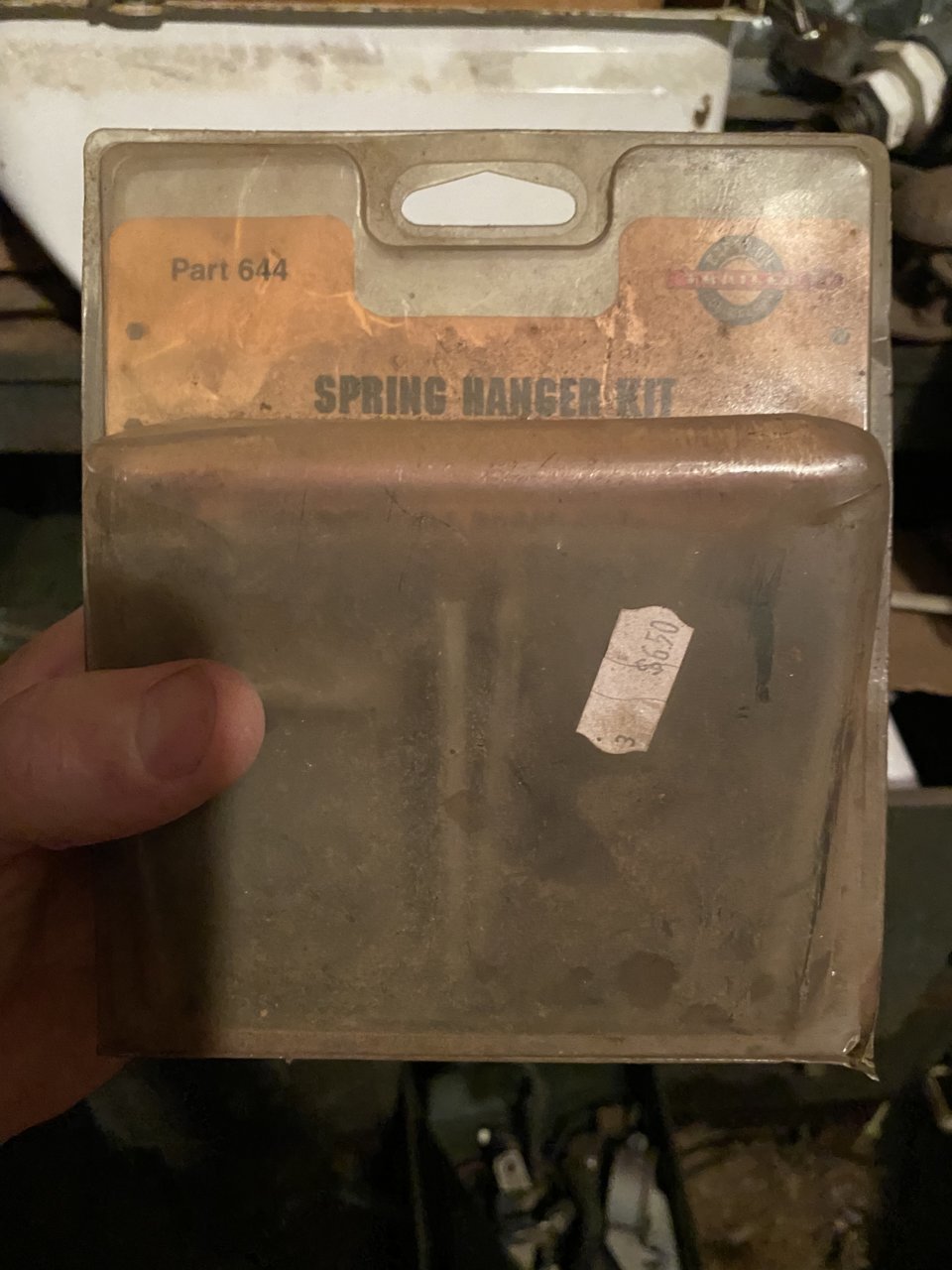

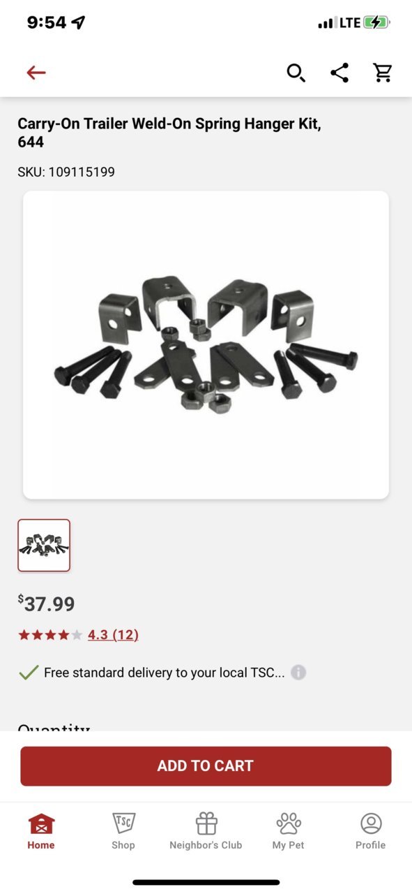

    I noticed my spring shackles are a little worn, as they should be since they’ve been on since 1981.
    A new spring hanger kit is $37.99 at TSC, just the bolts and plates are more than that and I need 8 plates and 8 bolts :eek:
    Last night in the shower I remembered I bought some 15+ years ago at a salvage store so I got to looking and found what I need.
    I bought a few of these for $6.50 :bananadance:

    Preventive maintenance, check.

    You could have mde them:boink::stirthepot:
  19. Jun 29, 2022 at 3:30 AM
    #7859
    six5crèéd
    six5crèéd [OP] Be the light
    Jul 9, 2019
    #298734
    36,231
    Southern Virginia
    8 lugs no plugs
    If I didn't already have the straps, I sure would have :fistbump:
