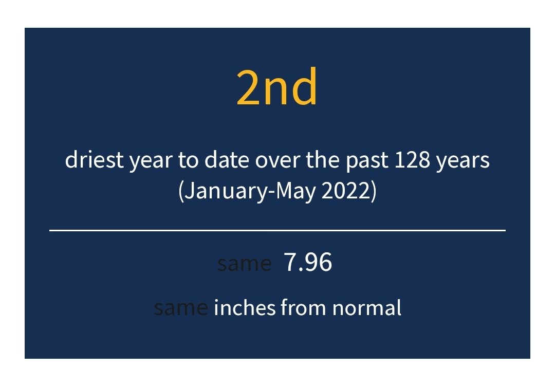

    Not normal temperatures, the May avg. temperatures was almost 9* warmer than avg, last month it was 6* warmer than average. When regions experience drought the temperatures spike, it is the 2nd driest Spring here in the past 128 years so far, waiting on June data...
    We're 22min North of that town and we're closer to 10 inches from normal, we have had less than 3 inches of rain this year. We had about 18inches of rainfall last year and the yearly average is 30 inches.

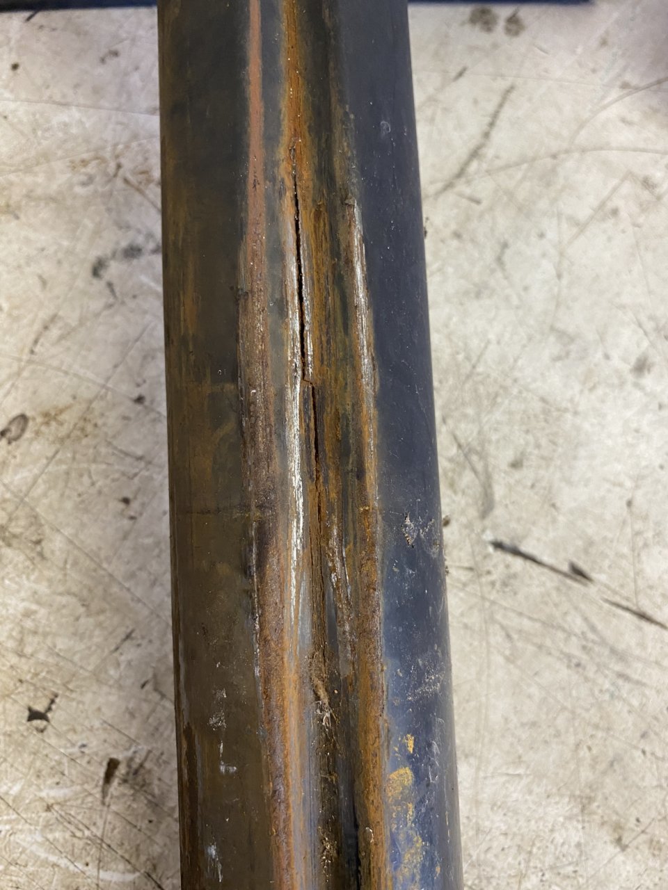

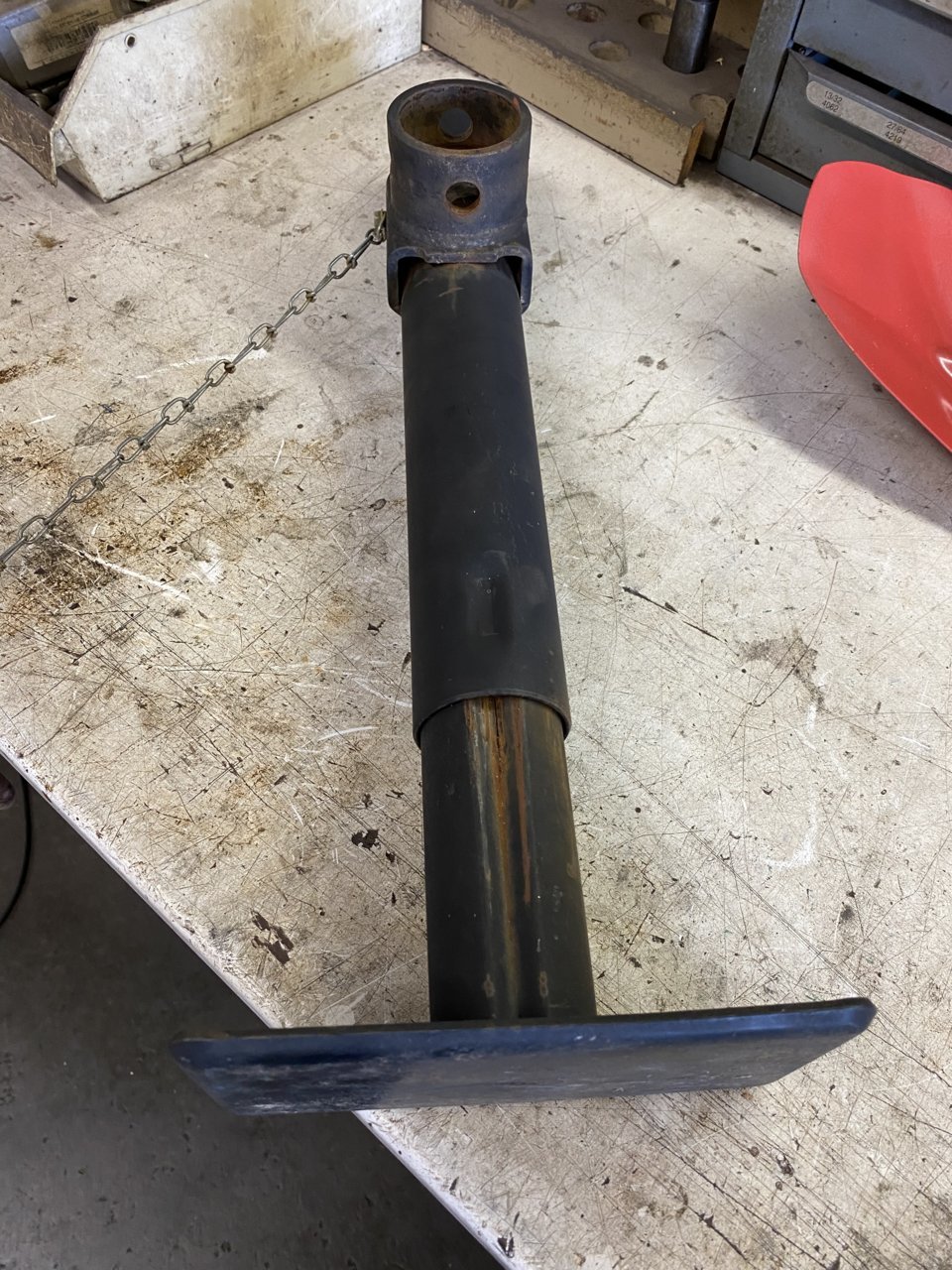

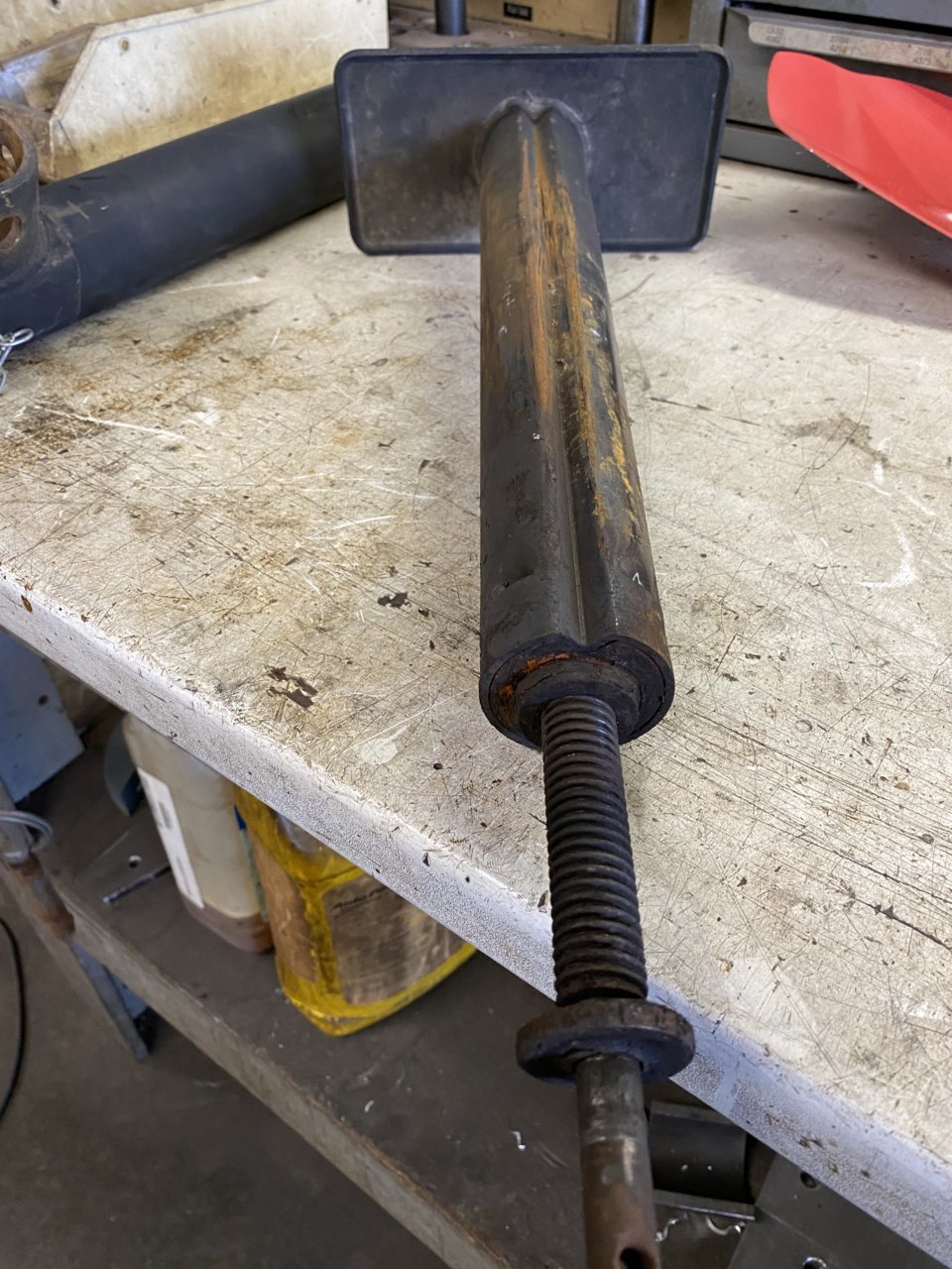

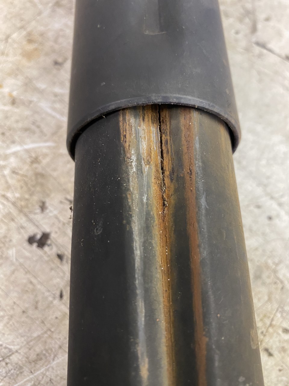

    This jack has been tight for some time. Oiled it and no help. Brought it to work to take it apart and I think I know what happened to it. Looks like it filled with water and froze.

    That’s exactly what happened to this jack. The threads are free as can be and it’s only swelled in the one spot. I’m gonna grind it out and weld it back together and see if I can salvage it.
    It'll also be getting a hole in the bottom to let the water out and the bees in.
  11. Jul 8, 2022 at 6:05 AM
    #7971
    koditten
    koditten Well-Known Member
    Sep 8, 2013
    #112077
    19,958
    Kirk
    Central Michigan
    04 trd x-cab 4 x 4 3.4l
    Reserected from the dead.
    If it's really an issue, make the hole big enough to stuff some stainless steel wool in there.
    Water can come out and bees can't get in.
    For that matter, how often will it sit on a hitch with the jack lifted.
    Trailers are parked more than they move.
    I think I'd be happy with just a drain hole.
    RustyGreen and six5crèéd[OP] like this.
  12. Jul 8, 2022 at 6:08 AM
    #7972
    six5crèéd
    six5crèéd [OP] Be the light
    Jul 9, 2019
    #298734
    36,231
    Southern Virginia
    8 lugs no plugs

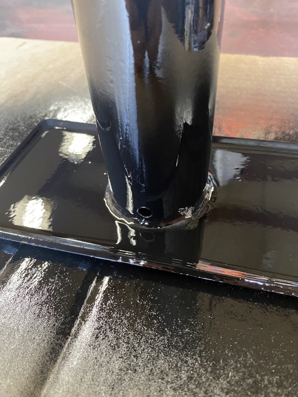

    I'm gonna drill a couple 1/4" holes in it and let it ride. It sits 99.99% of the time anyway. If bees do get in it, it won't be the first time I've been stung hitching one to the truck cause they were somewhere near the tongue/jack.

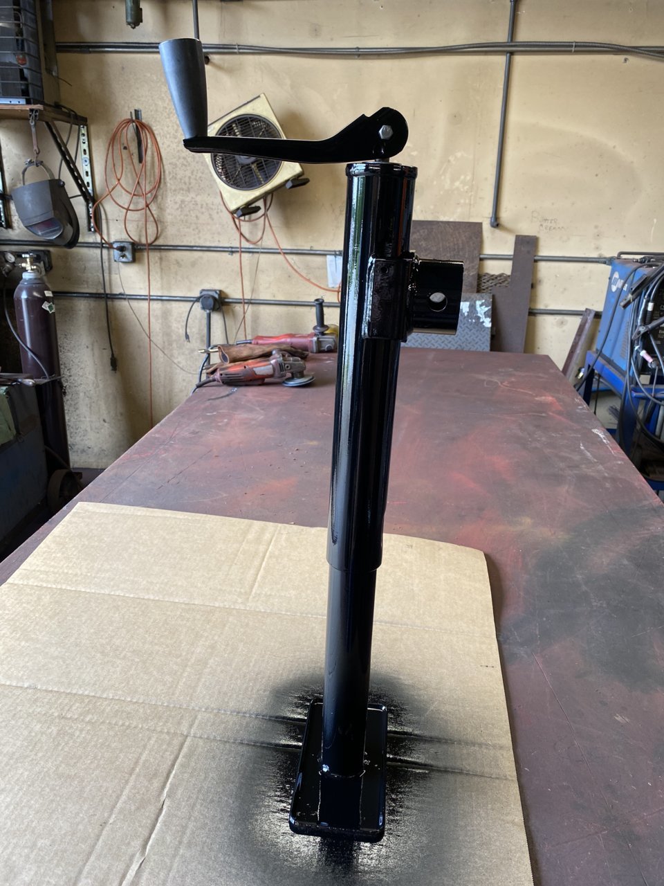

    I was so excited to get this fixed I forgot to take pictures. Cleaned and greased the threads, welded the crack and ground it down, drilled two holes for drains, and fresh paint. Good as new.
