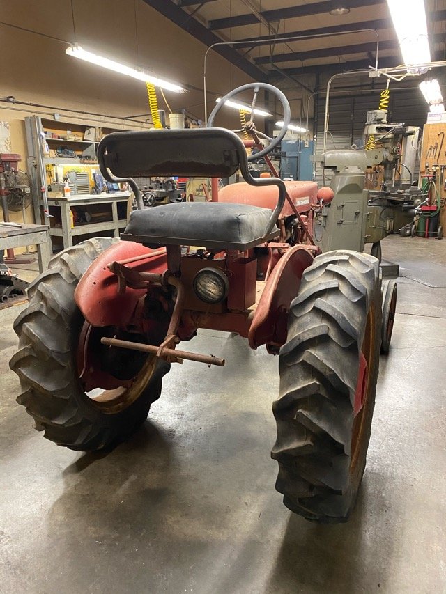

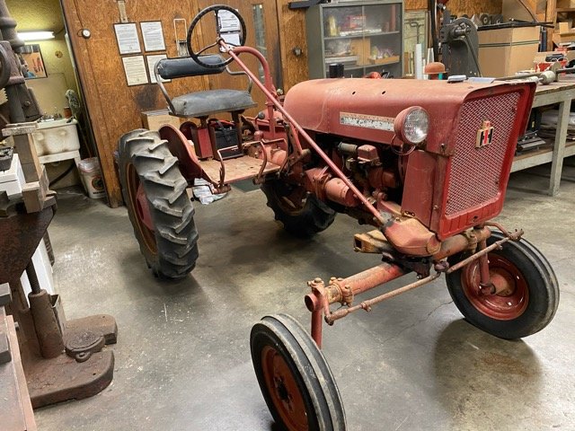

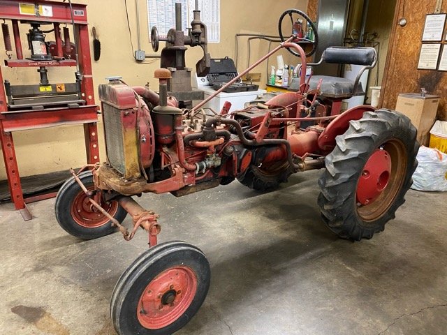

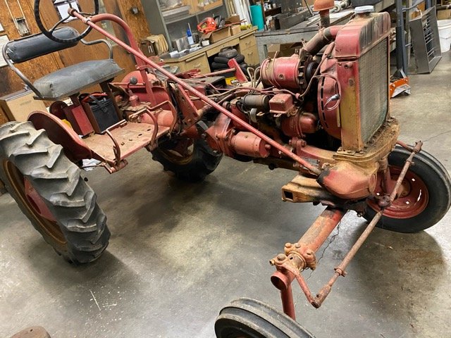

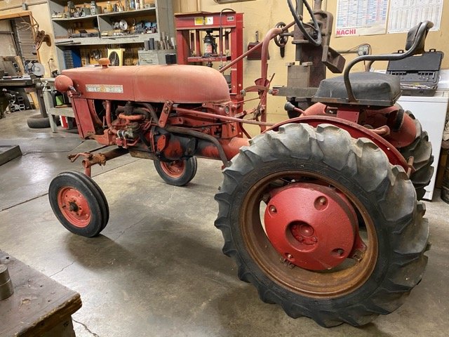

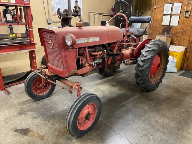

    The latest project, 1975 IH Cub.

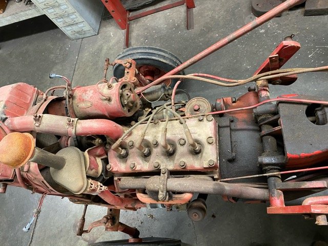

    While the hood is off.......:rolleyes:
    For the record, I bleed green. I used to dislike IH, I grew up on a JD 1020 dad bought new in 1970 (still has it and uses it) and he had a worn out IH 140 and I couldn’t stand it. Nothing like the sound of a JD two cylinder though.

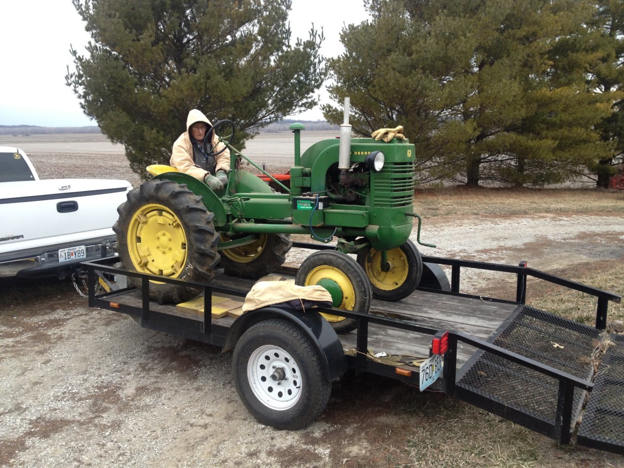

    Here’s the LA, bought it and all the equipment in 1972.

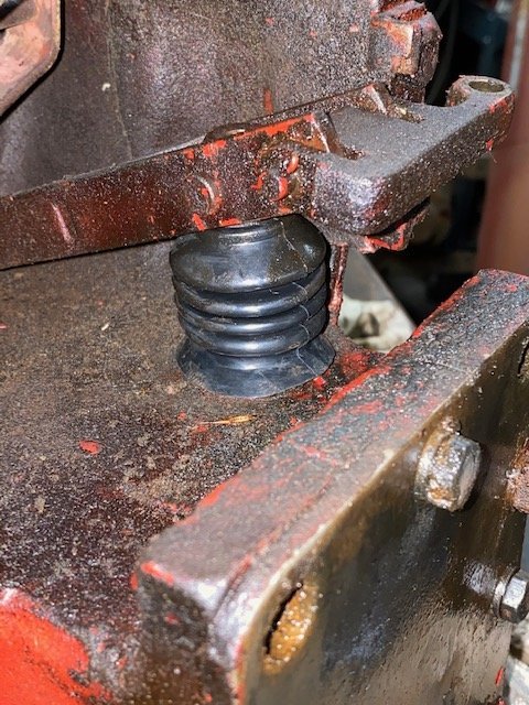

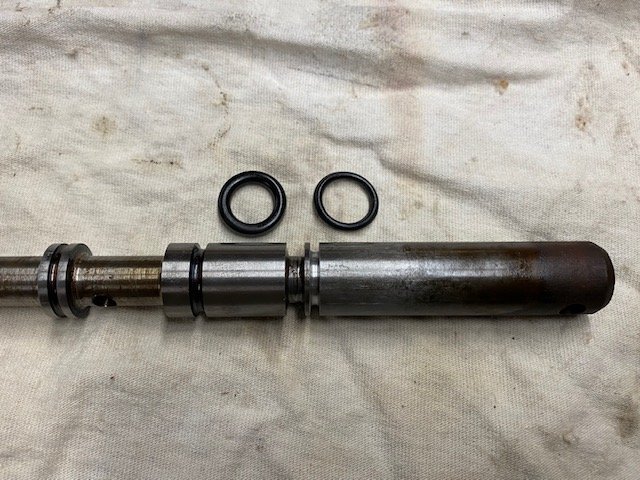

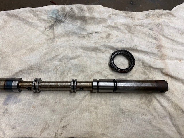

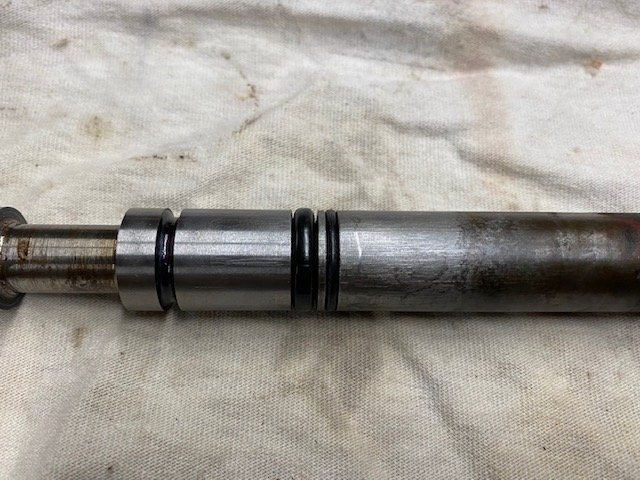

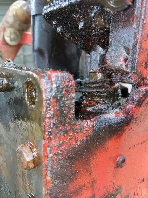

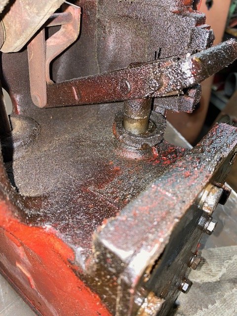

    The touch control was leaking on this Cub. I cut a new oring groove beside the old one because the original is special and I can't see paying $7+ for an oring. Also replaced the rubber boot that was missing.

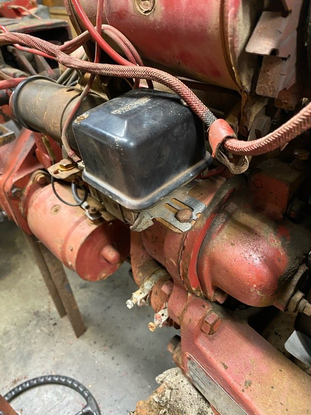

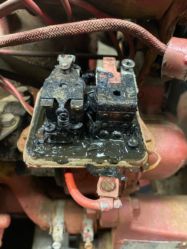

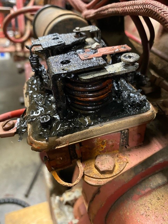

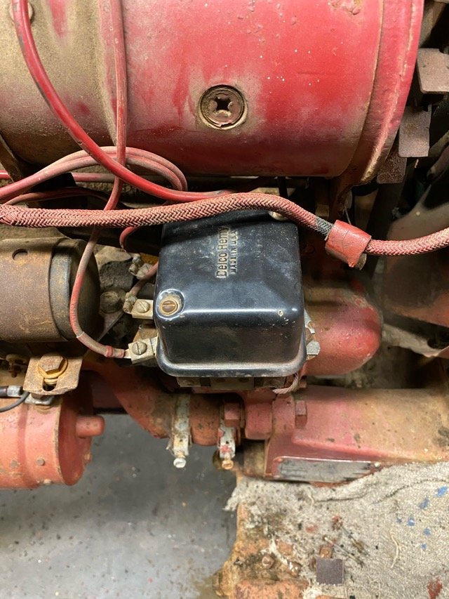

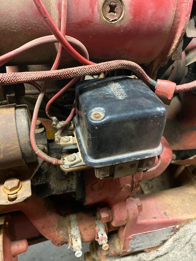

    Think I found the best place to start figuring out why this Cub isn’t charging.

    Where was it leaking fluid from? I have a TC18 that has a couple of drips/drops here and there, but nothing major. Just small sections of rubber return line that need to be replaced when the weather gets warmer.

    Aha...
    Bad valve, or had it gotten some trash stuck in it?

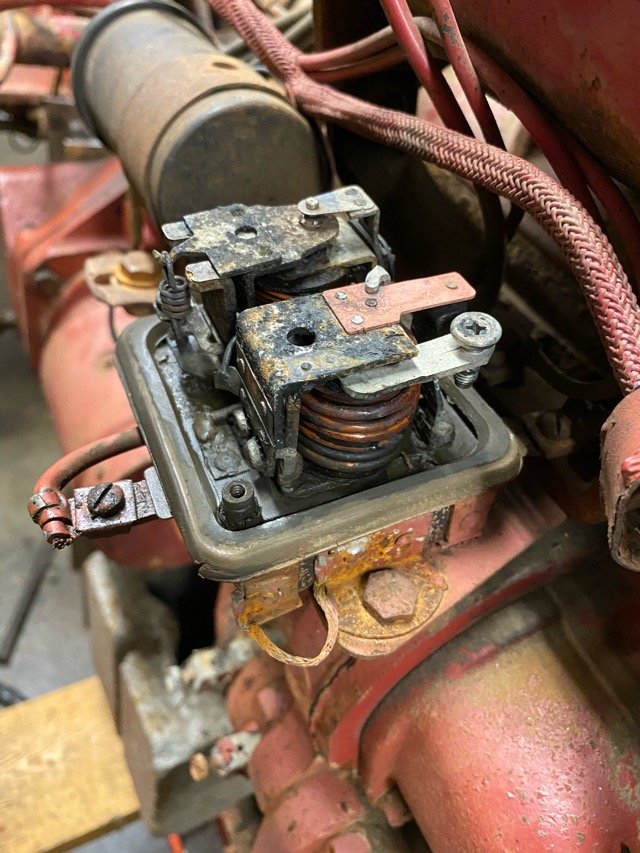

    Transplanted another regulator I had in. It looks new on the inside.

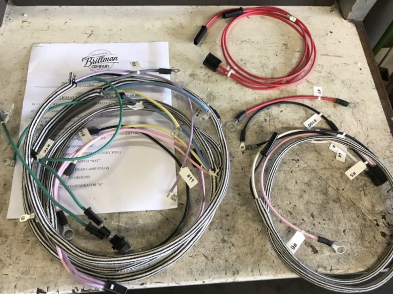

    I put a new wiring harness on one of our 140’s. Got it from The Brillman company. It was top notch.

    Here’s what all came with it.

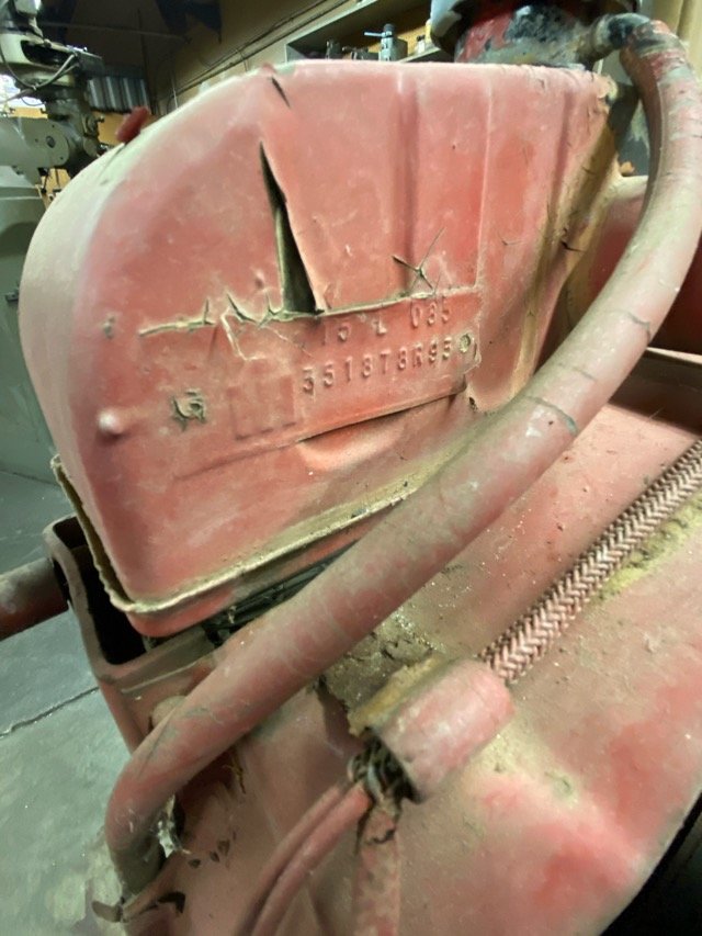

    According to the serial number you posted it’s a 1969.

    I never knew they made those for 21 years.

    Right, because International took over from Farmall in the mid 60's, I think.
