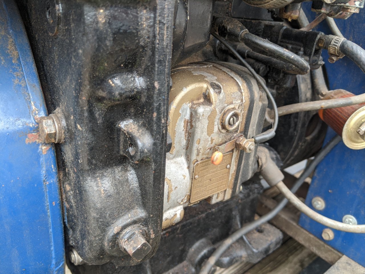

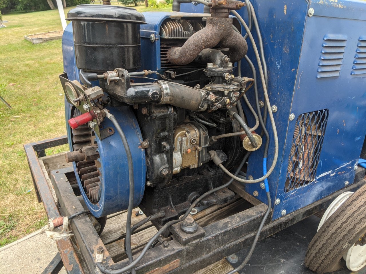

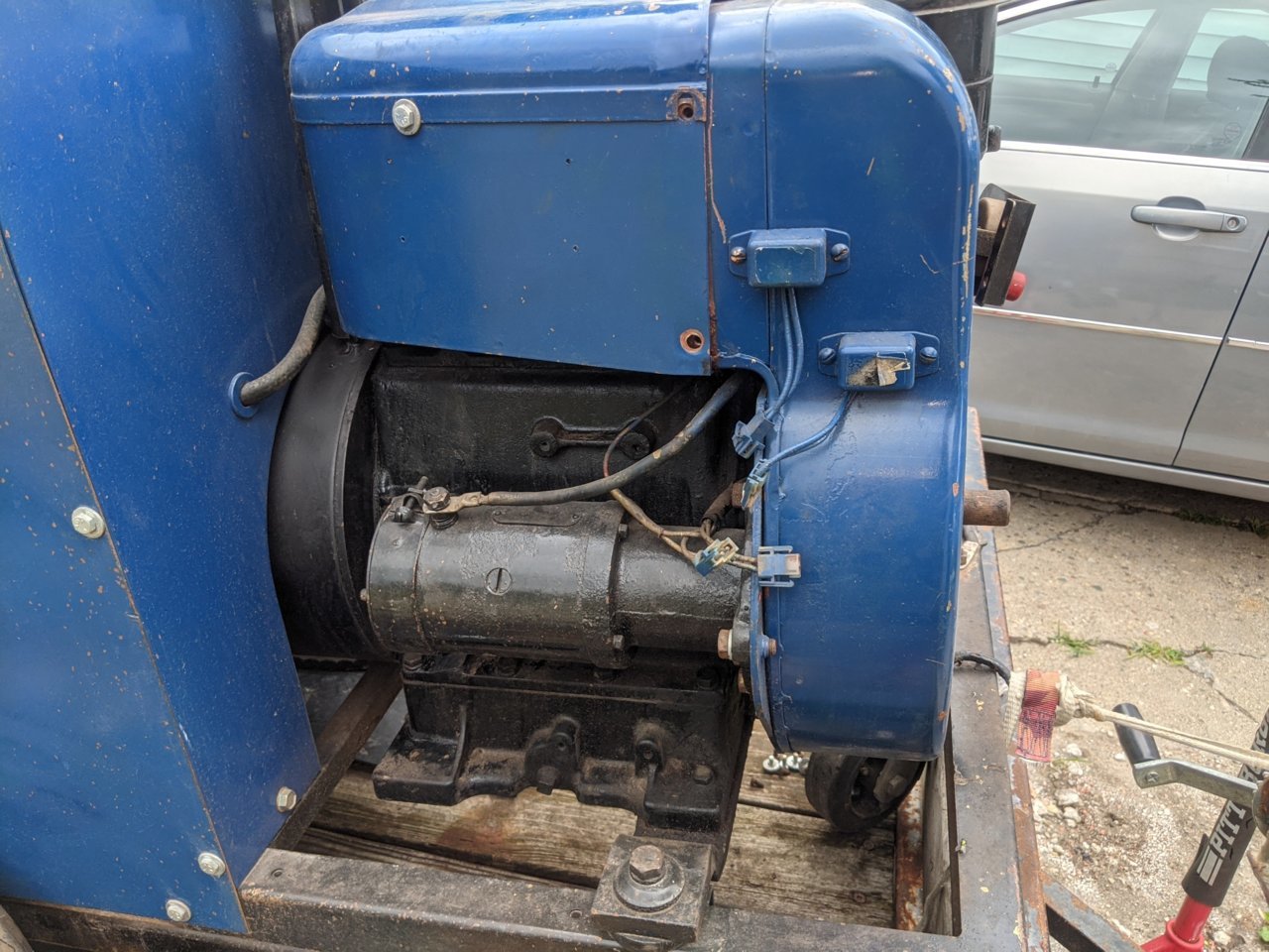

    @RustyGreen
    What engine is this?
    What the little lever for?PXL_20220724_182815847.jpg PXL_20220724_182751623.jpg PXL_20220724_182802621.jpg
    RustyGreen and six5crèéd[OP] like this.
  5. Jul 24, 2022 at 11:58 AM
    #8405
    Toyko Joe
    Toyko Joe Here for the pictures
    Sep 19, 2014
    #138654
    5,284
    Looks like an old two cyl Wisconsin. Is that a welder generator? Looks like a PTO lever of some sort. These are just guesses.

  6. Jul 24, 2022 at 11:59 AM
    #8406
    RustyGreen
    Aug 12, 2020
    #337468
    14,482
    sleeping in a chair
    2017 AC 4x4 Sport 6M Inferno
    Pavement Princess
    Engine is a Wisconsin 2 cylinder.
    It has electric start and a charging system, the ignition is magneto.
    There was originally a metal data plate on the blower housing identifying the model: TE, TF, TH, TJ - if the model has a "D" (THD) that indicates the heavy duty Stellite exhaust valve.
    It by lever you mean the little one on the magneto that is for grounding the ignition to shut it off.

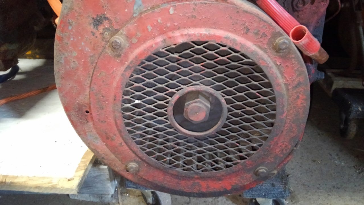

  7. Jul 24, 2022 at 12:04 PM
    #8407
    RustyGreen
    Aug 12, 2020
    #337468
    14,482
    sleeping in a chair
    Pavement Princess
    It is missing the ring/screen on the flywheel. The screen isn't a big deal (as long as one keeps their fingers out) but the ring is important.
    Without it the air can spill back out instead of being forced through the ductwork and over the head where it needs to go.

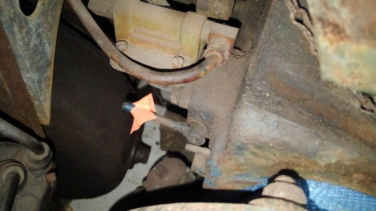

  8. Jul 24, 2022 at 12:18 PM
    #8408
    RustyGreen
    Aug 12, 2020
    #337468
    14,482
    sleeping in a chair
    Pavement Princess

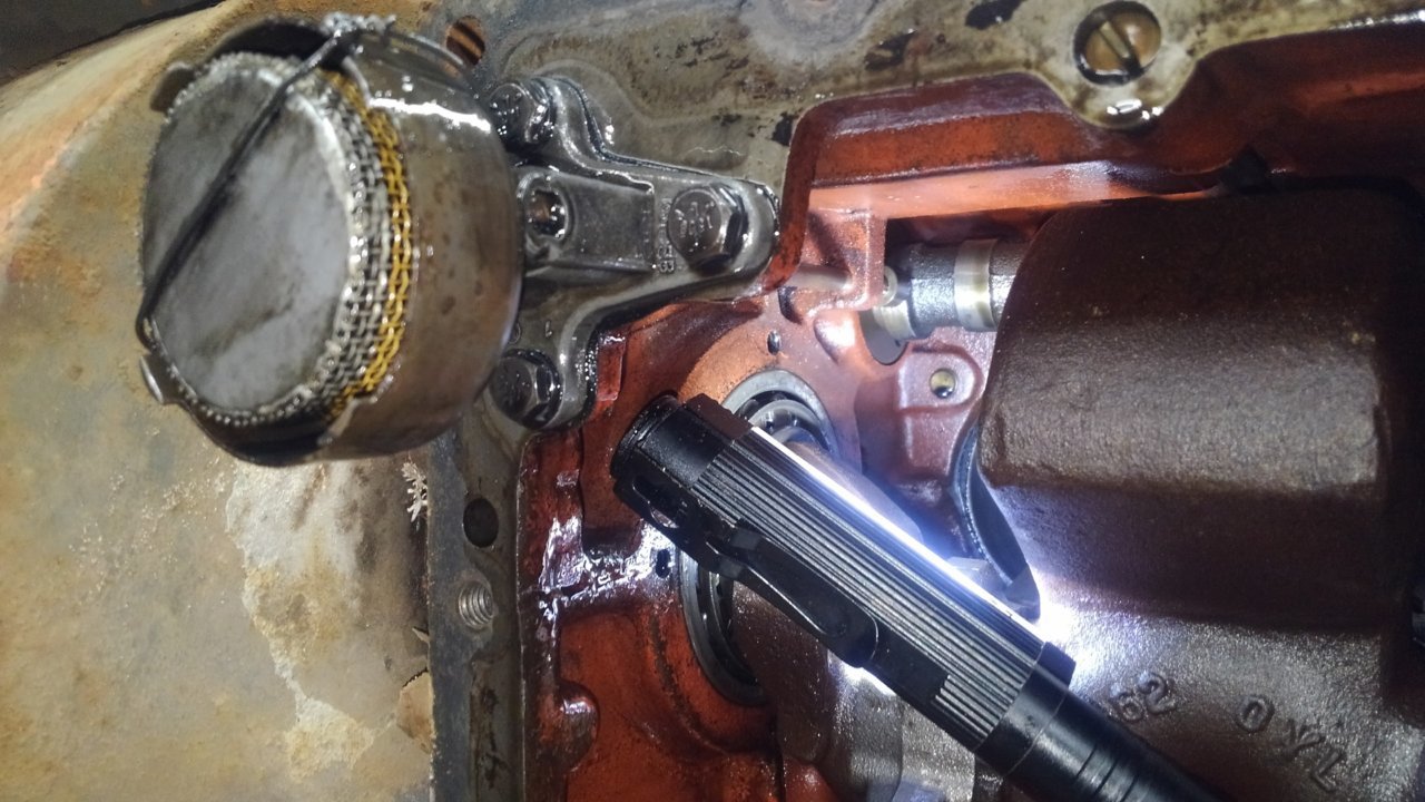

    There is also another little lever to be seen back by the fuel pump.
    Many of these engines were crank start, if a remote tank was fitted they came with a fuel pump. The lever allows manual operation of the pump to fill up the carburetor.
    The view below is the reverse of yours, looking towards the fan end of the engine. The lever with the orange tape is spring loaded to be down normally.
    six5crèéd[OP] likes this.

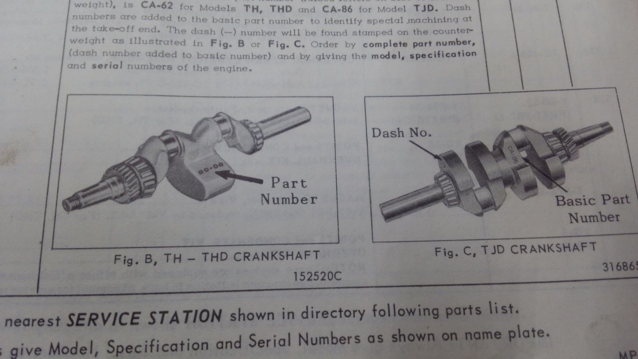

    Did a little book work, the engine is probably a TH/THD/TJD as it has the newer style 2 box charging system.
    My 1968 manual indicates that the older single box style is obsolete by then.
    The TH and TJ engines are mostly identical except the earlier TH has the pistons moving up/down together and has a big honking counterweight on the crank.
    The later TJ engines have a more conventional pistons opposite layout.
    They are both "square" engines with 3-1/4" bore and stroke, 53.9 cubic inch displacement. Rated 10 - 16.8hp depending on governed rpm.

    THD -- I said a big honking counterweight...
  12. Jul 24, 2022 at 2:45 PM
    #8412
    koditten
    koditten Well-Known Member
    Sep 8, 2013
    #112077
    19,754
    Kirk
    Central Michigan
    04 trd x-cab 4 x 4 3.4l
    Reserected from the dead.
    Thanks for the knowledge drop. I figured you would have the deets for this unit.
    It is attached to a Hobart welder.
    The screen is present. We do not know why it was removed.
    My brother bought this at a recent auction. He doesn't even weld. I'm guessing he will flip it.

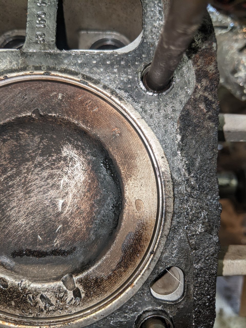

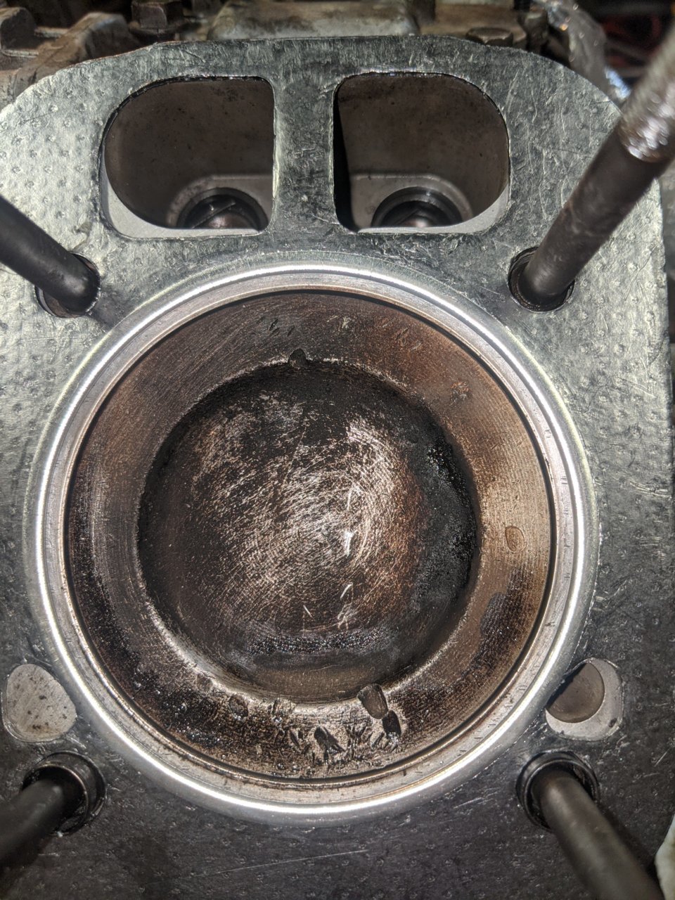

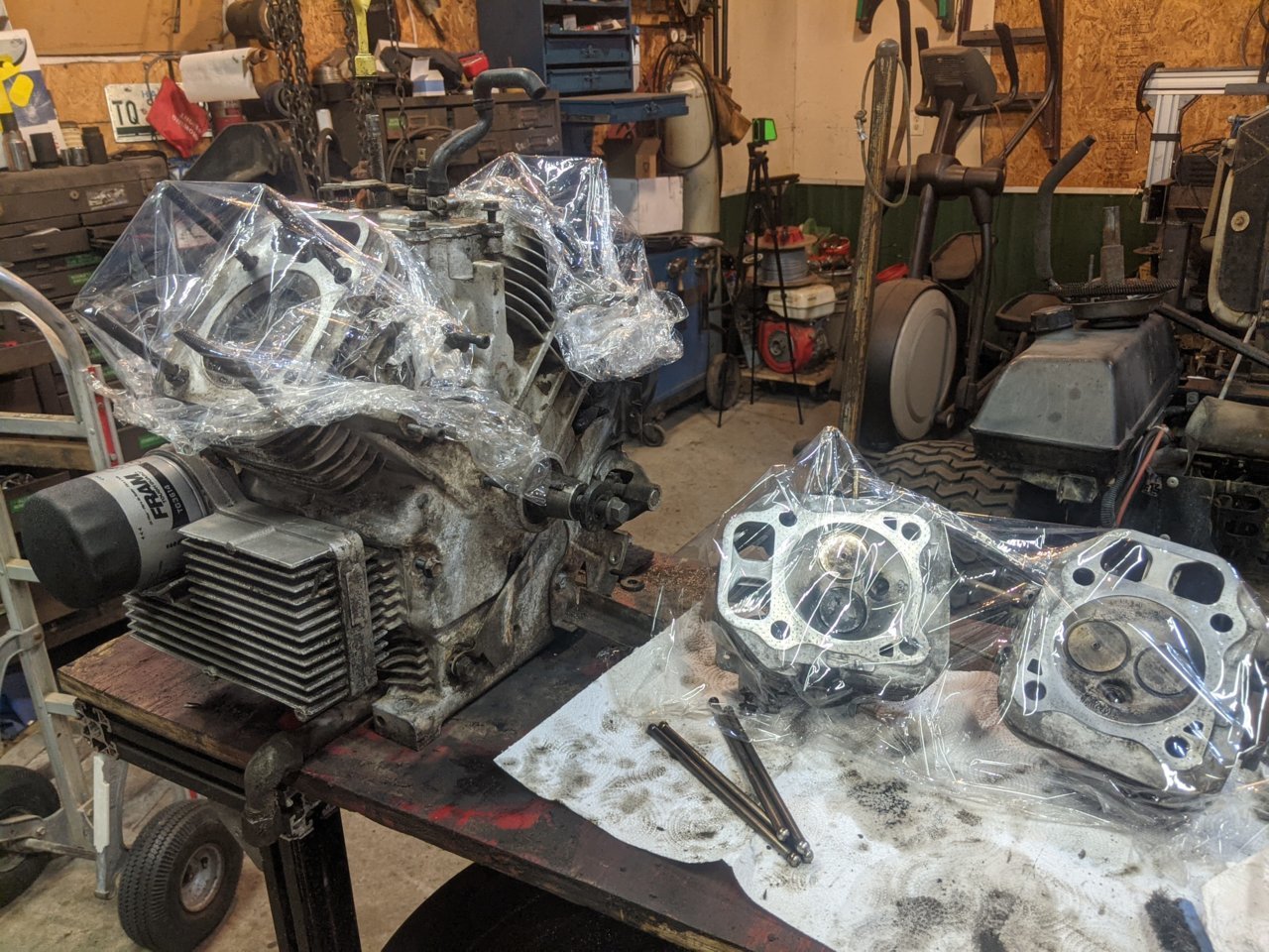

    Another question for the squad.
    Got my replacement head gaskets.
    Was dry fitting them and noticed the bore is quite a bit bigger than the originals. Is this going to be a big issue?
    You will have to zoom into the pics to see the differences. I did not measure, but total diameter looks to be close to a 1/4" bigger.

  14. Jul 24, 2022 at 5:00 PM
    #8414
    six5crèéd
    six5crèéd [OP] Be the light
    Jul 9, 2019
    #298734
    35,845
    Southern Virginia
    8 lugs no plugs
    Personally, I’d get a different one and see if it’s closer to the bore.
  15. Jul 24, 2022 at 5:04 PM
    #8415
    koditten
    Sep 8, 2013
    #112077
    19,754
    Kirk
    Central Michigan
    From what I've found so far, too big is better than too small.
    I've also found that .030-.060 larger is acceptable. This is way bigger than.060.
  16. Jul 24, 2022 at 6:22 PM
    #8416
    wilcam47
    wilcam47 Keep on keeping on!
    Jan 27, 2016
    #176243
    54,696
    Will
    Bourbon state
    More cc:muscleflexing::bikewhoops:. But yeah id try to get one closer to bore size

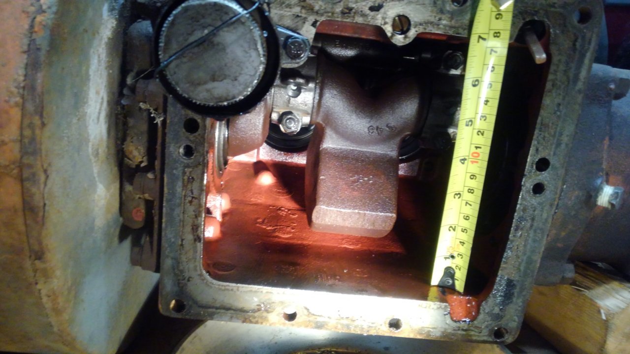

    These twins have a plunger style oil pump with a check ball, when they sit the check ball can stick.
    It is a good idea to pull the base pan and make sure the pump is good to go. It is a low pressure system, about 5 psi when warm IIRC.
    This is what the pump looks like, you can see the push rod that works off the camshaft.
    See the looped line with the flare nuts above the governor? That is the oil line for the gov, it goes into a restricted fitting. You can loosen/remove that with the engine idling, there should be a steady stream of oil from the line if the pump is doing the job.
