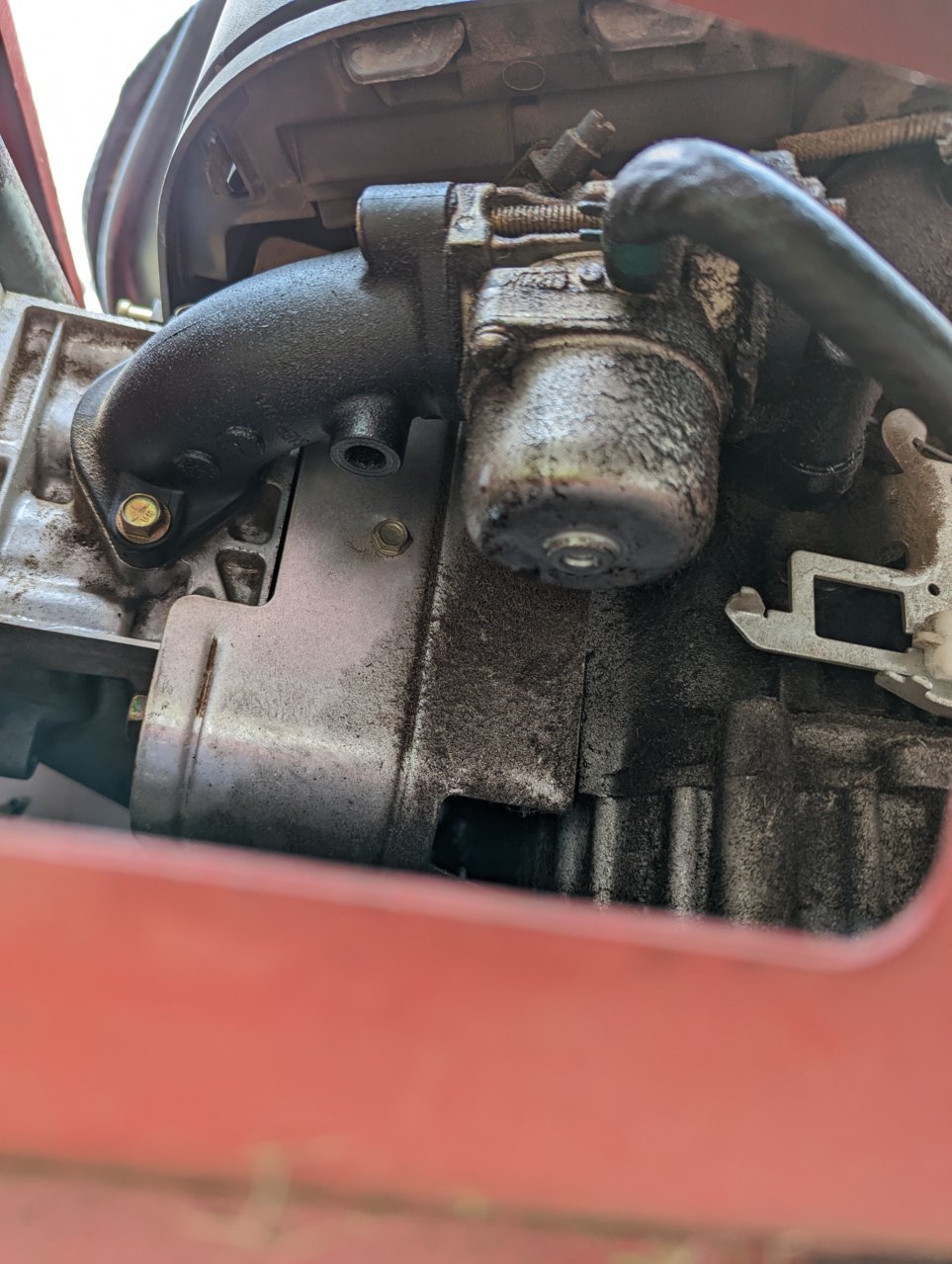

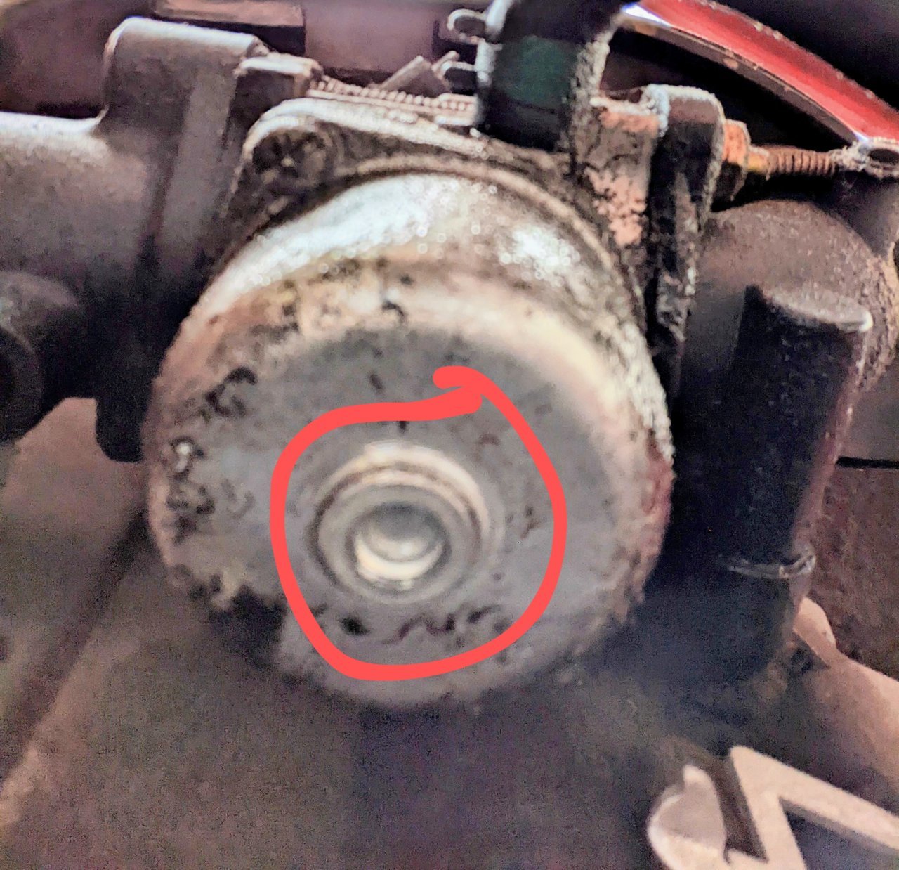

    I have a problem with the carb bowl on my $free.99 riding mower. It's a Briggs motor.
    It's dripping off of the circled bit below.
    Do I just tighten that with an allen key? Or take off the bowl completely with the phillips head screws in the flange at the top of the bowl?

    Isnt there supposed to be a brass cap in there? Or guess it depends what model

    That or a solenoid needle valve...

    Give everything in the area a good wipe down, run the engine, observe and report back.

    I clamped off the fuel line because it's pretty much running out.
    I don't know if it's supposed to have a valve in the bottom or not.
    If it helps y'all any, it a Briggs PowerBuilt 10.5 horse.

    I did just get down and look underneath and I don't think that bit where it was dripping has any threads.

    Was the engine running? Maybe bowl gasket leaking or float stuck, cracked line leaking down. I see some have some kind of sensor on them and some just plain like yours.

    I pulled the line off, it's fine. I don't know about the gasket because I can't even get the screws cracked loose with a stubby screwdriver. Should I even take the bowl off? I kind of want to be sure before I get medival on it.

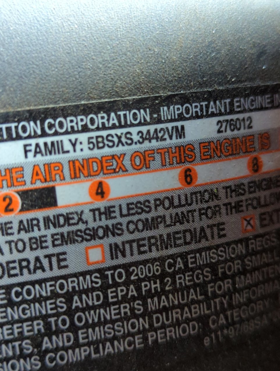

    I found something. Maybe.

  16. Jul 31, 2022 at 3:42 PM
    #8496
    My Name is Rahl
    Jul 5, 2018
    #258370
    22,106
  17. Jul 31, 2022 at 3:46 PM
    #8497
    Tacoma Mike
    Aug 6, 2011
    #61230
    31,374
    Southern Maine

    just replace the carb.
    I’ve put like 10 on the past few years.
    Like 10 bucks..

    I’m sorry
    15 bucks

    Oh and I buy older application carbs with adjustable main jets. run so much better
