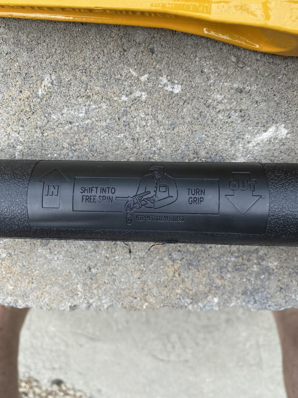

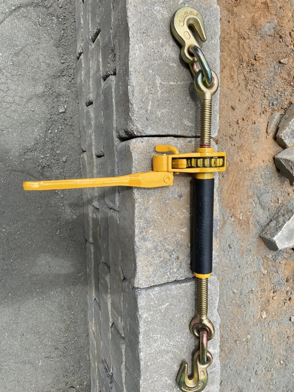

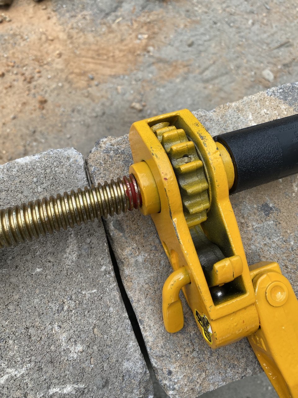

    Binders came in. These are nice and child proof.
    Red paint to tell you when to stop.
    Which direction to turn.
    Folding handles take up less room in the toolbox.

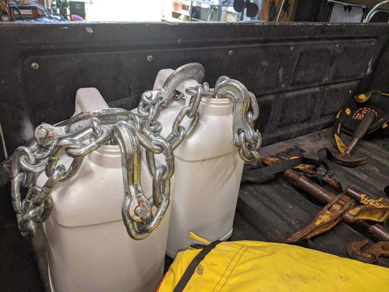

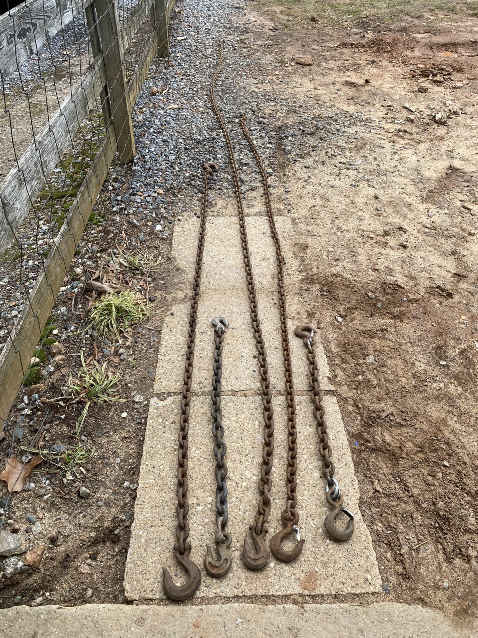

    That works!!
    That toolbox is on the neck of my gooseneck is why they are all jumbled in there.

    That is what I need to do with these. Traded some gas to a guy for them. I also need to weld two hooks on my loader arms so I can use short chains and a dog on each side.

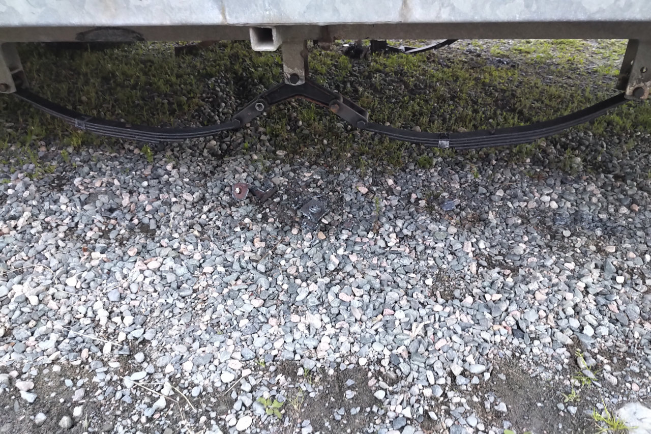

    How do you guys like these angles? Go or no go?

    I still say too short.

    You scratched them..

    No like.
    You are gonna have to cut off the front and rear spring hanger and move them in...or find longer springs.
    What can happen is if you have a good load on the trailer, when you enter or exit a steep drive at an angle, those links can invert. It is a job to get them back to their correct position.
