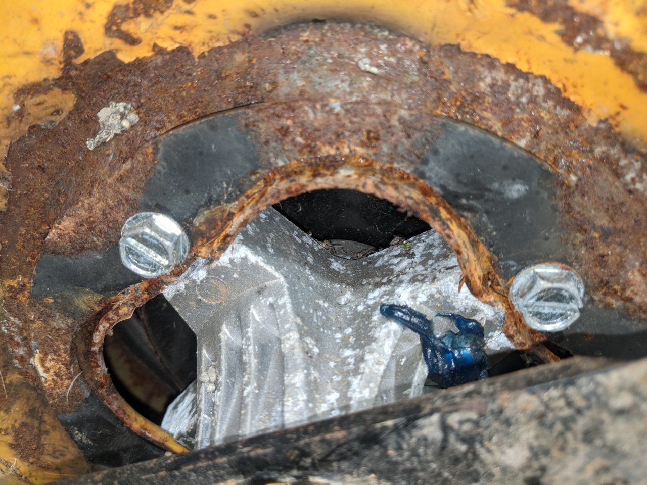

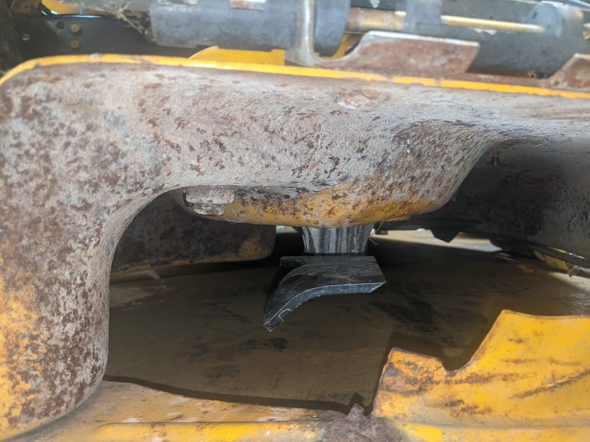

    I really hate working on other peeps stuff. This was dropped off. I was told
    Won't start.
    Won't go into neutral/push mode.
    Last time it was ran, the deck wouldn't engage. Owner estimated 4 years ago.
    Found:
    Varnished up solenoid needle valve-fixed- runs great.
    Idler pulley for the the deck belt was installed with the bushing on the wrong side- Removed and installed correctly-Deck engages properly, but...
    Found the blades installed upside down and they were brand new-removed and installed correctly.
    Found these are the wrong, fucking blades!
    They hit each other randomly. Now I know why they were installed upside down!
    I hope I never meet who did this work. Could be a FUPA punch involved!
    ZjW0e3pbdxAvkJAQ5WzCSbJe1KKhwN-Mn7vI6kc9_6640fda5e00ec4d7a09cb6730dda5d08ef5298c9.jpg
    JxW7hJkylgfG-9mpPOo1Z5Osw8SajxT3AbiEf_o__1d19002d71782ca7aa994c36b0e159e5f7113d89.jpg
    Edit:. Mystery deepens.
    Found that the spindle housing for the deck had been repaired. Results were the spindle is 1/4" too close to the center spindle.
    I'm gonna grind an 1/8" off the ends of the blades.
    This turd isn't worth new blades.

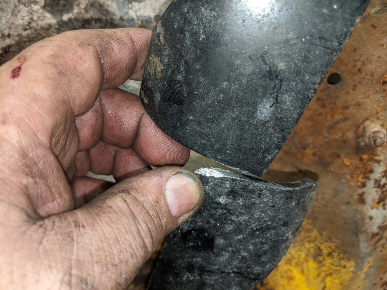

    Here is the repair (4th time taking this deck off).

    Bourbon state
    Thats close:eek:

    Not any more. Installed and tested.
    I'm done with this pig.
