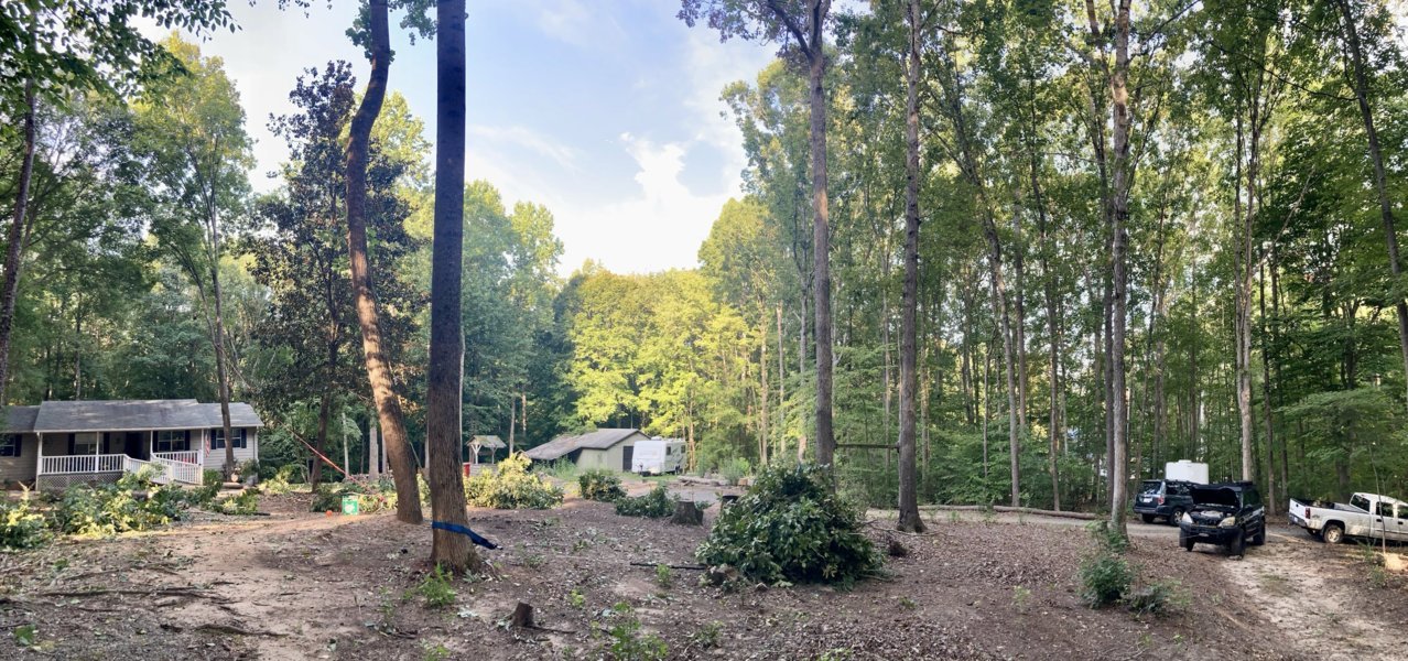

    One down! Really liking the Samson rope! Definitely had a little bit of a learning curve getting it high up in the tree with a throw rope. Also nothing like trusting knots you just learned how to tie on google.

    What knot did you learn? I want to work on mine.

    Running bowline to go around the tree and alpine butterfly to hook my winch line onto.
