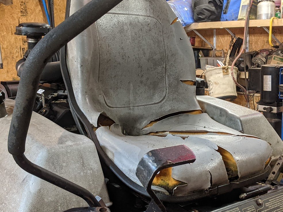

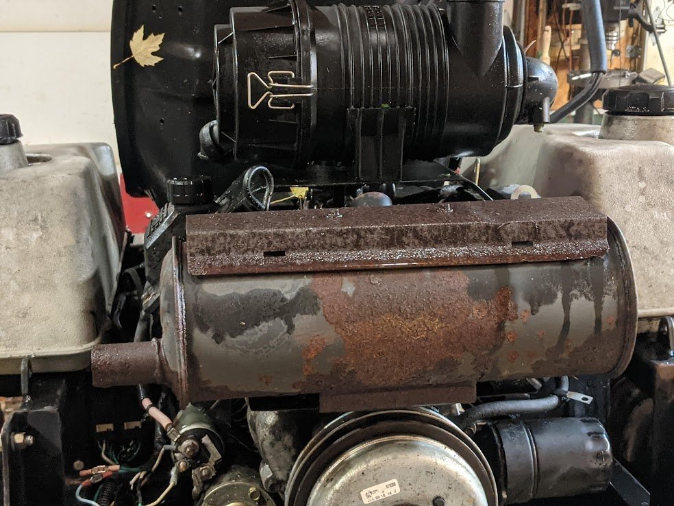

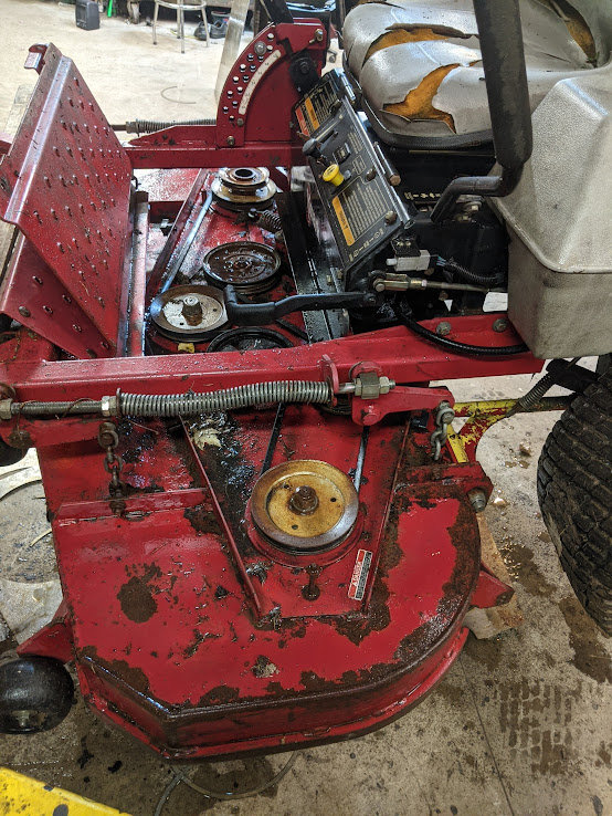

    Quick list of what it needs:
    This does run, I have not tested the charging system. Found out this was an original 72" decked machine, it now has a 60", not worth bitching about. I don't like the 6 footers anyways. This now has a Kohler Command 25 hp, the original was a 28 HP Kawasaki, again nothing to bitch about.
    Gave it a quick power wash, kinda confused why the fuel tanks were painted black, the black powered off like it was water color. No biggie.
    Pictures to help me keep track of the parts and labor it will need.
    New seat-obviously
    new muffler. She crackles pretty good
    New front tire
    New gear motor (included with the purchase-hope its the correct one)
    Missing the PTO cover (easy fab work)
    Deck with have to be cleaned/ de rusted/painted
    Kohler and Kawasaki have different wiring, will have to clean up the cobble job.

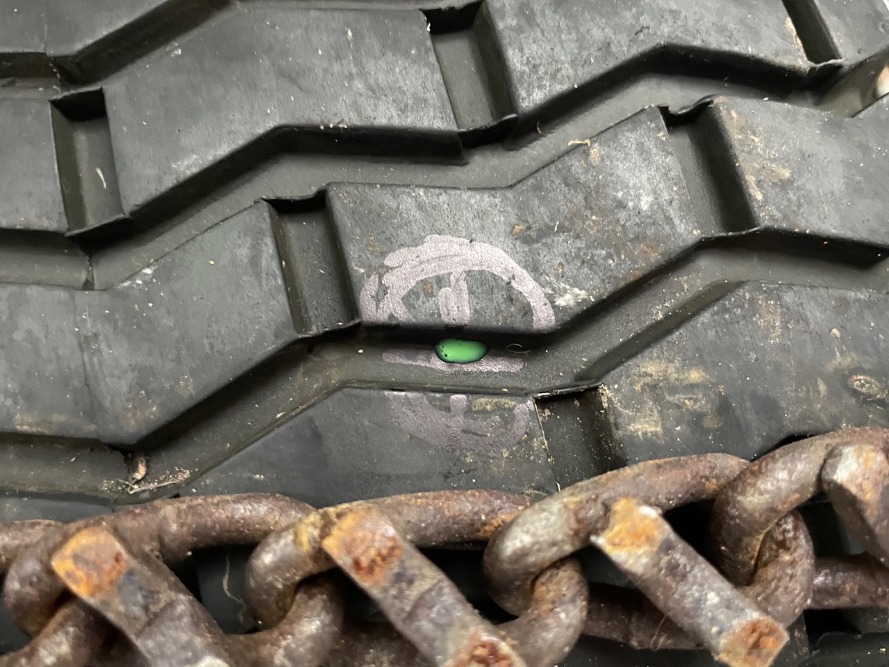

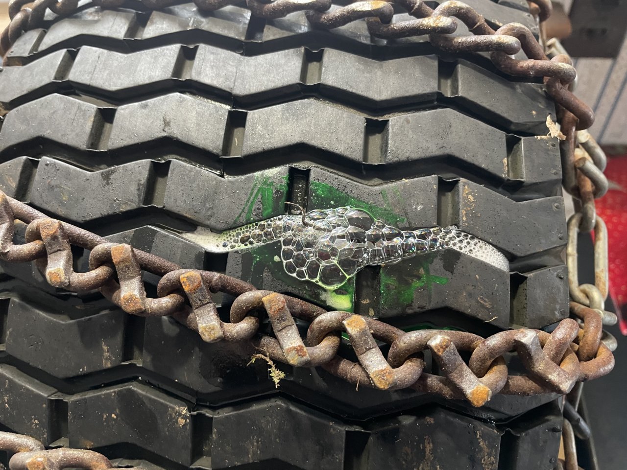

    fellas, whats the best choice for fixing a slow leak in a garden tractor front tire? its tubeless. can i use spray foam inflator and drive it a while? or do i take this to a tire shop? thanks!

    Does it for flat in 1day, 1 week or 1 month? If it’s longer than a week just inflate it as necessary. If it’s less than a day take it to a tire shop they might just tube it.

    Check the rim with soapy water, if it leaking there prob rust on bead. Check valve stem also if its leaking there also will have to get new valve stem

    I’d try to figure out where the leak is coming from and how fast it’s leaking. Because how fast and from where it is leaking makes a difference on what I’d recommend you do.

    8840ACEB-96A3-4B1B-8BBB-CB5619D5D6B7.jpg 8A6F597C-F99E-4FC8-B667-0A7497C121FE.jpg
    i just used an ounce of a tire sealer and positioned the tire to have the goop pass over the hole. Been good for two years. A major tire repair I don’t think is worth it and a tube would be a better choice.

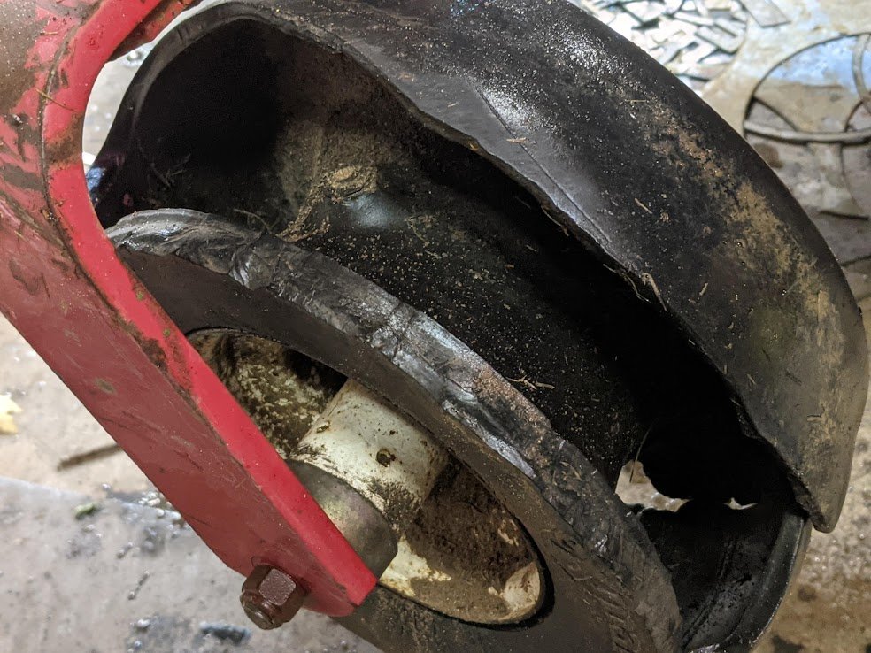

    Previous owner told me the hydraulic wheel motor was shot.
    Oddly enough, I have not had a bad wheel motor. Pumps and hoses, yes.
    Took the hub off this one and found the half moon key sheared.
    $2.45, serious uggu dugga with the windy gun and the unit moves and runs like a pretty new unit.
