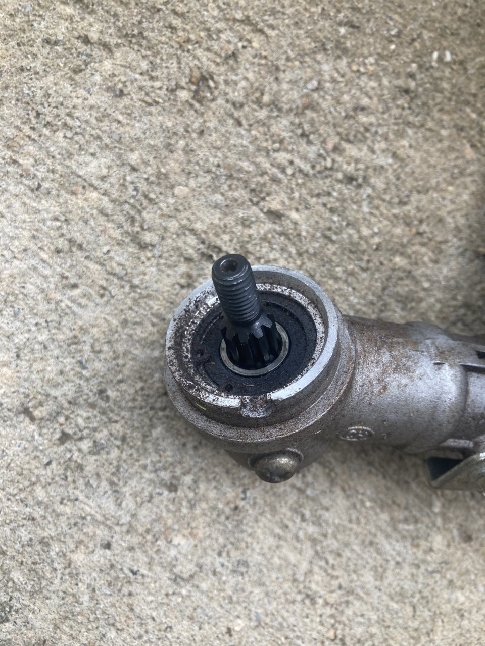

    27749B68-A410-4799-8762-45D005EE53DE.jpg 5504C0F5-CCE4-41D9-B947-606F226FC472.jpg I’m replacing my straight shaft trimmer head and I’m wondering if I should grease the gear drive or what. The manual doesn’t say anything about grease and not many things are serviceable anymore, just wondering if I should pop out the retaining ring on the shaft bearing and gob some grease in there.

    Is it a sealed bearing? Or can you pack it with grease?

    It is a sealed bearing. A quick search I found this. I guess I was overthinking it. I just need to pop off the Philips head on the side and add grease there, seems like a helpful little un-documented feature.

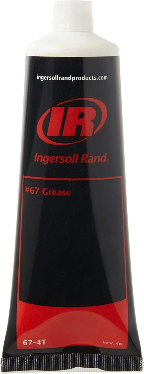

    The bearing is "just a bearing" if it needs to be replaced you can just match up the numbers.
    The right angle gears should be greased, that is a hard application for a grease.
    At the old job I maintained/repaired/resurrected a large fleet of pneumatic and electric tools that the workers were absolutely dedicated to giving the roughest treatment possible... :annoyed:
    I spent many hours working (and gabbing) with my IR tool rep, one of the most well rounded Wrenchman I ever had the pleasure of meeting, he had forgotten more about equipment than many folks ever will know.
    The grease I standardized on for tool applications was Ingersoll Rand #67, although this is called "right angle grease" it was also recommended for planetary gear sets in pneumatic tools. I also used it in greased ring and pinion and roller bearing applications with uncounted thousands of hours of trouble free service.

    I do my Sthil at least once a year. And yes screw is where it goes. Mine looks like the 1 in the video though.

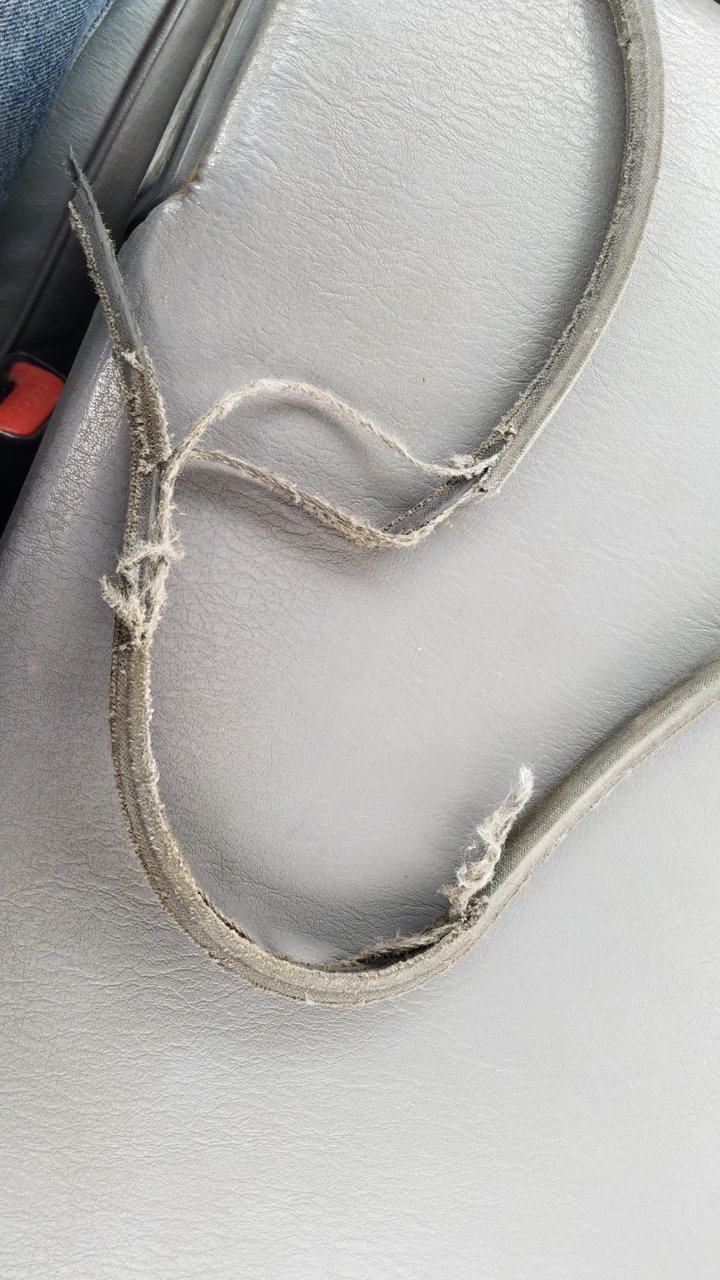

    My afternoon. My JD LT180 shredded its 2nd hyro belt at about 500 hrs. It's my yard cart/leaf vac mower.
    It's a pita to change that belt, but it's done, again.

    very good question. i asked too. mine cant be greased. ive got a stihl 460 brush saw. just use it til its busted, which will take a while. its a monster.

    Something isn't right... Usually they last just about forever.
    The hydro belt isn't doing much compared to a deck belt, it sees a fairly smooth application of load and no shock loads like engaging the deck at full rpm.

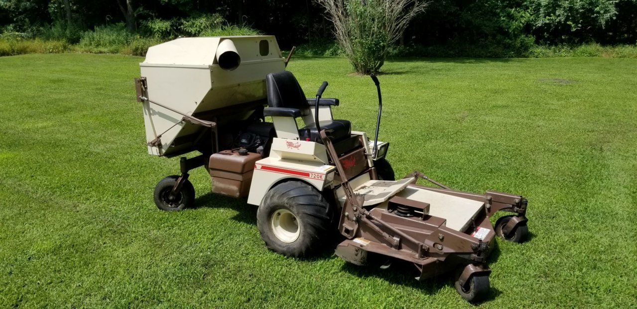

    I still keep this old girl around for leaves, It shreds them to little pieces and you just back up and dump them without ever getting off it. I can do a LOT of leaves in a couple of hours.

    Good friend of mine has the same mower. I think it's 4 years old now. He keeps going thru belts just as often.
    I've been trying to get him to grab one of my ZT project mowers and go thru it. it will last him the rest of his life.

    On my John Deere, the original belt lasted about 400hrs, and the Rural King replacement belt <200. A friend warned me their belts (forget brand, I'll edit later) don't hold up well.
    I may not have kept it tight enough. Could have been slipping a bit.
