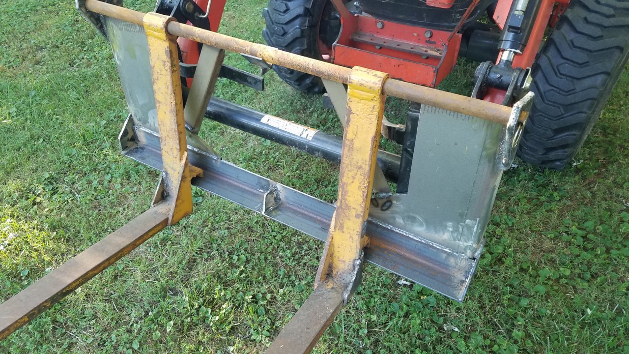

    I have clamp ons and built a thing to clamp them on using a quick attach blank plate and substantial piece of steel. So I don't have to use the bucket if I don't need to

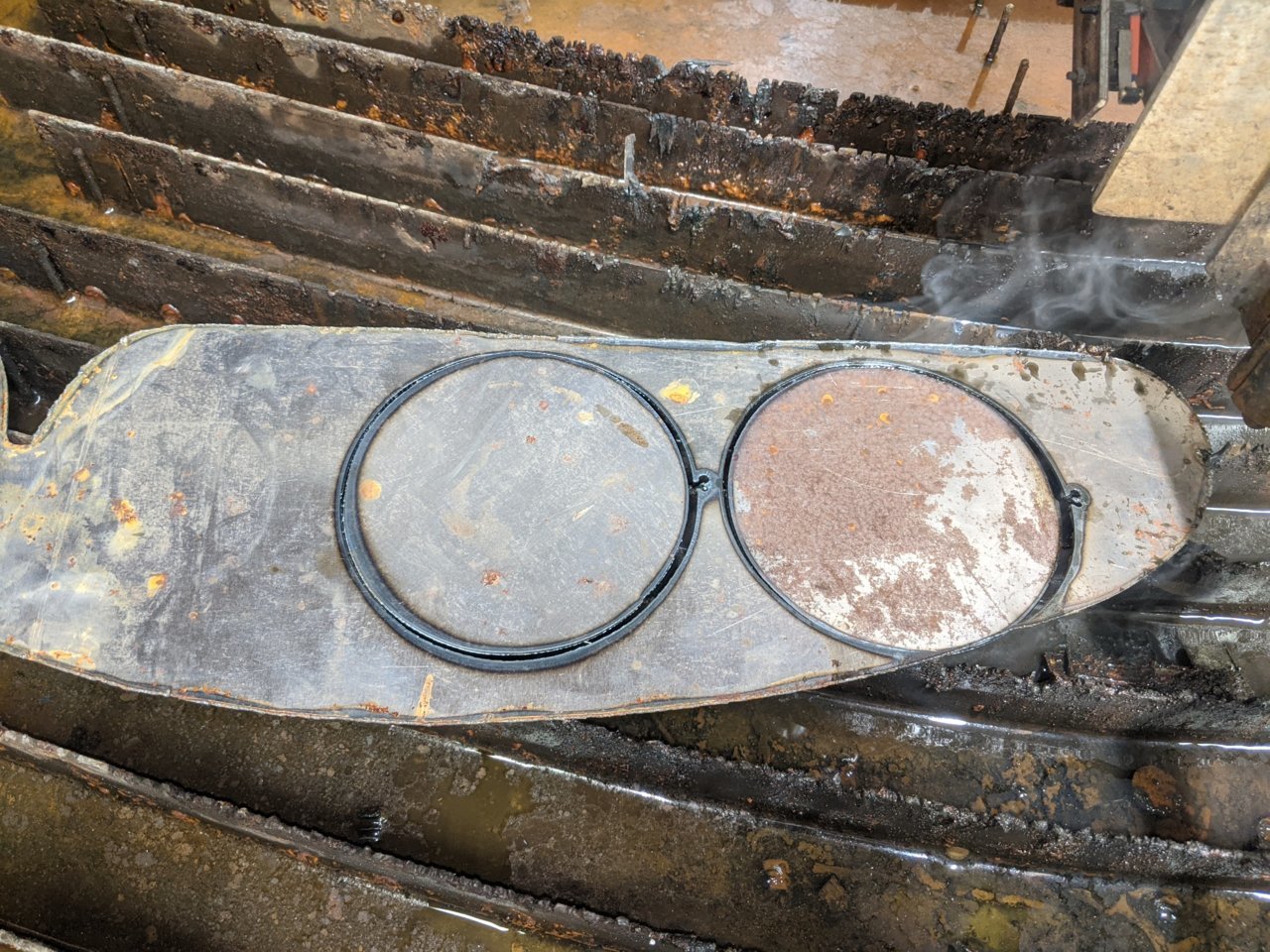

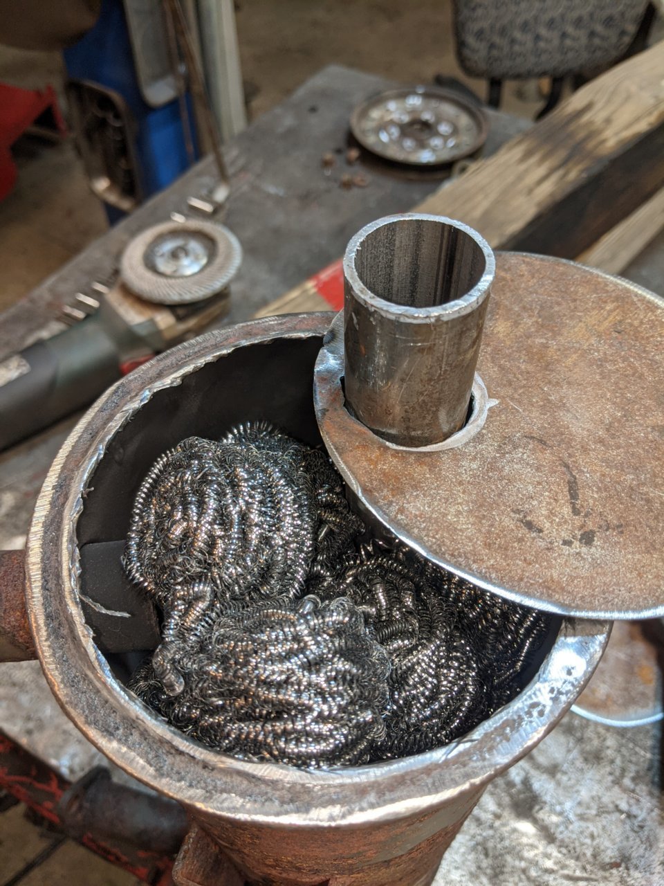

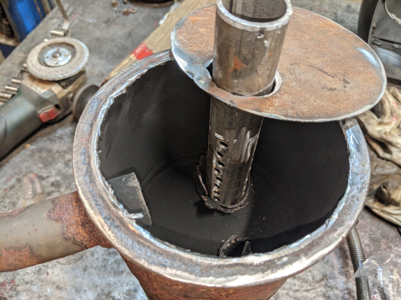

    Started by making a new perferated transfer/tail pipe. I just drilled a bunch of 1/4" holes.
    After that I was able to start stuffing the muffler with packing. I used stainless steel pot scrubbers.PXL_20221118_173123259.jpg PXL_20221118_173224818.jpg

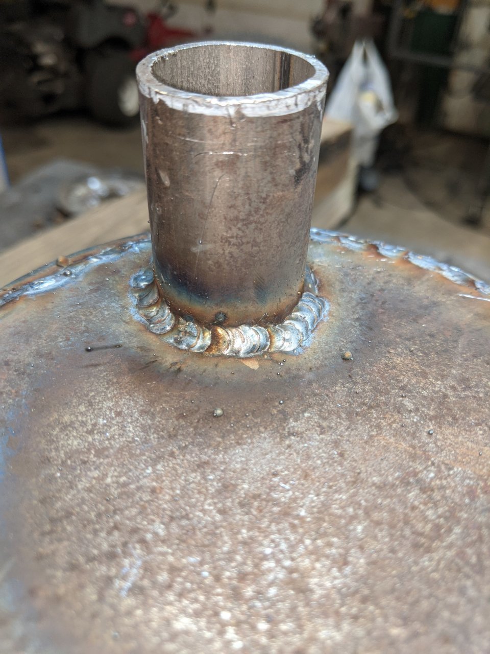

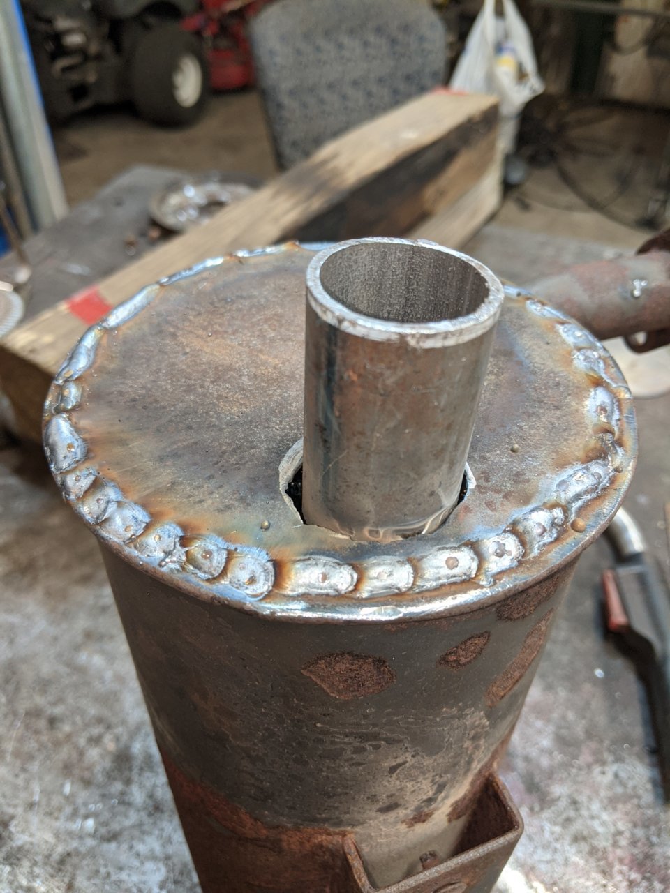

    Welded in the end caps as welded in the tail pipe.
    Pretty thin stuff. I was happy if I could carry a 1" bead. I think it looks pretty good for using a 240 volt mig machine.
    After test running, I am super happy. It's quieter than a brand new muffler.
    Who knows how long it will last.
    These mufflers are around $140 for the Chinese versions and way north of 2 bills if you pony up for the Kohler part.

    I bought one of the quick attach plates from Titan and welded up the rest to hold a set of used forks. If you had to buy a set of used forks, at least around my area $4-500 would get you the forks. The quick attach plate is $1-200 depending on size. Need to fabricate a few parts, but nothing fancy.
    Very happy with their part and they have sales pretty regular. You may want to pick something out and watch it for a bit if not in a hurry.
