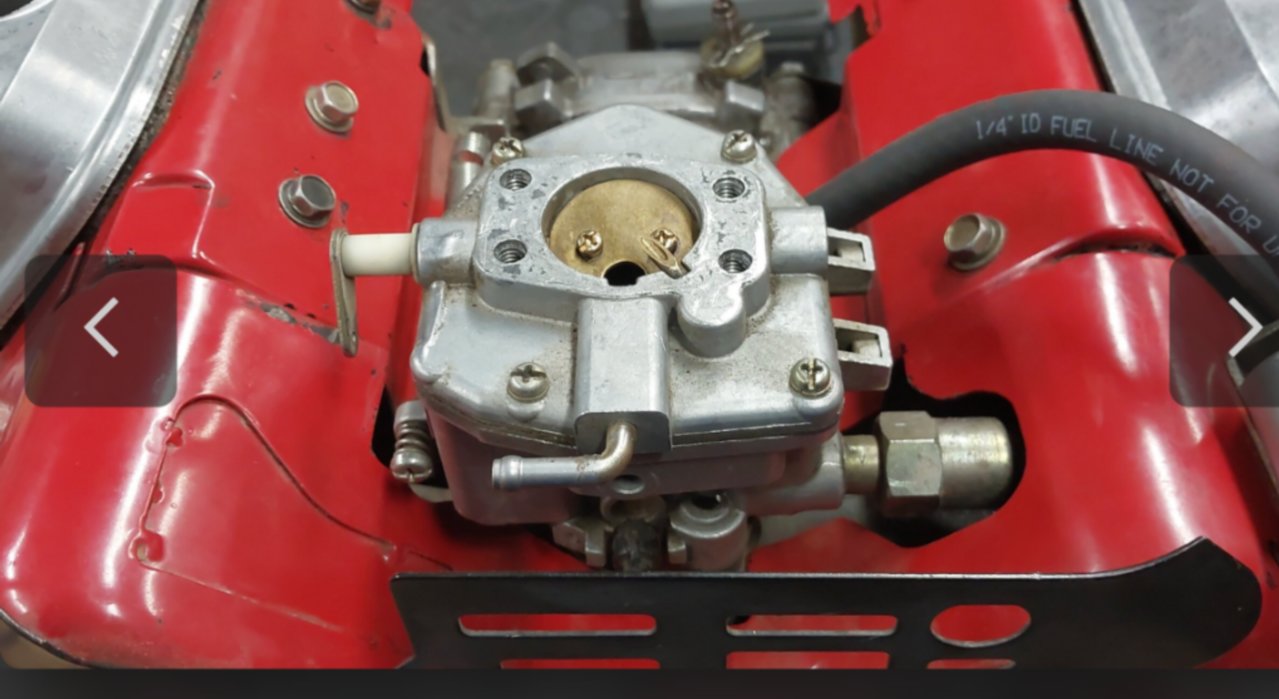

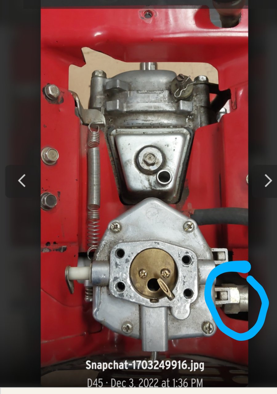

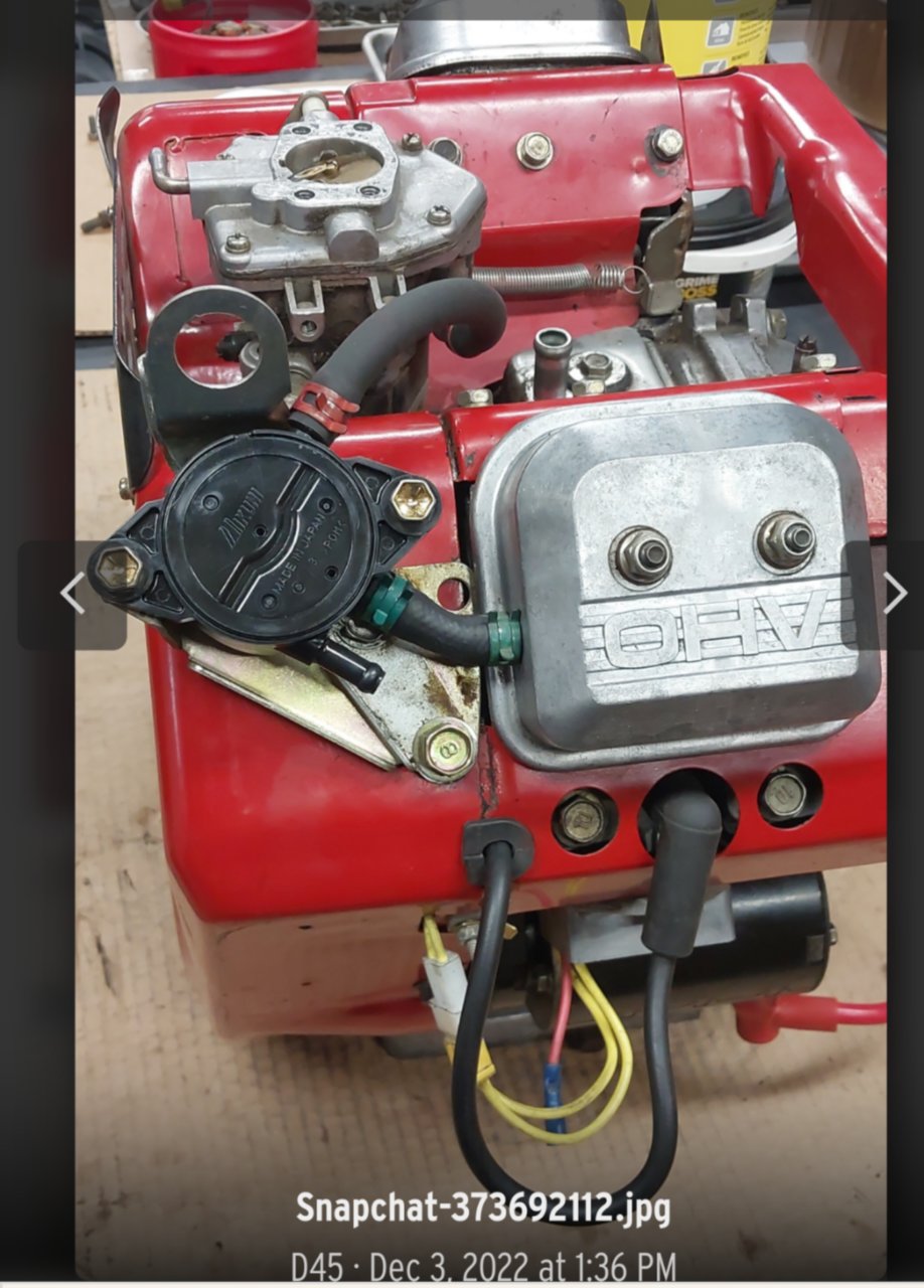

    16 HP Vanguard w/ 6100 carb question?
    Pics from another forum. Person is rehabbing this motor that they got for cheap.
    The question is what is the extra fuel nipple at the top of the carb throat?
    What is the angle cut port at the top of the throat and above the choke plate?
    Does this carb have a fuel shut off solinoid (circled)?Screenshot_20221204-114138.jpg Screenshot_20221204-114202.jpg Screenshot_20221204-114251.jpg

    I thought this might be a dual fuel carbs, but others say it may be a float overflow drain. I find that odd if it has a fuel shut off.
    I honestly don't know, but need closure. Lol.

    The extra nipple at the top is probably for a PVC system where any crankcase vapors would be pulled in the engine and burned.
    The angle cut port is the bowl vent I believe.
    Don't know for sure about the fuel shut off solenoid, lots of modern engines have them for emissions concerns I believe.

    I thought that too, but no air filter installed showing the case vent going to the filter. You can see the case vent port in both pictures.
    Is the cc vent different from a PCV port?

    Dug in a bit...
    From what I read it is the bowl over flow and originally had a small piece of foam over it, apparently the engine won't run if it is sealed.
