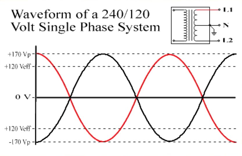

  12. Dec 21, 2022 at 7:05 PM
    #9692
    RustyGreen
    Aug 12, 2020
    #337468
    14,515
    sleeping in a chair
    2017 AC 4x4 Sport 6M Inferno
    Pavement Princess
    The photo below shows how 240 volts is provided either by the utility or a generator.
    L1 to neutral and L2 to neutral each provide 120 volts.
    L1 to L2 provides 240 volts as used in devices like water heaters or larger motors for example. In both uses the neutral line is also grounded.
    Below is a waveform as would be seen on a dual trace oscilloscope, L1 is in red, L2 in black and the neutral/ground is the 0 volt center line.
    The problem with the single inverter with two receptacles is the inverter is only making 120 volts (only L1 or L2 not both) and giving you two places to plug it like the photo below.
    The same 120 volts (L1 or L2 to neutral) is available from the source (inverter) at both receptacles.
    The issue with using two inverters (aside from damaging them) is there would be no hardware to make them produce the synchronized waveform needed.
    six5crèéd[OP] and wilcam47 like this.

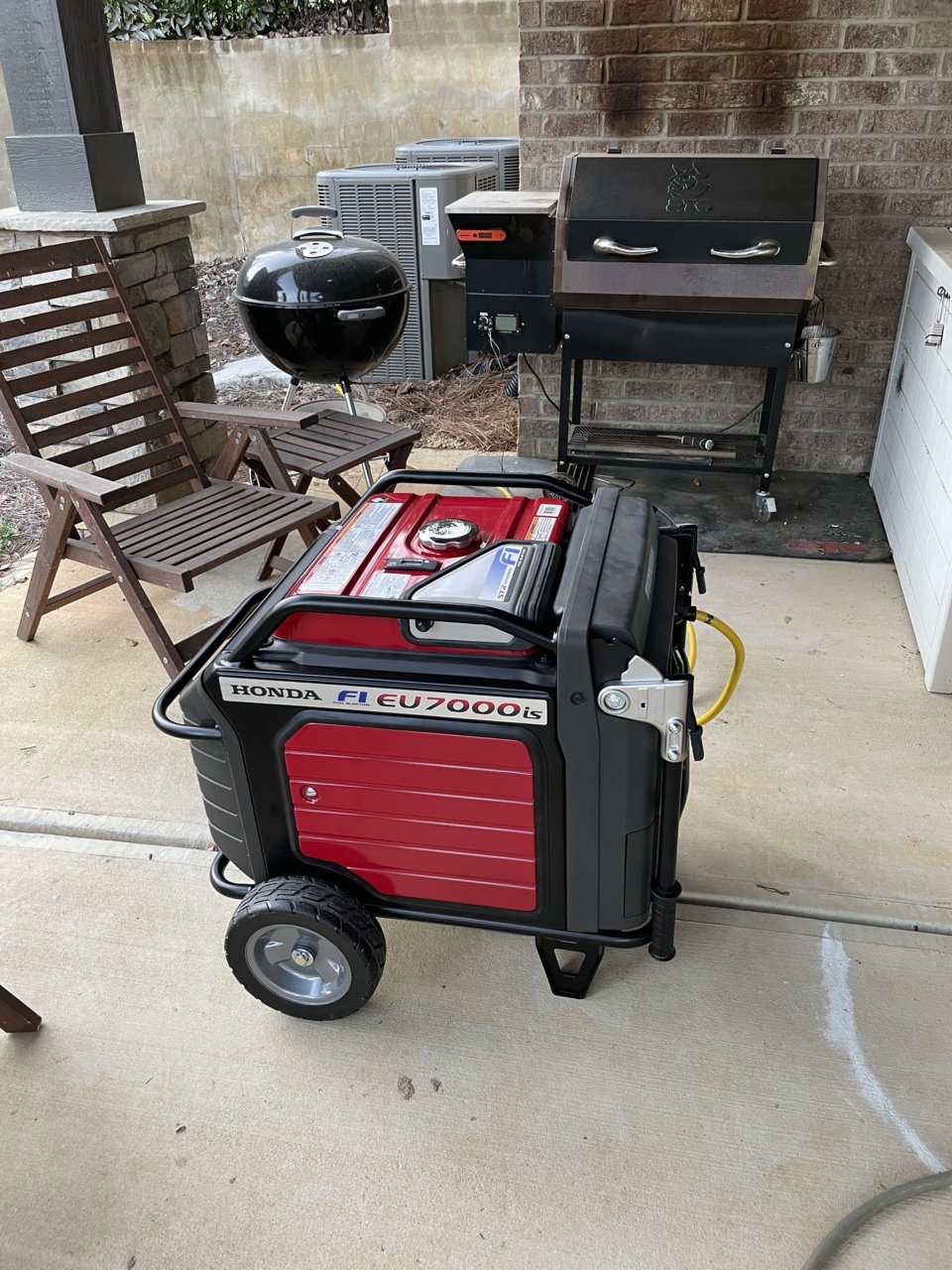

    Early Christmas…now to learn how to operate and maintain

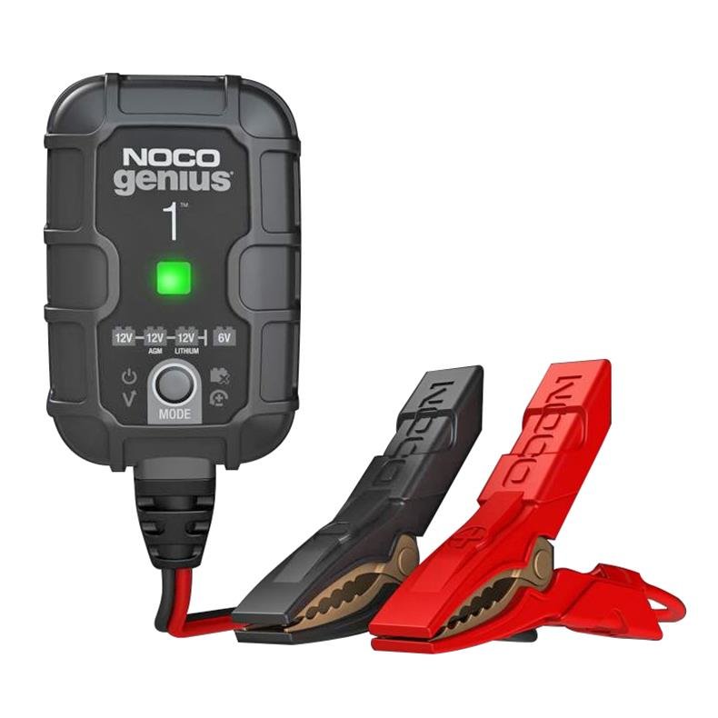

  20. Dec 22, 2022 at 6:10 AM
    #9700
    RustyGreen
    Aug 12, 2020
    #337468
    14,515
    sleeping in a chair
    Pavement Princess
    ALL of us have done the pull the rope with the switch off trick -- kind of a rite of passage I think. :facepalm:
    First get back to the basics: Get out the manual and make sure it has the correct spark plug including brand if listed, often times the wrong plug gets substituted and then people keep replacing it with the same. Get a new one, don't fall for the parts store guy saying "this will work", get exactly what the manual calls for.
    Try a short spritz of carburetor cleaner down the intake and pull the rope, if the engine immediately runs for a second or two you can assume it is reasonable mechanically sound and the ignition system is good. NOTE: Don't use starting fluid, it is very hard on small engines.
    While you have the air cleaner off operate the choke and verify that it fully closes and opens.
    Do you have straight 30 grade oil in the crankcase by chance? It will be very difficult to get starting rpm in cold weather if so. Your manual probably calls out 10W-30 or even 5W-30 for cold weather operation. Check the level frequently especially if using 5W-30.
    If it takes a standard mower battery don't even bother testing it, just replace, they don't last long in occasional service.
    The best way to extend the life of (any) battery that isn't used daily is a quality battery maintainer like the NOCO Genius 1, at only around $30 these quickly pay for themselves.
    https://no.co/genius1
