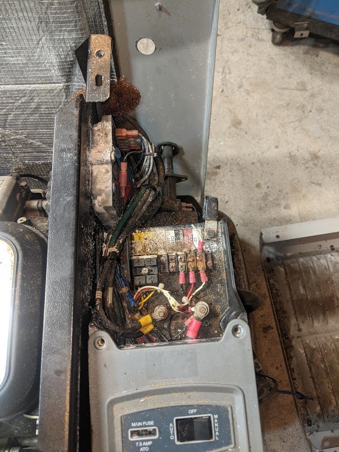

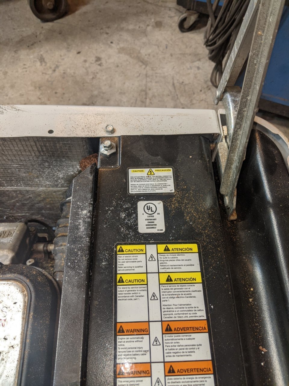

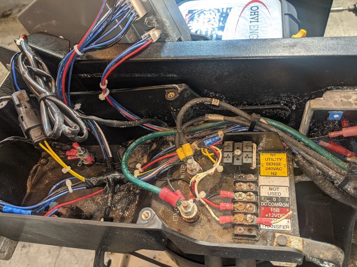

    Cleaning up my stand by gennie. Found some corroded wire terminals. OCD requires me to go thru the whole unit.PXL_20230329_205842501.jpg PXL_20230329_205851922.jpg PXL_20230329_205904569.jpg PXL_20230329_212757842.jpg

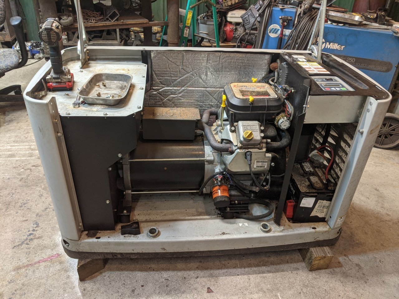

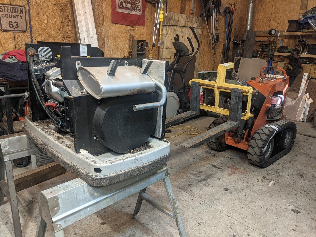

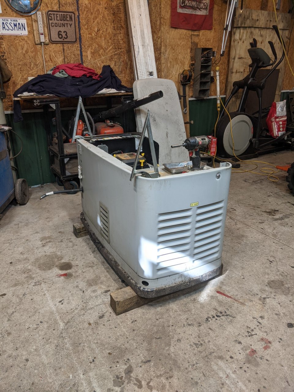

    Removed the enclosure. Makes it a lot easier to clean the thing.

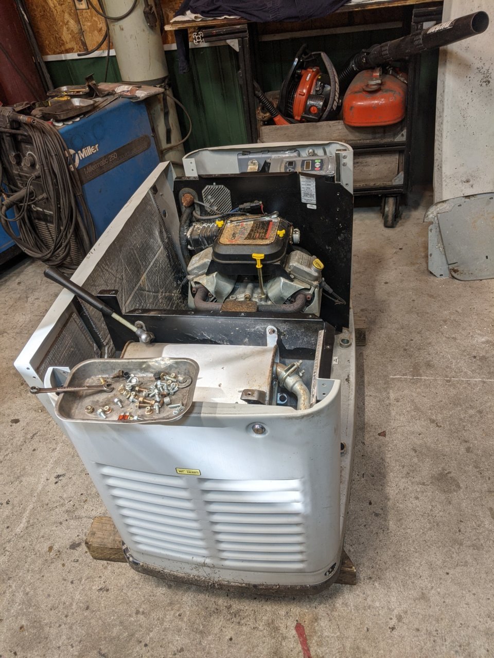

    Those bastard got everywhere! They gained access thru the natural gas grommet.

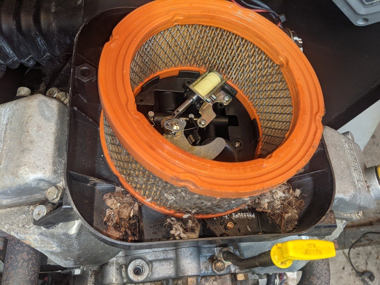

    They even snuck into the air cleaner housing. I'm not sure how they did that.

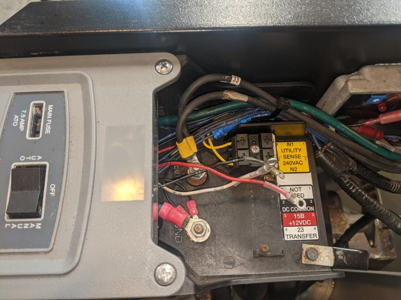

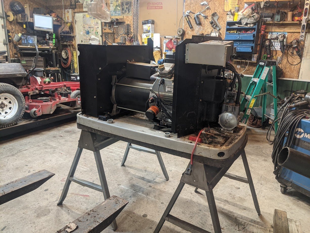

    Cleaned up...Mostly. waiting on a terminal block and a starter.
    Of course Generac used their own starter. Even though this starter looks like a Kohler starter, it don't fit.PXL_20230330_200616719.jpg

    Fukkin mice?
    I didn't even think of that. We had a 24kw installed last July. I guess I should take a look.

    Yeah, fucking mice! Man, did they make a hella mess!

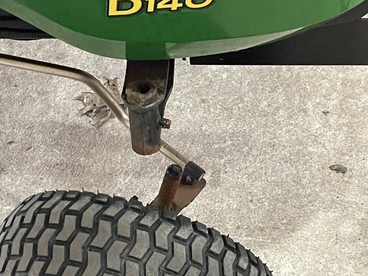

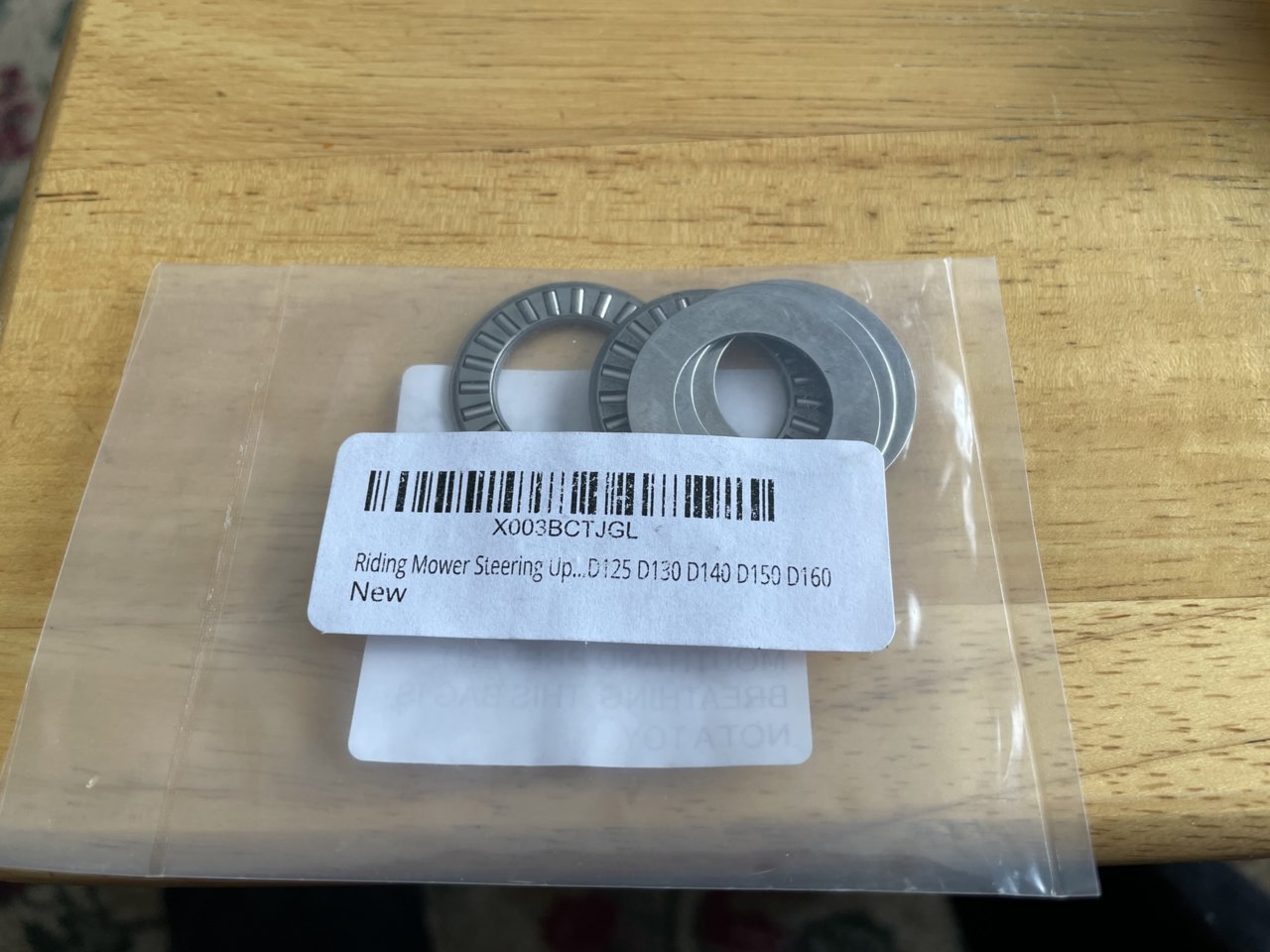

    Putting steering spindle bearings in the JD..
    Turns like a Mac Truck with the blower on it.

    Did this come with those thrust bearings from the factory? Regardless, it's gonna make steering a breeze!

    Nope. Just bushings and metal on metal. I can tell the difference without the blower on it as it is. So I’m sure it’s going to save the steering on it next winter. For $20.00 it Was a no brainer while I had the tractor hanging from the rafters from the winch.
